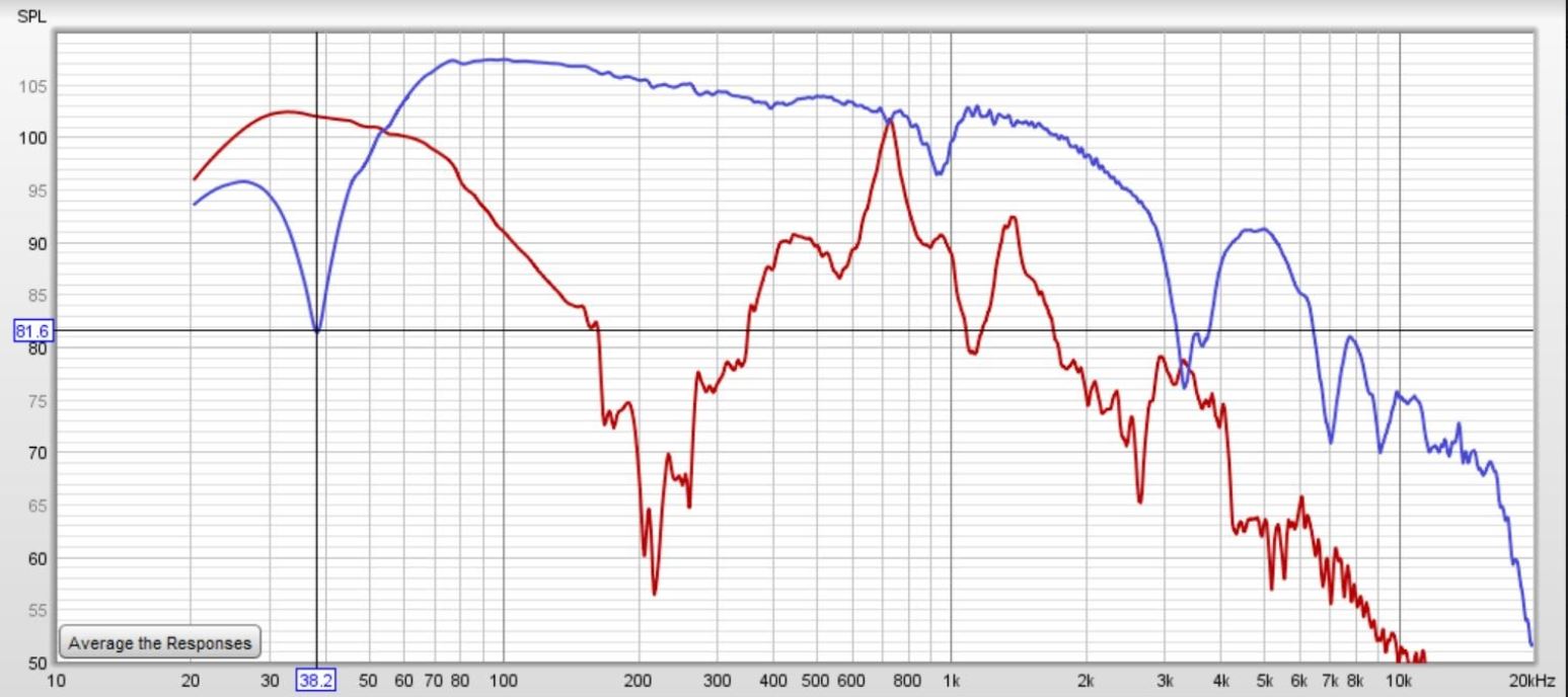

Regarding this specific aspect of port pipe resonances, I have attached a picture of the woofer and port nearfield responses I saw in one of my previous attempts to build a 2 way with an Sb17MFC35-8 woofer.
I don't know if I have ever heard that pipe resonance while playing music (since I don't know how it will sound like specifically). But looking at that graph of port response was terrifying enough for me to try sealed alignment for the woofer in this project

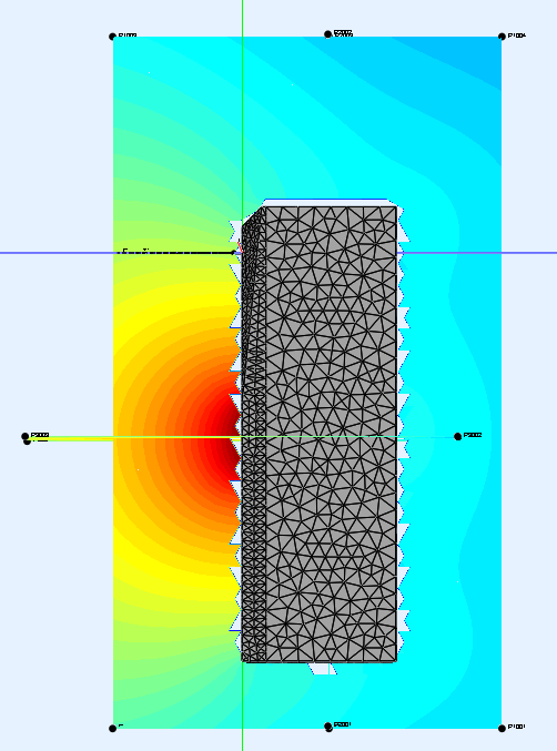

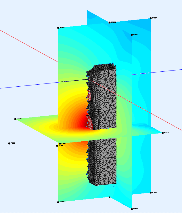

Yes Vituix models the baffle step which is the dominant feature. When you measure or simulate 360 degrees around the speaker, there is a second step or transition depending on the geometry which has more directivity than the baffle step alone would predict.So what is happening seems like the interaction of the depth and width of the cabinet during the baffle diffraction step transition for the woofer and similarly for the mid driver as you and others have been pointing out.

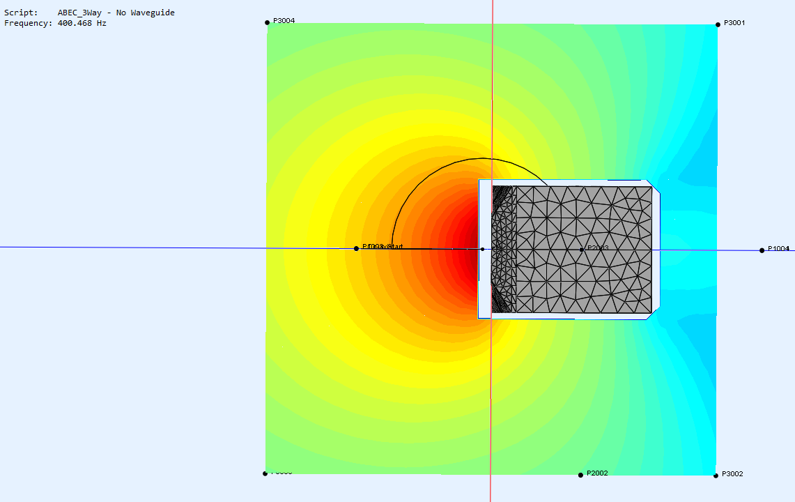

That is not so easy to answer. If the width and depth are quite similar you tend to get reinforcement and cancellation from the dimensions occurring at similar frequencies. This is why a cube is often considered a bad enclosure shape due to all sides being equal.If this is the case, is there a specific combination/ratio of dimensions that will help us see smoother directivity transition at these lower frequencies (wider baffle + less deep cabinet?).
In this case the woofer could be modelled in a more simple rectangular box with the width and depth varied to see the effect. This would take some time but it is interesting enough to try.
If you retain the dimensions as they are you will get something like the response predicted. A flat disc is a better representation at higher frequencies and adding the depth of the cone is more accurate at low frequencies, but if too deep ABEC runs into issues with some of the basic assumptions made in the simulation and it becomes less accurate.Or we have to live with this kind of response if I retain the cabinet dimensions as I have currently.
This is in the transition zone and whatever your speaker measures like in free space will not be what it measures like in room. The transition zone is the hardest to fix with equalization. So for me it seems worth the effort to try and minimize the issues in this range.The other question I have is, audibly, what could be kind of impact
of this kind of peaks in the response since it looks like the kind of frequencies below which the room takes over. Also I have heard people saying that the 200-400 Hz frequencies are very important perceivably in setting audible levels for the rest of the spectrum etc. I don't know much about any of these yet.![]()
The level of treatment and position of the speakers and listening point that can be used will determine how much effort would be worth putting into the acoustic design to minimize problems created from difficult placement.
In a three way speaker it should be much easier to avoid midrange leakage by putting the port and damping in the right place, crossing the woofer below it and sealing the mid in it's own enclosure.I don't know if I have ever heard that pipe resonance while playing music (since I don't know how it will sound like specifically). But looking at that graph of port response was terrifying enough for me to try sealed alignment for the woofer in this project

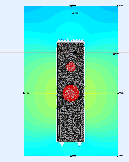

There is information on port placement and reducing midrange leakage as to the directivity effects from cabinets I don't know of any specific sources of information.I will also try more in the direction of the bass-reflex design by reading more about the work that augerpro has done and see if I can accommodate it in my project. If you have any more suggestions/papers/books/anything that you can point me to regarding enclosure geometry and its effects on directivity in the lower frequencies, please let me know. I can pursue learning more in this direction.
The tweeter should be OK and the Mid looks fine as long as it will be crossed over high enough. The same sort of issues are visible in it's response too but they are more likely to be out of the passband. Fixing the enclosure for the woofer would have the same effect for the mid too.I will wait for your simulations and suggestions about the woofer enclosure part and the remaining part of the overall design like the tweeter and mid interaction to see if changes need to be done in that area also..![]()
This would have some effect but more so on the vertical directivity and overall power response. As the same sort of issue is visible in the mid it won't be fixed just by moving the woofer. Having the woofer closer to the floor is a good idea in general as you get more reinforcement that way.Will it help if we create a woofer module where the woofer is asymmetrically mounted on the baffle (in vertical direction-i.e., woofer location shifted more down towards the bottom of the cabinet or more towards the top in the woofer module cabinet, with a separate smaller cabinet for mids and tweeter kept on top of the woofer module). This would be unlike the woofer location in my current design where it is almost at the center of the cabinet in vertical direction.![]()
The Rockport is basically a faceted baffle. Chamfers and round overs work much the same. Facets and round overs have more effect as frequency rises as the longer wavelengths just don't see the baffle edge like the mid and high ones do.The other thought I have is regarding what would be the effect of a generous rounding of the overall cabinet itself (again thinking like diffraction doesn't like rounding much).

I suggest you build the current project as is, at least a prototype. Measure it and optimize the stuff that needs optimizing and finish the project. I suspect the sound will be good as long as you have addressed an issue and either accepted it or bettered it one way or another. On the next project you have opportunity to redefine the goal and when you have very good plan (goal) and knowledge how to get there you can make better one.
Separate top and bass box is a fine solution sound quality wise since you can optimize dimensions of both to their respective bandwidths. More work involved in a way that now there are two boxes, but it could still be easier to build since both can be smaller than if they were combined as one. Big boxes are very difficult to manufacture. Small errors multiply, big assembly space required (I've assembled on floor.. ), huge clamps and what not. Pain in the back in general

Observation fields at 400Hz show the effect the depth and the height are having on the directivity of the woofer.
Thanks fluid
Can you elaborate a little bit about how to interpret these pics. I am a little confused looking at them..
This is what I understood so far.
In general we are trying to look at how a 400Hz signal radiates into free space surrounding the speaker
Pic-1: We are looking at the radiation from the front. I see dips in the attenuated blue colored wavefront at the top of the speaker. So something has caused energy to dropin those dips. Is it secondary sources due to diffraction from the edges?
Pic-2: Side view of the radiation. I again see blue colored dips at the back. If the speaker had more depth, would the radiation have been more of a "focussed beam?
Pic-3: Top view of the radiation. Again the dips at the back. Would it have been better if those dips were not there or that pattern was more focussed forwards
Pic-4: We have a slice each of the directivity baloon in the horizontal and vertical directions comtaining the combined information in all 3 plots before
