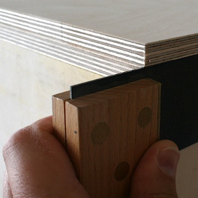

The outer box has to be oversized relative to the inner box. This is to allow a gap of around 1mm to accommodate a layer of Silicone which is designed to provide some vibration isolation between the inner and outer boxes. The outside box pieces will be glued firmly to each other with PVA yellow wood glue where they contact each other.

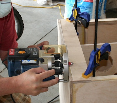

I decided it was best to start with the top of the box, trim the edges, then add the sides, trim them, and then the front baffle because each subsequent addition overlaps the last.
Therefore, the top has to overhang the sides and front/back of the inner box by the thickness of the Silicone, around 1mm. The best way to achieve this is to slightly oversize the top, then use a guided router to trim the edges back, using a shim of metal to set the thickness.
The first image shows a set-square held up as a temporary shim to set the overhang distance and the second image shows what we are trying to achieve. The top piece is glued in place already.

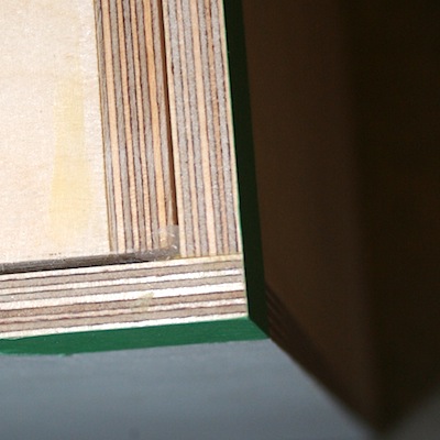

So I managed to get the top and the sides glued in place. Next is the front baffle.
first image - shows the corner of the box, which is lying on it's back so that the front baffle is facing upwards towards the camera. The outer front baffle is 17mm thick birch plywood and it will be glued down on the top of this. It will be glued firmly to the edges of the outer box using PVA glue, but where it contacts the front baffle of the inner box it will be Silicone. You can see there's a gap between the inner box and the outer box.
I've taped (green masking tape) around the sides to prevent pva glue seeping out onto the surface during the gluing of the front baffle; it's a bugger to clean off otherwise and would badly affect the finishing later.

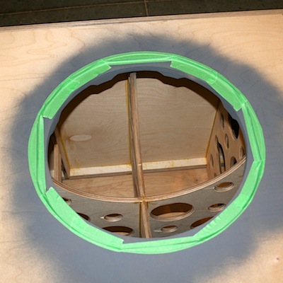

second image - taped around the driver opening to prevent silicone seeping out and making a mess there

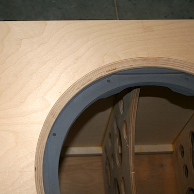

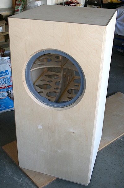

third image - the outer front baffle dry-fitted to the front of the box. It's been routed with a 45 degree chamfer and perfectly aligned with the driver opening in the inner box.
