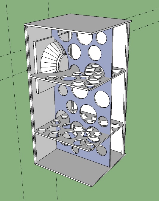

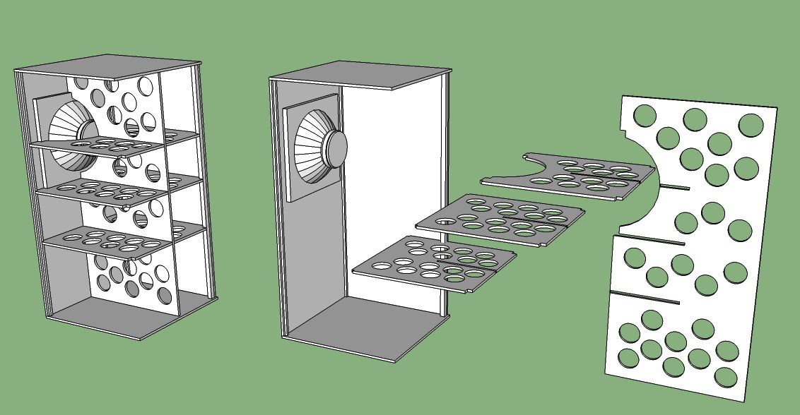

The front baffle, because of how I have things arranged, can be thinking and I'm thinking of using the 17.5mm sheet for the outer front baffle for total of 29mm, total just over an inch.
Trouble with a vertical brace that is parallel to the front baffle (as I proposed in my earlier post) is that it once it is glued into place cuts off access to the front half of the box for fitting additional smaller braces. This is where the horizontal shelf brace helps because now I can easily reach into the box to add a number of smaller braces which will be larger in number so that I end up with no large areas of unbraced panel. These smaller braces could more easily be installed at some angles too.
The horizontal shelf braces also add more strong bracing to the front baffle and behind the driver where perhaps the most help is needed. So I think I'm going to go for this arrangement.

the walls will still be relatively thin. The inner box is 11.5mm thick panels. I've undersized the box by around 13mm, allowing an outer box to be made of the same 11.5mm panels. I can't use thicker panels for the outer box or it won't fit on top of the inner box.

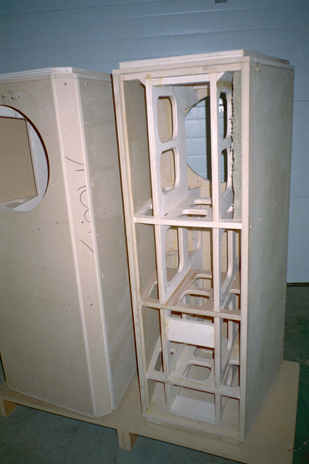

something like this?

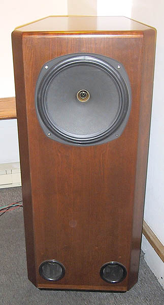

Tannoy 15" dual concentric circa 2002
build the endo-skeleton first, dado exterior panels
next (?) time, BB ply for the whole thing 1" MDF is a mf to work with on a box this size - well over 100hrs start to finish, and at least 200lbs each with drivers installed.
is that cnc router yours?
perks of working in a commercial millwork shop - Morbidelli Author 505 at the time

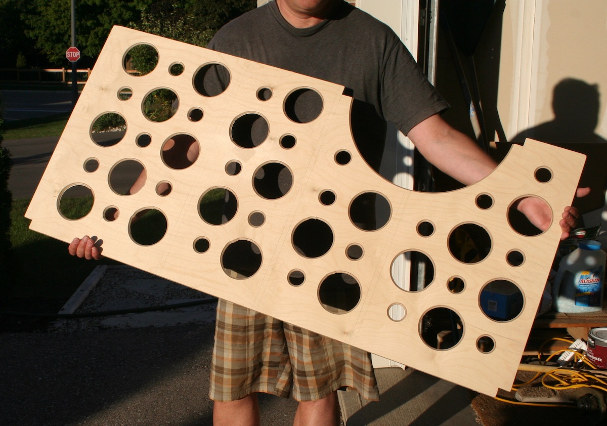

Well, this is an inspiring build Chris. Just happens I have a half panel of birch ply left over from another project so I can make up a 3rd shelf brace as in your design. I've cut the braces to size, just the external dimensions, a lot more is needed to turn them into holey braces. I think it's going to be an interesting challenge.

No flat spot to brace (& support) the magnet?
dave
I decided not to do that because I'm not so sure that's how I want to brace the magnet so I've created a clearance space - but it will be relatively easy to add a magnet brace (e.g. by gluing it to the holey brace) - and I have time to worry about the design for that whilst I finish the basic construction. I may opt for something that 'grabs' the magnet rather than just presses against the back of it.
