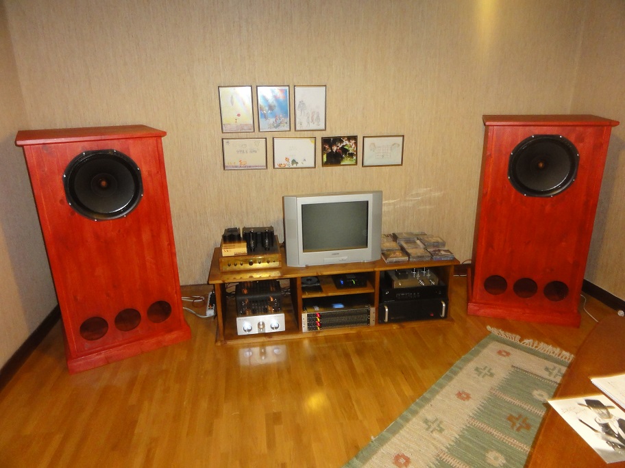

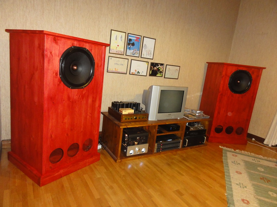

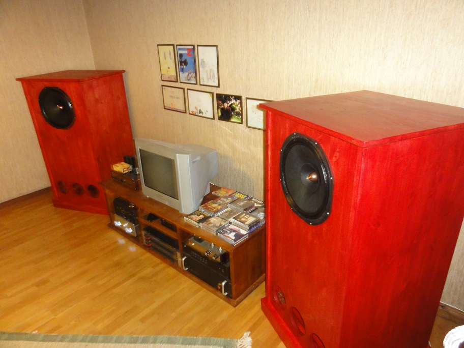

Some photos of the 13.6 cabinets
Thank you very much for starting this interesting thread, Bigun. Much appreciated and very good reading! I have followed the thread closely, and it helped me to pull the trigger and order a pair of the AN15s. I first put the drivers in large open baffles, 6x3 ft with wings. The bass output was very adequate in those baffles, but with a different sound to it, a different 'signature', than in the 13.6 boxes. I'm not sure which bass signature I prefer, from the 13.6 boxes or from the ob. However, I had a problem with beaming at higher frequencies in the ob, a problem that I can't detect with the drivers in the 13.6 cabinets. I also had more of a problem with a rising midrange in the ob's, and I used some eq to manage that. I talked about the beaming I heard with David at Commonsense Audio, and he recommended me to build the 5.6 or 13.6 enclosures. Well, the beaming is inaudible to me in the 13.6 cabinets and I like the overall presentation very much. However, there is a certain 'magic' to the ob sound, I like it a lot. I use about 20 degrees toe-in on the 13.6 boxes and my listening position is some 10 feet away from the speakers. I use no eq now, but I seem to enjoy the sound more if I position my head somewhat below the drivers. There is still some rise in the midrange, or it could be that I'm just over-sensitive to those frequencies.
