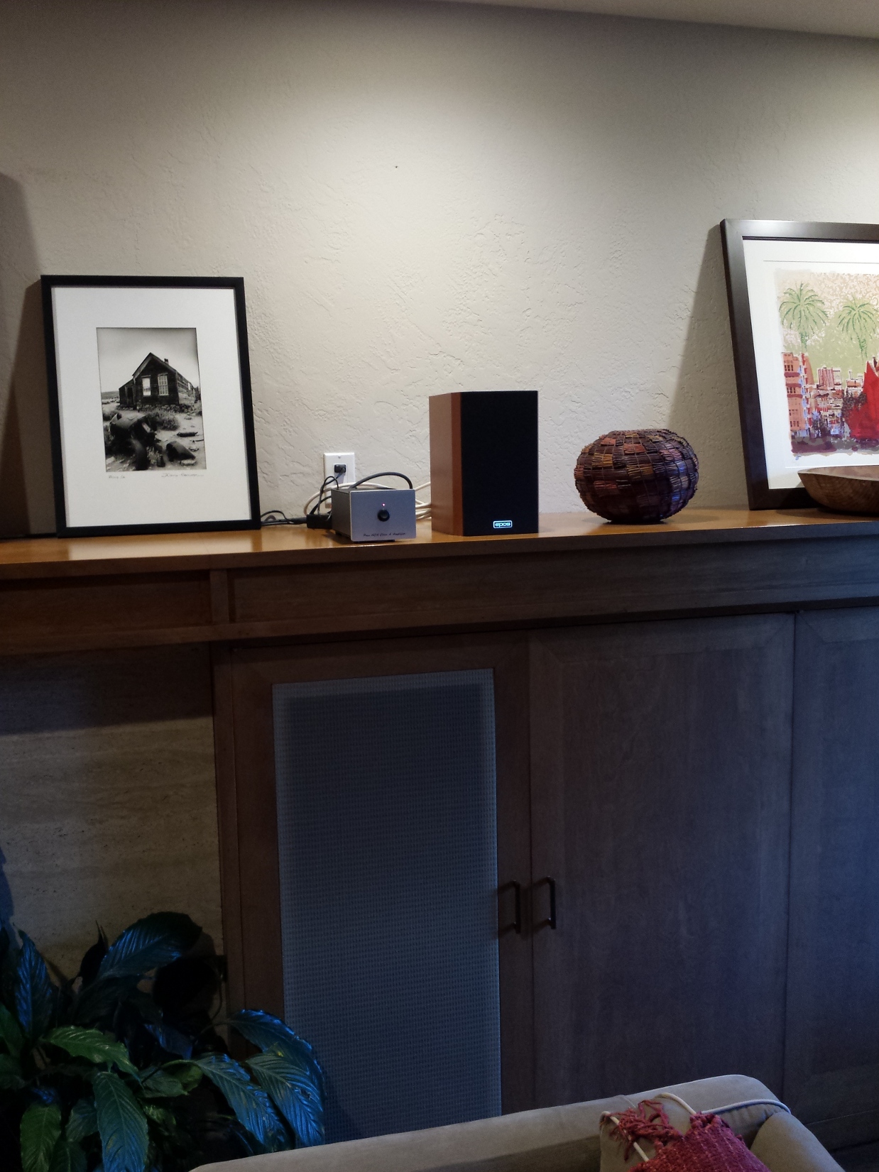

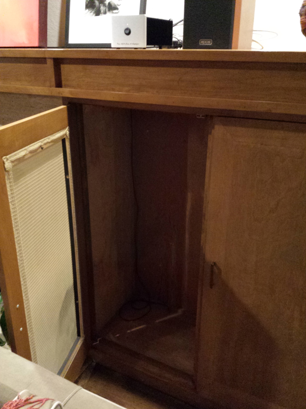

Building Audio Nirvana 15" speakers into existing cabinets...
All,
I'm making the bold move of doing my first speaker DIY project with something slightly out of the ordinary. The previous owners installed a beautiful (in my humble opinion) wood cabinet that extends the length of the living room. They put speakers in the cabinet previously, but I thought it would be fun to build speakers using the existing cabinetry.
Now, this obviously brings up a lot of challenges, notably that it's likely that a large part of the cabinet will be vibrating - I don't think it's going to be possible to brace the inside of the existing cabinet sufficiently to prevent this from happening. I'd appreciate any thoughts / suggestions on things to add additional bracing from the inside.
There was a bit of discussion earlier in this thread (read all 40 pages) about the purpose of the horizontal brace below the speaker, and that it helps to distribute energy to the side and rear panels. Seeing that the side and rear panels won't actually get any sound out to the listener, and may actually be detrimental, does it make more sense to skip that?
Any suggesting on porting vs. skipping it? I saw a little discussion, but not much on that.
The volume of the cabinet is approx 45.5"H x 22.25"W x 17"D. I was planning to put foam on the side and back internal walls, and doing as much work as I can to seal the speaker cabinet so that there isn't any leakage into the other sections.
Thanks in advance!
