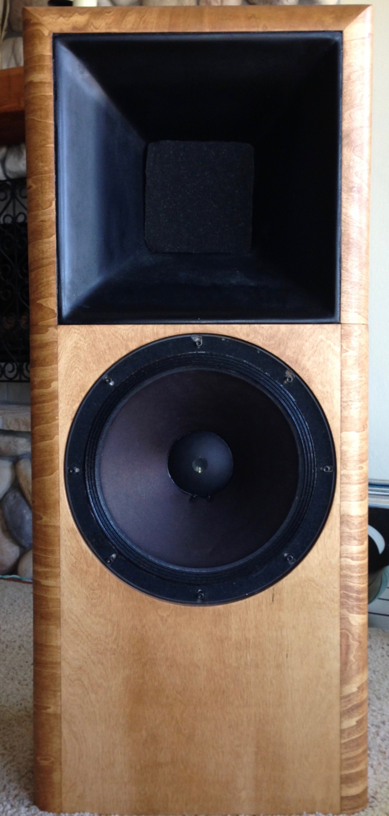

Well, simply put, I don't really want use huge horns in my living room, so these seem like a very nice compromise.
One thing I noticed is that a 1.4" horn is used with a 2.5" fullrange driver. I'd like to use a 2" horn because I might want to switch to a 2" BMS coax compression driver if it all works out. What would be the effect of the larger throat (on the fullrange driver)? How much will that affect HF?

I think he means the Small Syns. But neither this thread nor the Small Syns are large designs. They are meant be be relatively small
I'm wondering if there is another solution: what if you would take the simple 2-way design that is proposed here, and make it an acoustic resistance box by making some stuffed slots in the side panels. That would also take care of the lower down directivity, but does not need a box that is much wider or higher than the horn itself is.
I went with a big conical horn, a single 12PE32 12" driver for 110-500, entering near the throat in a 180 sq. cm. port. The cone throat is 25sq.cm area.
