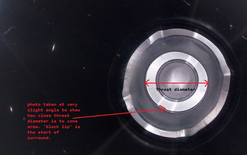

Hi All,

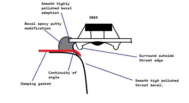

Very interesting to read about this experiment/speaker - So much in fact, that I want to try to make a similar build with the SB fullrange and 18-horn.
Regarding how to make the "throat" I am a bit confused.
Why make the roundover a tiny bit bigger than the surround and then cover it again with wool. Is this to make a smoother transition between the driver and the horn ie. no sharp edges?
On the picture of the actual driver in the horn, it looks like the driver inclusive dustcap, diaphragm and surround is visible from looking into the horn.
Is this not a discrepancy from the description of the picture?

Hi, that is not the surround you can see, it is the throat of the horn. The horn actually has a slight 'pinch to it that improves high freq dispersion (see 18sound website for pics).
The wool was my attempts at reducing a null when we first started experimenting. Getting the smooth transition was the most important bit.

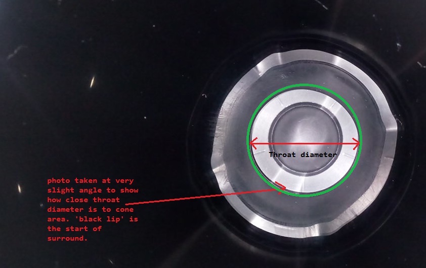

Hi Buschmeister, thanks for your reply.
I think I have figured it out know: When looking into the horn, it is only the area inside the surround that is visible (the green ring on the attached picture). But the actual routing of the horn is bigger - Outer diameter around 2,5 inches. To make room for the driver to breath?

That's correct.

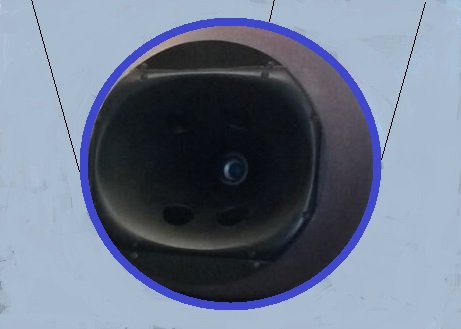

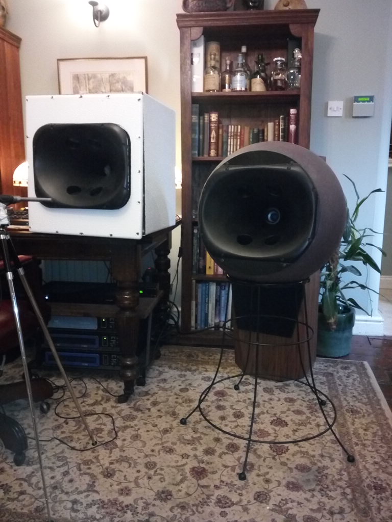

Yes I still have these speakers but I rehoused them into spherical enclosures:
See this thread for the build:
The XBush Mark 2. A synergy/Unity horn of spherical proportions
They are amazing speakers - they don't need sub-woofers, and you can listen to them very near field or far field with very little change due to the point source summing. Of all the speakers I have made they are one of my favorites.
They must use a digital crossover to work though.
Currently I have one speaker that I tend to listen to more which is also spherical and designed to minimize diffraction. They aren't so good near field, but further out, they are simply amazing.
I don't know if this is the quality of the drivers, the lengths I went to to minimize diffraction, or because they are four way (rather than two way).

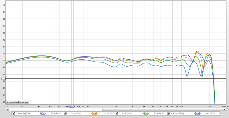

Attached is some rough measurements of the driver in the horn. The horn is flipped 90 degree - So kind of the vertical response - I plan to use it like that.
Maybe the response around 4-5 Khz will be better when I route the horn a little bit bigger. Clearly room for improvements - but not too bad I guess?
That looks excellent to me!
I did find improvements can be made by making the throat transition as smooth as possible. But the SB65 works really well in that horn!

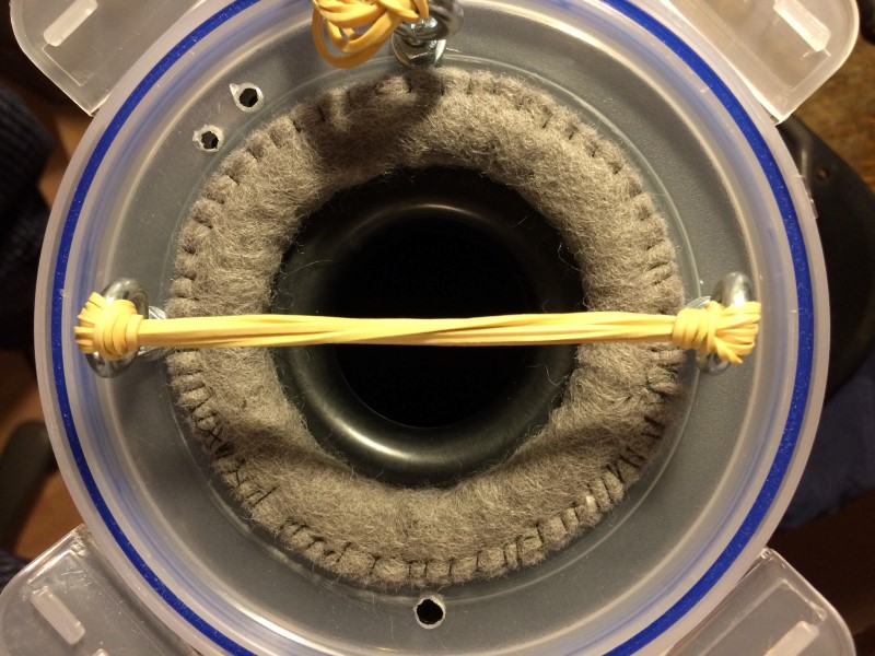

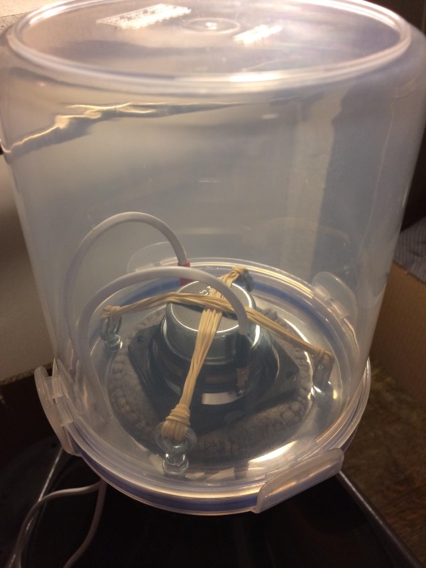

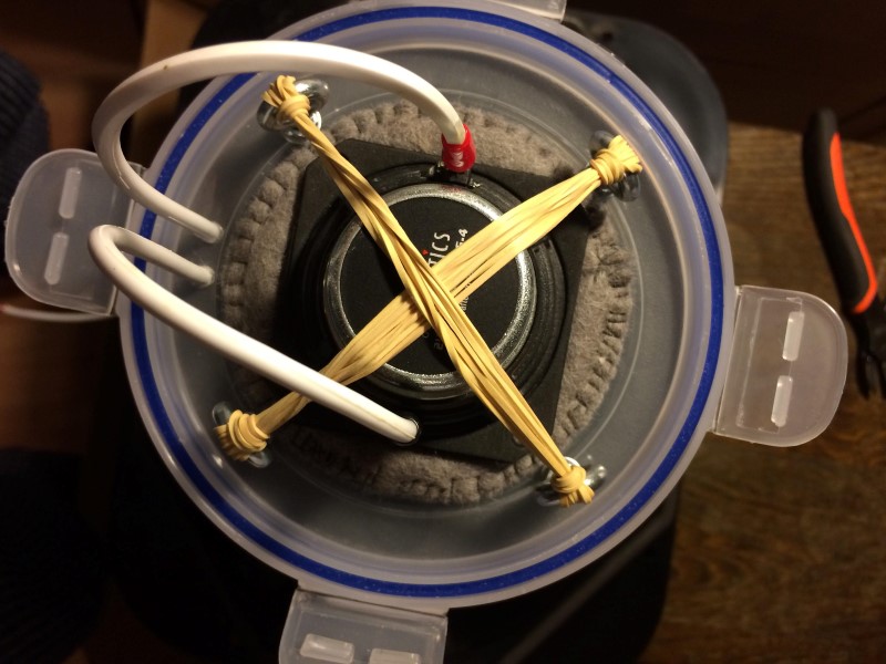

I have made som advance regarding the horn.
First of all have made the throat a little bigger and as smooth as I could. Sanding up to grit 2500 with "wet-sanding-paper". The wool ring around was the simplest solution I could come up with. To rings of speakercables sewed together with thin wire. Then the wool sewed around it. My solution to mounting the driver is also quite simple, but I think it works well. See attached pictures.
The plasticbox is filled with thin felt and a piece of fill in the back. The volume is ca 1.5 Liters. Way bigger than nessesary - But the cheap boxes were fitting well...
