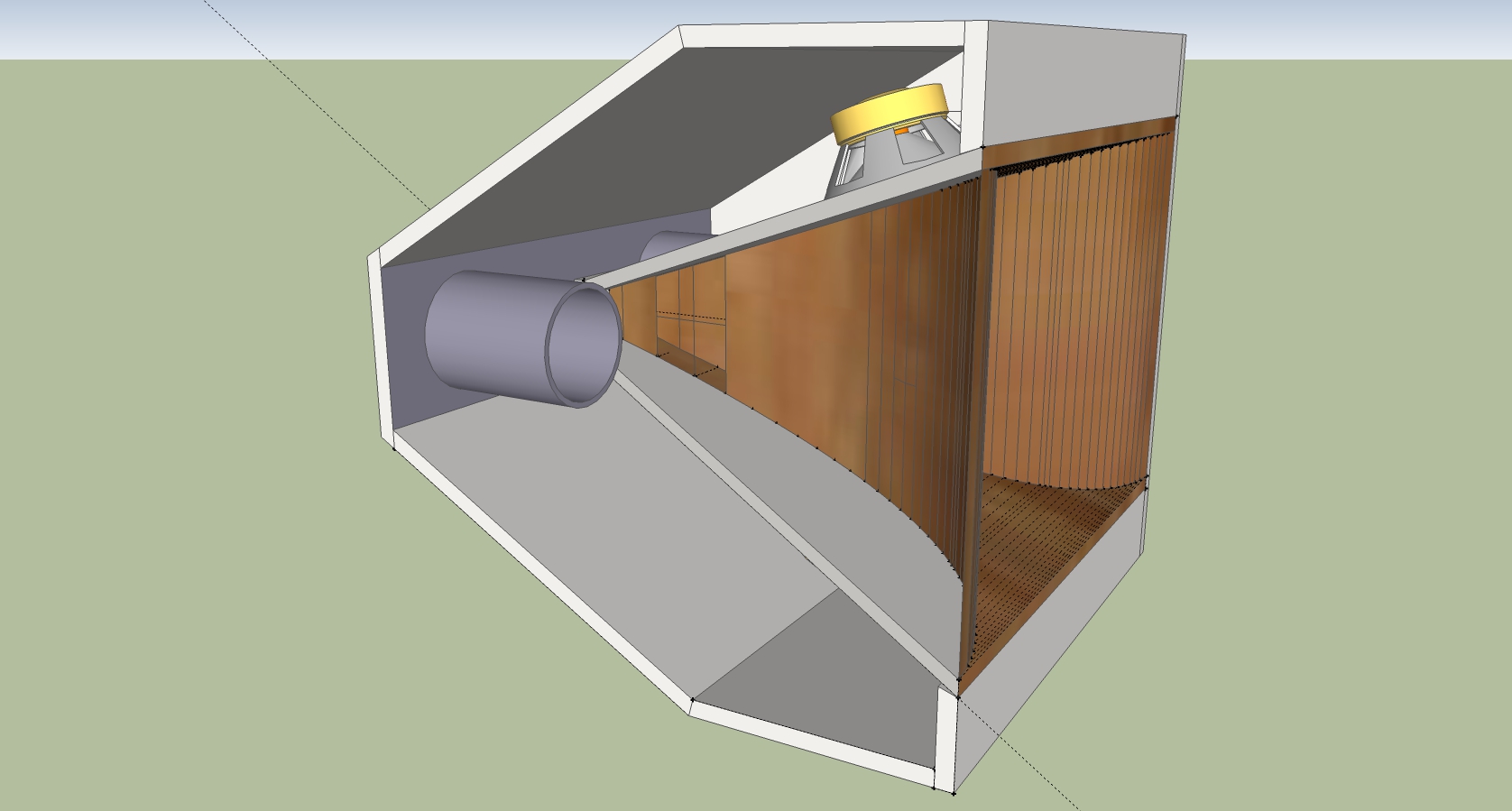

Mine horn has get some big and if I read here some things, I can make it much smaller?. now the opening and depth is 42 x 52 x 48 deep. I think half can be removed.

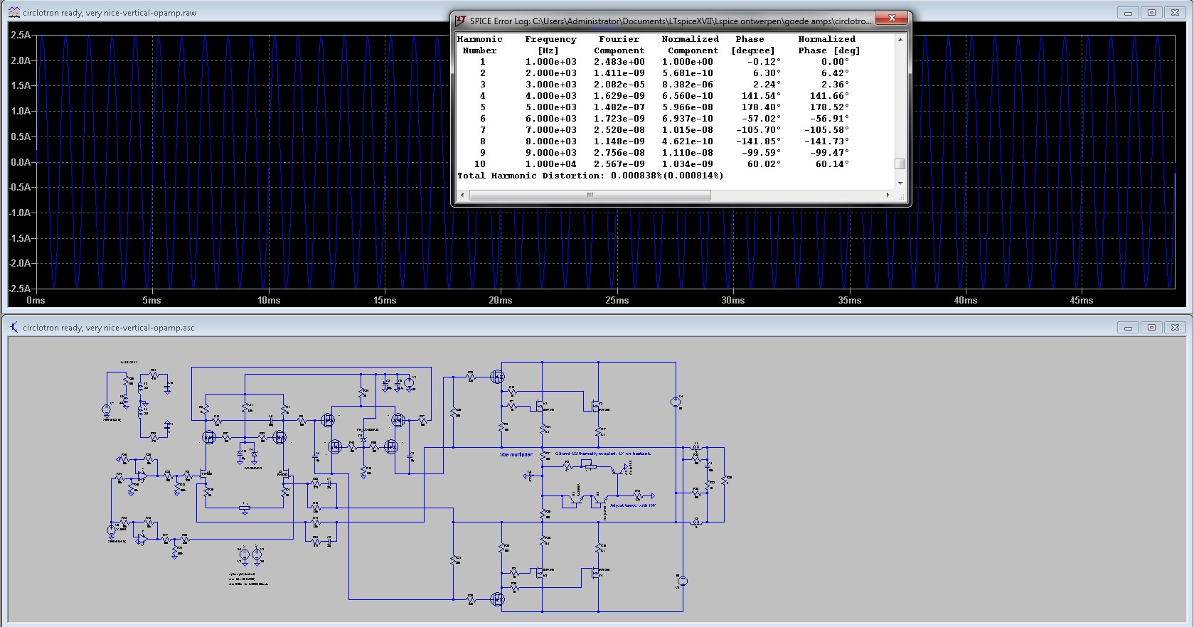

And the circlotron is started again, with verticals, distortion with them is in class a -100dB.
