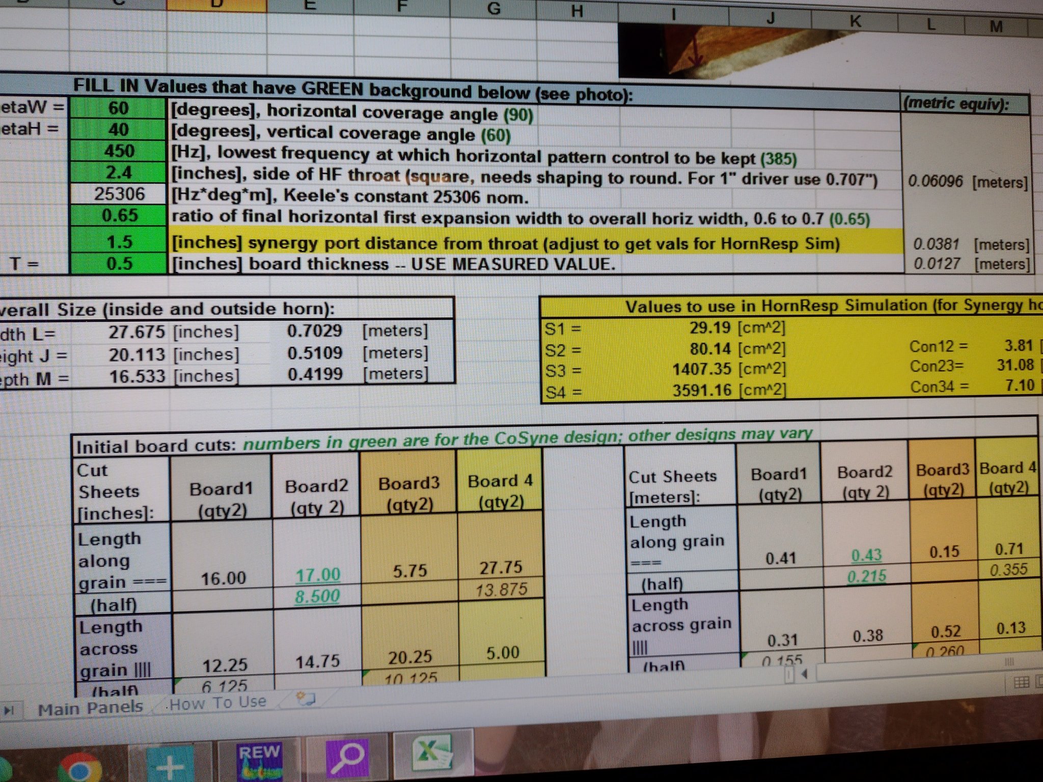

Lots of questions here. Thanks for your interest but I think you need to spend some more time reading (scanning) at least the first 30 pages to get much of what you are asking.
It is a FAST based speaker design where a full range driver is used as the tweeter. A lower crossover frequency is employed and this allows the main band for vocals and most instruments to one driver. The woofer supplements this below say 600Hz. This gives more coherence and better spatial imaging. Look in Fullrange Forum for FAST or WAW type speakers.
What’s the difference compared to CD’s? I personally don’t like the harsh sound of a CD. They sometimes have an edge to them and they like to be crossed rather high. This requires the mid injection ports to be placed close to the throat. And requires mids and woofer if you want output below 600Hz. Then it becomes a 3 way. Although some designs manage a CD with a woofer closer the throat like SynTrippi by Weltersys.
Bushmeister and myself used different waveguides as we had different ones readily available to us. They both can work well.
Why do holes not affect the waveguide? They do and it’s a trade off on how big you can make the holes.
How to get drivers to mount to curved walls? That’s in the first few pages of the thread. Use 3D printed adapter or lots of Bondo.
How to get the throat to be smooth? Lots of work and trial and error. I made at least 3 printed throat adapters and Bushmeister used Bondo contoured adapters.

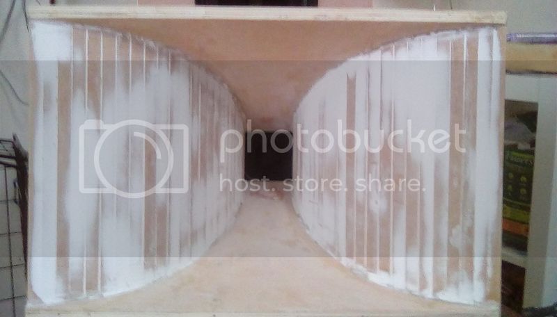

Horn I just made was the first section of this, if it works out I'll make the second flare.

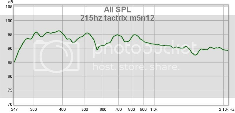

I did make a tactrix to load a 5mn12-80, something like 24 X 12 X 15 off the top of my head, I'll try and find a link. Results didn't fit my desired use, not sure the driver worked out as well as the hype.
I like the idea of conical 2/3 of the length then tactrix, isn't the 402 reputed to be something along those lines?
Wish I'd tried it to 20k and the idea of using DSP to boost the top flat hadn't occurred to me till reading this thread, probably because I got interested in horns as a result of messing with smaller tube/valve amps.

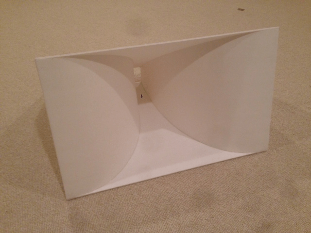

Well its been about twelve months since the last post here so I thought I would give it a bump.
Thanks firstly to everybody who has contibuted here, I have started my second read through!
Secondly, Its harder to find or scource DIY gear over in Aus, especially at a reasonable price, but I did manage to find a decent looking CD horn locally and decided to grab two and begin the learning curve. Also grabbed the SB65's from the same shop.

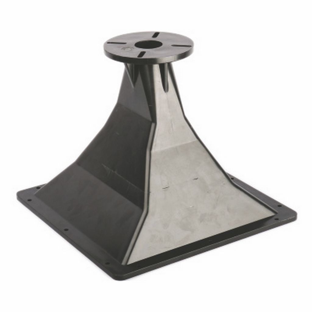

https://www.wagneronline.com.au/sb-...audio-speakers-pa/horn-h280-92853/1002105/pd/
This seemed like an easy starter horn too, with the semi flat sides and low enough cost to not mind destroying one or two.

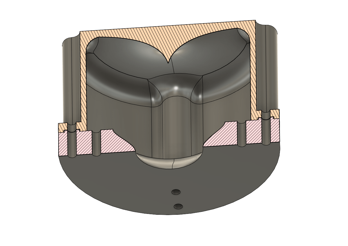

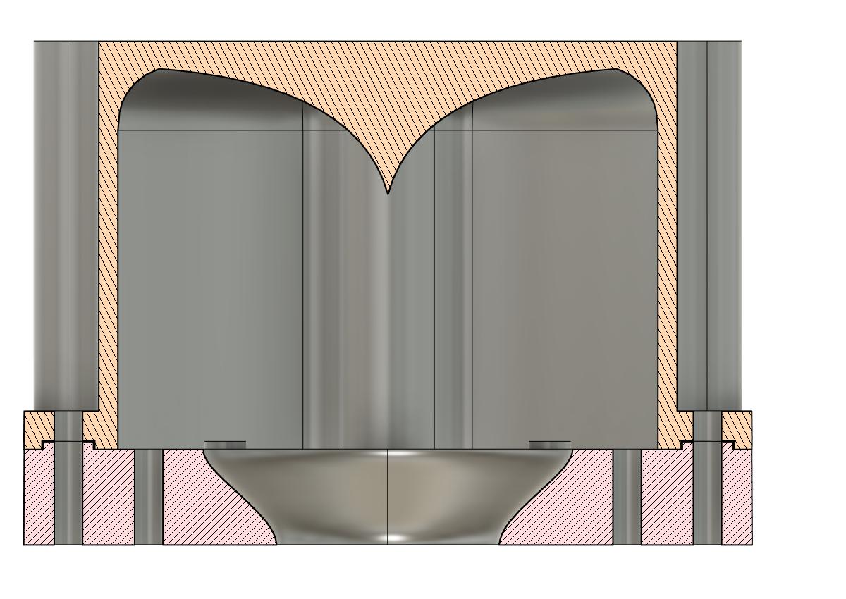

Then took some inspiration from XRK's adaptors to model this 15mm deep unit in fusion and 3d print a test unit.
The driver entry mount is 1mm bigger that the outside of the drivers surround and follows a directional loft down to the 35mm horn entry.
Printed with PLA+ and sanded to a smooth (+/- 0.1mm) transition with the horn.
I added more bolting points so the adaptor can be exactly aligned with the horn throat, bolten down, then the driver is screwed on, then the back chamber is bolted on. Also the alignment lugs between sections helps all the parts sit in the correct positions.
Printing went well and before I knew it I had a horn to test!

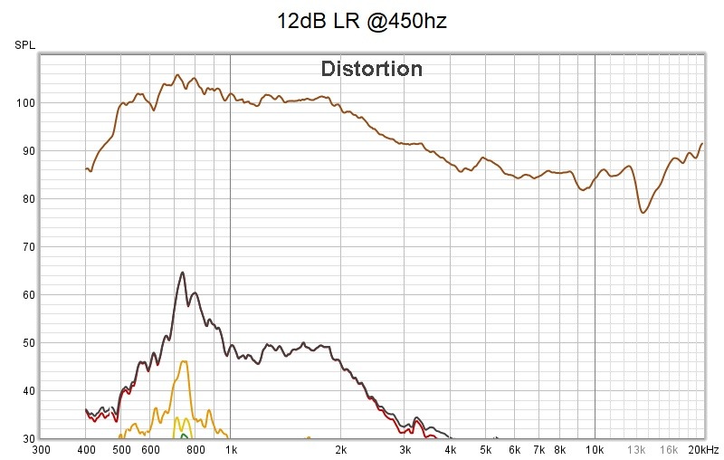

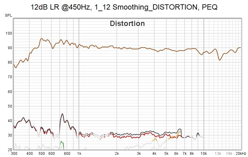

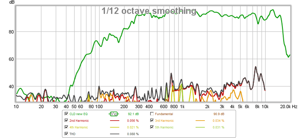

Im not great at testing yet and background noise was terrible so I just cranked it, using calibrated umik1 @ 1m on axis. First is just with xover, second with 10mins of minidsp PEQ play.
Sound test after EQ was decent but its hard to tell with no bass.
Next is do some better measurments including off axis and start work on the woofer section.
