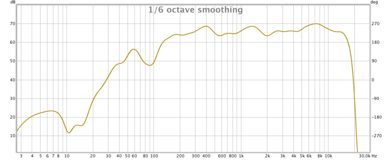

I really only measure at the listening position. I haven't even once done a near field measurement. The above plot is gated in REW using it's recently added frequency dependant windowing, at 4 cycles. (available if you click on IR Windows)

Since REW introduced a frequency dependent windowing feature, I've been wanting to see what kind of correction results I could get compared to DRC. After generating minimum phase versions of my impulse responses (this involves exporting and importing), I applied a 1/6th octave (4.3 cycles) freq dependent window and used the auto eq to invert the response. I saved the filters' impulse responses as a stereo wav file to be used for convolved playback.
The results are very good! I have only been able to listen for about an hour so far, but the imaging is solid and precise, and the stage is wide and deep. Tone quality is excellent. The final corrected impulse responses don't look quite as pretty as what I get with DRC though, because no attempt is being made to eq the excess phase response. I tried once to use DRC to correct only min phase but I don't remember it sounding as good as this (I'll have to do it again and compare). I think this filter will stay in my chain for a while...

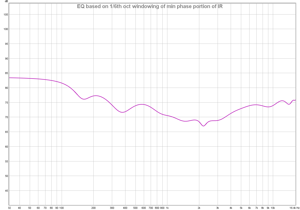

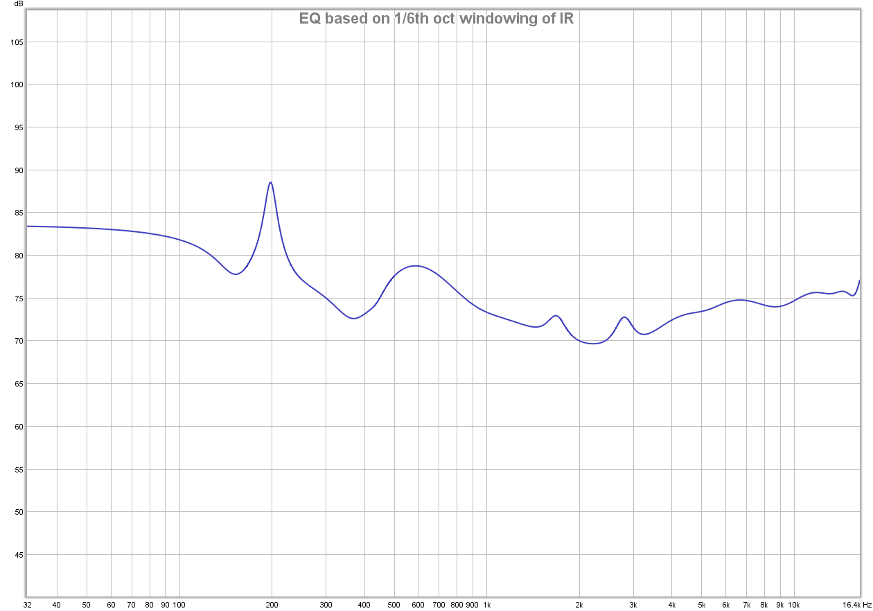

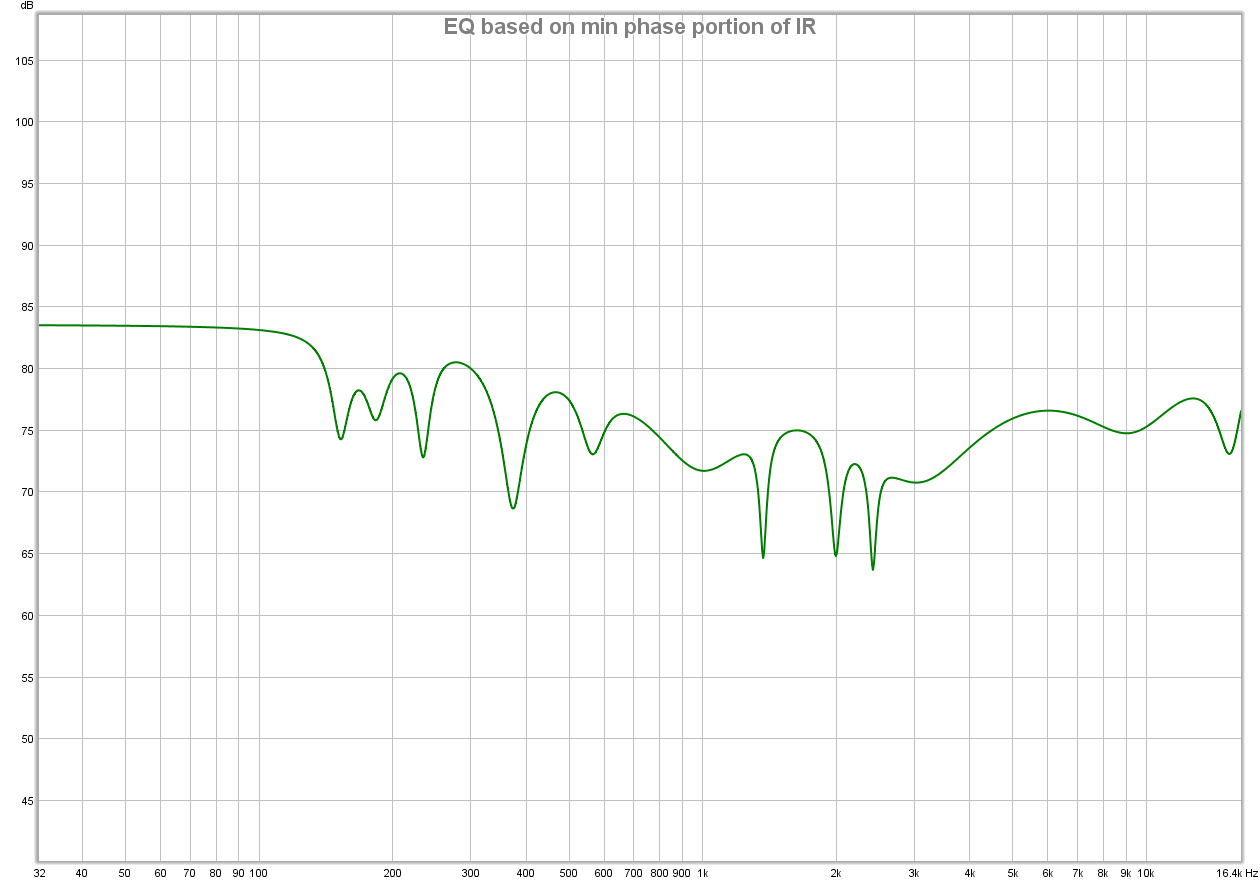

Here are 4 possible eq curves for my left speaker based on the impulse response as measured from the listening position; the titles of the graphs will hopefully explain the differences. This was done with REW using the min phase extraction feature, IR windowing function, and the auto EQ. I am currently enjoying the results I get with the EQ based on the 1/6th octave windowing of the min phase portion of the IR, and this is what I would recommend as of now (at least as a starting point) for someone who would like to try using REW exclusively for EQ/convolution based correction.

I don't think you can export a windowed response per say, but what I do is:
-export the min phase portion of the IR (Controls - Generate Minimum Phase - File - Export - Impulse Response as WAV (check "Export Min Phase Version of IR"))
-open the min phase versions with REW and apply a 1/6th oct frequency dependent window (IR Windows - (check "Add frequency dependent window", and specify "Width in octaves" to be 1/6th) Apply Windows To All)
This is now the response to be eq'd. BTW, I have since discovered that I can get a bit more aggresive with the windowing here than I was comfortable with while using DRC. I tried 1/12th oct (8.7 cycles) windowing very briefly and it still sounded pretty good off-axis with a noticeably improved final impulse response.

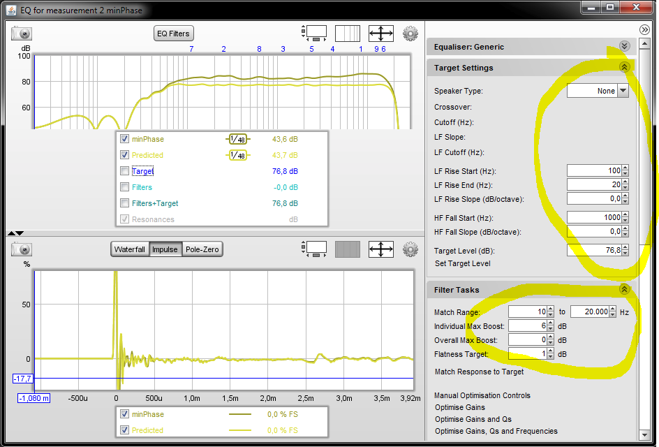

Ok, I think I got all the steps down up to this.

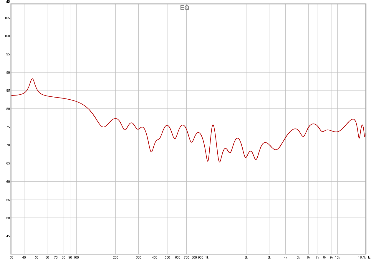

How do I save an Impulse response from the EQ window, the one with the filters applied?
Also, even if I specified a 12db slope at 40Hz, REW doesn't give me any filters under 300Hz. Peculiar.
Perused the REWHelp file but couldn't find anything on both.
.....How do I save an Impulse response from the EQ window, the one with the filters applied?.....
Picture 1.
.....Also, even if I specified a 12db slope at 40Hz, REW doesn't give me any filters under 300Hz. Peculiar.
Picture 2.

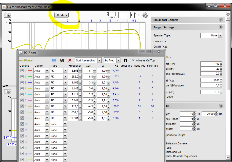

Also instead of creating EQ's as IR you can manual set filters in JRiver, data for those auto created filters is presented when push button "EQ Filters".

It sounds like you want to save the predicted corrected response as an impulse response? It doesn't seem like this can be done; what I have done is just convolve the original IR with the newly saved filter IR using foobar2000's "Convert" option.

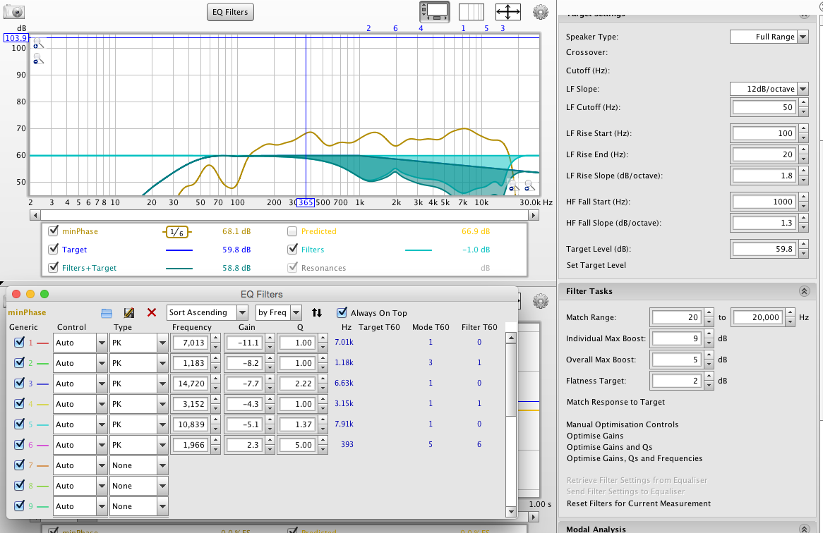

It looks like your target level is too high - drop it down a few db. Looking left to right at the freq response in the EQ window (with the "target response" box checked), REW won't attempt to correct the response until it goes above the target line. This is to prevent over-correction in the freq domain (like peak limiting in DRC). For a starting point, hit "Set Target Level" from the Target Settings" menu (sometimes I have to do this twice), and for a single driver with no compensation network I have found the need to lower it from here manually.

oops, I was looking at the pictures posted by BYRTT and I thought they were yours, perceval, that's why I wrote about target level (although this may still apply to you if REW is ignoring the response below 300hz).
Anyway, as BYRTT has pointed out, the impulse response of the filters is not generated from the EQ window; from the main window, select "File" - "Export" - "Filters Impulse Response as WAV". Do this once you're happy with the predicted response of both left and right channels and then save as a stereo wav which will serve as your correction filter.
