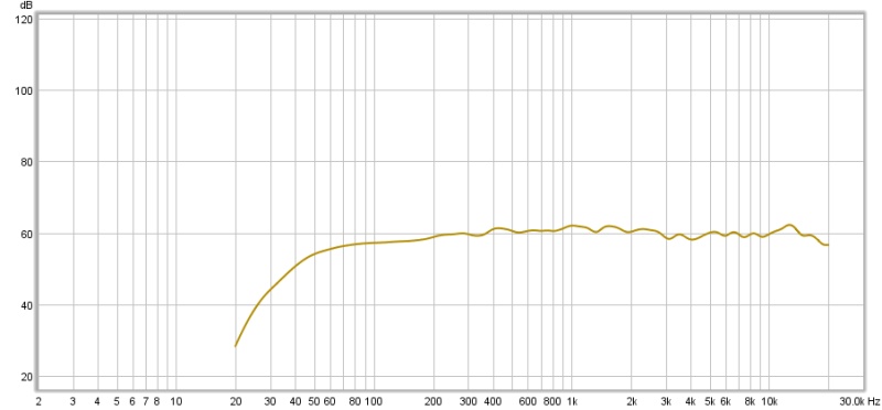

Well, it's not always peachy...
I just lost 2 hours getting a flattish sweep in my awful room.
I started with getting the speakers flat, for fun, which was easy. Mic at 30cm from the W8-1772. Then, did a sweep at the listening position. As expected, it was all over the place, and not just lower freq.
So, onto getting the listening position as flat as possible... until I got to the graph below.
Then, I applied DRC and... well... not a success this time.
For some reason, DRC split my not too awful impulse (which was centered L/R) into 2 main peaks. It wasn't a pleasurable listening experience.
Food for thoughts for another day, this week's window of testing availability is gone.
Hi Perceval,
So far what has worked in your room has been corrected by gmad in regards to timing. gmad hand picked the initial peak and let DRC work with that.
If you don't align, or tell DRC where the peak is, it will assume it's at 1 second or 44100 cycles. When recording an impulse in REW that usually fits as REW tries to find the main peak and it will be at 1 second on a REW export.
