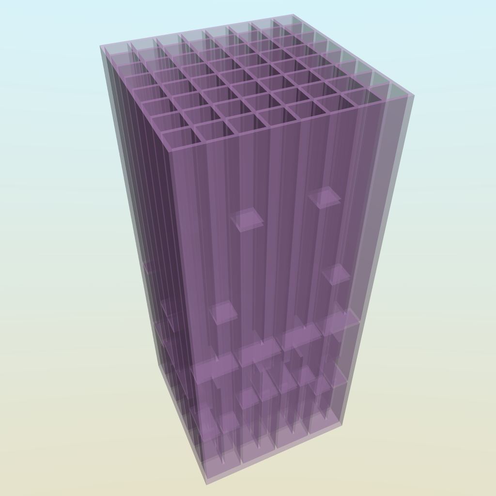

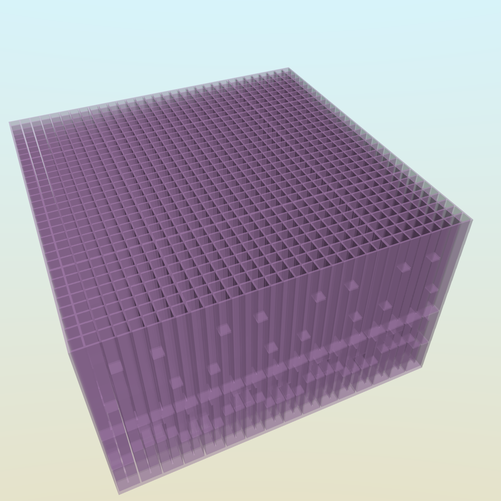

I worked up another broadband metamaterial, this one is based on Fabry-Perot channels in a lattice tuned to the quarter wave length. http://sheng.people.ust.hk/wp-content/uploads/2017/08/optimal-sound-absorbing.pdf
It didn't have fully defined dimensions so I had to get creative on my own. Ended up with better packing than in the literature example though. Channels are 20, 32, 44, 56, 68, 80, 92, 104, 116, 128, 140, 116, 128, 140, 152, 164, 176, 188, and 200 mm respectively in each 16 unit cell. Should be effective from 440Hz up to 4400Hz. It is designed to have a 3mm of sponge/felt/poly in front of it to reduce banding. It would be mounted on the back wall.
It will take some serious print time, 13 hours for 1 cell and 10 days for a full build plate of 4x4 cells. Again they have 0.8mm walls, so just 2 passes of filament. Gave a little extra on the floor for mounting and elephants foot control.
I think this should be a very effective one, just maybe not as easy for everyone to make, looking at a print service like shapeways the 4x4 is $1k. It is however only 125g of filament, so if your 3d printer is reliable you can have it for a couple dollars. Personally I would print one 13 hour cell at a time so I wouldn't have something go wrong on day 9 of the print.
Going to test print a few of these and see how well they hold up. Honestly I would try the other one first, with 2 days of print time you get a full 200x200mm layer instead of 10 days.
