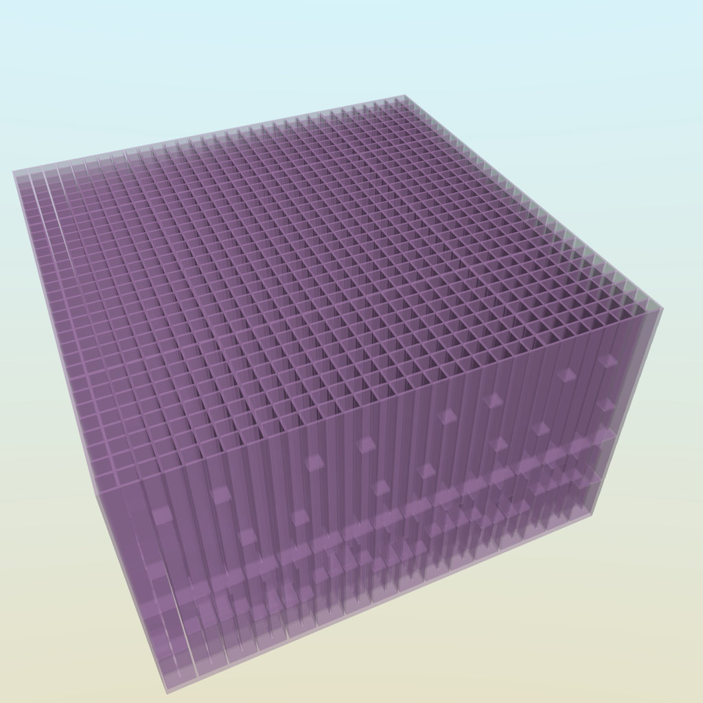

878739d1601103615-monster-construction-methods-shootout-thread-fabryperotmetamaterial_002-png
These are 1/4-wave open ended waveguides. We usually call them tuned 1/4-wave stubs. A Fabry Perot resonator is a flat-flat parallel (closed) resonator. Two parallel speaker walls would be closer to that.
But I often use these on a large scale to absorb a nasty resonance in a TL or horn loudspeaker. If the simulation in Akabak shows a peak that you can’t get rid of otherwise, I would design a thin channel of appropriate length (typically in the 15in to 30in range depending on frequency) about 1in tall and width of speaker. Stuff it progressively with fiberglass or other material. It really can knock a peak down by -6dB to -12dB. You can see this done using a 4in dia PVC pipe inside one of Danley’s tapped horn subs.
Finely printed material like this would be for very high frequencies like in a mid range or tweeter. And I have found tapered Dagger (tall 3 or 5 sided pyramid or even a round cone) rear chambers progressively stuffed to be quite effective at being an acoustic black hole for rear radiation.

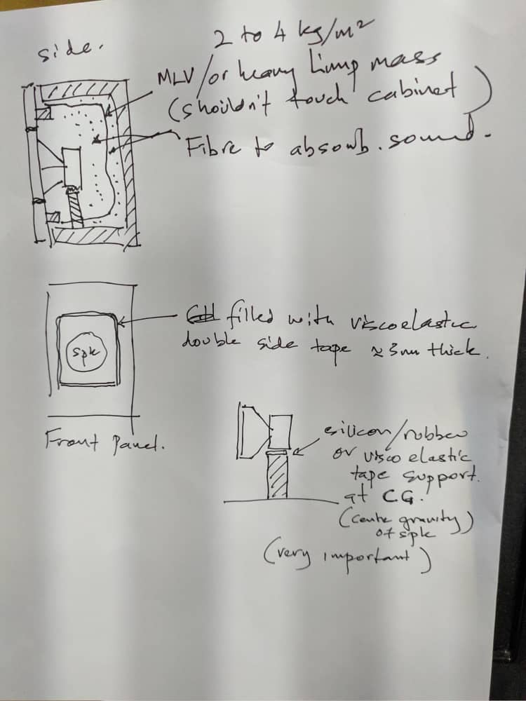

Hi Augerpro love all your testings, but from the results obtain let me suggest working on decoupling the speaker or the front baffles with speaker from the main box. The decoupling can be done using a viscouselastic material like polyurethane arclyic adhesive. This will greatly reduced the transmission from the speaker to the cabinet above a certain frequency . CLD is effective to damp down the peaks of resonance and is temperature, thickness and material dependent for maximum effectiveness. To reduce the tranmission of airborne sound from the speaker backwave just use nornal dampers materials and add another layers of MLV or heavy Limp mass material decoupled from the main cabinet with polyester fibres etc . The MLV have to fully enclosed the interior but not touching the cabinet. It should be suspended by about an inch of damping fibres and terminated at the edge with butyl rubber.
This I think will work well from 300 to 5k hz ( midrange ). Woofer I just think making it as rigid as possible with multiple brace to push resonance above 600 to 1k hz will be fine.
I will probably be starting a new speaker built using a Kef 5 in driver from 250 hz to 20k hz using this decoupling method. Will update here if I completes the box. Cheers
I am curious on how you decouple the speaker driver from the speaker box. Can you describe in a little bit more detail.
Thanks.
Oon
hi Onn, here is a rough sketch. I will probably not bother too much about cabinet resonace as the main coloration culprit is actually the backwave sound not absorb that gets emitted out the speaker cone . If you can fully disipate all the backwave then you will hv remove 80 to 90% of the stray sound. The box probably contributes about 10 to 20% of this. Its the first box resonace that you hv to be careful. A reasonable stiff box with a decoupled MLV or limp mass bitumen sheet that hv their resonance frequency below 100hz will be very effective in blocking the sound transmission to the cabinet. All this is good to about 200hz
The skectch is effective probably for 200hz n above.

augerpro, when you are done testing boxes this way it would be very cool to see worst and best deemed enclosure far field measurements (as normal loudspeaker, without the back chamber box) if the difference is seen there. Also if there is difference to your ear. Kind of simulating real world living room scenario if the difference is meaningful or not. Better yet, if you detect a difference, try to find out which is the most practical construction method that yields sufficient results in this regard. Thanks!
Subjective impressions would be a LONG time from now, for the simple reason that when my testing here results in some good techniques, I will be building a family of speakers using my waveguides and SB & Bliesma drivers. That is whole monster project in itself and won't be done this winter.
I like your thinking lcwin. Also looking at the test results, from all the well performed test here the differences are not that significant I think.
What is tricky here is also to determine and understand how much the box is actually contributing, compared to the driver output. Is it like 30-40 db lower?
To determine this you should make a big soundproof box with a hole, then place the speaker box to be tested on top playing into the soundproof box. This way you would be able to measure the backside/side output by it self, which could then be compared to the sound of the total speaker. Not an easy job, but I think necessary to split contributions.
On the other hand you could probably also just focus on the forward sound in all the test.
If the speaker plays in a normal room (should be the exact same placement in all test) you would measure the combined result, and would be able to see if there are any significant differences in the overall output. I would do distortion and freq.
From all these good test already done, I would also put my bet on minimizing the backwave.
My 2 cent
Baldin> You keep bringing up driver contribution and I've answered it several times, but you still seem confused. What you are suggesting is essentially what I have already done. Please re-read my answers or simply look at the first couple pictures at my website. There is no driver radiating outside of the box!
lcwin> have you tested this limp mass thing before? I'm skeptical that a solid sheet of anything just suspended there by fill material would really do anything? It would probably change the internal reflections of high frequencies of course, just as any solid object would, but I'm not seeing how it would absorb energy better than say, being fully stuffed with fiber material?
