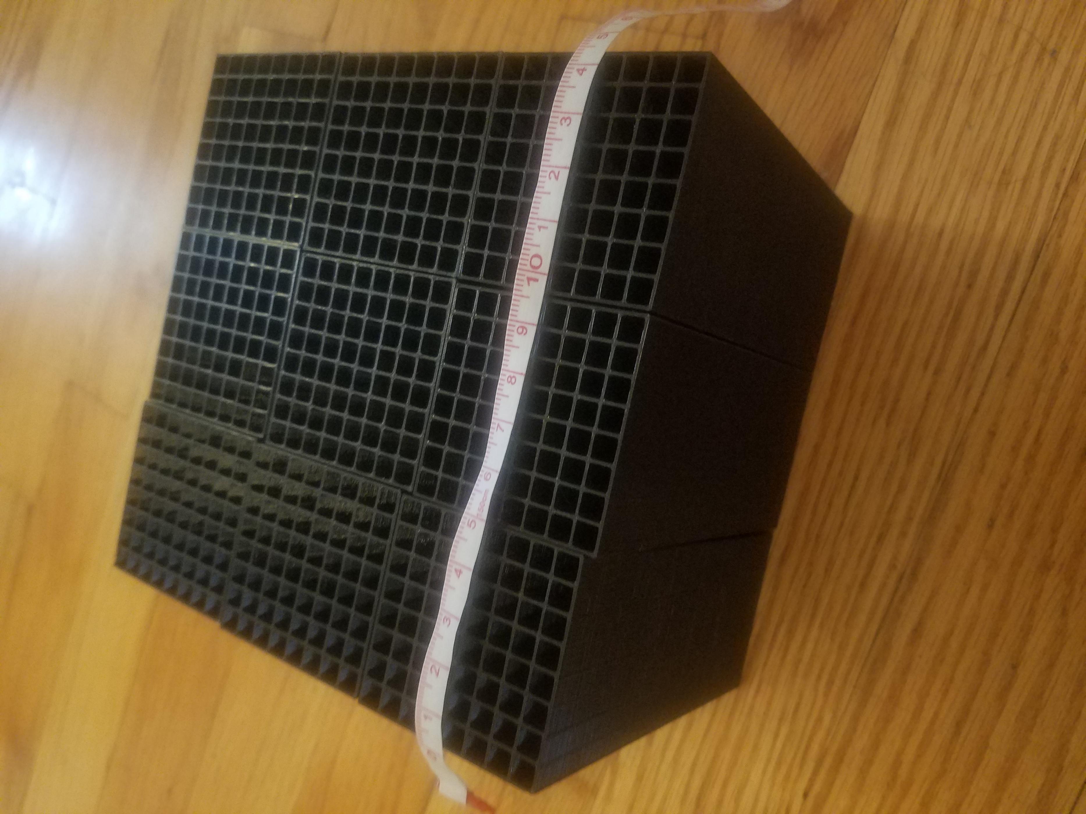

If you want to test out a meta material I have a pretty good chunk of the stuff printed. 140x140x112mm effective from 400-4kHz. Let me know and I could send it on.
Pretty curious how it would sound behind a 5in midrange. Not sure given how much time (150+ hours) went into printing these it would be better than a progressively stuffed dagger/pyramid enclosure.
