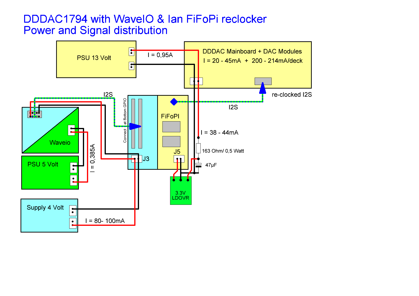

So here is an example how I connected the Waveio with the DDDAC and the FiFoPi….
As said the 4 Volt is NOT critical. I would say, anything between 3.6 and 4.8 Volt will work - hence I went kind of in between …
Alternatively you can feed the Waveio Isolator and FiFoPi digital side with separate supplies of course. Key thing is to keep the Waveio Isolator < 4.8 Volt. FiFoPi will work fine with anything between 3 and 5 volt, but to keep the 3.3V on-board LDO work well, I suggest to keep it > 3.6V

I did not say it was an extra power supply…. I wrote a 4 Volt regulator (I use a LDO for that) which is fed by an existing 12 Volt power supply (not the one for the DAC, as that one needs to stay at the isolated side of the FiFoPi
oh, edit: … Not sure what voltage you want to drop FROM, but you should not only use a resistor to drop voltage to 4 volt, as that is depending on actual current draw, specially at startup where there is little to no current drawn by the FiFoPi and also as depending on music FS the current varies. Best is to regulate the supply voltage for the FiFoPi and Waveio. If you need a drop resistor to use a LDO, well fine, but you need to take into account maximum current draw…

So must of us have 12v for the main dac and 5v for waveio meaning we will need a third psu to generate the 4v considering isolation needs

2) So must of us have 12v for the main dac and 5v for waveio meaning we will need a third psu to generate the 4v considering isolation needs
3) Which LDO do you use?
1) well, you ARE adding a device (FiFoPi) and this device has an isolating function. If you power it with the 12 Volt dac supply you defeat the isolation from the FiFoPi and … if you use the 5 Volt power supply from the Waveio you will be putting the WaveIO I2s signals now to refer to the ground, which is the the same as the USB shield, connecting it to your complete domestic Earth.... This is why there is also isolation at the Waveio to start with. So with the FiFoPi you have a third-signal-section which you want isolated from the USB bus AND from the DAC - and here comes your third power supply and the reasons behind
2) yes and the reason is 1)
3) LDOVR
the good news is, you only need like 100mA.... that can be a small linear supply - I see no direct need for HIGH END stuff at this place (as the re clocker comes after it anyway)
1) well, you ARE adding a device (FiFoPi) and this device has an isolating function. If you power it with the 12 Volt dac supply you defeat the isolation from the FiFoPi and … if you use the 5 Volt power supply from the Waveio you will be putting the WaveIO I2s signals now to refer to the ground, which is the the same as the USB shield, connecting it to your complete domestic Earth.... This is why there is also isolation at the Waveio to start with. So with the FiFoPi you have a third-signal-section which you want isolated from the USB bus AND from the DAC - and here comes your third power supply and the reasons behind(hence I chose 3 colors in my overview, that was not just for fun or good looks)
3) LDOVR

Doede, if it's not too much trouble, what are the current draws of the WaveIO digital and isolator? Thank you!
Waveio 385mA
Isolator max 10mA
It’s best to separate power between BBB and FifoPi isolated side (J5)
You can try to power BBB via J3, but then you will need another psu for FifoPi’s isolated side J5. Take a look at the schematic from Doede on the previous page. This schematic include the WaveIo, but imagine this is your BBB and not WaveIo.
