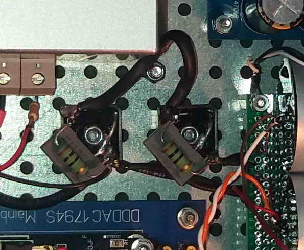

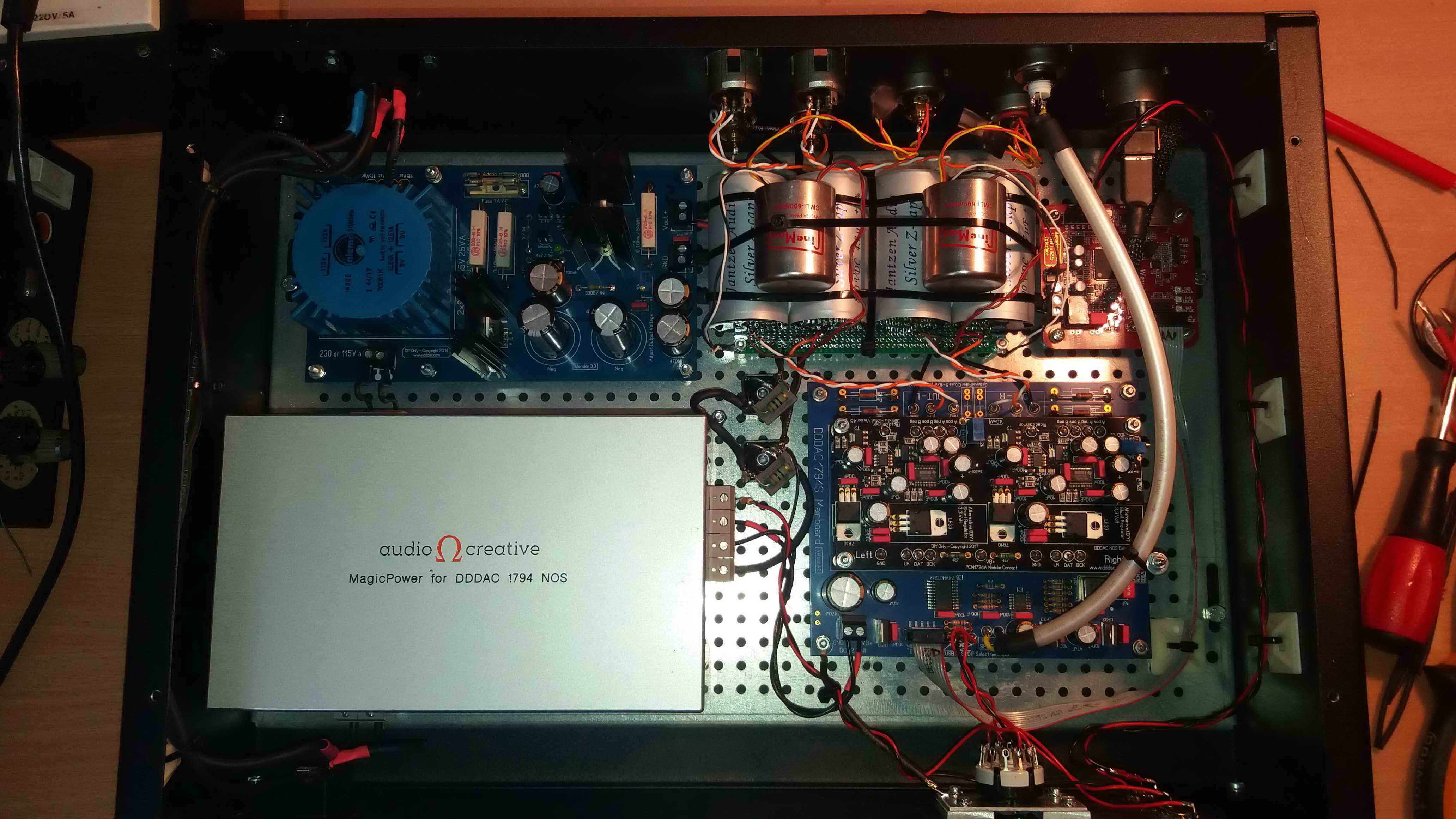

Inspired by Doede. I installed one Lundahl 1694 choke on each 5v psu’s, which is feeding two 5v Ultra capacitor boards connected in series to get 10v for dddac mainboard with 4 dac boards.
After the pic been taken, I replaced the two 4700uf caps with two 10000uf Mundorf Mlytic caps. I don’t have any instrument to measure the psu’s, but I like what I hear.
I decided to leave the 7810 regulators on the DAC boards alone, so I need 12 VDC. Otherwise the ultra cap boards might have been interesting.

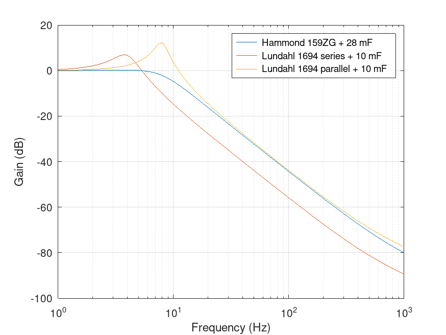

I looked at the Lundahl 1694. I don't know if you connected the windings in series or in parallel. For my purposes, I'd have to use the parallel connection (40 mH), while the series connection (160 mH) would have too much DCR and would saturate the core. I calculated the filter function for the Lundahl + 10'000 uF and compared it with 15 mH Hammond 159ZG + 28'000 uF. The Lundahl will tend to ring, whereas the Hammond seems to behave a bit better.
Hi Matthias,
Thanks for your contributions
on the oscillations and peak versus choke inductance. Point is in the simulation you also need to take the Load into account. With lower load there is higher oscillation... With high load (like 1A) it is dampened like in my graph.
Not sure how you arrived at your graphs? So I cannot judge what you did (what load for example?)
now the good news, as the power supply has a soft start anyway, this oscillation will not really show using the 1H for example, also at no load...
I tried and 10H has a bit hectic start but after 5~10 secs all is fine

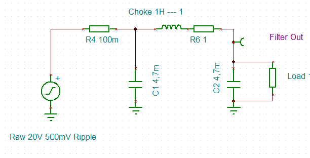

I calculated my curves by looking at the AC voltages across the choke and the second capacitor in the CLC filter. The gain function of this LC part is the ratio of the AC ouput voltage across the C and the input voltage across L+C. The impedances of L and C are calculated following the good old schoolbook / Wikipedia formulae for L and C (and I added ESR for the cap, but that has virtually no effect at those low frequencies). I can post the GNU Octave (Matlab) code if anyone is interested.
I don't understand how the DC bias (=load current) would change the AC operation of the circuit. As long as the DC current does not saturate the core of the choke, the choke will work the same with and without a DC bias. The capacitor will not pass any DC anyway.
I agree that the low frequency ringing should not be "excited" at power on, but I still think the life of the regulator is better if it does not have pre-filter that tends to ring/oscillate if it's asked to do so.

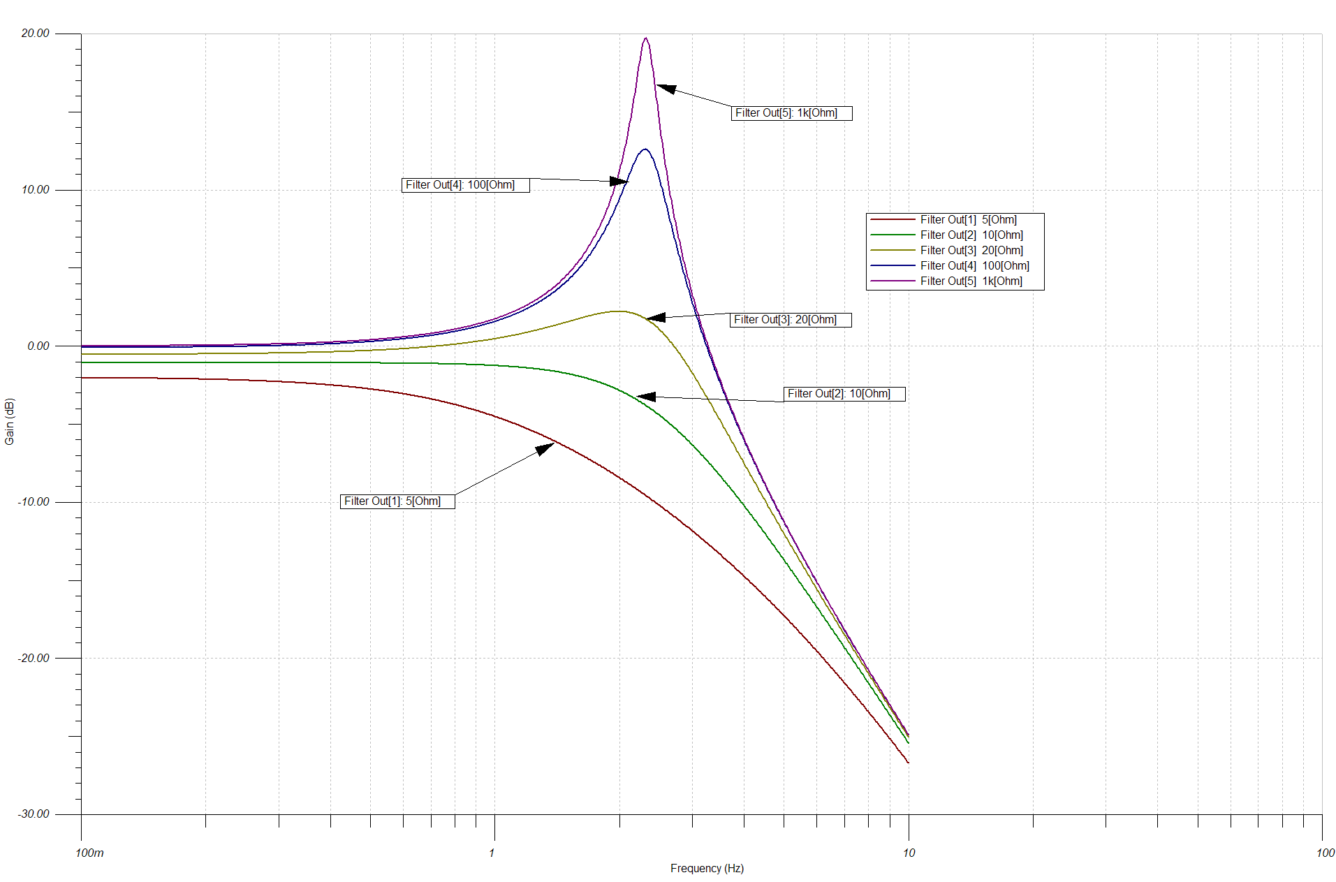

Trust me, the load has impact:
Circuit:
first
RC:
0,1 Ohm
4700uF
then LRC:
Inductor 1H
R 1 Ohm
C 4700
I ran 5 plots for 5,10,20,100, 1000 Ohm load:

Ok, now I understand why we get different results. Your schematic shows a load resistor in the output, probably used as a dummy load to get some current flow at the CLC output. This dummy resistor adds additional damping to the circuit.
There is no such dummy resistor in my analysis, so all the damping is left to the DCR of the choke.
The thing with SPICE is that it seems to stop my brain from thinking how a circuit really works. In this case, my brain is not sure which approach is better (with / without the dummy resistor). In the real-world application, your dummy resistor gets replaced with the PSU regulator. This means that the regulator would take resistors job to provide some extra damping to the CLC circuit.
However, I tend to believe that it would be better not to stress the regulator with this job.
P.S.: could you run your simulation with a CCS instead of a resistive load?

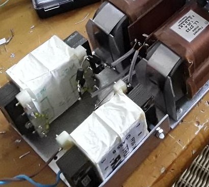

Hello,
I am having VERY good results with using split bobbin transformers available at Mouser.
I have met several people who told me to use these in stead of the usual toriodal ones which seem to pass much more garbage from the '' power station '' into your sensible circuits.
Getting a choke with more mH and a bit more DCR combined with the right transformer will give lots of improvements. I think the cleaner the supply entering the original supply will be the better.

Hammond 229 series ?Hello,
Hello,
I have used both Hammond and Triad.
Usually i made my choice depending on VA rating, circuit mounting or chassis mounting.
The chassis mounting types are easier to use you can solder the diodes directly to the terminals. Much easier to create airflow than circuit mounting.
I ALWAYS use choke input so then it will be easy As you can see in the picture short connection for a DC heater supply circuit ( Rod Coleman UK based) Here circuitboard Triad mounted onto the chassis which is ok but a bit hard to realize)
