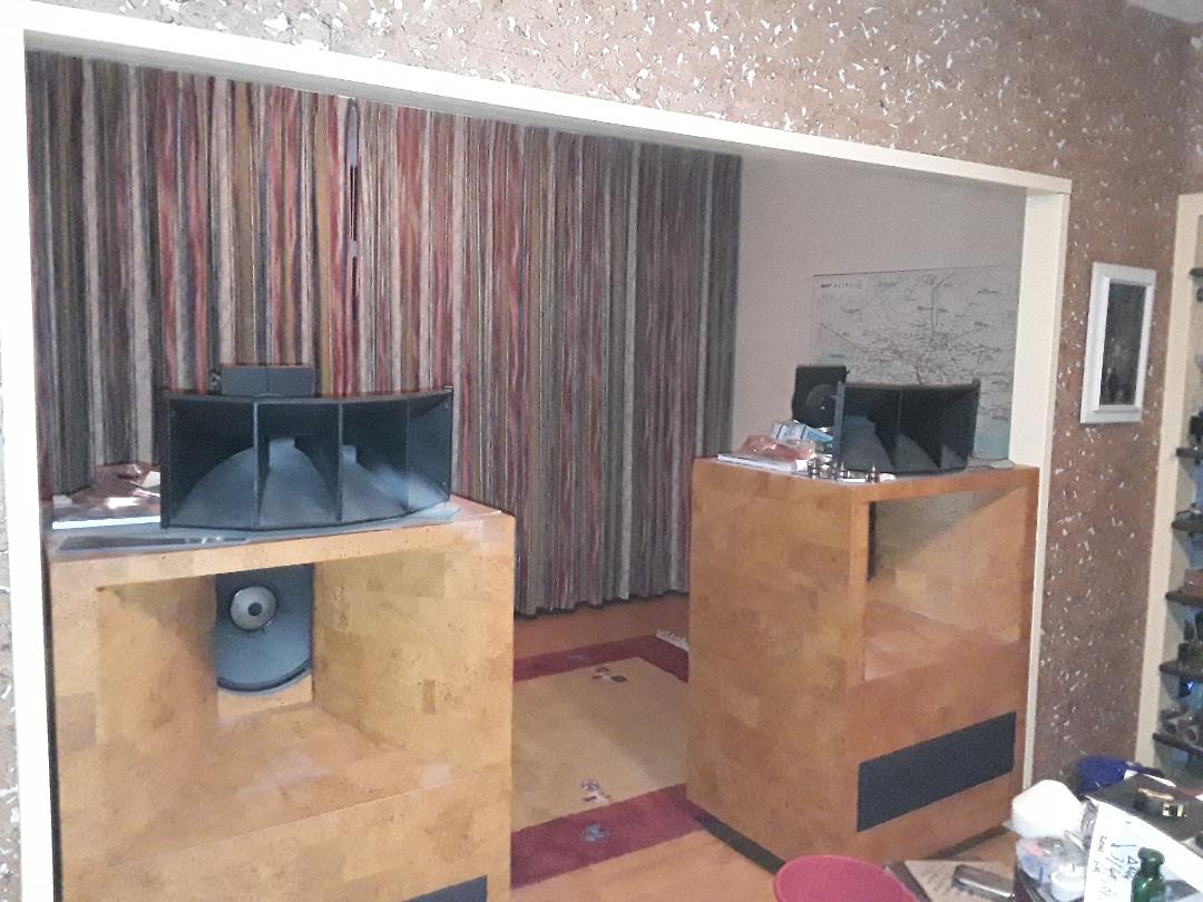

Doede is thinking we all have some kind of diy man cave with nice equipment all over the place.
Probably most of us have a limited use of the kitchen because there the light is ok. Most of us also lack the knowledge so we say better be safe than sorry. If Doede tells us how to do , just then we are sure.
When i bought my house i put my speakers in the corners so visitors wouldnt notice them so easily. A month ago i had new windowns installed, replaced wallpaper by cork tiles and after that i told myself what the heck why spend so much on diy while not putting my satellite speakers in a better spot. No investment made and after all it is my living room.
Greetings, Eduard
