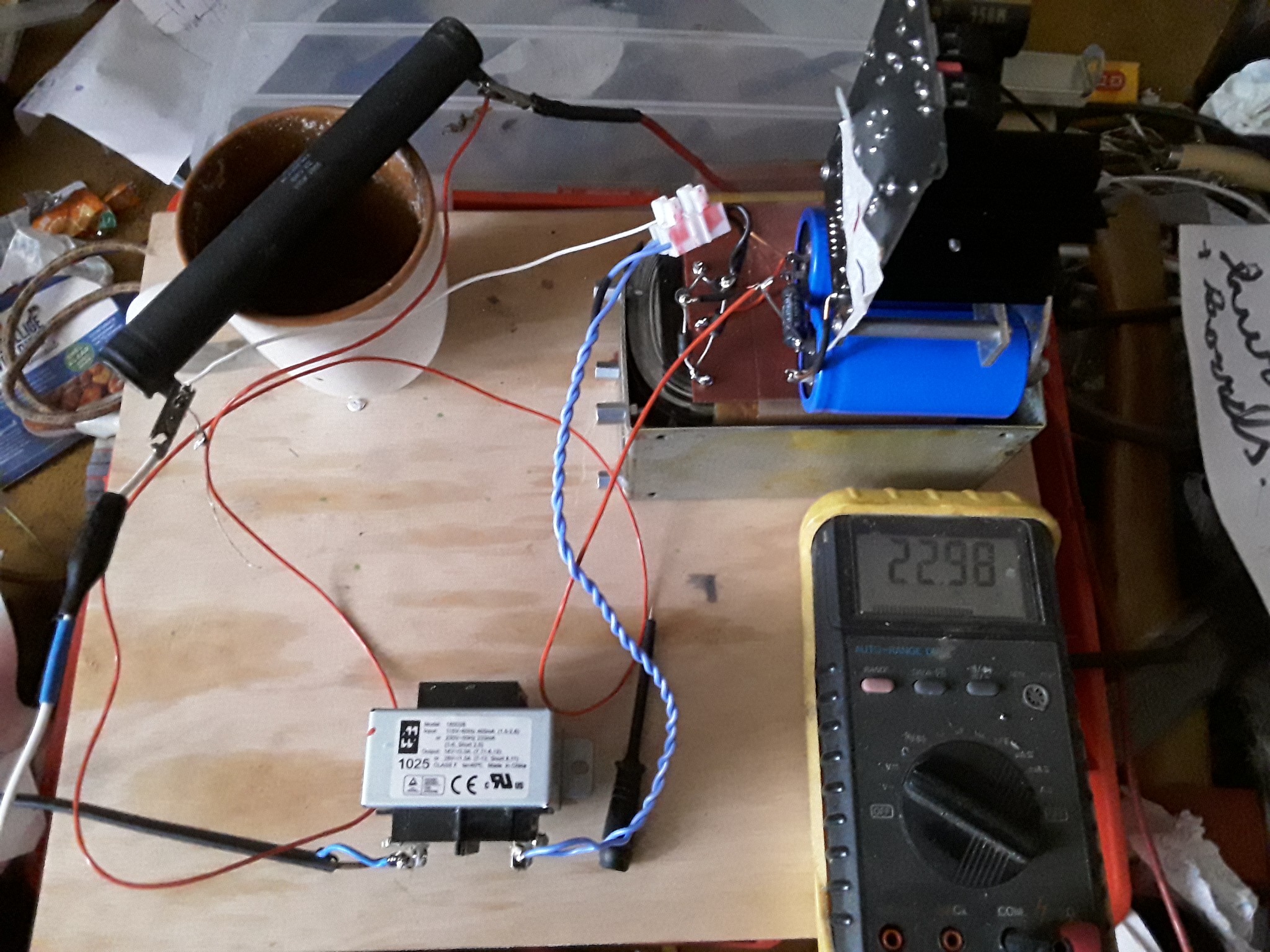

Like Doede answered a few weeks ago if something like this happens and you dont understand how it works just replace the 4 transistors( Doede told me that the one mounted on the heatsink can take some abuse) and i would replace the two leds as well. IF you did not reverse the polarity of the power supply and if you did not use to the caps with to much voltage the caps probably will be ok.
In the attachment you can see the power supply using choke input and a special edition of Doede's power supply to feed Andrea's clock circuit with Eaton ultracap after preloading it with a Chinese charger. As you can see i pay more attention to the choke than to the power transformer..
The voltage shown as the input voltage for Doede's circuit which will give 15,7 volts to the ultracap.
Greetings, eduard
