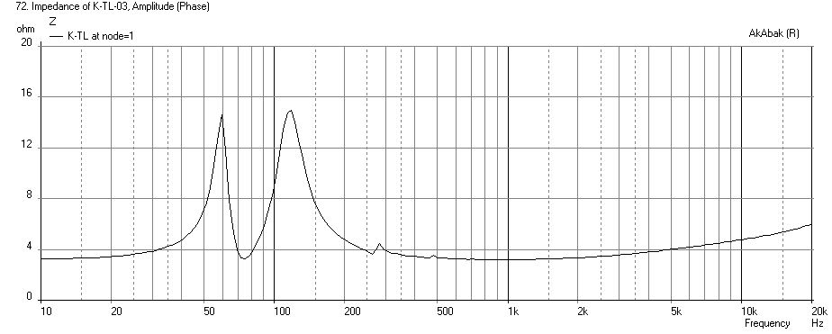

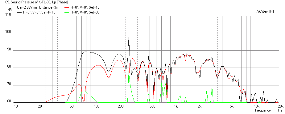

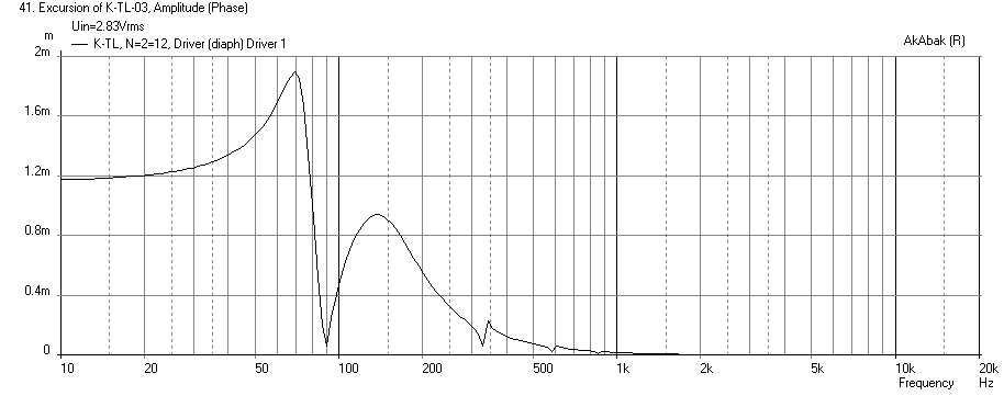

Tiny Dual 3.5 inch Drivers with 0.33X Scale Karlsonator

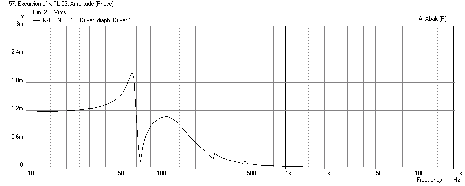

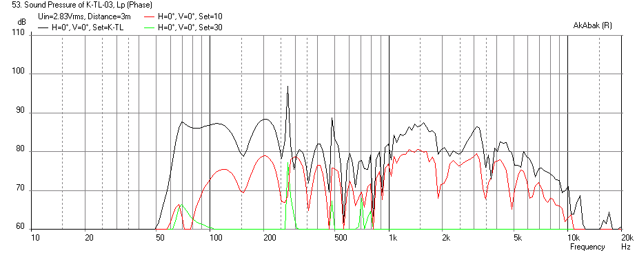

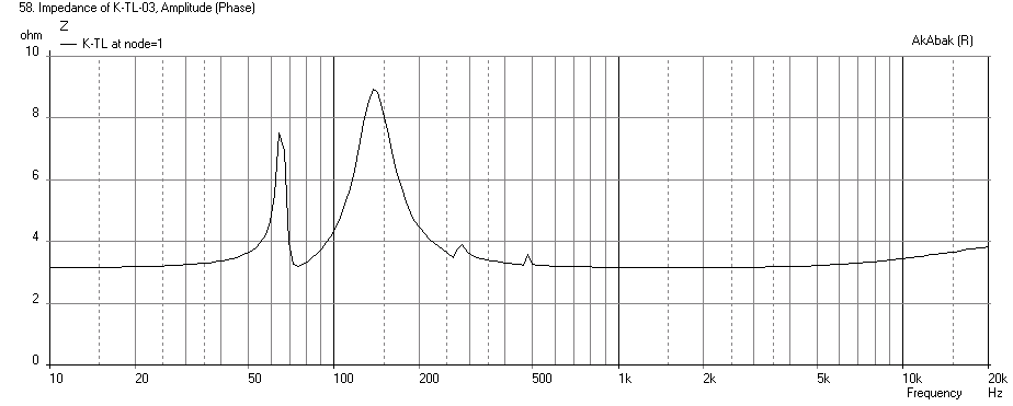

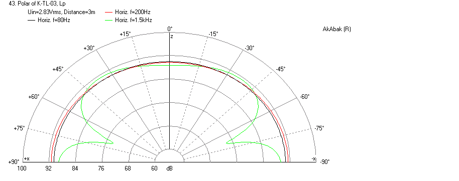

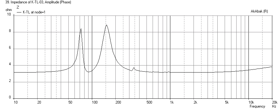

Just for grins, I wanted to see what happens if I were to take the Karlsonator and scale it by 0.33X in all dimensions and put two small 3.5 in Vifa TC9FD (high Qts) drivers that I use for my other projects. The resulting cabinet is indeed very small ('cute' and 'bookshelf' comes to mind) - about 5.1 in wide x 5.4 in deep x 10 in high (all internal dims). The speakers are assumed to be placed against a wall and the measurement is at 3 meters away. At 2.83V into 4 ohms parallel load, I get a solid 90 dB bass shelf from 80 Hz to nearly 300 Hz. There is a big hole 350 Hz to 800 Hz, which may improve with stuffing inside to prevent the end reflections. Anyhow, I am surprised how well this can throw a solid punch at 3m. The second plot is the impedance, third plot is cone displacement, and fourth is polar plot of 80 Hz, 200 Hz, and 1500 Hz. Note the very wide dispersion of the 1200 Hz without lobing. The frequencies that are there, when they pass hrough the K-slot, have a very wide uniform pattern (90 deg in this case).

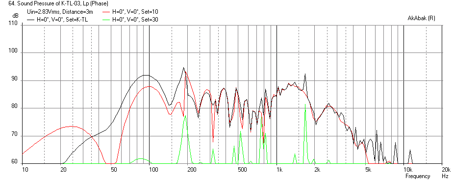

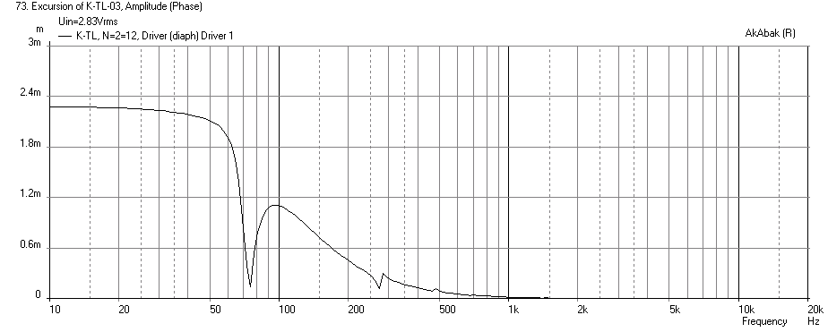

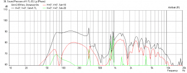

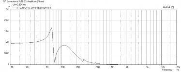

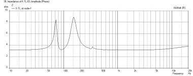

Upon looking at the physical dimensions required to fit a couple of TC9FD's on the front, it looks like the cabinet has to be scaled to 8/15 or 0.53X. This makes the angled driver mounting baffle plate 7.5 inches tall and the drivers are 3.52 in wide a piece - so they just fit in there. It appears the mid-range performance is improved as well. The cabinets are now about 9 in wide x 9.4 in deep x 16.4 in tall - still fairly small. One nice thing is that the driver cone excursion appears to be fairly well controlled. A similar MLTL box that achieves about the same SPL and bass range at 3 m will exceed the driver's xmax of 2.5 mm in a hurry. This could be a fun build in either XPS insulation sheathing foam or even in foam core boards for a fun mini Karlsonator.
Take the plan from:
and scale all dimensions by 0.53X and it should produce results similar to the plots below.

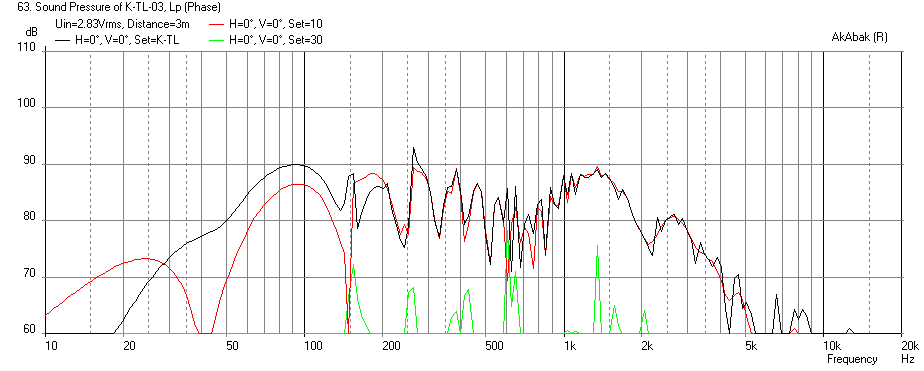

Here is the BG20 in a full scale 15/15 Karlsonator and 12/15 scale Karlsonator. I don't think it is suited for this enclosure. There just isn't enough bass extension - probably Qts is too low?

thanks for the simulations -I expected lower than that in a 12/15 Karlsonator. Does BG20 like a 0.75->0.8 K15 better with regards to punch? that 8/15 scale Karlsonator with the 5" Celestion looks pretty punchy!
