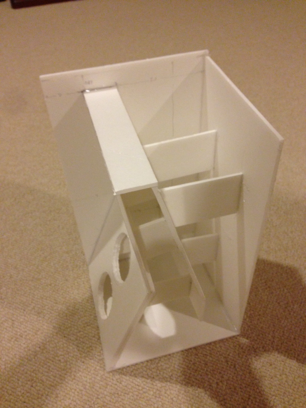

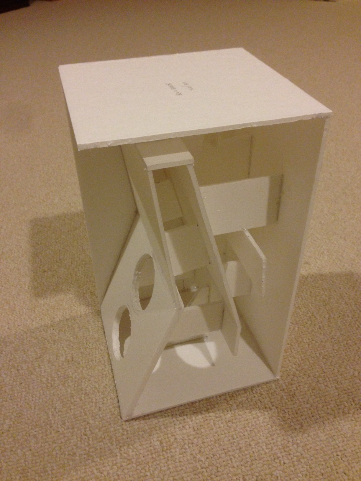

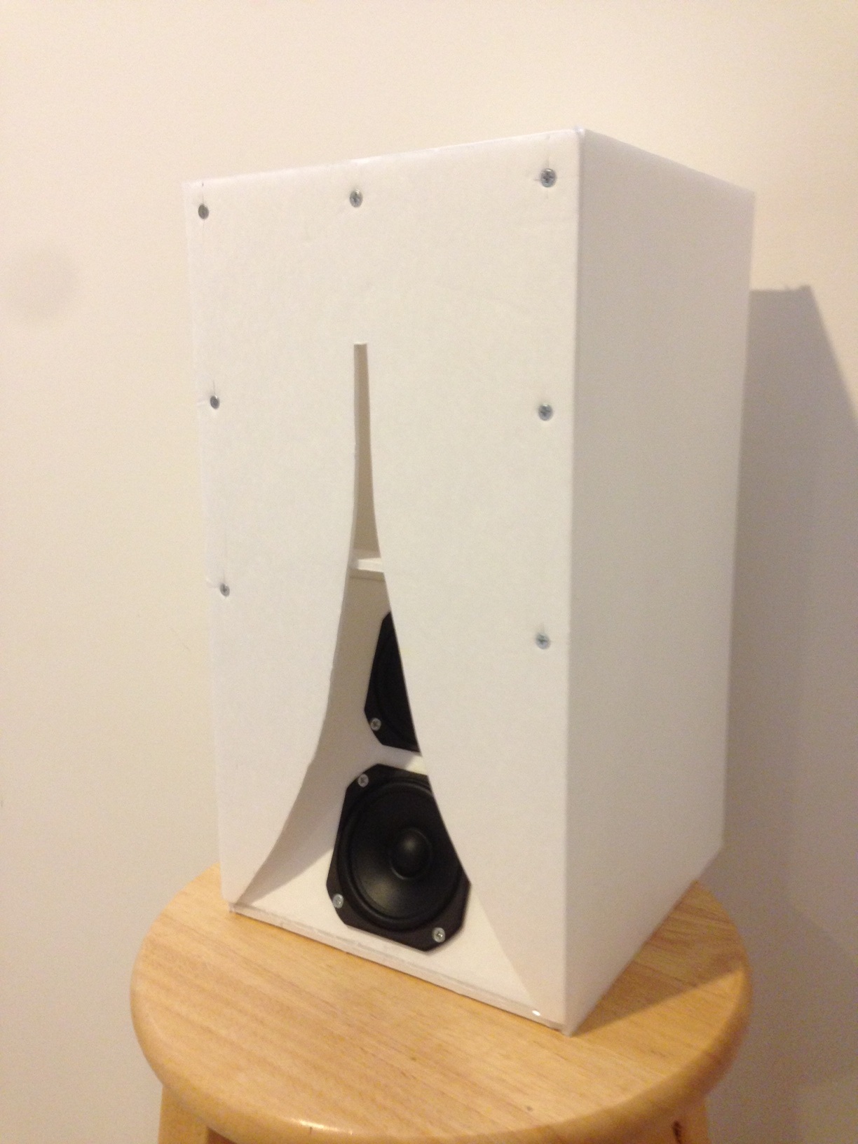

0.53X Scale Karlsonator Build w/ Dual TC9FD's
Upon looking at the physical dimensions required to fit a couple of TC9FD's on the front, it looks like the cabinet has to be scaled to 8/15 or 0.53X. This makes the angled driver mounting baffle plate 7.5 inches tall and the drivers are 3.52 in wide a piece - so they just fit in there. It appears the mid-range performance is improved as well. The cabinets are now about 9 in wide x 9.4 in deep x 16.4 in tall - still fairly small. One nice thing is that the driver cone excursion appears to be fairly well controlled. A similar MLTL box that achieves about the same SPL and bass range at 3 m will exceed the driver's xmax of 2.5 mm in a hurry. This could be a fun build in either XPS insulation sheathing foam or even in foam core boards for a fun mini Karlsonator.
Take the plan from:
and scale all dimensions by 0.53X and it should produce results similar to the plots below.

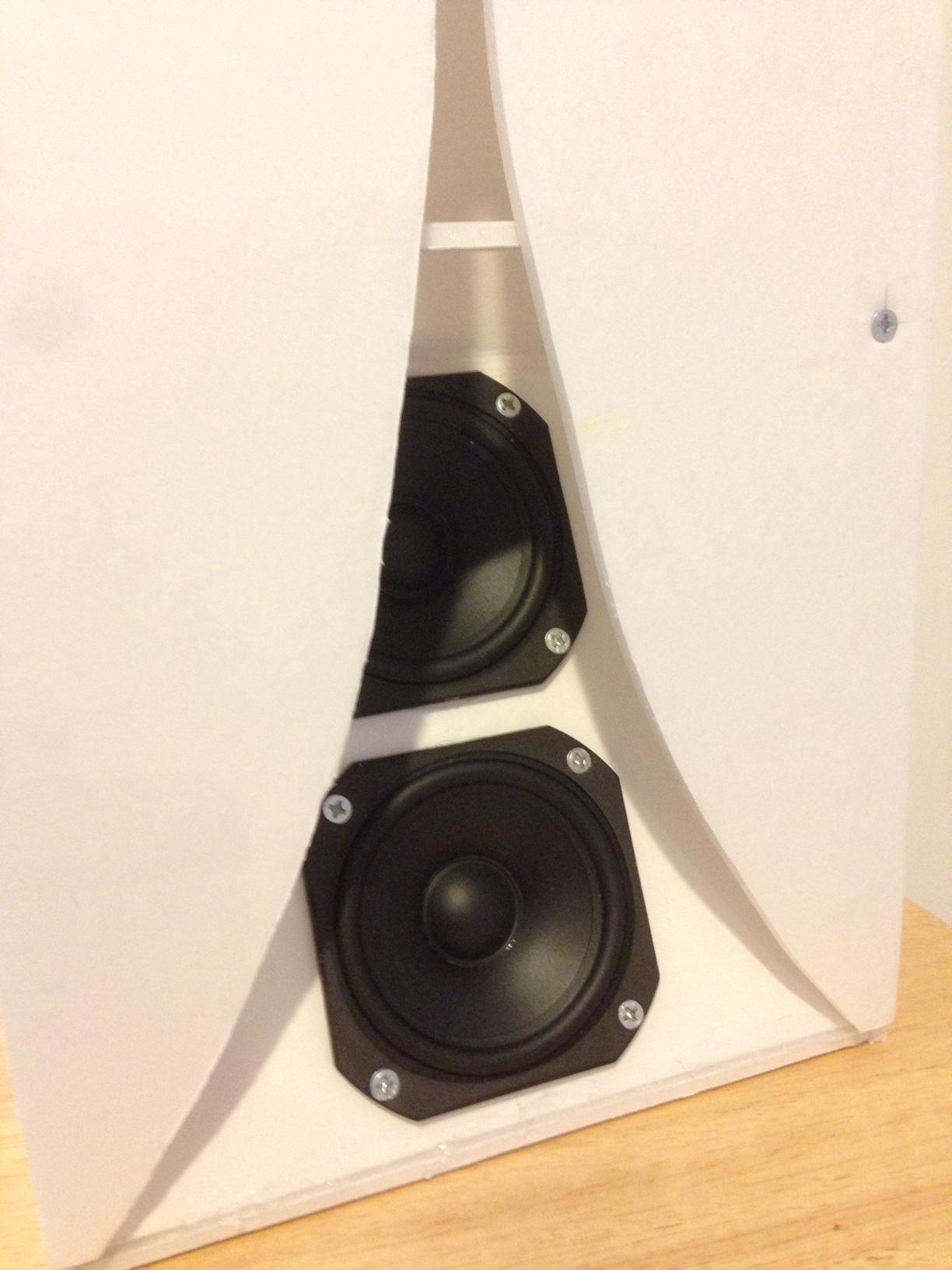

I finally found some time to actually cut foam and build something! Here is the foam core 0.53X Karlsonator with dual Vifa TC9FD's. All I can say is WOW!!! They sound fantastic! The punch on the kick drums is really something. They are very efficient (loud) at distance away and the dispersion is really good. What I am also noticing is that there is a lot less driver cone movement compared to the other cabinets I have used. Although this is a very compact cabinet at 8 in wide x 8.5 in deep x 15 in tall - the volume of the sound is amazing. Now I know why Karlson's are special: they deliver very clean tight bass that sounds very natural and easy.
I highly recommend this build. Easy to make, inexpensive, and they sound great! 🙂

LUV that Foam build !!! - is that a brace strut for the wings which appears above the top driver?
That is a brace for the wings just to increase stiffness as there is a lot of pressure there. It is about 0.75 in wide piece of foamcore and should minimally affect path in opening. I am playing around with reducing amount of stuffing and room placement. It really shines when placed directly on floor - the bass enhancement is very noticeable and the angle of the drivers seems perfect if you stand 3 to 4 meters away. A great floor monitor. I love this thing, can't wait to hear it in stereo as I don't have enough drivers lying around. I can't believe how loud a couple of 3.5 inch drivers can get.

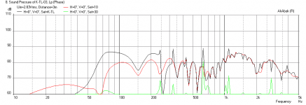

Well Freddi, I never would have built this if I did not simulate it first to see how it looks on paper. But sure glad I did. 🙂 If there are other folks out there wondering, give this a try and you will see. The Karlsonator is not a true Karlson but a Greg B design but I played it with and without the K aperture and the aperture makes a huge difference in dispersion and bass punch.
how should we define a "true Karlson" to separate it from hybrid? - is a true Karlson setup more like a horn with regards to its back chamber sizing?

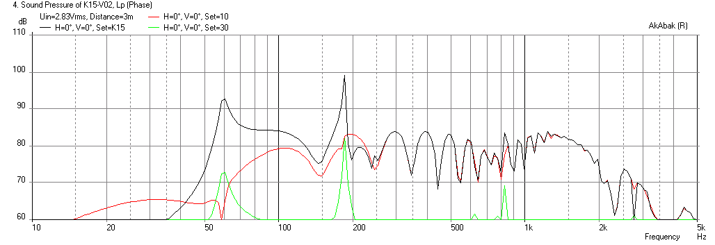

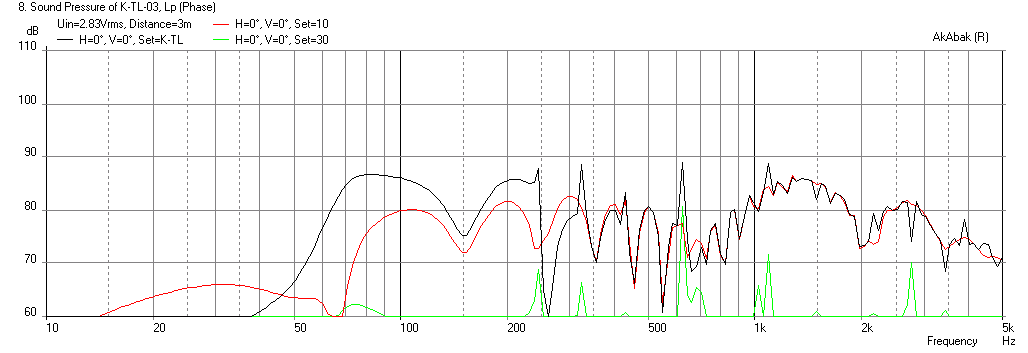

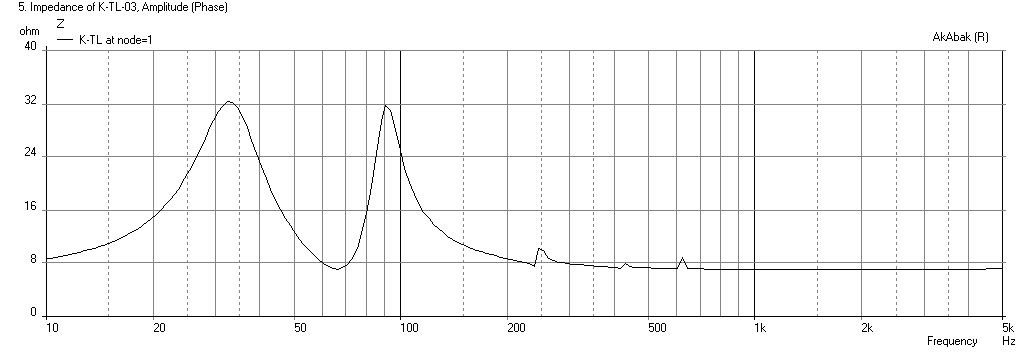

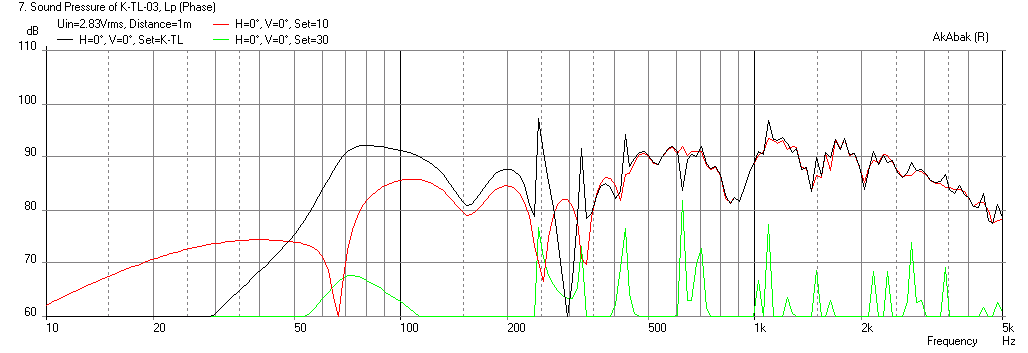

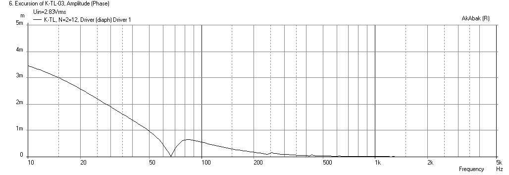

Here are the simulation results with the A12 metal cone. It looks like it can work and be a pretty small cabinet. I scaled it at 9/15 or 0.6X.
First plot is freq response at 1m, second plot is impedance, third is cone displacement, fourth is freq response at 3 m away. Last plot is the A12 in a 12/15 scale K15 cabinet - I don't think this is the right driver as there is a big bass overshoot peak.

For me, a true Karlson is one that resembles the 1950's design with chambers connected by shelves and a vent between the front and back chambers. The hybrids are either TL's or horns with Karlson apertures on the mouth/terminus. The true Karlsons cannot be scaled very successfully beyond 12/15. Any smaller and the performance just collapses, whereas the TL Karlsonator, as I have shown in sims, scales quite well. And I have just demonstrated to myself in foam core that it sounds fantastic. Greg B has a great design here. You should give the foam core a try Freddi - you will be surprised how easy and fast it is to make and how good it can sound. It needs a lot of bracing strategically placed to work as this design has a lot of pressure on the walls.
Karlson deleted the front shelf in all his small designs (K8/K12 and X15) from 1954 onwards. The rear shelf was split into two boards in the ~1956 K12 then the full width rear shelf reappeared in one 1960's K12 model.
