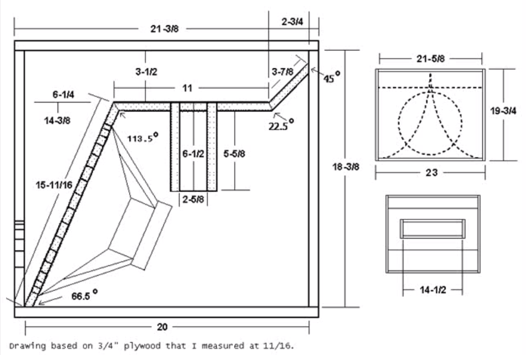

when the late Gregg Baker had a T15 built, he ended up with a small pipe duct instead of the rectangular duct "hinted" at in the drawing - it would be great to find a picture of a T15 with its access door open.
T15 Plan
Freddi,
Great to hear you are back!
I don't know how accurate this plan is, but I got it from the first few seconds of the YouTube video link that Anthony Bisset provided above. I assume these were actual measurements by the person who posted the video. Anyhow, here is a screenshot of the plan - it's actually high enough resolution to use.
The Metro T15 literature says that they use B&C drivers and they achieve a +3dB boost from the T15 enclosure, so that would make the drivers a 97 dB efficiency model. Not sure which particular one that is. I think Eminence has 97 or 98 dB drivers that can be substituted - but we won't know which is best until I build the model and run the sim.
Here is the plan:
where do you think Gregg's interpretation tunes with the rectangular duct vent shown in his plan which you snapped from YouTube? - he had to re-tune for the Eminence - think had had difficulty getting good LF measurements in-room
does Metro's T15 scheme affect the front chamber's potential cavity peak placement and amplitude? - overall bulk wise, its not real far off from Karlson's X15
does making a K taller as Carl builds, tend to tune the front lower so peaking may be avoided? cavity shape must have some influence.

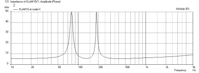

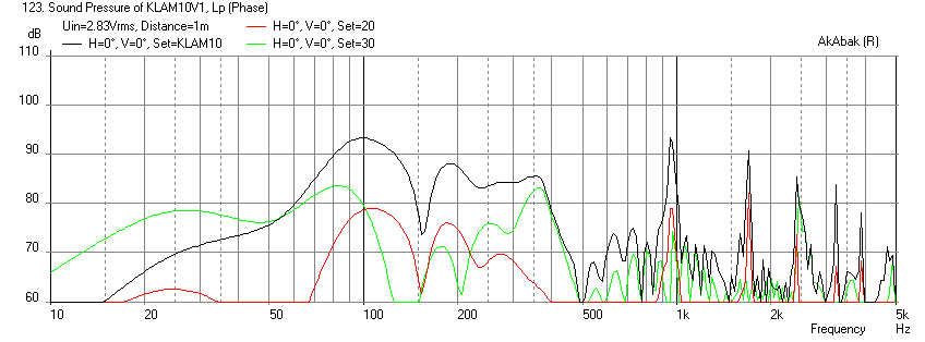

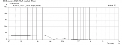

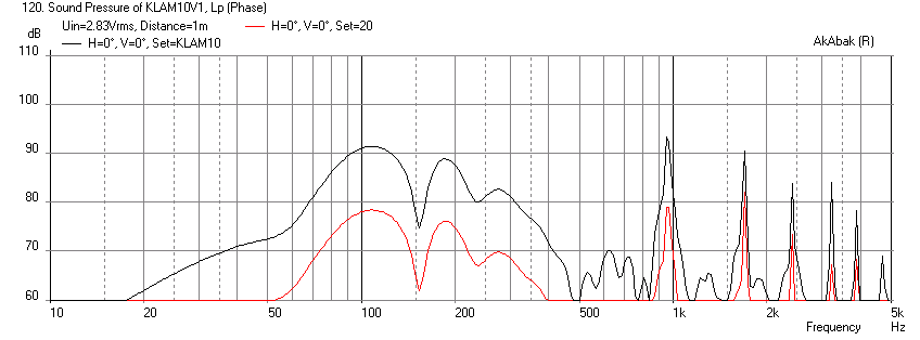

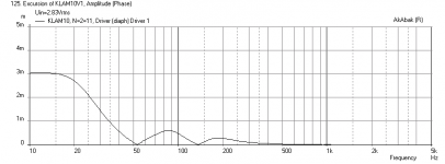

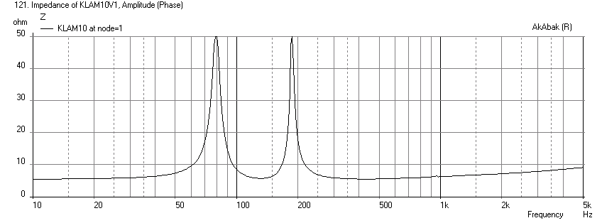

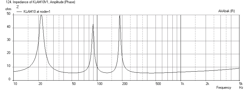

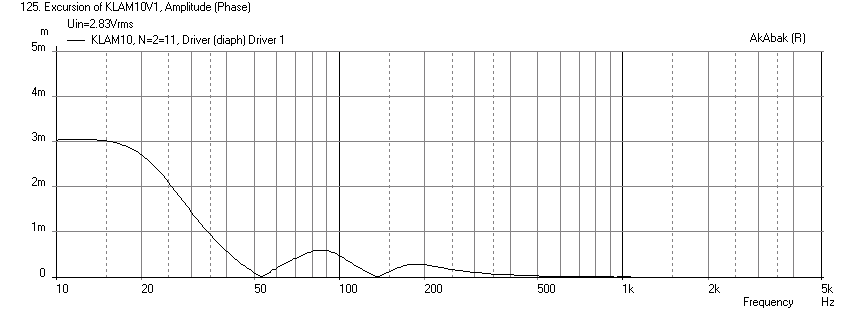

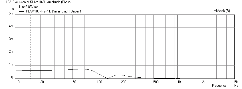

Simulation of Klam 10
X- how tough is it for you to model a Klam?
Freddi,
Well I finally got around to modeling the Klam 10 based on the drawings you provided: 22.25 in deep x 11 in high x 15.25 in wide with a 7.125 in x 11 in x 15.25 in rear chamber. I used a Beta 10CX for the driver as you requested and placed the speaker up high like shown in the pictures. I assumed it is stand mounted at 6 ft high (driver centerline) and the mic "listening position" is equivalent to a seated person with mic at 48 in high. The back wall is far away at 60 in.
I did two cases: a sealed rear chamber filled with stuffing, and a vented rear chamber tuned for 50 Hz with a rectangular (15.25 in wide x 0.86 in tall) slot vent coming out the front.
Plots are as follows:
- Freq response for sealed back (red is output from one of the 9 vents that comprise the aperture)
- Impedance for sealed back
- Cone displacement for sealed back
- Freq response for vented chamber (green is rear chamber vent output)
- Impedance for vented chamber
- Cone displacement for vented chamber
I am not sure if I modeled this correctly but I used the same approach for modeling the Karlson aperture as before with 9 segments of a waveguide that has ducts of varying cross sectional area dictated by the Karlson aperture function. The simulations indicate that the Klam 10 is not a particularly efficient speaker. It is also has a much smaller bandpass than the K15 - acting more like bass cabinet with an upper cutoff frequency of about 400 Hz. So it will definitely need a tweeter and need one that can go pretty low. Although, the model may not be correctly accounting for how much high freq radiation leaks through the Karlson aperture - this is probably the case as in my Karlsonator sim, it says there is not much about 3 kHz, but with the mini Karlsonator I clearly get up to 16 kHz.
One good thing about the sealed version is that it can handle a lot of power as there is hardly any cone movement (as expected for a sealed box). The vented version provides a slightly wider bandpass (in the upper portion) but not much better in the low end due to the limited volume of the back chamber (should be twice as big).
Anyhow, let me know if your listening impressions are consistent with the model or if you have some measurements even better. First thing I would notice is not much bass below 80 or 90 Hz.

hey X - thank you very much for working out the klam -
here's some old notes
the first graphs used averaged pink noise as I could not get good enough signal-to-noise for swept-sine. - - part of that was my fault for testing at ~1 watt. -- rasing drive to ~10 watts in later plots along this list got swept-sine recognized.
Klam 10 sat on top of a plastic barrel and microphone was ~9 feet away. Klam 10 was built nicely by John Lapaire ~ to Carl's dimensions (slot and nose may be a bit tighter) - the aperture came out too "tight" by 1.5" at the final width
resonance is around 100Hz and "Qtk" ~0.62
the few dispersion plots were taken at only one elevation so its not known how much that parameter changes with elevation and varying frequency.
if I could just re-cut the aperture to a radial arc which opens the full width, I know the sound with Beta10cx and compression driver would be pretty impressive
