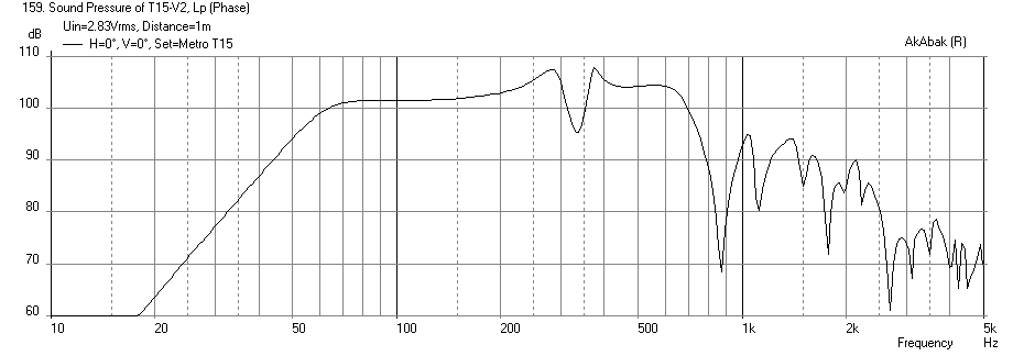

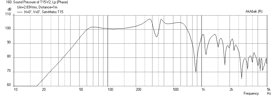

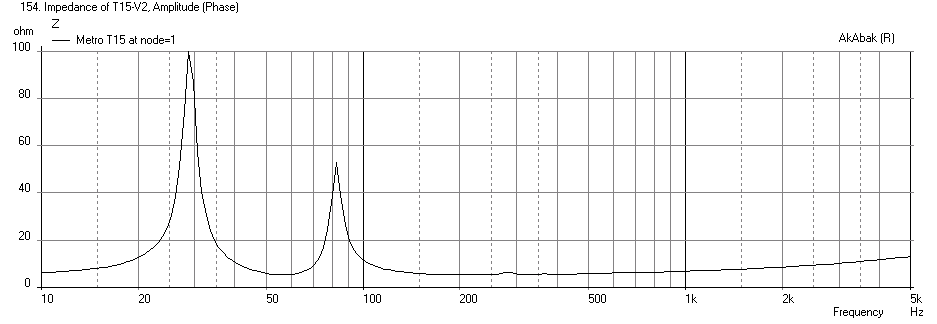

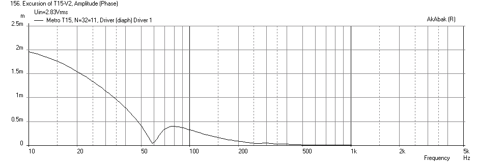

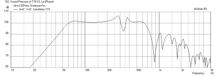

Sim of Metro T15
I finally caught a typo in my code and it all seems to work now. Presenting the T15 model - it produces a nice flat bass shelf when used in the open space like a stadium or arena as it was meant for. The bass extension, as I guessed does not appear to go any deeper than a K15 given that the box volume really is about equivalent. There is a 'V' dip - which can become a 'W' shape depending on the exact parameters of the Karlson aperture curve on the front. I am using the same curve function as the K15. The T15 may have a different spec for the curve but that was not given in the drawings. The location of the dip appears to not be at 190 to 270 Hz but my simulation shows that it is from 270 Hz to 370 Hz and the depth is about 6 to 10 dB depending on smoothing. Nonetheless, it appears to be a very nice design suited for kicking butt in large spaces.
Simulations are with a wall really far away (416 ft to the back - no wall effects) and speaker placed on the floor. I have mic set at driver height above floor (~10 in) and also at a typical seated listener's ear height of 48 in. I have most of the plots for the Eminence Kilomax 15 driver, but also show the Kappa 15A and B&C 15HCX76 at 1 m away and driver height of 10 in for comparisons. They are quite similar but have more SPL at the higher frequencies. The Kilomax being a nominal 95 dB speaker is actually more balanced.
For the Kilomax 15, the SPL at 40 Hz (1 m away) is ony 86 dB, and 94 dB at 50 Hz (not bad)m and about 100 dB otherwise.
Plots are as follows:
- SPL vs Freq of Kilomax 15 at 1 m with 2.83V input, mic at 10 in height

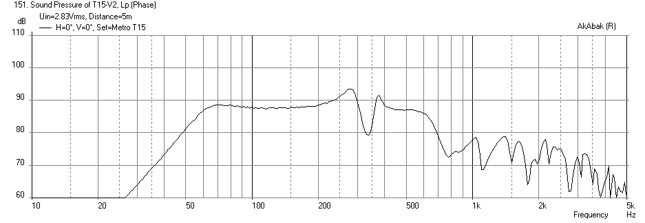

- SPL of Kilomax at 5m away with mic at 48 in height
- Impedance of Kilomax 15

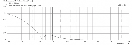

- Cone displacement of Kilomax 15

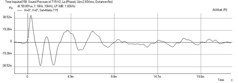

- Impulse response of Kilomax

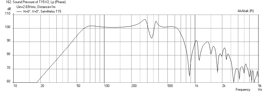

- SPL vs Freq of Kappa 15A
- SPL vs Freq of B&C 15HCX76
Let me know what you guys think of the simulation and if this model looks like it may actually be similar to what measurements show. I have not yet seen any measurements of the T15 so this is a true "blind" prediction. 😀

hi X -- I think the cone null on T15 and K15 is coming in too high (?) - nearfield on K15 and a K15 sized coupler with 18, for some reason I see a near-cone null about 1/2 octave below fb , or ~37Hz in K15 - what would cause that effect???
here is the PDF covering T15 and its designer gives explanation of this hybrid cabinet and its benefits on distortion reduction and better fidelity (if that matters in pro work)
http://www.metroaudiosystems.gr/pages/manuals/E_Array_Manual_en.pdf
here's T15's 2.83v 1M response from Metro's literature - I'd love to have at least 2 for home use - 2 per side would rock - T18 should work - not so sure about a "T12" ? - what do you think?
my two pairs of B&C are 15PZB40 and 15TBX40
it would be cool to find a picture of a T15 open or an impedance plot
the vent hinted at in Metro's literature has a healthy area

Freddi, any idea if GregB's struggle to get LF in room related to the room? Do you know if he ever measured outdoors?

Decisions decisions... The commercial Metro T15 FR shows bass falling steeply ~23dB from 50 to 30Hz while X's akabak model shows a slower and more linear decline. Is this marketing in action (MIA) <or> is X's great Akabak model missing something <or> is the vent size on the real T15 smaller as per Gregg Bakers discovery?

the Metro had a PHL woofer - I think Gregg got the cabinet and aperture about right - he may have undersized the vent due either to a room mode or interpretation of a bad graph -?? - a test cabinet would need to be made - or make a neat means to change the vent that Gregg dimensioned from Metro's sketch. T15 is a nice size like THAM 15 and Jim Bell's single sheet tapped horn. I might ask Metro if the drawing is about correct. That vent has to clear the woofer.
you can see Metro's graph was losing signal to noise ratio at the 2.83v drive - 20 watts would have made it easier to figure - if it really does 40 (2pi?) at -3 to - 6dB then that's pretty solid bass. The little X15 with a light cone woofer rolls off quite high.

Thanks for the feedback. I am a little bummed that my sim doesn't show the bass shelf extension down to 50 Hz like the Metro measurement. Seeing the ripple in the response provided by Metro I would have to say it was done in a room because when I add a wall at about 5 ft in the back of the T15 I get similar ripples and dips. So I wonder if the 95dB response at 40 Hz is partially a room enhanced mode or is it really the speaker? The other thing I can't figure out is why my notch is that far off. I will take a look at my code again and double check the dimensions. AkAbak usually gets these things much closer if the dimensions are correct. So my question is the drawing from the YouTube video (Gregg Baker's I presume) close to what a T15 that was measured by Metro in the freq response plot shown above?

Anthony,
The sim predicts about 0.75 mm cone excursion at 40 Hz with 2.83v input. This is about 3x more displacement than the peak near 60 Hz. So within the main bandpass the cone excursion is very small and well controlled. If you EQ down at 40 Hz you may get away with it if you use something like a Beyma http://profesional.beyma.com/pdf/15P80NdE.pdf which has like 52 mm of stroke before physical damage occurs.
