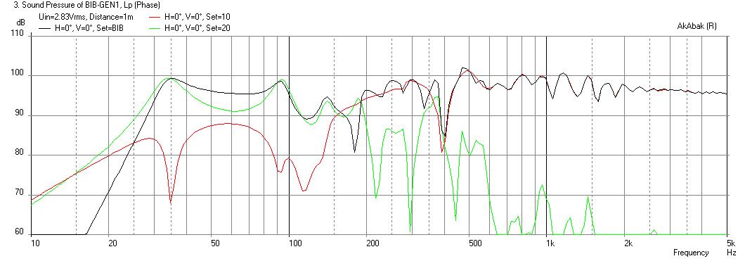

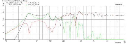

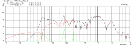

OK, why did I just pick on the MLTL? Many folks associate a BIB with a speaker that is good for filling sound in a larger space. Well, below are sims of a Betsy K in a BIB with dimensions as prescribed by GM's BIB calculator spreadsheet (20 in wide x 28 in deep x 67 in tall, all internal dims).
The first plot shows the BIB flush against a wall with mic at 1 m away. The response actually looks very good - nice and flat with great bass extension, and boy is it loud at 1 watt!. This is just to show that on paper, the BIB can actually look good for certain cases.

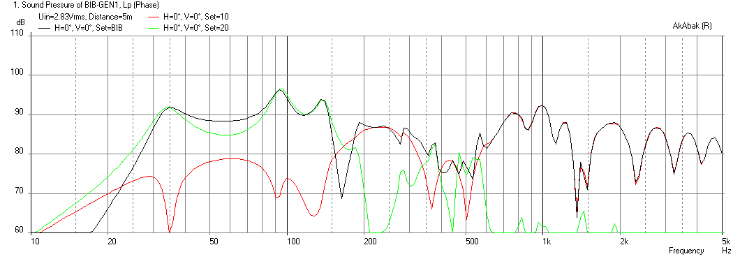

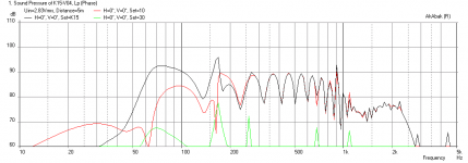

Second plot: when one steps back 5 m with BIB still against a wall, the response doesn't look as good anymore - there is a big wide dip at 450 Hz.

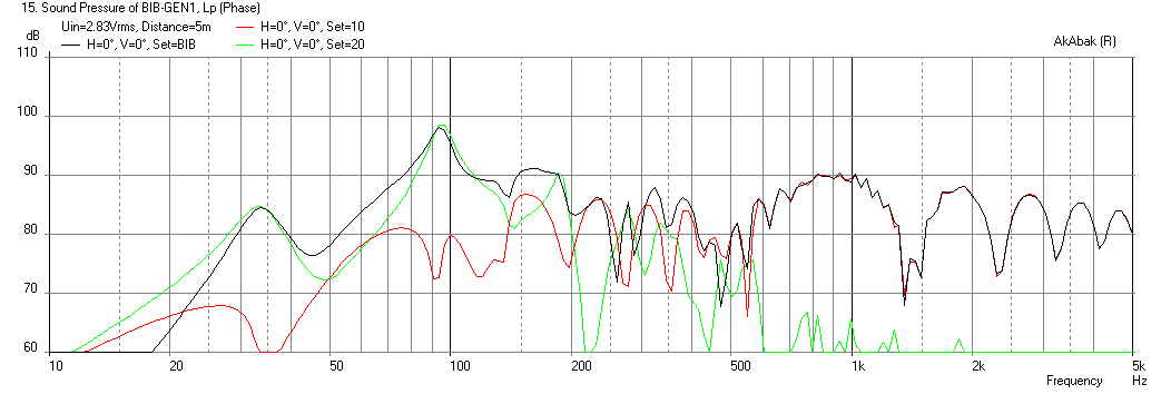

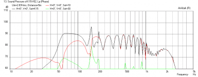

Third plot: move the BIB to 60 inches away from a wall and listen to it at 5 meters away and you get recessed low end bass and a bass peak at 100 Hz and generally uneven response with average SPL in the mid 80 dB's.

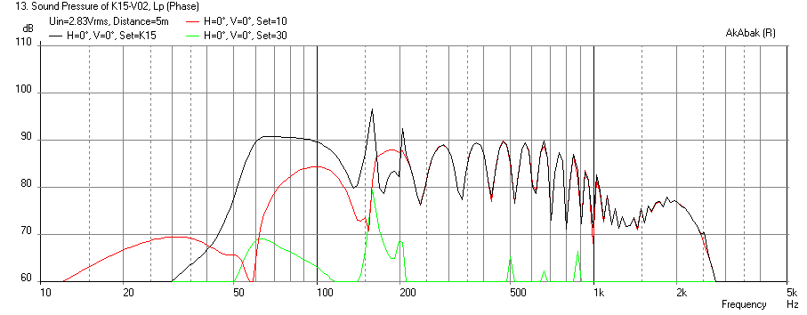

If you are curious what the Betsy looks like in the K15 plan with the 40 square inch vent, this is shown in the fifth plot. Still pretty good but not as tight a bass shelf as the Job Ullman variant with 21.5 sq inch vent.
So there you have it, the K15 continues to kick butt even when matched against the venerable BIB.
Hmm, many folk's listening experiences and occasional measurements don't line up hardly at all with these or other long distance sims you've posted, so I'm inclined to ignore all of the room modes BW of those more than a meter away.........
For sure, I wouldn't use them for tweaking a design.
GM

You are probably right about room modes being dominant. What I have here is a large room meaning it is "infinite" in extent beyond the floor and one wall that forms a boundary. So if you can imagine a room being a box, only two sides to the box are present, and these sides extend infinitely (no ceiling and no 3 other walls). So when a BIB is placed in a larger room with all 6 walls, there will be reinforcement from room modes for sure. I am basically talking auditorium/outdoor stage with a back and floor.

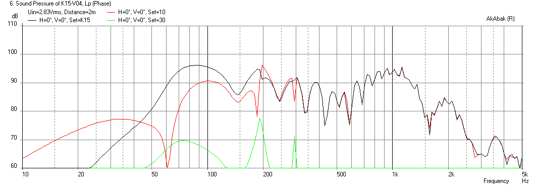

I have an overall scaling factor that I can tweak and I tried the 0.8 factor which is same as scaling it for a 12 in driver (12/15). The simulation is 60 in from back wall and mic at 2 m away. Second plot is for the FE206EN. It doesn't look too bad actually.
