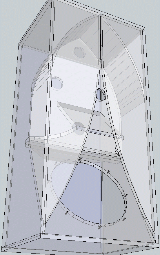

in a heretikal act, Karlson built at least one set of X15 with horns up front - probably for electronic organ - that one set had a very large vent so must have been the daddy of the Transylvania Power Co. product and other spinoffs
I should hack a large vent in my copies, extend its lower boundary with a shelf and see where it tunes and how it plays. (de-Q-ing )

what is the ideal shape for a K's front cavity? Kenpeter - what in your opinion can cause the first dip? 115BK with its large vent, etc. doesn't have much of a dip.

The first dip is the shortest path from back to front. Make sound
go around the side of the shelves, and taller coupler, and higher
internal vent (if placement doesn't ruin the chamber's reflective
properties) all give more distance. Distributed internal vents may
smear the dip, which can be useful too..
I think the first dip has more to do with the typical dip found in a higher order bandpass reflex box design. For example, a double bass reflex box tuned for 50 Hz will have a dip at about the same spot when the ports are not optimized or too aggressively tuned. So really, it is a function of the CSA of the inner shelf and the vent between the back and the front chamber. The front shelf will not affect this dip, nor the shape of the K aperture.
Maybe, but I like my own theory better than anything reality has to offer.
There's many things going on simultaneously, and your suggestion is one
of them, but I think "the dip" of a K misbehaves much as a tapped horn.
The shelf is good for doing three things:
Lengthen the short circuit path. Depending the location of the
internal vent, this might be trivial. It isn't trivial on the K15...
Provide a direct bounce out for much of the midrange.
Split the path of midrange to the upper chamber, so interference
patterns will make a vertical stripe, directly behind the exit slot.

I have an 8 cubic foot bulk diy K-coupler with a 3-panel "cupped" reflector - no rear shelf in the groundplane graph below - two 4.5" holes for its vent so it could be tuned lower with 4" pvc and also mount an internal K tube
here's the effect at groundplane of a 5" deep front shelf - tuned just by the 4.5" holes

You often mention how Karlsons are most often Nth order BP systems and I can't say I disagree. The back-chamber itself is usually a simple reflex or quasi-DBR at times, but how do you view the front chamber's action? The typically smaller Vb and large K-slot area make no sense for a Helmholtz tuning anywhere close to what we deal with; ~115Hz for K15, ~155Hz for K12 and ~200Hz for the above little SK8. I've usually found correlation between vertical height and the front tuning (second impedance minima on a Z plot, between 2nd and tiny 3rd peaks, if I interpret this correctly). This tuning is often a quarter-wave for ~90-95% of the internal height.
When simulating a 6th order BP in WinISD, I set this frequency as the front tuning without regards for the in-software Helmholtz vent dimensions and set Ql=3 for this Vb, which gets me a close enough match to actual measurements.
IG
So when the front shelf is added does it become an 8th order bandpass? I seem to recall hearing on one of these threads that the K15 was 8th order.
I am thinking of taking step back and designing a Karlson type enclosure from the standpoint of a multiple-resonator bandpass with Karlson aperture output coupler. I am not sure if having the driver right behind the large part of the aperture really is impacting that much with the "tapped horn" behavior. I don't really think there is much tapped horn action going here. This may free up the spatial design constraints and open up the design space to allow this to be optimized for almost any size driver. Right now, moving away from the K15 cabinet by any more than 12/15 ratio ruins it. Too much geometry dependence coupled to chamber volumes. They need to be separated - thinkseparate chambers connected by interchangeable round ducts. Final chamber has K-slot and first chamber has driver.
All implementations of a front shelf I've seen were nowhere long enough to add additional poles. It'd have to be full cabinet width and touch the wings for this to happen IMO, even then?
I think the K-slot will trap some air on long enough a path for a top-vent Karlson to have some tapped-horn action. There will be some de-Q'in action as well because of it and other effects can then start to dominate, wether neckless-Helmholtz or QW or whathaveya. 🙂 A vent anywhere lower than the very top of the coupler, including distributed schemes, will probably allow for very little TH action to go on.
