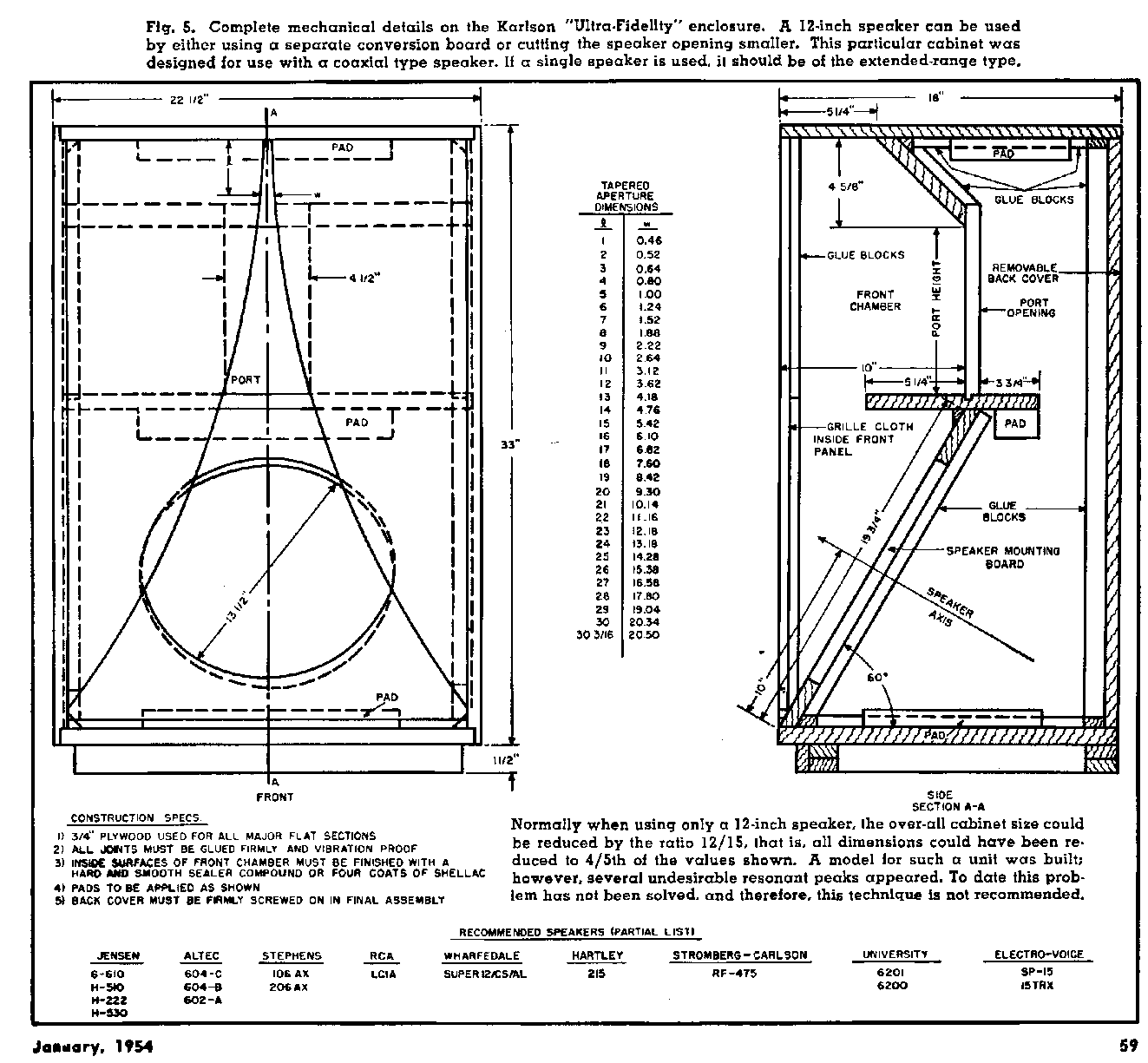

John Karlson had a K18 - you can figure out its size sans the upper driver/whatever compartment
Karlson 18 Console
http://imagizer.imageshack.us/a/img338/7135/foldoutpage3web.jpg
after Karlson's death, Cetec-Gauss came up with their 5181 K18

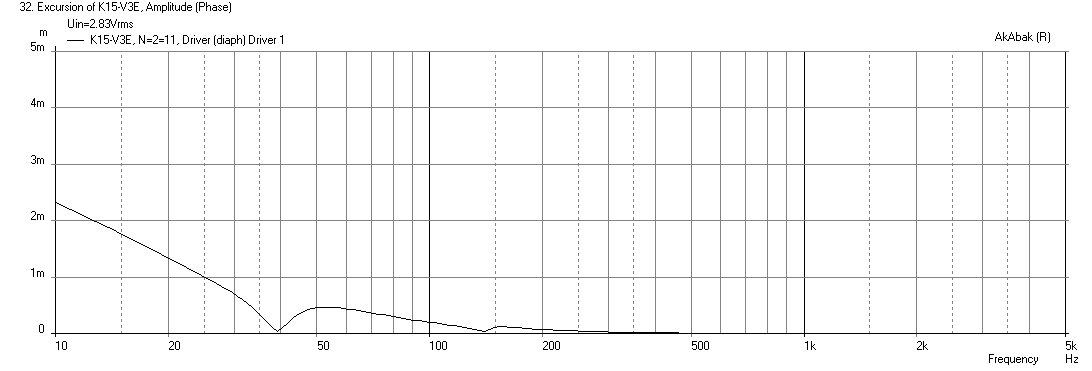

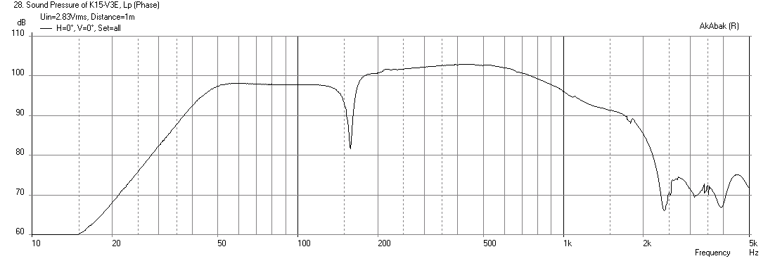

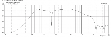

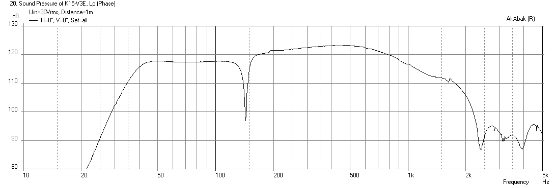

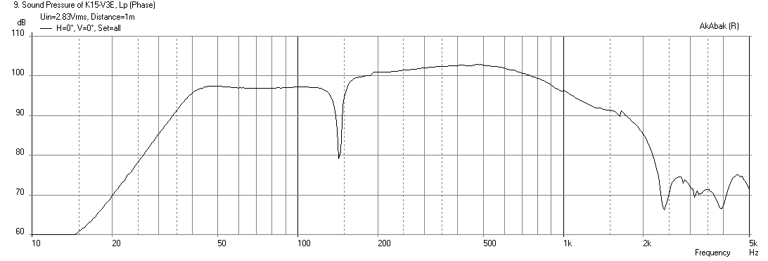

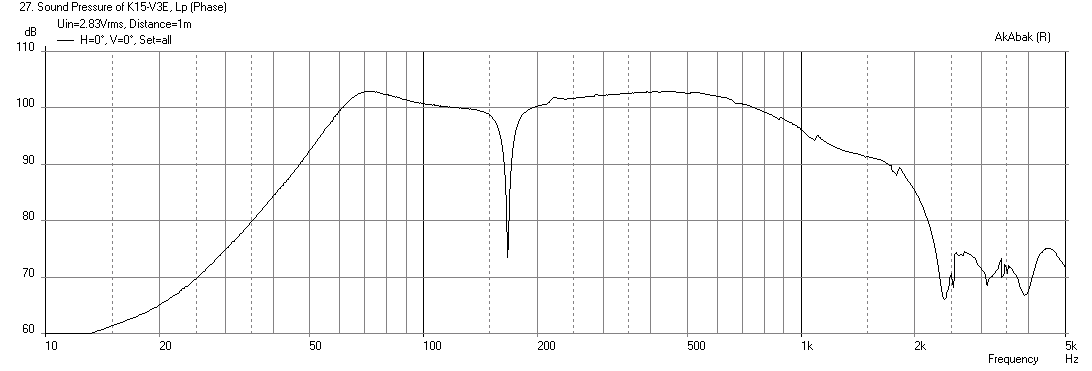

I am quite impressed by this Iconic driver. It has perhaps one of the best responses simulated in my K15 model with deep smooth flat response at high sensitivity.
Here is the baseline case in a standard K15 with a slot top slit K-aperture, this gives about a 55Hz -3dB point from the nominal 100dB level (there is a bass peak overshoot that gives quite a punch but at the expense of bass extension):
Here is the standard K15 with a K-aperture that goes to a sharp cusp (-3dB point is 44Hz):
Now if we scale the height and depth by 1.10x and the width by 1.05x we get 97dB sensitivity (-3dB point is now 38Hz), this configuration will reproduce the 41Hz bass note with convincing authority:

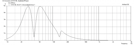

Here is cone displacement at 2.83V:

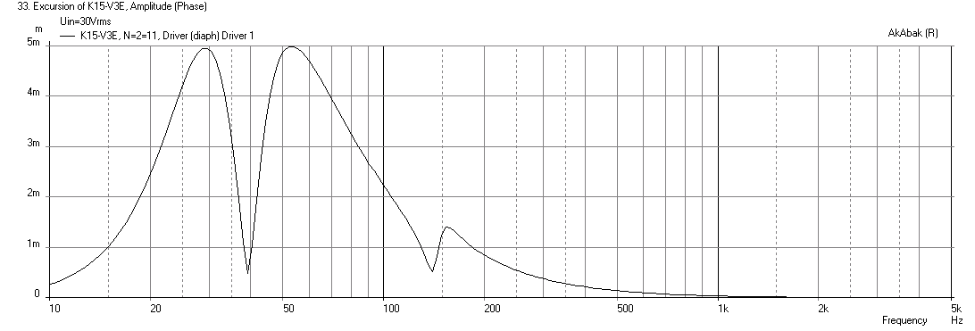

Here is the cone displacement at 30 volts to reach xmax using a 24dB HPF @ 31Hz:
Here is the corresponding max SPL with the HPF in place:

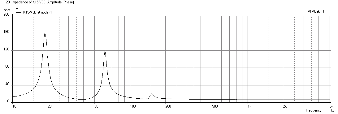

Here is the impedance which shows the tuning freq between the two peaks as about 37Hz:

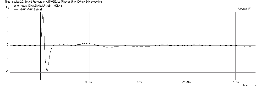

Here is the Impulse Response - doesn't get much better than that - and therein lies the magic of the K15 cabinet for convincing dynamics and percussion:

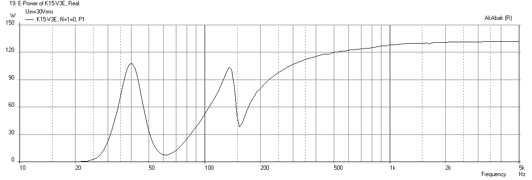

Here is the electrical power input (with HPF) - it is still below the rated 140 watts:

that's pretty close to a Cetec-Gauss 5181 K18 in size. How would an 8 cubic foot bulk Karlsonator fare in comparison?
5181 plan http://img72.imageshack.us/img72/825/gaussbracing.jpg
