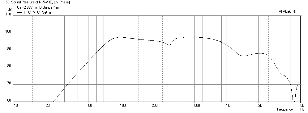

hey X - I've got a mini K15 in the 0.55 scale ballpark for an 8" which might hold a 10" - could one get a rough idea of performance in that case where the front of the cone sees an ~7" diameter cutout? have to be careful not to let B102's cone slap against the baffle (IF it will fit the rear chamber)
hey X - I've got a mini K15 for an 8" which might hold a 10" - could one get a rough idea of performance in that case where the front of the cone sees an ~7" diameter cutout? have to be careful not to let B102's cone slap against the baffle (IF it will fit the rear chamber)
Not sure what your question is... You have a K15 scaled down to 8/15 (0.53x) and you want to put a 10 incher (B102) in it?
If that is your question, here is what you get:
![438719d1410837987-speaker-kicks-butt-large-spaces-k15-053x-b102-freq-1m.png](https://www.diyaudio.com/forums/attachments/full-range/438719d1410837987-speaker-kicks-butt-large-spaces-k15-053x-b102-freq-1m.png)
Usable to 80Hz, needs a sub below 80Hz.
its 1/2" plywood, this size: 1.4 cubic foot external bulk at 18.625" H x 13.5" W x 9.625" D (sans molding) and is cutout for an 8" - can I get a pretty good idea of how it would perform with proper cutout for a 10" by rear mounting a 10" speaker over the ~7" diameter hole? do you predict good power handling with Delta10a or B102 in 0.55 to 0.65 size K? (got 1kw/c) - -would a 2X10" Karlsonator be a good project with regards to range and power handling? or does it get too tall/long? - (two 2.5" to 3" coil should do pretty well.)
oops -the external dims are ~18.7"H x 13.5"W x 11.5"D for ~1.7 cu.ft. external bulk and B102 fits pretty well centered over the existing cutout - got to dig for a camera. The plywood in this old cabinet isn't as stiff as modern 1/2" Baltic birch. If it really could hit 80Hz with power then would be a good substitute for larger front load horns. I'm pretty sure ~0.65 scale will do 80 with Delta10A. Sometimes its easier and better to add a sub or two than try to extend some drivers LF cutoff. That recent TQWT with 1260W Infinity is liked by TheJessMan.

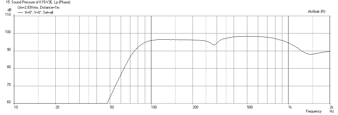

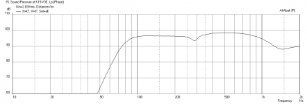

here's SN10C's woofer graph - extremely blurry but believe the 94dB/1KHz sensitivity helps mark its window
it has a rise similar to Delta10A
SN10C coax
Delta10A

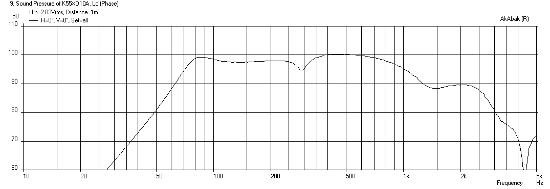

thanks - that might be enough - is a bit larger any more useful? - does power handling of the 0.55 size look good?
how much sub would you say is needed to subjectively balance out a little 0.55 scale pair?
Delta10a looks pretty strong
compared to the moderate strength motor coax, SN-10C
![432767d1407809273-speaker-kicks-butt-large-spaces-k15-055x-delta10a-freq-1m.png](https://www.diyaudio.com/forums/attachments/full-range/432767d1407809273-speaker-kicks-butt-large-spaces-k15-055x-delta10a-freq-1m.png)
![439195d1411088620-speaker-kicks-butt-large-spaces-k15v4e-sn10c-0.55x-freq-1m.png](https://www.diyaudio.com/forums/attachments/full-range/439195d1411088620-speaker-kicks-butt-large-spaces-k15v4e-sn10c-0.55x-freq-1m.png)
