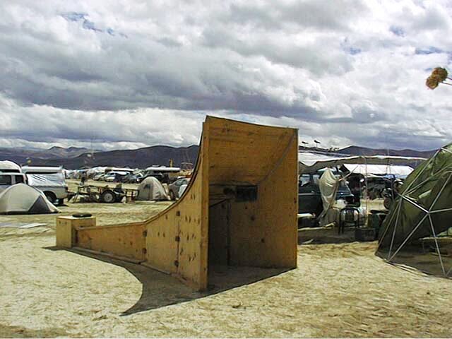

Carl made a klam12 - talked about rebuilding it as like it but not fully satisfied - below is what I think it looked like - rear chamber may have been too big (too deep) in my sketch for some drivers - when sealed, there's not much sense having too low a system Q as that compromises response and power handling - his favorite wing flare was a "Trax 60" by Ken Lehman
there were other pictures but Imageshack lost those uploads - Imageshack has crap service for a pay site
Carl's klam12 size could probably work series vented with some speakers, and not too large to mount
on a sturdy tripod
my sketch
http://img83.imageshack.us/img83/4366/klam12gdob5.jpg
Carl's picture with EV
Carl's little klam10 with a Beta10cx and compression driver should be fun
