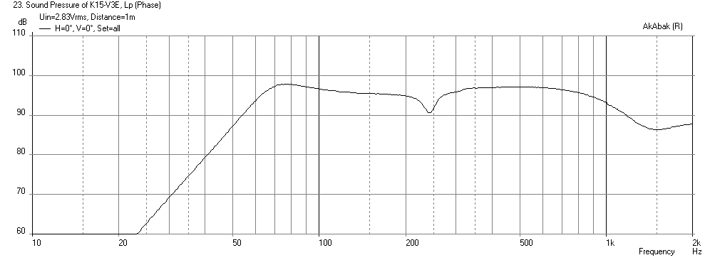

I can run some sims to check this by adjusting aspect ratio while preserving volume. I think that because the K12 is a bandpass multi chamber reflex box - until the aspect ratio is long enough for it to switch to TL operation where the length of the upper or lower chamber is significant - there will be minimal effect. That is my guess but we will see. The K12 and K15 are very good from an efficiency standpoint in that they have a great coupling between the cone and air motion. I wonder how stretching it will affect this? Stretching it may impact CSA of the inner shelf vent and top chamber vent. That will modify coupling efficiency.
can you also run the case where there's no front shelf? - that's the way most smaller couplers are made including Karlson's originals -- I think the goal of the high aspect K was to extend the bottom a bit and limit cavity peaking.
we can see in Fig.3 of Karlson's 1951 patent, whether built or not at that time, suggested a high aspect to the K-coupler. K15 was already finalized at that time and getting ready for production in 1952.

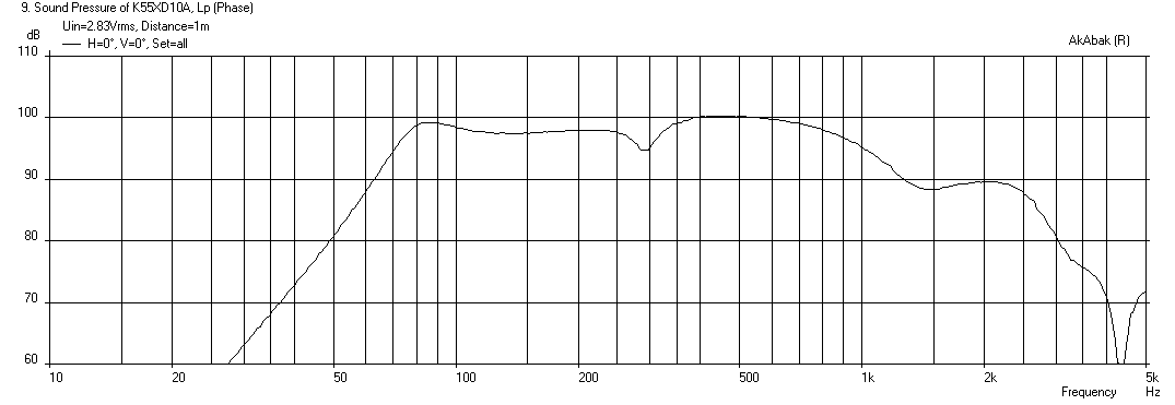

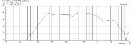

0.55x Scale K15 for Delta 10A
Freddi,

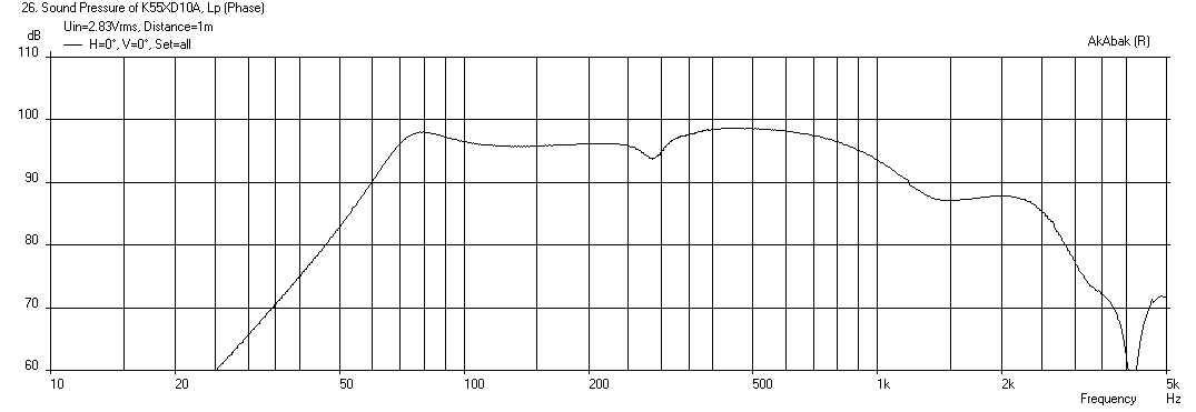

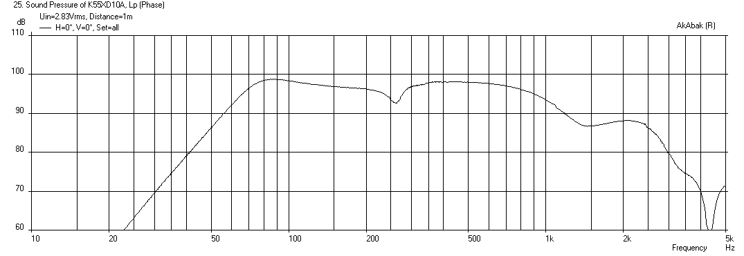

Here is a sim per your request to optimize for a 10 inch Delta 10A with 80 Hz bass extension. It seems that a 0.55x scale K15 with a K-aperture that goes to a cusp should work.
Freq Response:
attachment.php

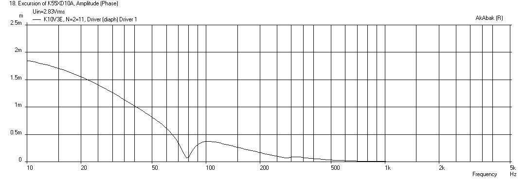

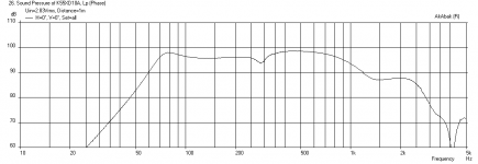

Cone Displacement:
attachment.php

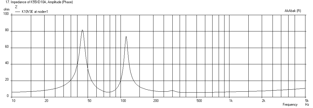

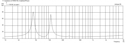

Impedance:
attachment.php

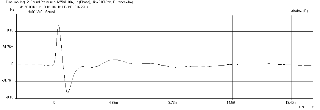

Impulse Response:
attachment.php
The response above 2kHz may be better in reality as the model is not very good at capturing the effects of the driver cone interaction with the fron cavity. Looks like a super sensitive unit that can be paired with a sub and made in qnty 5 will be great for HT.

Thank you very much ! - that is a truly small cabinet - fwiw, I think the front shelf should be made to protrude just enough past the port panel as to experiment with its depth - the cabinet is small to fit a 10" - assume 0.55 is based on K15's nominal inside dimensions -- ?
would Beta10cx play in this cabinet?
I would have to look at the driver magnet size and draw a scale picture to see if it actually fits. It is tight but the bezel is nominally 10in dia and the front baffle is 12+in wide so that should work. One trick is increase the height of the bottom back chamber to clear the magnet and add wood blocks internally to restore the volume gained. I will have to look at Beta10cx but my guess is that it has a substantially higher Qts and probably won't be ideal.
flush mounting vs rear mounting will help a little bit - Delta10A is about 3.75" deep from the frame rear flange to magnet. Magnet diameter with the rubber ring is about 6.375" and without ~6.125". The old model Beta 10cx was about strong enough to work. What would you guess the change if the cabinet's outside dims ended up 21x14x112.5 vs say 20x13.5x11? I have a pair of ancient Beyma 10G200 laying around .

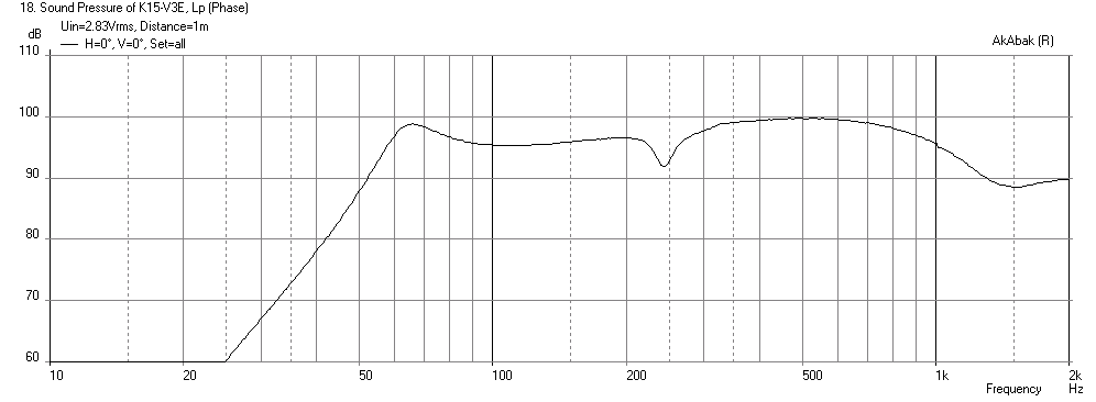

Freddi,

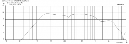

A Beta 10CX will work in a 0.60x scale K15.
Beyma 10G200 will work in a 0,55x scale K15. This speaker can be driven to xmax with 35V with a 57Hz -24dB BW HPF and produce 119dB SPL at 1m.
good = something else to try. In a regular K12 size I get some ramp-up around 200Hz and the current Beta10cx looks much like Visaton's BG20 from lows to midrange. I don't know how much the cavity shape of the 1956 or so K12 with
10 degree forwards canted port board would compare to a 0.6 scale K15 in the 100-200Hz region - maybe not a lot of difference (?)

hey X - what should happen if Delta10A is used in a 0.65 scale K15? would it get near 70Hz? would it lose any punch vs the 0.55 scale example above?

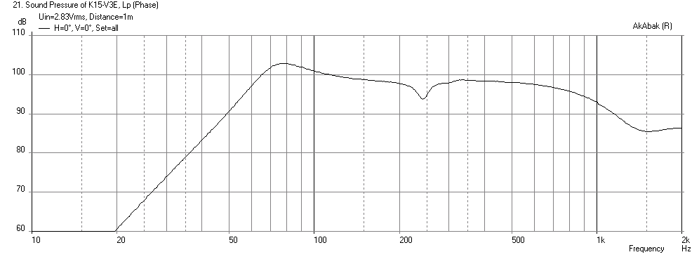

Freddi,
At 0.65x scale you get a little more bass extension with some reduced SPL compared to 0.55x scale case - not a bad performer with 95+ dB sensitivity:

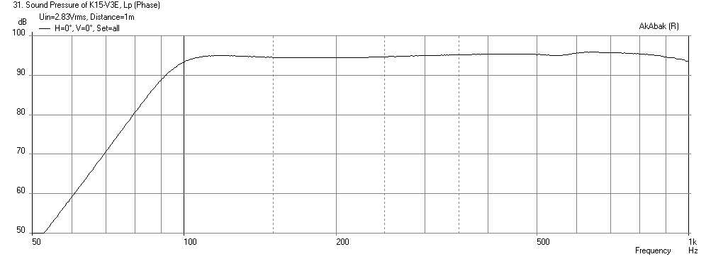

For the BP102, the response seems a little skewed to the bass:
thanks so much for your time - - it might not peak on near cutoff depending upon how tuning goes but the loss in spl isn't good. B102 had its magnet size reduced, raising Qt and killing upper mids and treble - but there's enough for bass guitar use - especially considering only 1-10"
for Delta10a, should I build 0.6 scale then tweak rear chamber volume with foam core? How do changes just in front chamber volume affect response when going upwards from 0.55 scale?
in your reply you said "BP102" - was that a typo as Eminence makes a "BP102"?
B102 as a direct radiator - old 59oz magnet version vs new 45oz magnet version
thank you very much for the B102 sim - (that is the later model with qts ~0.39?) - that PRV sim looks phenomenally smooth - do you have K15's shelves in that sim?
