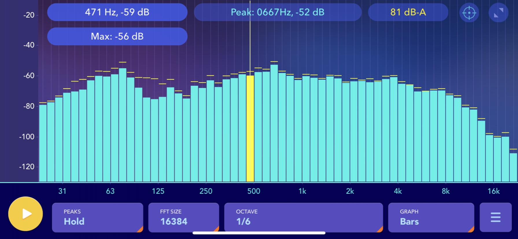

Ok I downloaded an audio spektrum analyzer on my iphone and am playing an mp3 of pink noise and this is what it looks like. As far as I can tell it looks like i am dropping in the lower range from 80 to 250 and the highs roll off at 8k
I am using a sub, the music sounds pretty good but a bit too brassy or tinny and lacking the lower midrange? It surprises me it sounds harsh in the highs but according to this it looks like I am lacking highs? Im a bit confused These xps panels are just hanging from fishing line a couple inches away from wall. Do i need to play around with foam on edges or maybe dampening in certain areas?

Veleric has shown measurements of xps that start to roll off above about 3k or so,so your not doing too bad.
Also I have mentioned many Times on this site and for many years on audio circle about the classic dip in response in the 100 to 400hz that can appear in the room response.
This can give the panels a very tinny sound,this I why I use my low end drivers to cover this area,rolling off the low end driver anywhere between 100 to 400hz depending on where the dip is.
The stretched canvas artist panel mentioned on this site(sorry can't remember the name of the member ) is probably the best all round full range panel I have come across so far ,that is of reasonable size and good sounding and is also pretty cheep from eBay,I got 4 panels for about £8.
This panel didn't suffer from the dip in the lower midrange,if I remember rightly.
All the best.
Steve.

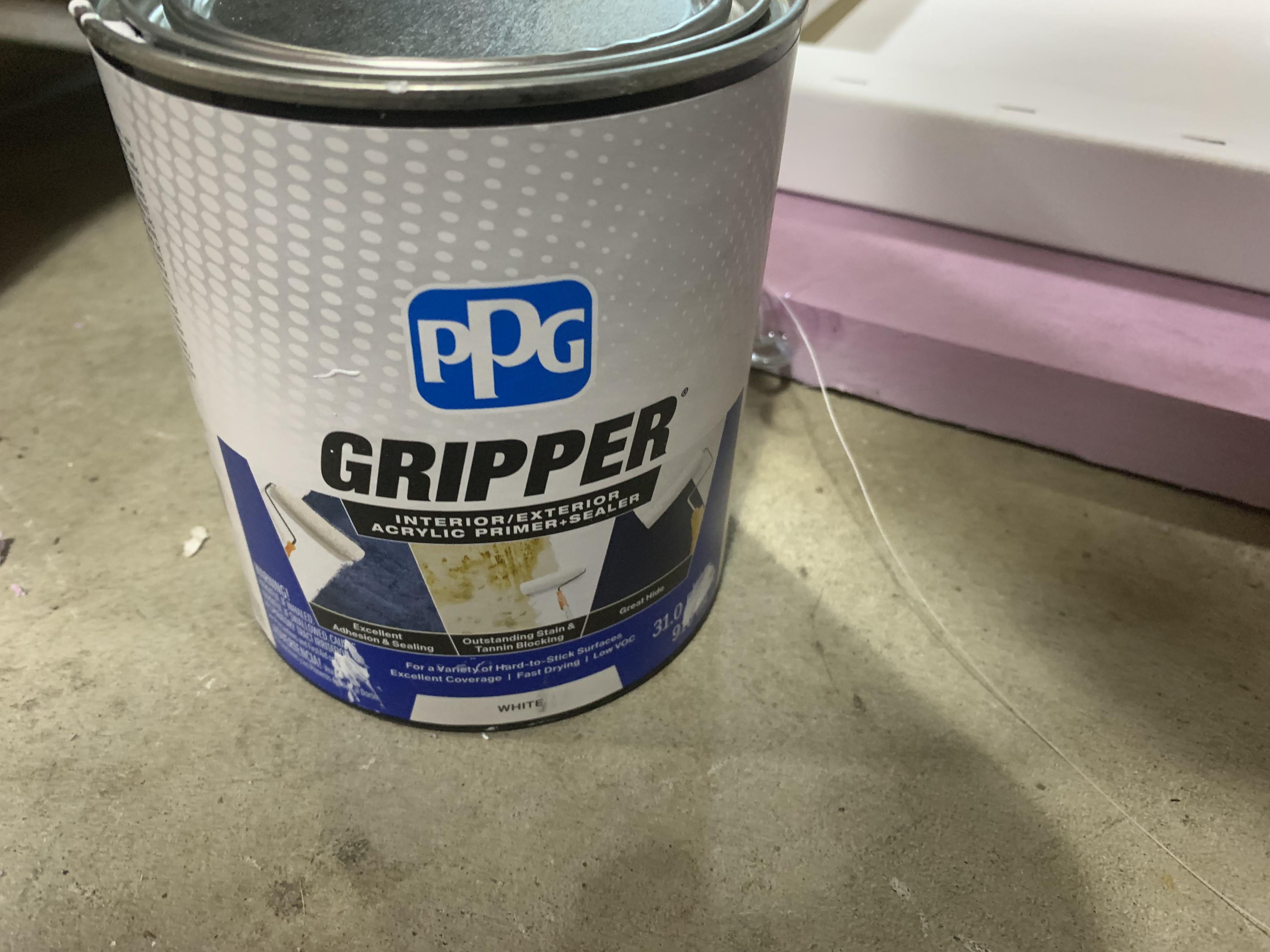

Im experimenting with 18x24 canvas from the art store. I coated the back with PPG gripper arylic primer and also used the gripper to paste a circle of 3 ply birch to back to epoxy the exciter too. Just holding the exciter on there by hand sounds great. Once this drys tomorrow Ill try hooking them up and get the full effect and see where they are at.
Im thinking im gonna try a set with 2 exciters so I can wire them in series for my 8ohm receiver.
I can't decide though should I paste them on 2 separate pieces of wood or just one longer piece of wood?

I used pva ,2mm bulsa ply 6x4inch ,the frame was about 18x12inches,the panel was placed in the centre of the picture frame,the exciter was slightly offset on the ply ,not sure this was necessary,as the canvas would dampen the panel anyway ?and having everything centrally mounted would balance the canvas ?
I covered the whole panel canvas in thinned pva ,this helped stiffen the canvas and also tightened the surface through shrinkage .
I did also cover the front surface up to an inch from the fame in cascamite which made the surface very rigid ,but over time it cracked badly and ruined the panel.
I could do a recording of the panel to give you an idea what it sounds like but it might buzz a bit?
Steve

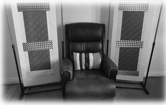

Good day folks
Firstly, would like to thank this thread for giving me inspiration and guidance!
Ok, Just returned to the UK needing a new sound system had my eye on this for over a year now. But just couldn’t part with that cash. I stumbled on TI YouTube channel and this was the project for me..
Bought 2 Dayton Audio DAEX30HESF two bits of Birch spray varnished attached them and was blown away instantly, the way the music filled the room was and experience of its self. Not to mention family members saying “ It sounds like the piano is in the room”.
As I’m a lover of heavy reggae the DAEX30HESF struggled to cope in this environment, so I narrowed the problem down to excessive movement when introduced to bass.
18” Active Sub added
EQ added (with sub out)
Better but still too much wobble lower mids
XO added
Delivered a lot more versatility to my set up, but I wanted more depth at higher volumes.

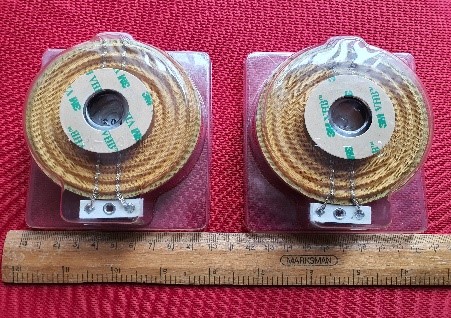

So I found these 100 watt monsters
2Q==
Attached them to a naked bit a ply and it was quite disappointing hollow tinny still no depth.
My 60 watt max amp couldn’t drive them
250 watt per channel amp added
With the XO and EQ onboard sound manipulation was easy. However, there was a hum coming from the naked boards? You pros call it resonance, so I didn’t varnish or paint wanted an easy fix so I went for self-adhesive vinyl.
Now I have a crystal-clear PA system (for a fraction of the cost) that fills the whole house with music regardless of room upstairs or down.
Handles any music you throw at it adding a depth of sound that most don’t even know was there.
The best bit is that my two main speakers look like ….. See for yourselves

Sucra2.
Wow !where did you find those exciters can you give more information on them.
They are a bit overkill for me as I only at the moment use small panels with 10watt exciters,but in the future, who knows.
Also how about some pictures to show how you have mounted them if that's OK.
Steve
kaptajnThomsen
The build was very simple as I have no power tools or electronic meters.
This thread gave me the idea then I left the rest to intuition and creativity
I had a vision of what I wanted to achieve and set about doing it.
My method was the bog standard method, including nails and fishing wire. However, the vinyl thing happened because I didn't want to paint or spray....
I am very much an eclectic when it comes to music so I would recommend EQ XO to have complete control of the sound to tailor it to how you like it..
P.s
Sitting in that chair gives you a feeling of wearing headphone
I have another pair of the big exciters if anyone needs a set pm me
