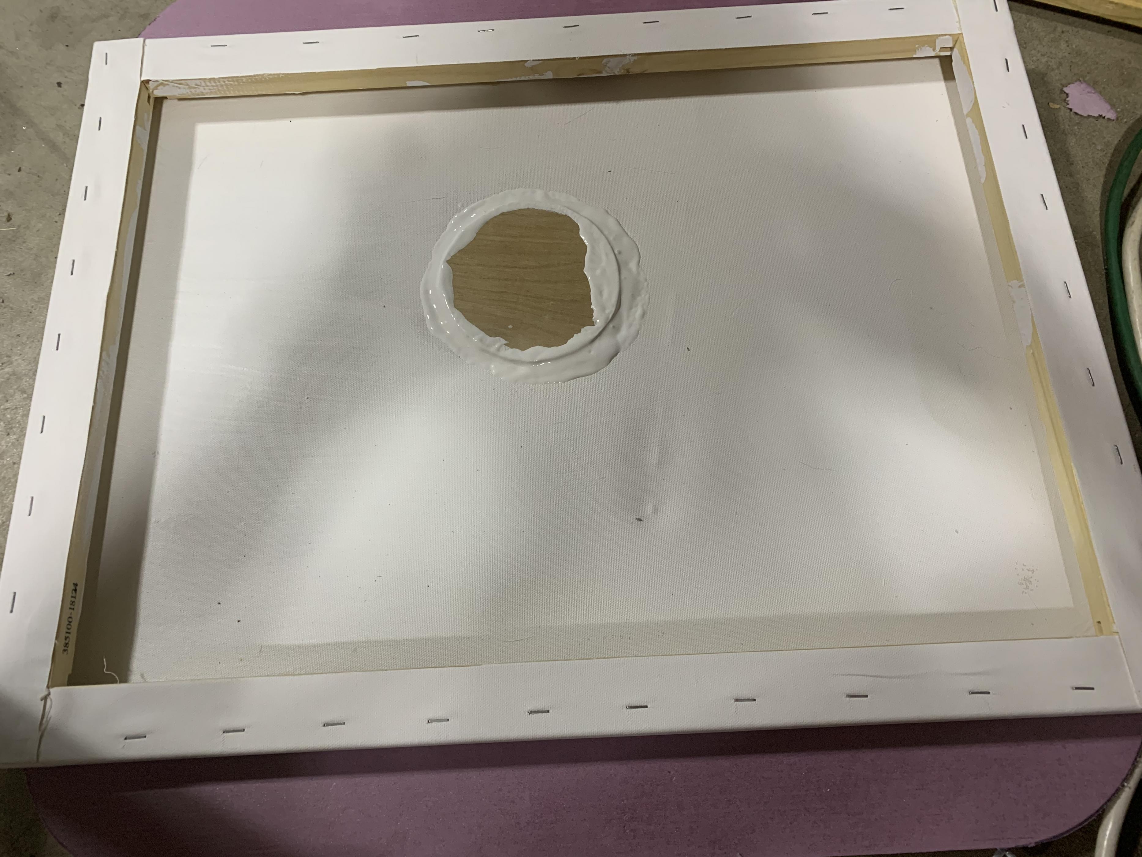

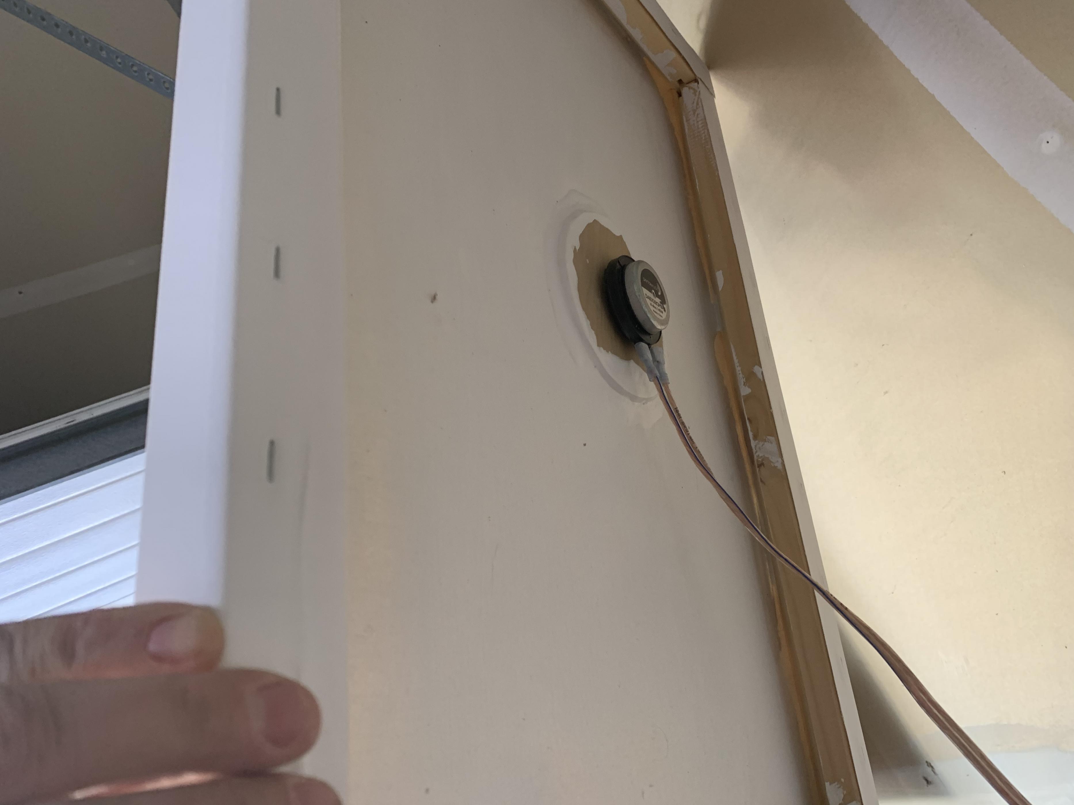

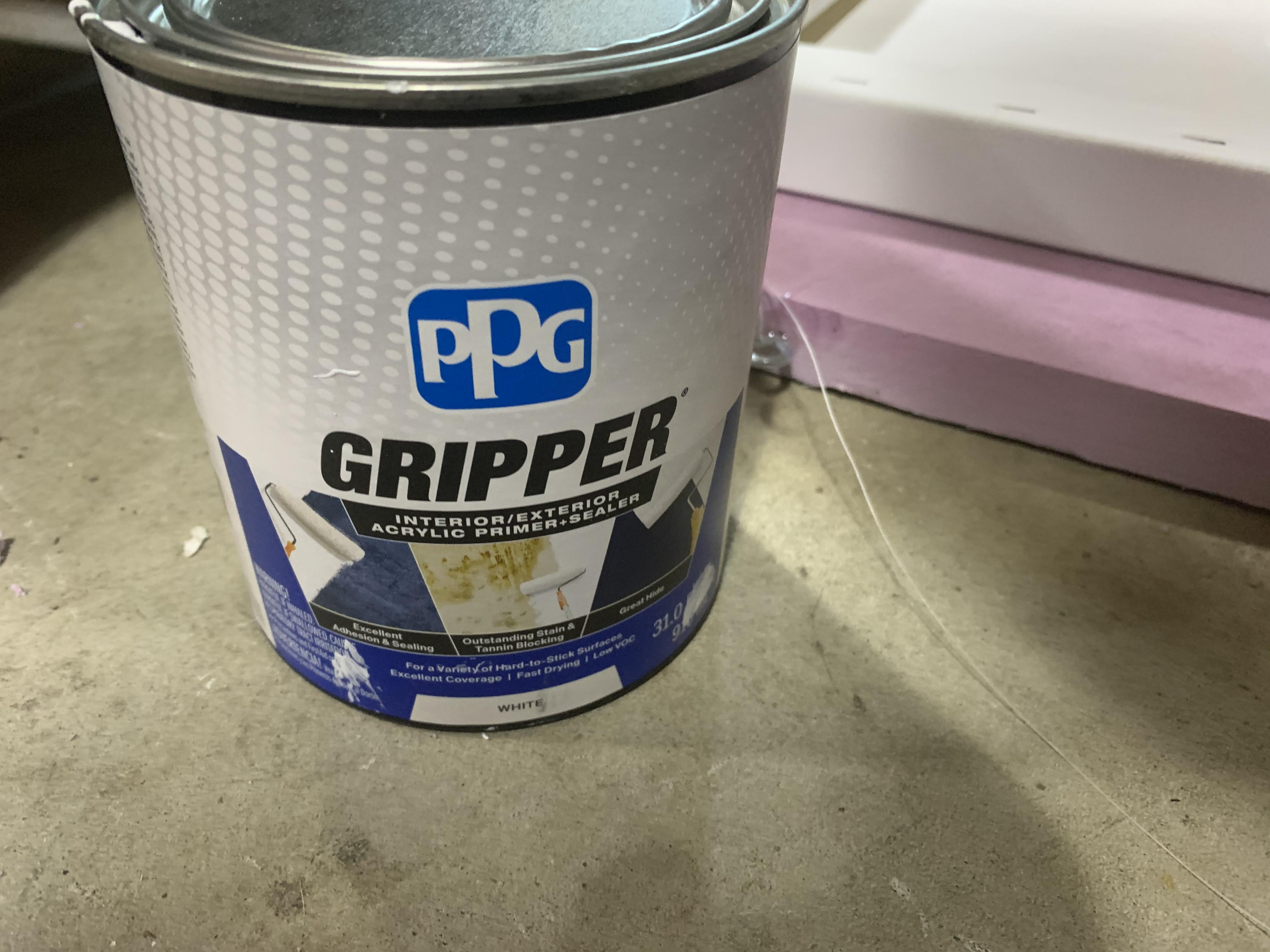

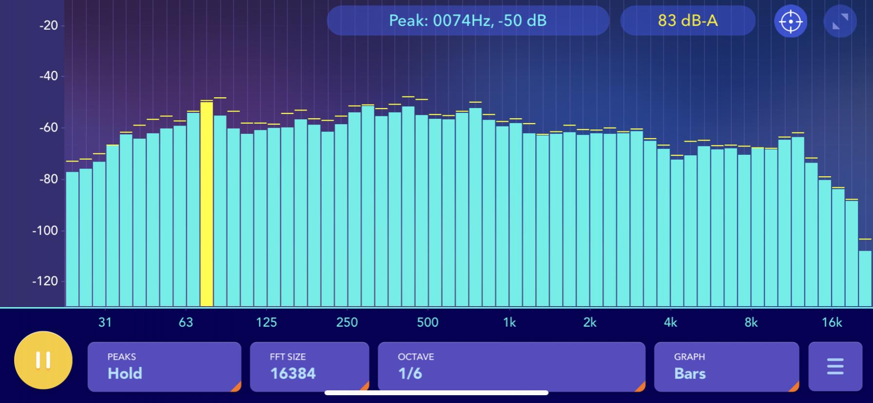

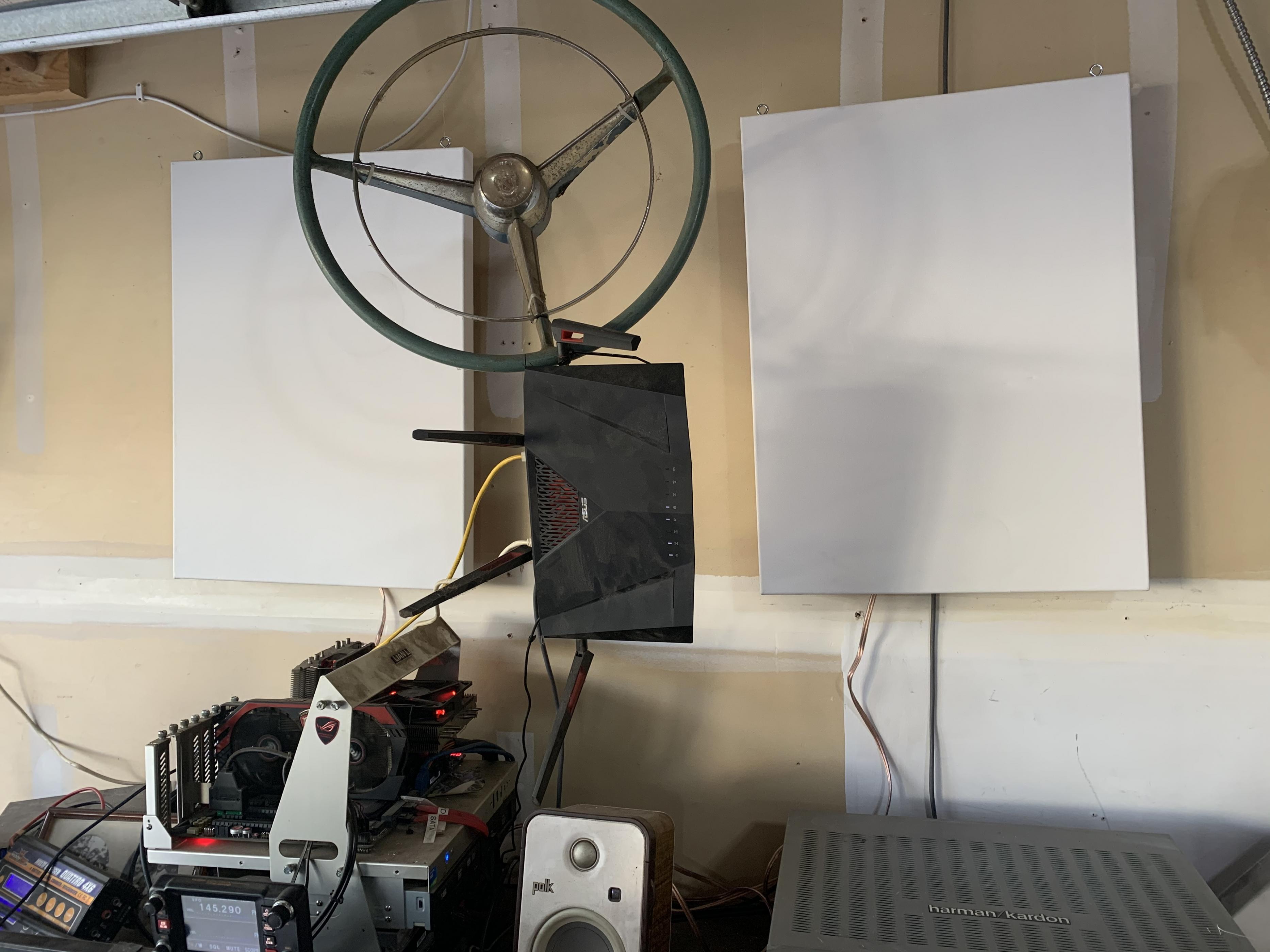

Wow so just hooked up my canvas for the first time and wow Im impressed!
18x24 canvas, coated backs with PPG gripper acrylic primer. Also used the gripper to paste these 3 ply birch circles to mount the exciters onto.
Im using a home receiver that is supposed to take 8ohm speakers and Im running a single 4ohm exciter on each at moment. I have a 100w powered sub under the desk that is just barely has the level turned up maybe 2 nothes and I am not using any equalizer.
I am using my iphone to test the audio signal with a MP3 of pink noise -12db I got off the internet somewhere and these are the results I got. granted the iphone is not going to be as accurate as you audiophiles equipment but look at that spectrum all the way from the low end to the high end.
First is without the sub level on at all and the second is turning the sub on just slightly.
I think that is pretty impressive.
Now that these are successful Im gonna have some canvas with pictures of my kids made to hang in the house as speakers.
57buick.
I presume that is the steering wheel of a 57 buick in the photo?
At first I thought it was some crazy art work welded together,couldn't figure it out,then The penny droped.
The iPhone microphone will probably be restricted in the highs and lows ,but from your pictures of the eps it gives a good response down to about 40hz.
You could try what I am doing with new panels with the exciter more central,or maybe mount the exciter on to a spine to help prevent exciter sag ,on the canvas as well as the coils ,and maybe drive the panel better in the low end?,I presume they are in piston mode at this point? My panels are very stiff in the central area with the cascamite and the 4x6inch bulsa ply.
I will test with clamps and some blu-tack .

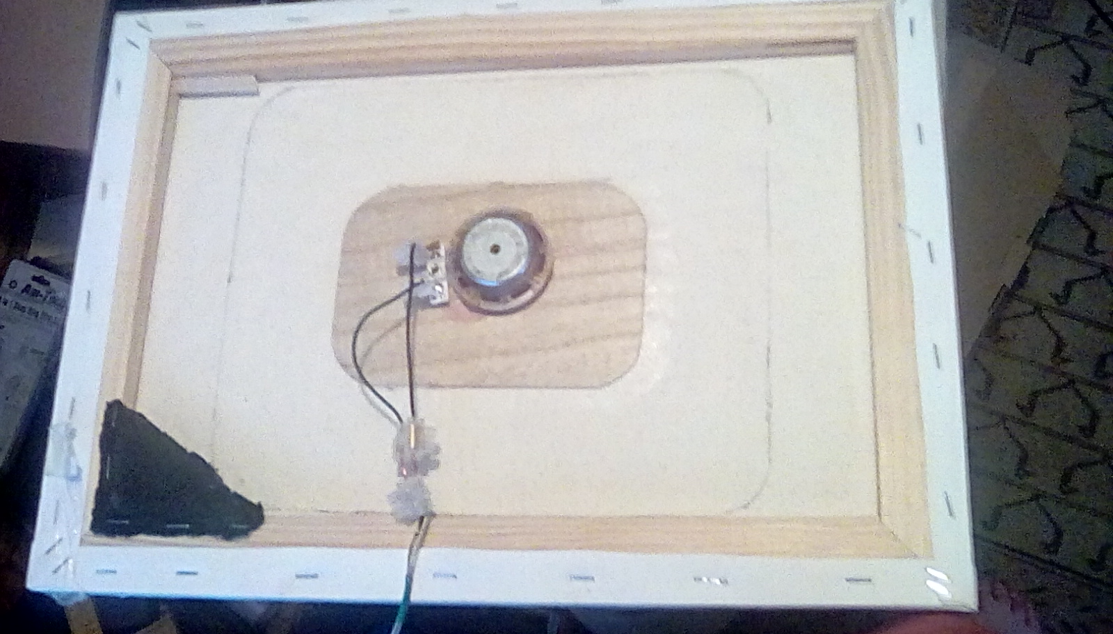

57buick

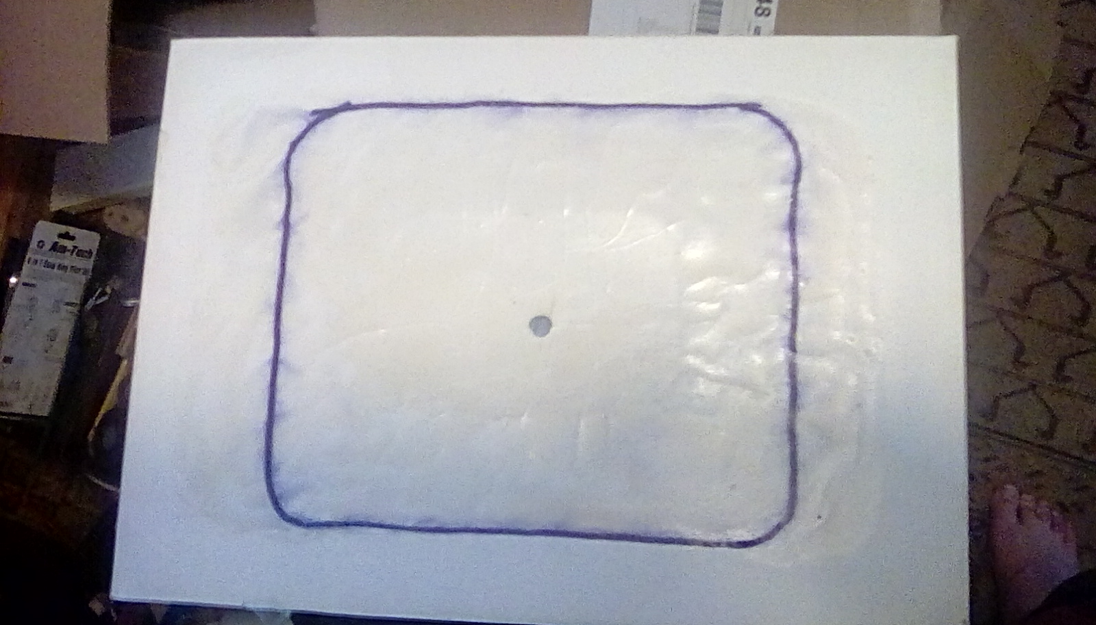

A quick picture of the picture panel before I clamp a spine to the exciter.
The blue line is where the cascamite was supposed to stop but I had a bit left over so went closer to the edge.

Yea Im gonna try a spline and see what that does, hopefully give a little more spl too. I was just impressd with what a simple setup could do. Now to start fine tuning.
The steering wheel is actually from an old 55 Chevy Nomand that was my dads car when he was a kid.
57buick.

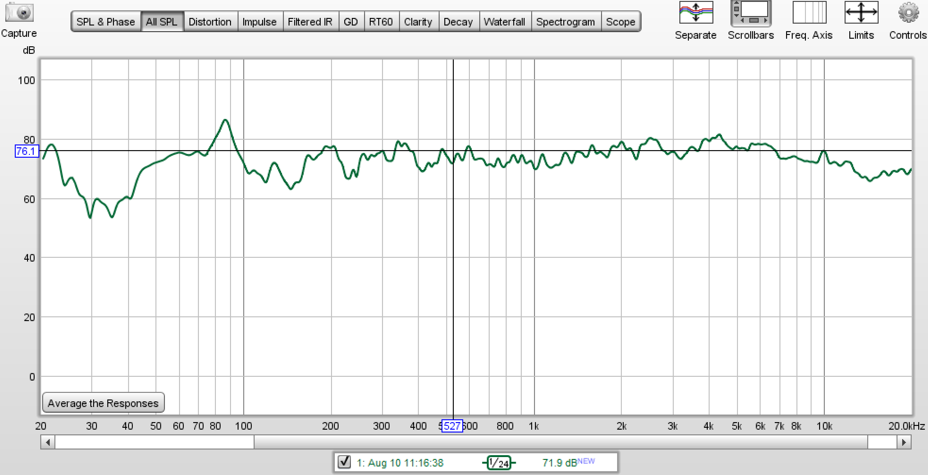

Some fr response pic with spine, I should have taken some pics before adding the spine,don't think it's changed much though.
Once again sorry for the poor picture quality,my other tablet has packed up so this is all i've got.
Still not a lot below 40hz,I don't think the 10watt exciter has enough power to move the panel below this,it's hit a brick wall.
First photo at 1mtr second at 3mtr the peek in the 400to 500hz lower mid is the annoying sound of the cascamite I think?
But apart from this the response is within +and-5db from 20k until 100hz when the response increases between 5and 10db till it drops like a stone at 40hz.
The dip at about 200hz, which is worse 3mtrs into the room ,is the room suckout ,even my TLS suffer from this.
Not bad for something so simple to make,as you say surprising how good (large) it sounds for such a small panel.
Sometime ago I tried two 15 inch drive units without cabinets to see how they performed,don't remember them producing this much low end and that was with two units?
And they were just running below 400hz.
Also this panel is 3ft off the floor and 3ft from the wall.

This is a graph of my panels reaching down to 20Hz. The problem is room modes in the long wavelength bass region (below Schroeder.) My speakers generate low frequencies but my walls, ceiling, and floor cause the long wavelengths to interfere with one another and cancel out or peak in different parts of the room.
To reduce low frequency cancellations and peaks you'd just need multiple panels (multiple subs) positioned and equalized for low frequency modes using a strategy supplied by Harman/Welti or Earl Geddes.
