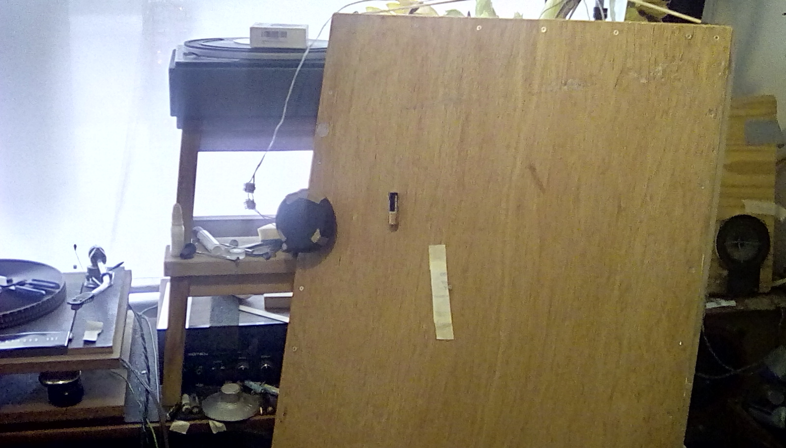

Actually, I just thought, my rigid ply panels are a bit like a stud wall.
What would it sound like if I screwed the exciter to the timber frame?
I'll have to get out the other hdn8 that hasn't fallen apart and give it a try?
Should be interesting?
Or not🤔
Steve.
Photo of panel and exciter screwed on to side frame while recording.
A bit of a mess but good enough for a quick test.
Steve.
Chdsl So you have gyprock glued directly onto a brick and mortar wall and you want to try an exciter on the gyprock? Is that what you're saying?
If that's the case, I don't think it's going to work well. For LDLs to work, the panel has to be able to flex and vibrate. On a stud wall, gyprock can work because it's only anchored at the studs but the panel can flex and vibrate in between and it can produce some volume because you've essentially got a cavity behind the gyprock and between the studs. If your gyprock is glued to a very rigid brick wall, it will be constrained from vibrating and flexing everywhere (not just on the studs 16" or whatever your local building standard is apart).
What you'll be doing is creating something very similar to when they do seismic for oil exploration using a vibro-seis unit which is essentially a huge exciter on wheels. The energy from the exciter will travel through the gyprock and when it hits the interface with the brick a portion of it will reflect back and the rest will refract and continue propagating further into the brick wall. That energy will continue going through the brick wall until it hits another density interface and the same thing will happen again; some will reflect back and the rest of the energy will refract and continue on into the next medium. The bottom line is, most of the vibrational energy may be lost into the brick wall and whatever is behind it and what energy that does stay or come back to the drywall, will not be able to create much sound because the drywall layer is so heavily damped and constrained because it's glued onto a brick wall which is not going to vibrate/flex much from the little bit of energy your exciter will impart. THe vibrations in the gyprock will have almost no amplitude. Based on this reasoning, my guess is that putting an exciter on a wall constructed in that way will yield very satisfying results but what the hell, I've been known to be wrong before so give it a try and see what happens.
Dangerboy.
You had me at,I don't think its going to work well😊
I was thinking it was a drywall .
I suspect not many people have an internal stud wall that isn't joined to a neighbour.
And I certainly wouldn't recommend building a fake stud wall to mount an exciter?
Steve.

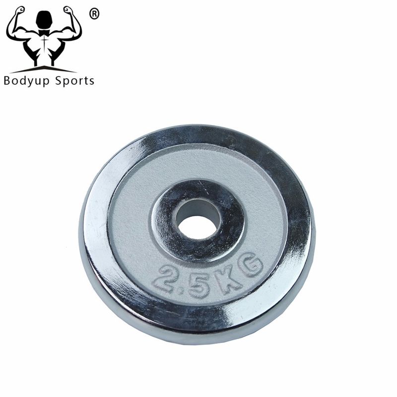

If it works u could bling it.

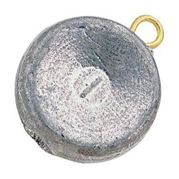

I want to paint a chladini pattern on my panels gold/black. Thinking about mounting a daex25fhe-4 to the front side, might look cool. If it would help the low end i could add add 3oz (85g) lead fishing weight to the exciter. Run a piece of fishing line from top of panel before gluing it if voice coil sag was an issue.
