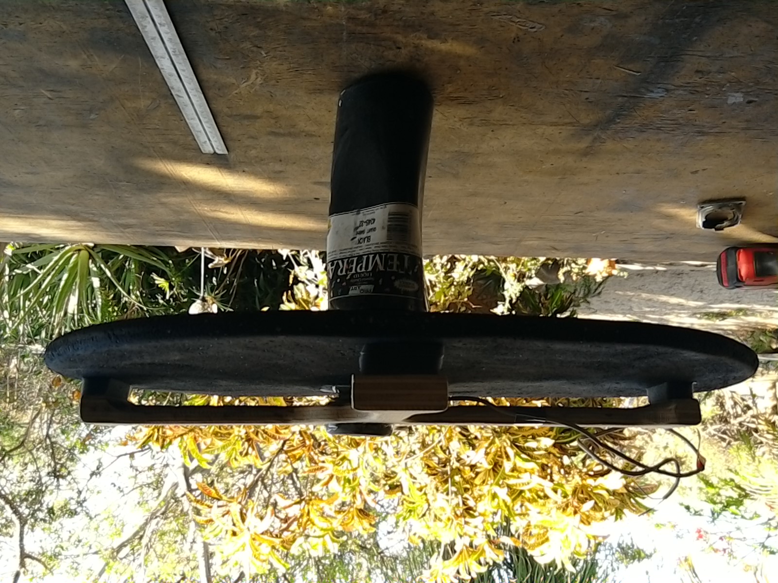

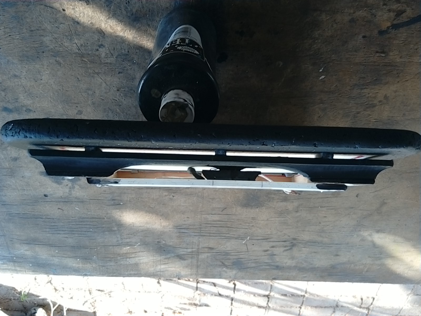

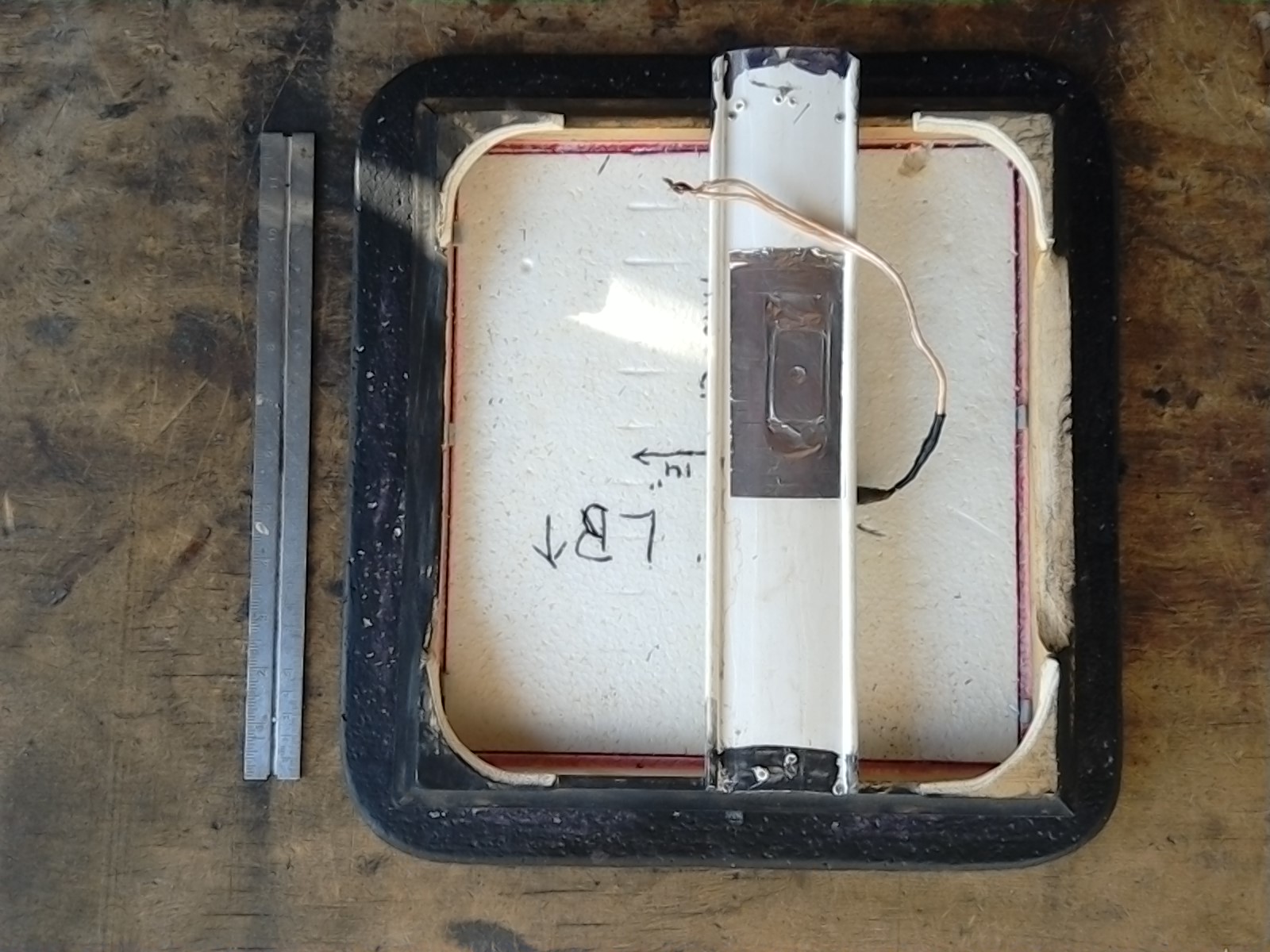

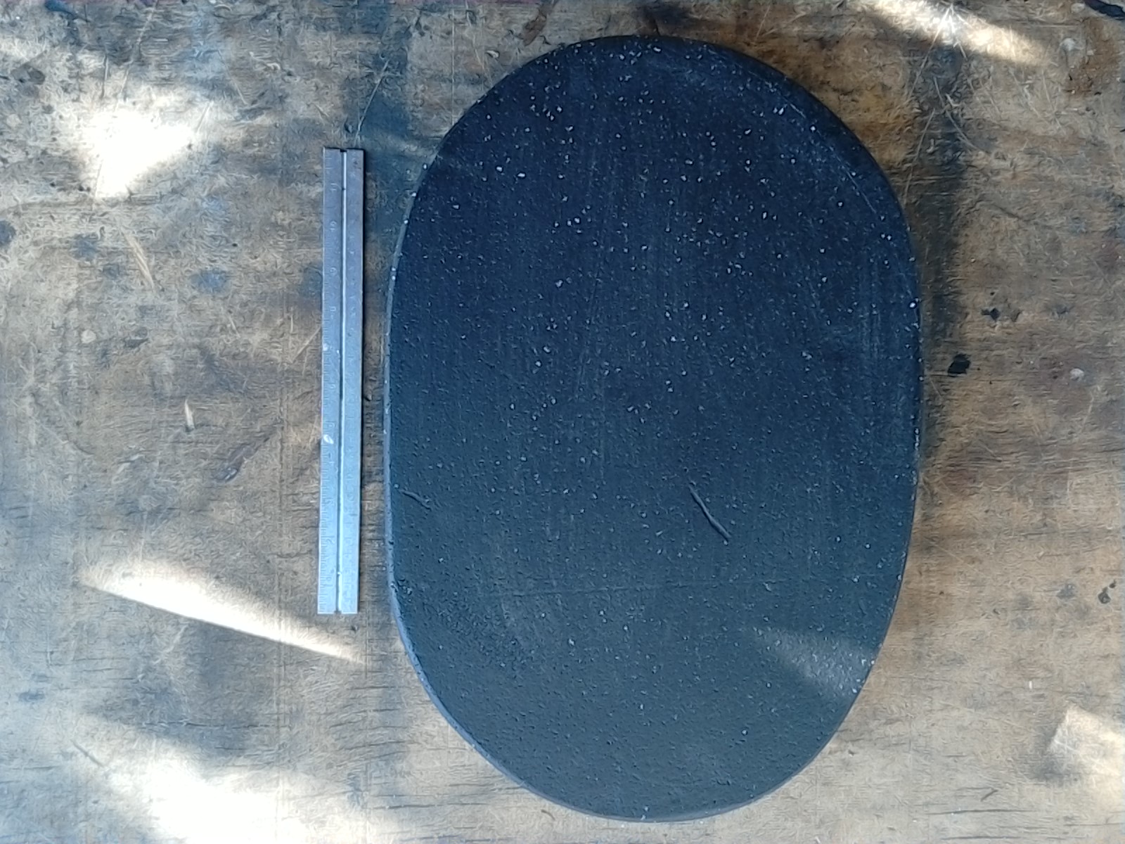

Here is my latest set build. I started off with 1" EPS and used a 4" wheel grinder to ramp down from the exciter placement "pad" to mostly 1/4" in the larger flat areas and on out to the edge. They are not perfect by any means but pretty damn close to what I was shooting for after a bit of finishing up with hand sanding. Just gotta' be careful not to take off too much with the grinder at first. The spine is pretty much self explanatory.

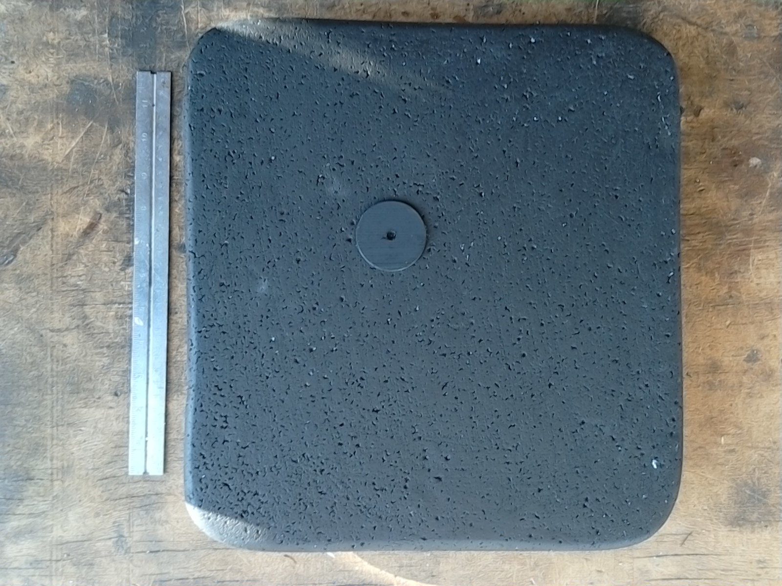

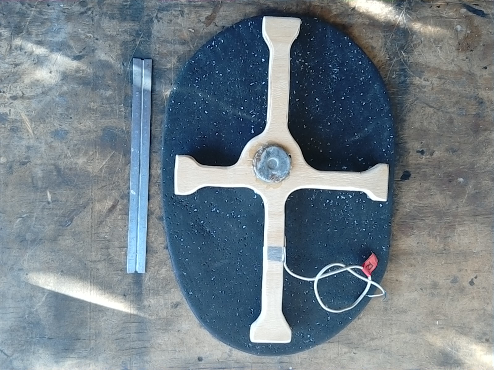

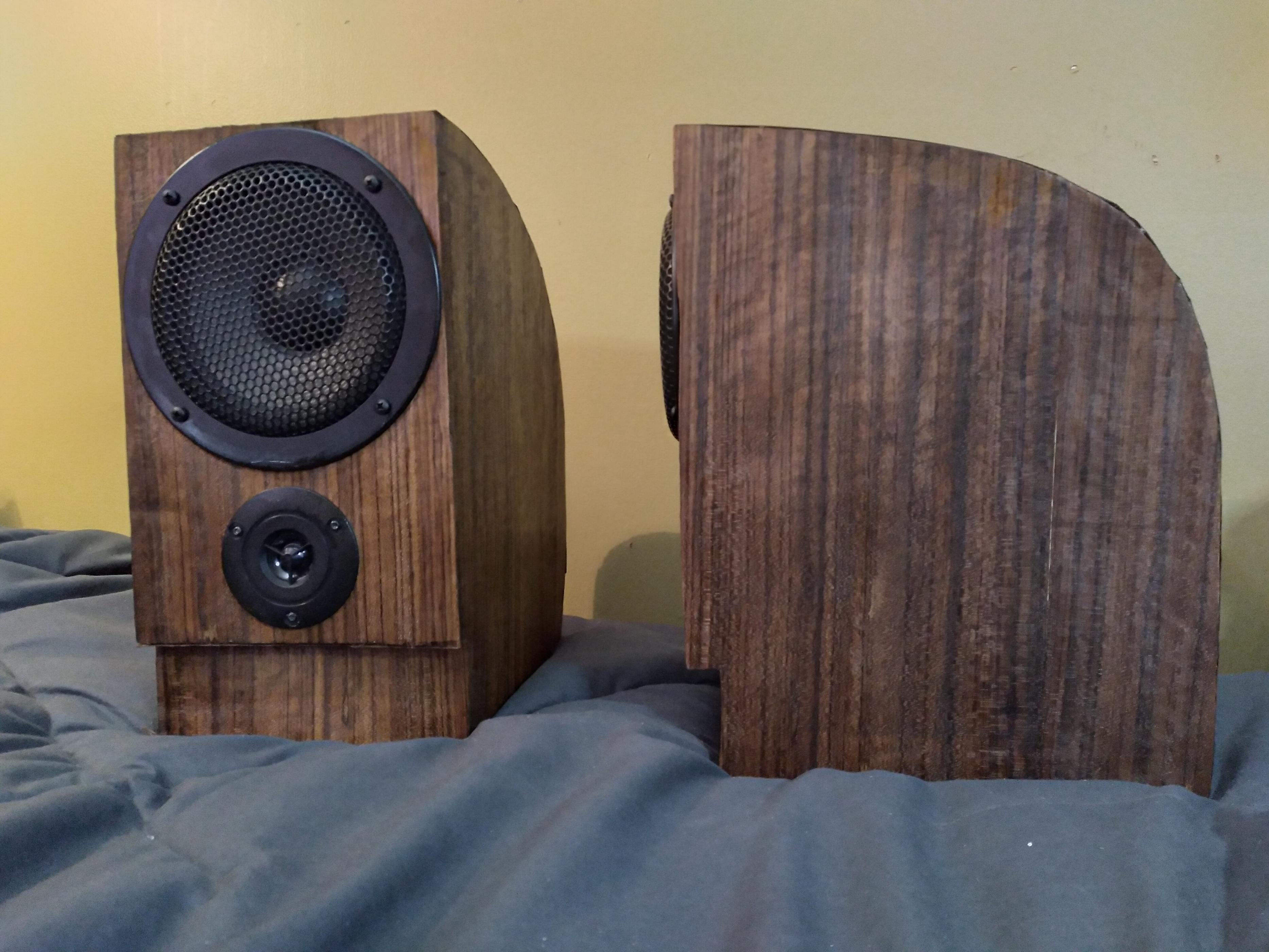

I made these to replace the smaller square set pictured. Those were my very first experiment with self made TV exciters. They are pretty good but have a harshness to them when played on their own. The small size and nearly square shape and the tiny voice coil on the tiny "exciters" are probably the culprit there. The 2" wooden circle placed directly in front of the exciter did seem to knock back some of that mess, but not much.
The new ones here are a definite improvement. They are 14 x 20 inches freehand. The exciters are also salvage jobs but have a larger diameter voice coil and more panel area to work with. That harshness is gone! Thank goodness. These sound pretty good so far with music but I am getting a few buzz areas from the left one when slowly sweeping with an online tone generator (An absolute must for dialing in these homemade tiny things before the final epoxying into the spine, the slightest bit off is failure). I can put my finger behind the panel and pull to me a bit from behind at the point where i have my foam contacts and the buzzing stops. There is no need to address these problems at the moment because all the glue, epoxy, paint/water/pva coating mixture needs to cure for a few days at least. The paint you see in the pictures is what I mix with water and the yelow PVA wood glue for coating.
I use these for music and surround for movies. I just leave my old Sony amp in auto mode and let it fly between 2.1 and 5.1. I also made a 8 x 14 inch center channel DML the same way and have it over the tv paired in series with a homemade center channel box type I constructed last year that lives under the screen. Let me tell ya', voices are amazing now.
Well, burrito time for me, that's it for a while, hope this helps someone.

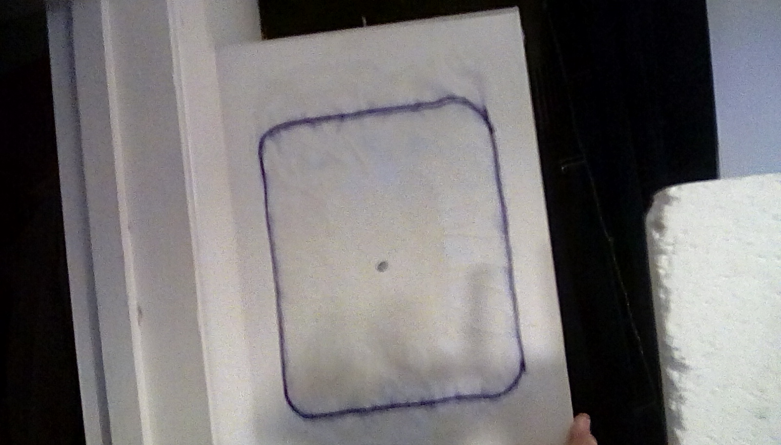

The exciter you have chosen should work very well although the 4 mounting holes look a bit of a pain? If used?
I'm no expert but pva is water based and will shrink the canvas,this I know.
You could add a dye or maybe water based paint to the pva for colour?
Acrylic is not water based ,so am not sure of the effect of shrinkage?
I used pva to glue the small panel to the canvas so it was an obvious choice to coat the rest of the panel in the same way,with the bonus of shrinkage.
I also purchased 4 very cheap canvas picture frames on ebay,so no work needed to do to the panels,at all !!!

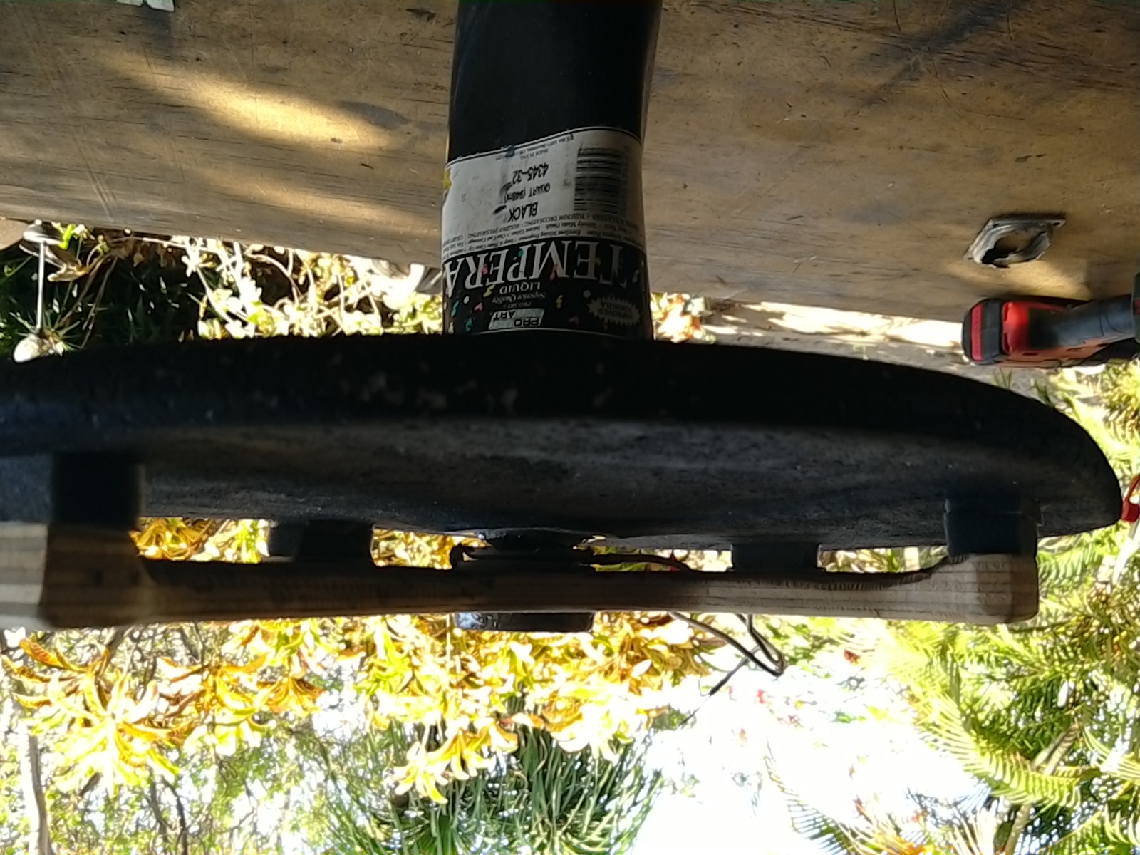

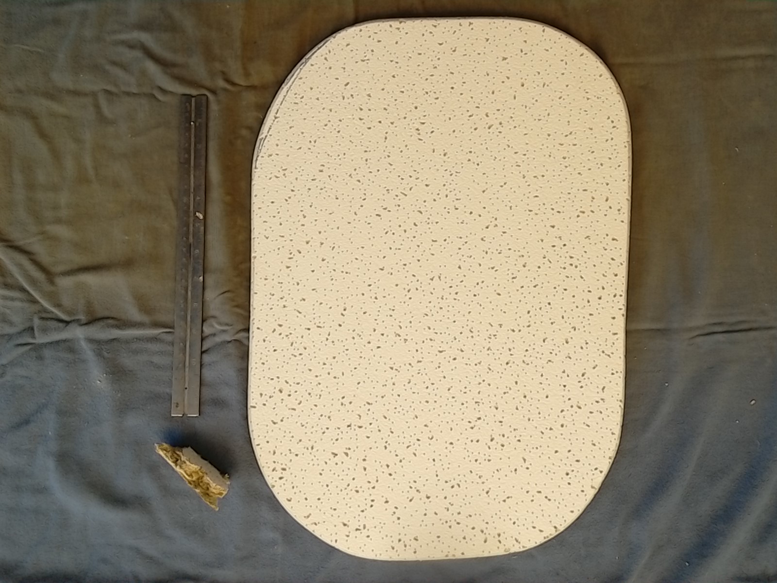

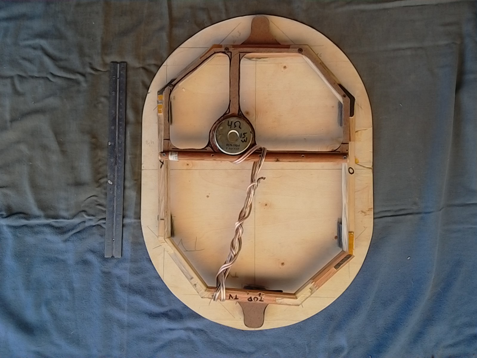

Well after trying to fine tune these "oval" EPS speakers (pictured below) I have come to the conclusion that using the "cross shaped frame" design is a no go. The four foam contact points do work but I had to add extra foam top and bottom to get rid of buzzing and it caused the panel to lose volume because of the area size they had to dampen. Lost a ton of flexibility.
A frame all around as pictured below, no more than 1 1/2 inch in from the edge is for sure the way to go as you can apply small pieces of foam directly to any problem area with minimal damping as you use a tone generator to dial in the buzzing. As in said picture (yea I know, its crooked as an Alabama back road) you can see where I had to add extensions top and bottom to tame the buzzing on that piece of 2mm ply that it was attached to, and it worked.
I have some thin MDF that I'll be using to make an entire "back frame" loop to glue to the cross because they are sounding good. I also attached a photo of some ceiling tile I found a crap ton of at the dump the other day. I thought for sure I would find at least some honeycomb cardboard and some nice pieces of EPS but no. I'll be checking these tiles out when I get some real exciters.

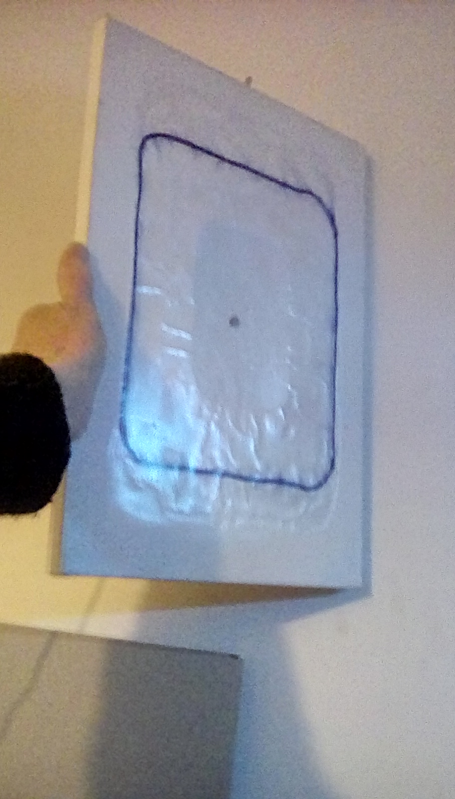

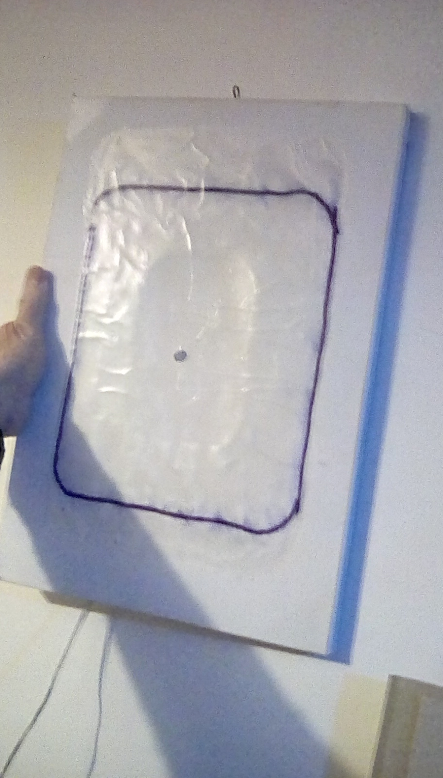

i did a very quick test of moving the art panel (30x42cm) close to a wall to see the effect on sound.
as you can hear(I hope) the panel starts to sound tinny and hollow the closer you get to the wall but 1ft sounded ok,I think?
having one edge of the panel hinged to the wall and the other end swung out seamed to work quite well , maybe better than having all of the panel 1ft from the wall?
moving the panel too close to the wall reduced the low end too much hence the tinny sound
i will take some pictures to show what i was doing.

To all.
These pictures give an idea of the positions recorded.
Very basic I know,but it worked.
Smaller panels seem to be able to go closer to the wall with less bad affects than large panels ,my 4inch panel even closer.
I recommend trying different positions and angles for best sound.
Close parallel reflections from the back of the panel and wall are not very nice sounding,so in my mind should be avoided.
But when using small panels ,it's surprising what you can get away with.

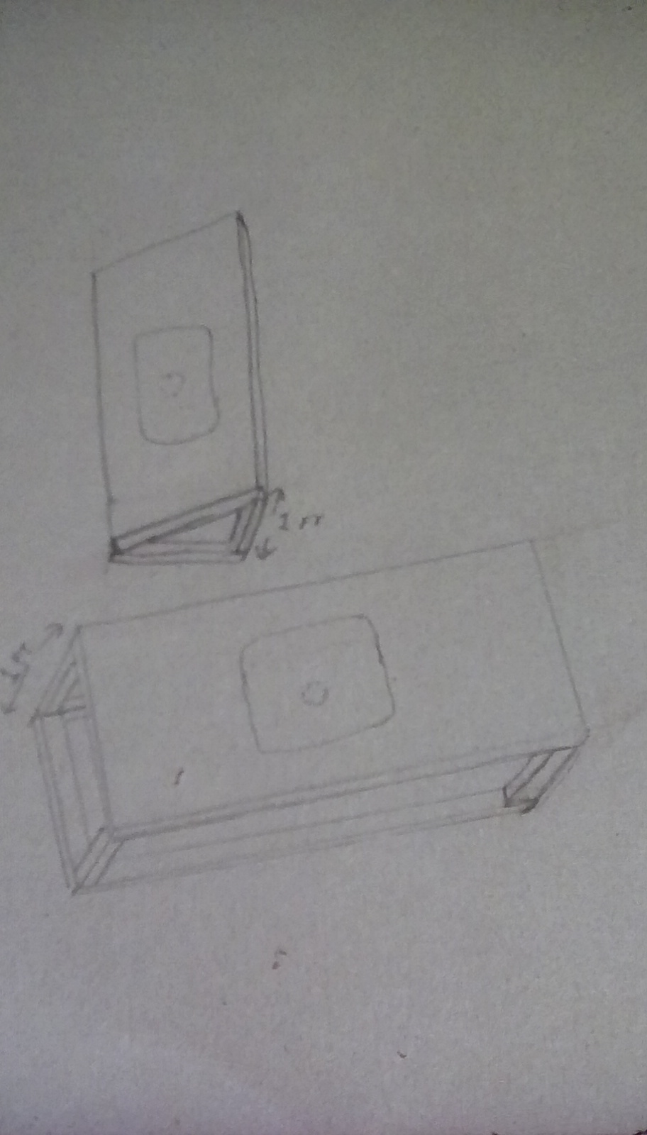

Just a few thoughts and observations.
I noticed that when I placed the frame on to a small table and held it tight and hard against wood,that LF increased a few db?
I noticed this on my solid wood frame ply panels some years ago.
So might suggest something like my bad drawings in this picture.
A little bit of acoustic wool behind the canvas could be a good idea ?
You could also cover the sides in speaker cloth to hold the wool in.
This would make the panel look more like a normal speaker box?
Obviously the type of wall the frame would be screwed to would make a difference to the sound?
Or screw small door hinges to the naked art frame and wall to adjust to taste,this could also be done to the full square frame also?
Mounting the hinge on the short side of long side?

I wouldn't have thought pva and foam would work well as a panel?
