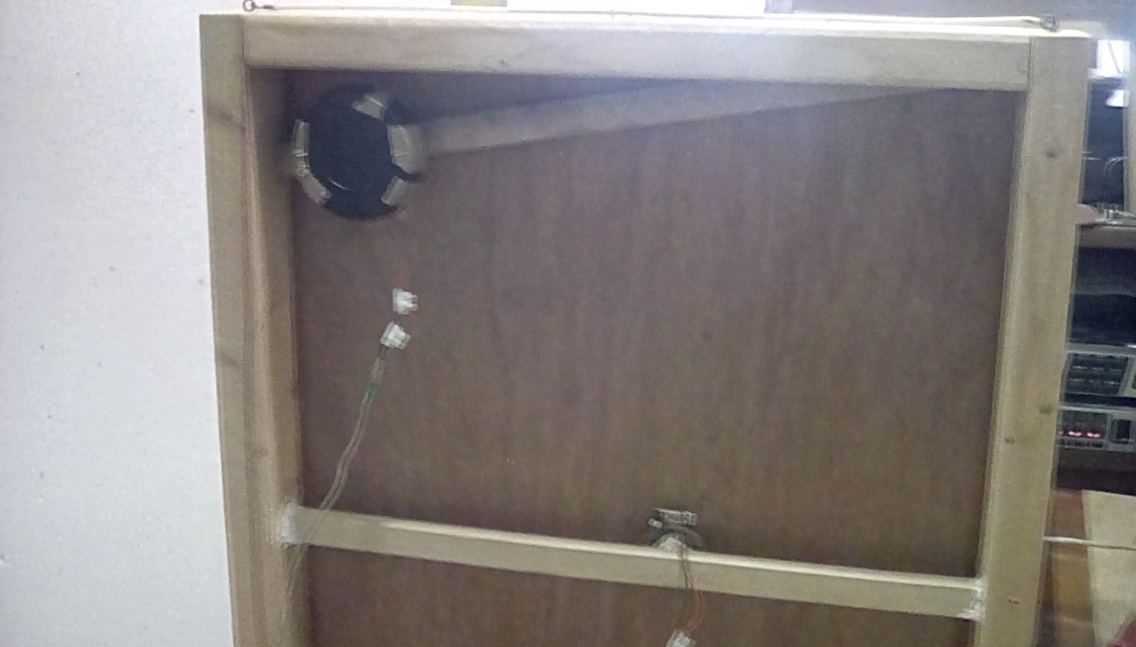

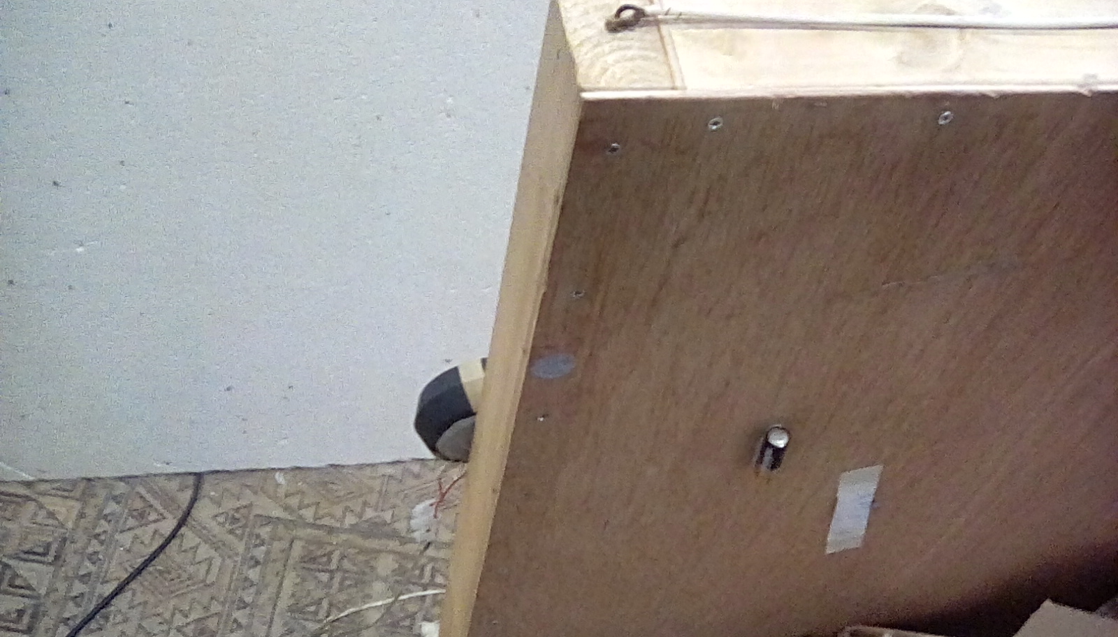

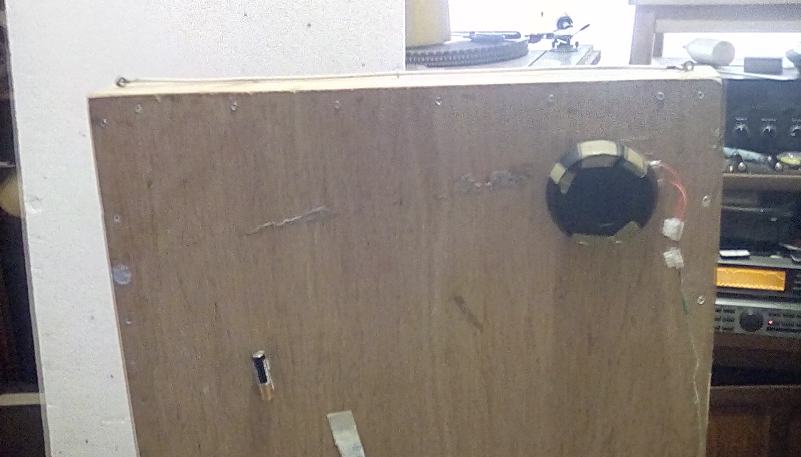

Different positions of the exciter.
First pic on the back of the 6x4cm wood.
Then on the back of the 25mm.
Lastly on the front of the 25mmm position,using the same drill hole.
All recordings made with the panel facing forwards.
All just random positions.
Steve.

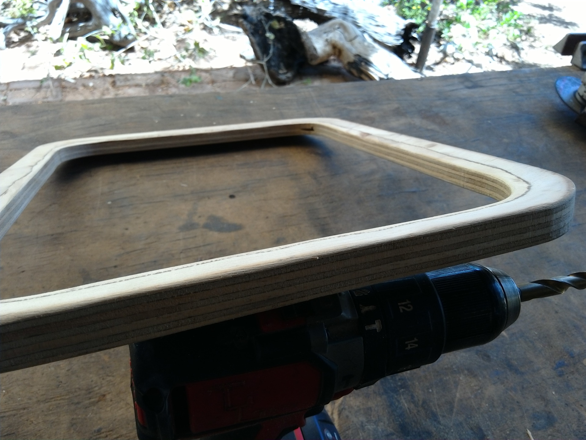

Tried It Liked It
I used this method for my first build and was very happy with the results. I made a pair of exciters out of some 10 watt TV speakers by removing the cage and cone and epoxying them directly to 14" 19" - 50/50 treated EPS.
The frame was 1 1/2" in from the edge and used 2- 1" pieces of weatherstripping foam on each "frame" facing attached with super glue.
Also used a spline running horizontally across the back. They sound pretty good and am using them to compliment my box speakers at the moment.

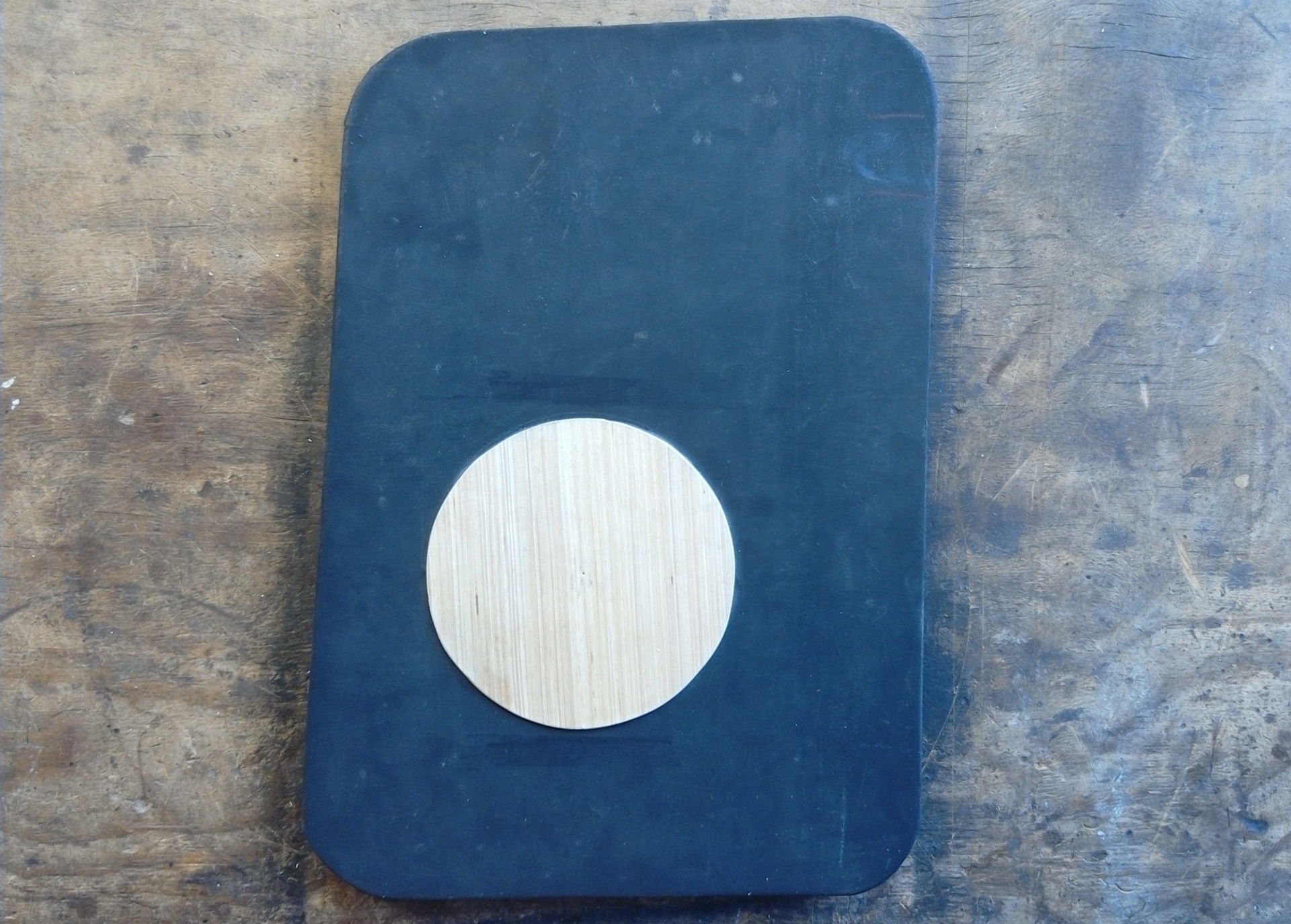

My contribution to the quest of experimentation with DML's..
This is the best design that I've worked on to this point! Mid/Highs are very nice and plenty of bass. I added sticks from the circle towards the lower corner for s&g's but I believe the bass response was better without them!
The wooden circle provides plenty of sound for the mid/highs. The canvas creates smooth bass. Just make sure the wood items are securely glued to the canvas. I used spray adhesive used in car interior repairs for headliners. I ran a bead of hot glue around all edges just to be sure..

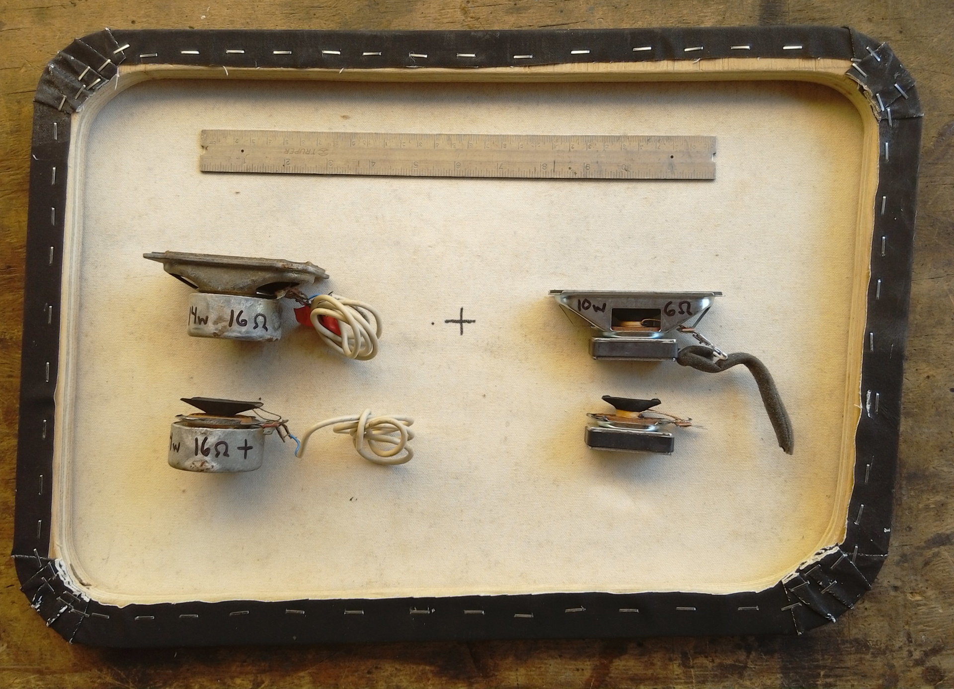

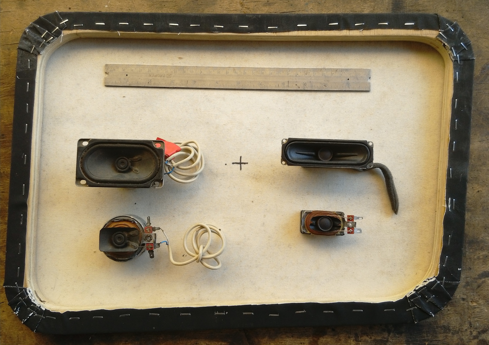

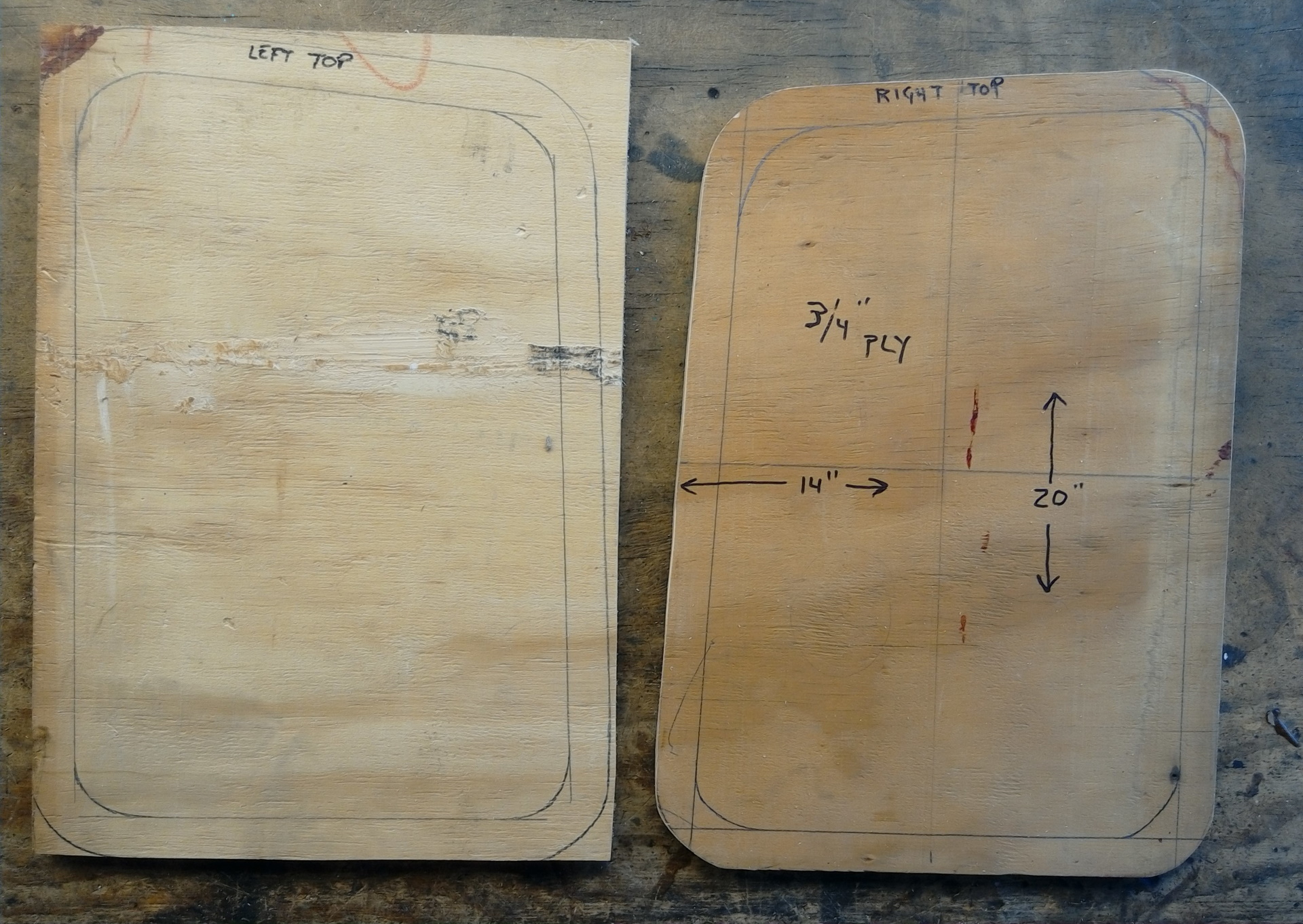

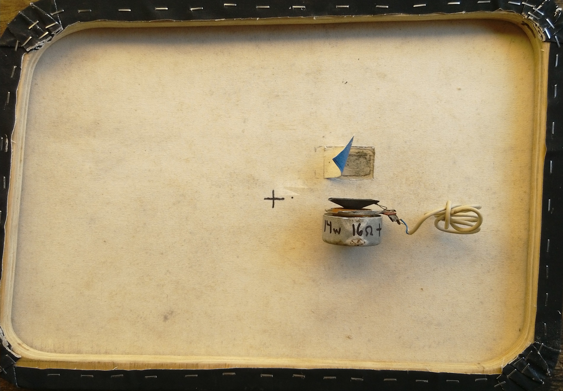

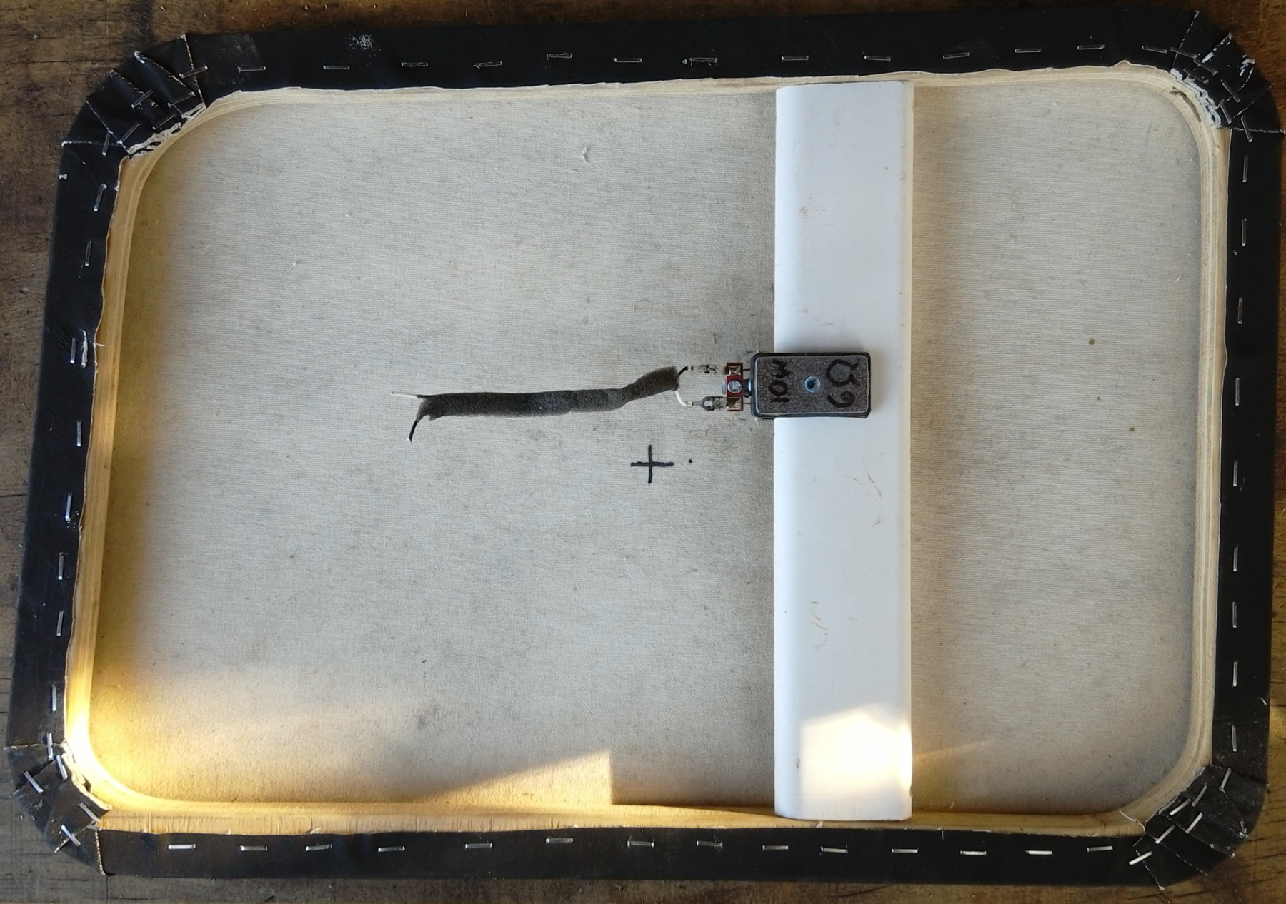

Photos of my first canvas build. Layout has left and top sides on an angle leaving a 90 degree for the others with varying radii all around. Used 3/4" heavy duty plywood beveled with 4" grinder from inside to outer edge slightly to avoid "canvas slap". Piece of 2 1/4" plastic trim used as spine that exciter fits in snugly for testing purposes.
The canvas is from a painting I started years ago and abandoned, just regular gesso canvas with the thin black acrylic paint. The wooden disc is 7" and is super thin, maybe 1 1/2 mil. I masked an area in the center with the blue tape to be cut out from the rear after the 3M 27 Spray Adhesive cured. Didn't bother lining the wood grain as this will be black also If I decide down the road to use it.
I used the smaller 10w homemade exciter because it was easier to make the spine (these things are super sensitive to proper mounting, they have to be pretty much perfect) You can see how I trimmed the cones down to level with the top of the voice coil and used tape to aid in pouring to level using the epoxy. Even the 5 min. epoxy will not be super hard until the next day which results in a bit more volume, which brings me to the results.
It really has good sound, just not loud enough. Compared to my 14"x19" ESP panels (with almost identical exciter) I am currently using alongside my small JBL bookshelfs and old Fisher 150w sub, I just can't hear them. The efficiency is terrible even for this small 7" thin wooden disc. I would say they are a 1/4 of the db fom the EPS. I connect it through the B Speaker terminal and EPS through A so I can switch between the two easily and I have to throw the juice to this canvas/wood panel to get near the volume of the EPS. Once near the same level though, I really like the sound better than the EPS. Way more natural sounding throughout! If this panel didn't get drowned out by my JBL's, I would definitely use a set of these.
I am going to be getting some "real" exciters in the future and will revisit this panel for sure. For now though, it's off to the Cabo dump to have a look see at what I can find to help quench my DML thirst.

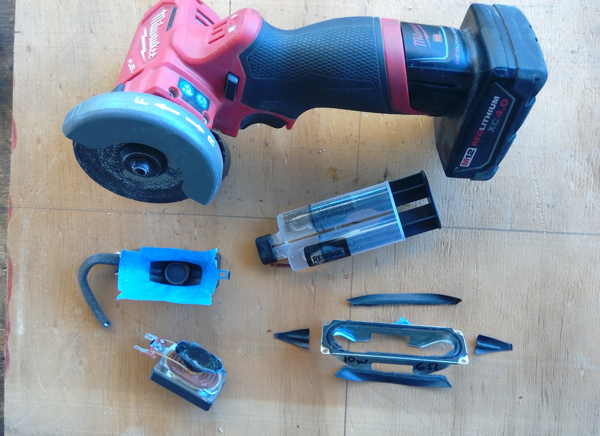

A quick tip here for reusing exciters.... I use the super shiny silver sheet metal tape (not that gray duct tape) to cover the contact area on both the exciter and panel then epoxy the two together. Leave some extra tape protruding from the exciter all around so you can get an exacto knife or whatever in there to peel the exciter from the tape, then deal with the leftovers on the panel.

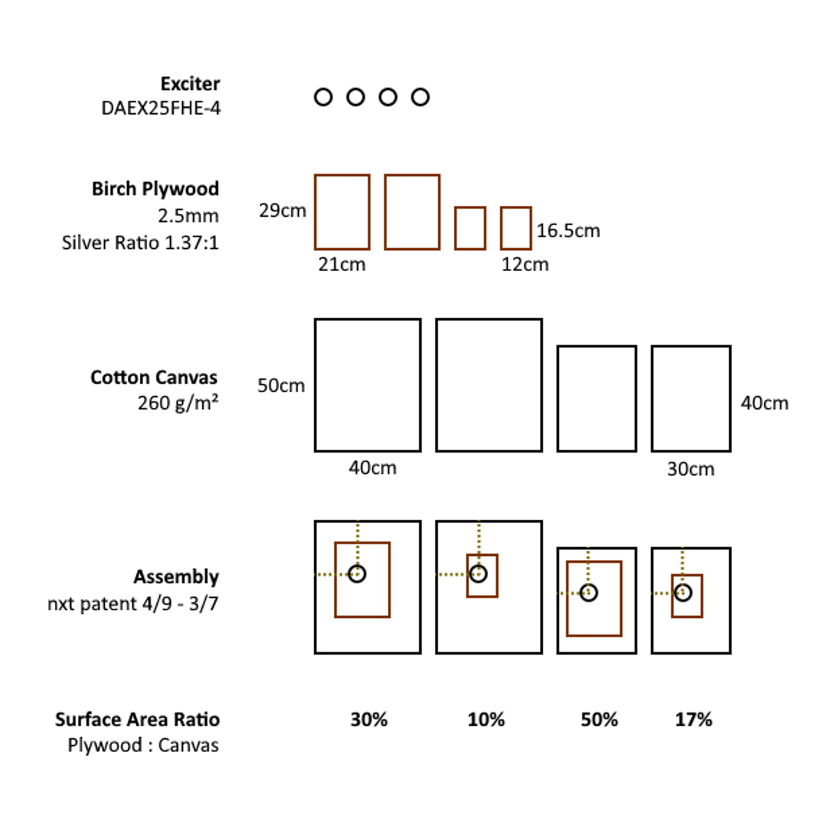

Canvas DML Testing
So, I am currently planning my second test run on the Canvas DML Design.
I ll have 4 different Canvas DMLs to test and compare.
Material:
4x Dayton DAEX25FHE-4
2x Cotton Canvas 30x40cm (260g/m²)
2x Cotton Canvas 40x50cm (260g/m²)
2x Birch Plywood 2.5mm 600cm² (aspect ratio 1.37:1)
2x Birch Plywood 2.5mm 200cm² (aspect ratio 1.37:1)
Preparation:
1. Attaching using the nxt patent ratio 4/9 - 3/7
Measuring Frequency Response of:
1. all 4 Canvas Panels
2. Effect of adding beads of transparent silicone as suggested by offgridkindaguy
3. Effect of adding Gesso Primer to the Canvases to increase its stiffness
4. Effect of adding inserts between the frame and the canvas to increase the tension/stiffness even further
I am not quite sure in what setting I ll measure the Canvas Panels. I d like to do it far field or on a ground plane outside to exclude room interference for now...
Any ideas on what to improve or add to the 'test-protocol'?

Bernardy.
Although I mounted my small ply panel dead centre of the canvas frame,I did offset the exciter on the ply.
But I did notice that in the patent for this type of panel,that they mounted both centrally?
I presume to keep the panel from wobbling at low frequencies,as this is mainly pistonic at these frequencies,supposedly down to 20hz(although mine only went down to 40hz)
Which is the best or ideal position ,I'm not sure.
The canvas is quite lossy ,and helps damp the ply,so offsetting might not be so necessary?
I do have 3 spare canvas picture frames ,so at sometime I do intend to test this out,and make a few adjustments as well.
Just a thought.
Steve.
