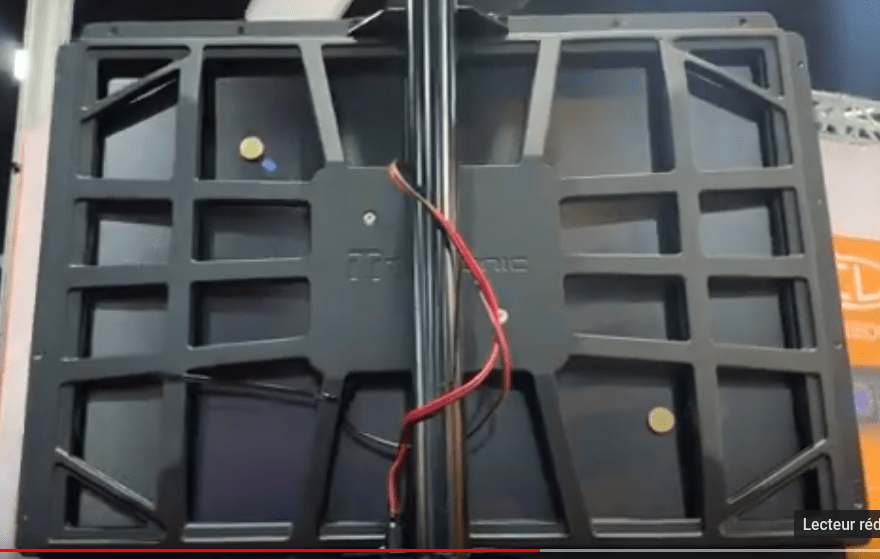

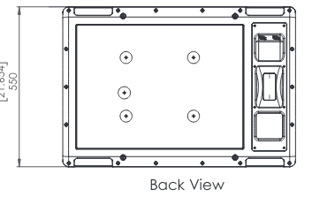

I could be wrong 😁 but last night while looking at the dml 500 down load ,I had a bit of a lightbulb moment(no it hasn't blown) which started me thinking(oh no , not again).
I mentioned a page of two back ,that I used weights to force a small panel to go lower in frequency, but I thought it made the panel sound too much like an ordinary cone driver, so dismissed it.
I think they might be using the same method I used ?
I also mentioned in post 4501 the 5 weights I saw on the back of the panel drawing(which I can't find any more ? It seems to have vanished ? ) if anyone knows where I can find this again it would be very helpful,
But there was also something else I noticed, in the photo of the back of the dml 500 there is a green plate going between the 4 exciters and the panel ?
in the drawing it shows what looks like 2 electrical contact points, which are blocked out in the photo ?
I think these are the special drivers as leob mentions ?
does this plate join all the exciter together in some way ?
Is it used as a spider with the coil wires integral ?
Does it bridge the coil and panel ?
I shall wait and see if the picture turns up of the 5 weights , in case it was my imagination ?
I also see there is a 6th weight ,it looks like a metal disc ?

yes the green ,what looks like some sort of plate material, but you cannot see the right end of the plate in the photo,it is handily obscured by one of the struts !
But if you look in the drawing ( which I am sure will disappear also) it shows the right end, which looks like it has two electrical contacts? Plus and minus ,maybe ?
it's just a quess, but it could be doing two jobs ,one as a type of spider ,and carrying the lead in wires(three jobs) and as a single mount for the 4 exciters to one position on the panel?( Just thought ,four jobs , as added cooling for the coils) ?
4 exciter and one panel mounting poin.
If it isn't ,maybe it should be ?
Anyways, without actually looking at one it is just quess work.

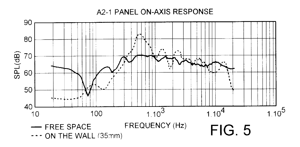

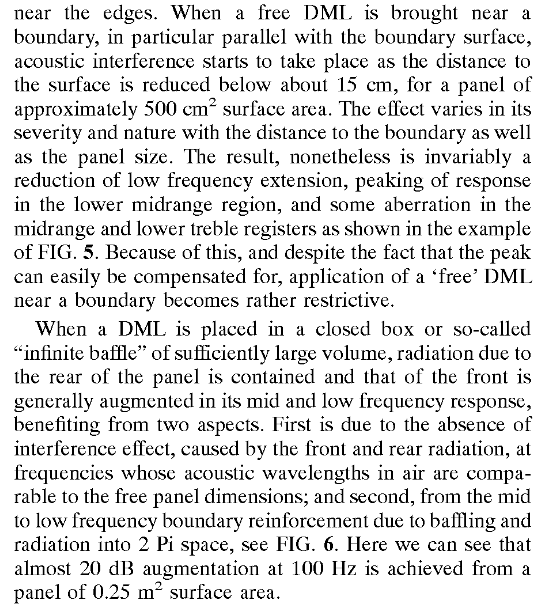

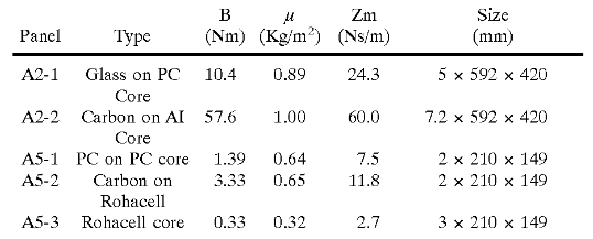

Going in the documents I store about DML, I found this patent US6553124 from M Azima and Panzer about a DML in a closed box rear load. Too complex in its theoretical part for me, it has connection with recent topic of this thread :
  • influence of the rear wall (close to what already shared here)
  • advantage of a close rear volume (need a "simple EQ", transform the panel in near cardioid pattern, increase of the covered frequency range)
  • test of different composite material in A5 orA2 dimensions among them carbon on Rohacell which is in the site pointed by Leob.
Below the extracts linked to that.
  • Does somebody already tested such close box? or other rear load (ie aperiodic) ?
  • Some test or knoledge about carbone/rohacell?
Christian
Influence of the rear wall
About the influence of a rear wall: interference said to start for 15cm. Optimistic!
Material used for the tests :
Leading to a Fc = 8kHz, A.F0 = 7Hz.m², D/µ³ = 11

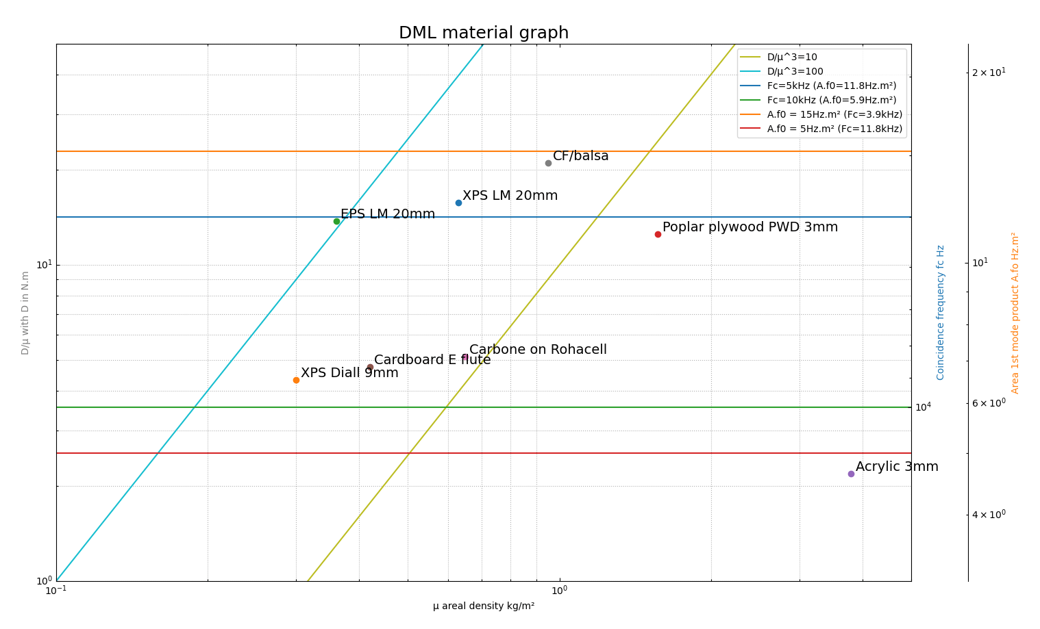

Here in the material graph

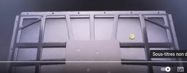

Yippee , I just accidentally found the weights in velerics post 4184 one below cheapvegas post !
it clearly shows the 5 items on the back of the panel drawings, obviously Eric was trying to hide them 😁
Can you guess what I am going to suggest ?
STeve.
Hmm... Are you sure? Are you refering to the back view on page 2?
I understand it more as mounting holes in a dimensionnal drawing. 4 are on a square.
What about the "yellow" point on this video.
And here

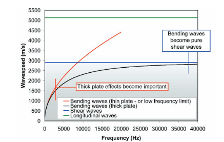

Other finding of the evening... is this has been already considered here about shear modulus?
The shear tents to limit the wave speed frequency. ie from Stephen A. Hambric web site :
STRUCTURAL ACOUSTICS TUTORIAL—PART 1:VIBRATIONS IN STRUCTURES
The values are probably not from the audio area...

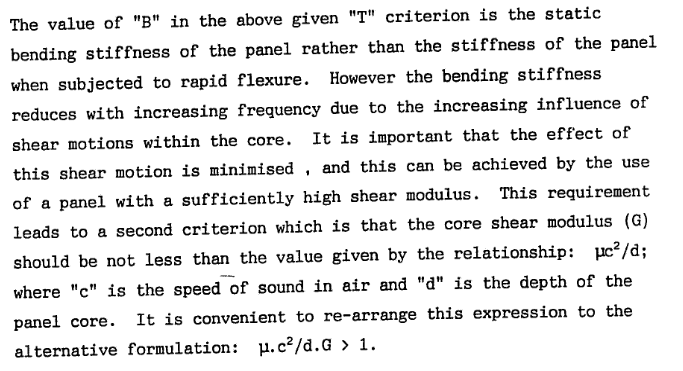

From patent WO1992003024A1
In other words, the speed of the shear waves are greater than the sound speed in the air.
Don't ask me why...
It is just another piece of the jigsaw.
What seems facts is that commercial realizations are based on honeycomb where sandwich material with light foam cores failed. No?
Christian
STeve.
Steve,
Haha, I was actually hoping you would find them! But honestly I have no doubt that weights can be used. In fact, I make wind chimes and place masses along their length at precise locations in order to achieve a desired timbre, so it makes perfect sense to do the same for a DML. I did play with weights on DML plates some time ago myself. I did not find any great benefit at the time, but my knowledge and methods were even more limited then, so those results mean little. I suppose weights could be used reduce the low end, in fact, any weight would. But I'd be more inclined to think that the primary purpose for adding weights would be to smooth the frequency response by preferentially supressing "offending" modes rather than to lower the F6. But who knows for sure? Not me.
Eric

That first article must be a good one, as it's written by a Penn State professor. I did my graduate research in the same lab (but not in Acoustics!).
I agree the effect of the core shear modulus may very well be something that's underappreciated. I do recall this patent family well, as it's the first place I ever saw the B/mu3 criteria.
But check the math, I think there's a typo in the equation. If you read the sentence above it, I think it says somthing different from the "re-arranged" equation.
That is, the words say, effectively: G>(uc^2)/d, right? which correctly rearranges to (Gd/uc^2)>1 , right?
But they wrote (uc^2/dG)>1, which is exactly opposite. Or am I mistaken?
Strangely enough, they buggered up the same equation in the US version of the patent, but in a different way!
Eric

In fig 5 the dotted line for near wall , matches your near wall measurements very well.
including the large hump !
Steve.
