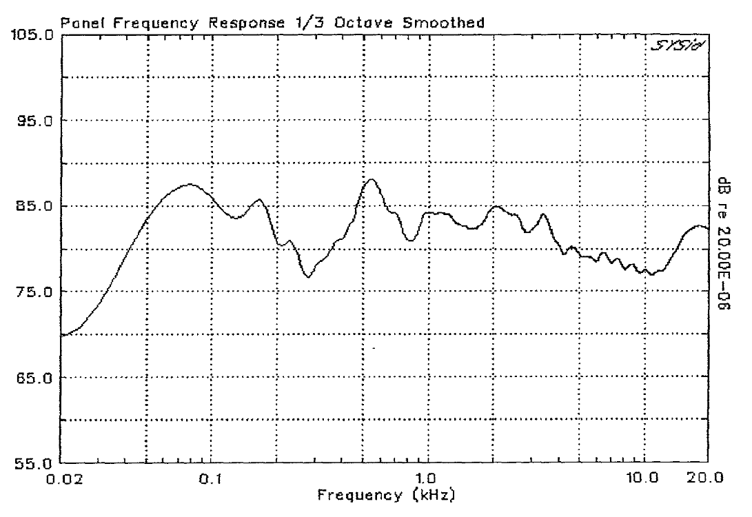

Here is the patent US20030081799A1which has several interesting points :
If a panel has an audible self-noise, something should be visible with this kind of test.
The frequency response shown is said of good performance... it is really similar to what we get from different panels in this thread
Christian
- A general discussion about DML, their qualities
- The description of a sandwich membrane made of a kraft honeycomb core with high tensile strength skins and special attention to the adhesive with high efficiency, high power capability, low self noise, low end.
- an evaluation of the self noise performance of a panel.
Christian

yes that frequency plot is very familiar with certain types of panel.
it was nice to read a patent that I could understand, more modern patents seem to want to confuse and hide and be vague about what they are saying ?
Bury the meaning in words !
So what is he really doing.
In the past I have used damping in the form of vinyl silk ,silicon, neat pva, and more.
But this is all added weight, in this patent he is replacing the hard glue with a softer more rubbery glue, so now you have the damping without the extra weight.
This is a great idea, but it is still damping.
I suspect this will have an adverse effect on the sound, for me anyway ?
One thing I would be suspicious of ,would be the extra bounce it would cause in the panel itself.
I have found this problem when using silicone as a coating ,would it have the same effect internally?
so something maybe that would add damping ,but not bounce to the panel ?
there is a lot of generalizing in this patent,which I would take with a pinch of salt.
Steve.

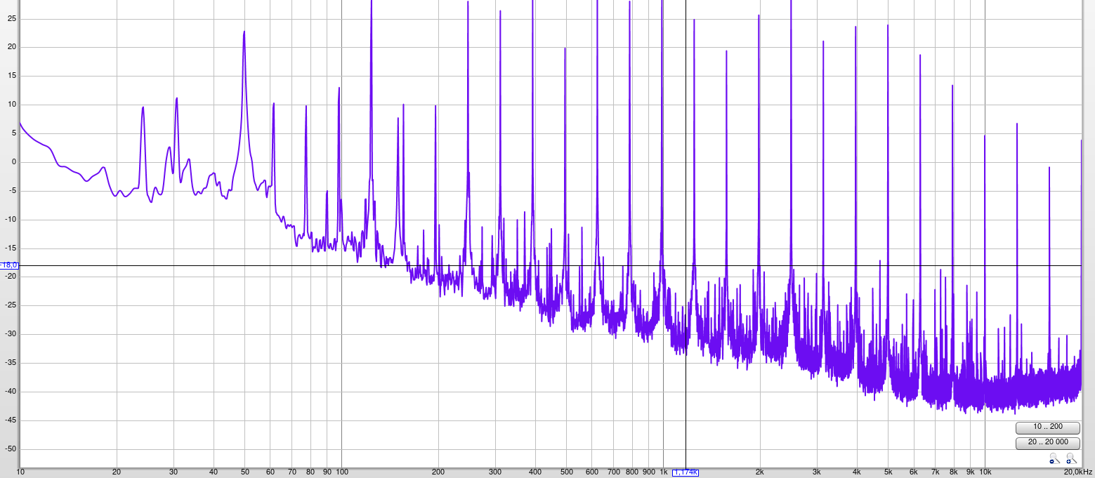

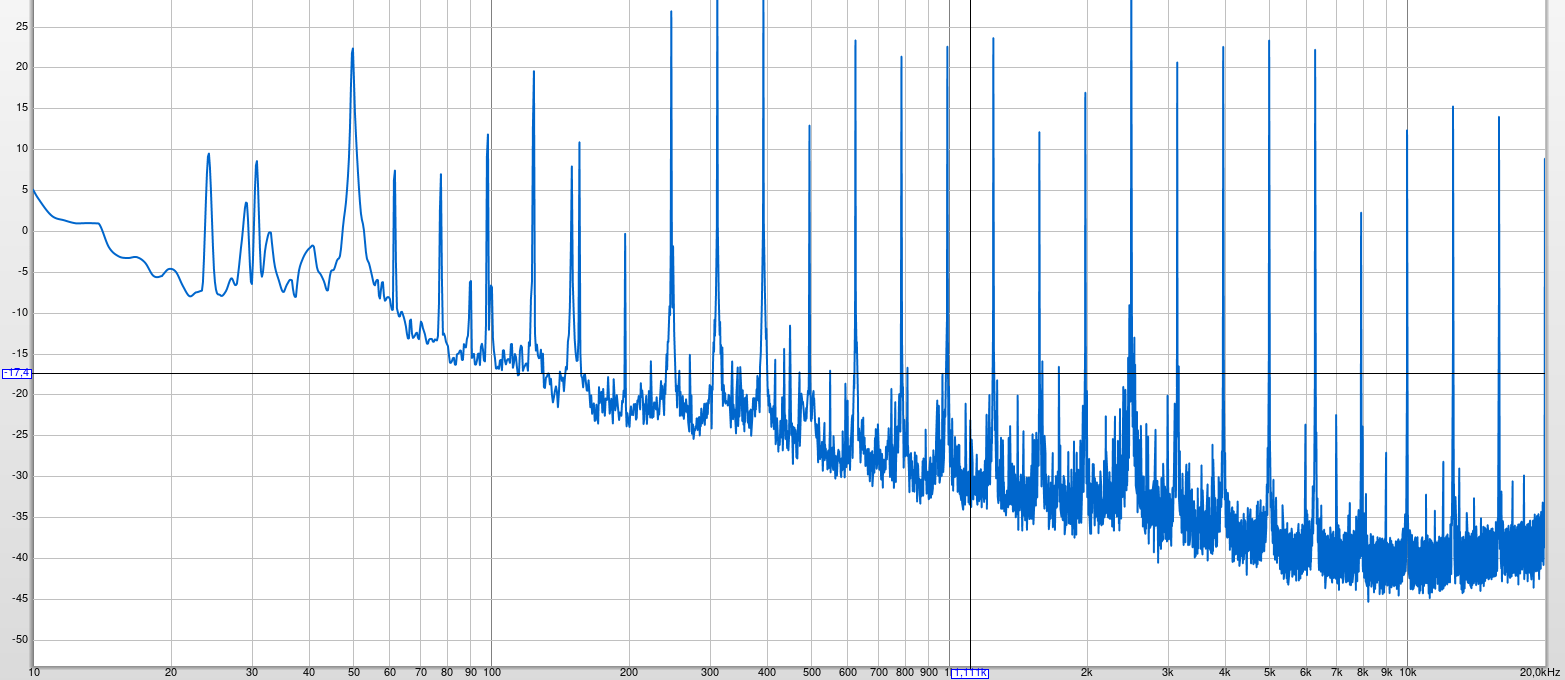

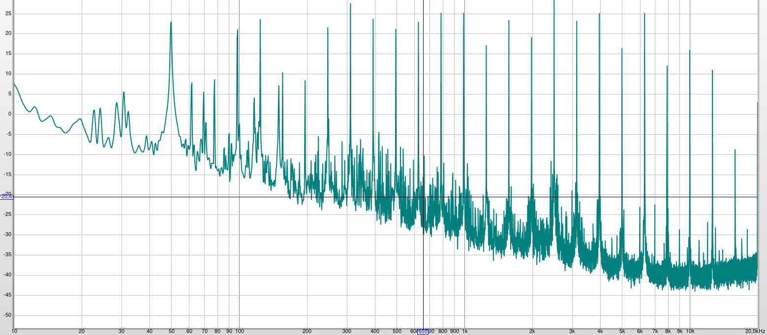

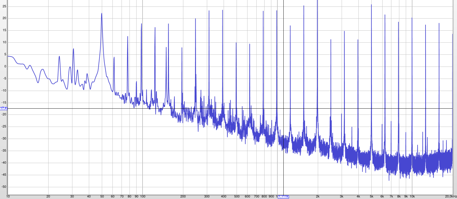

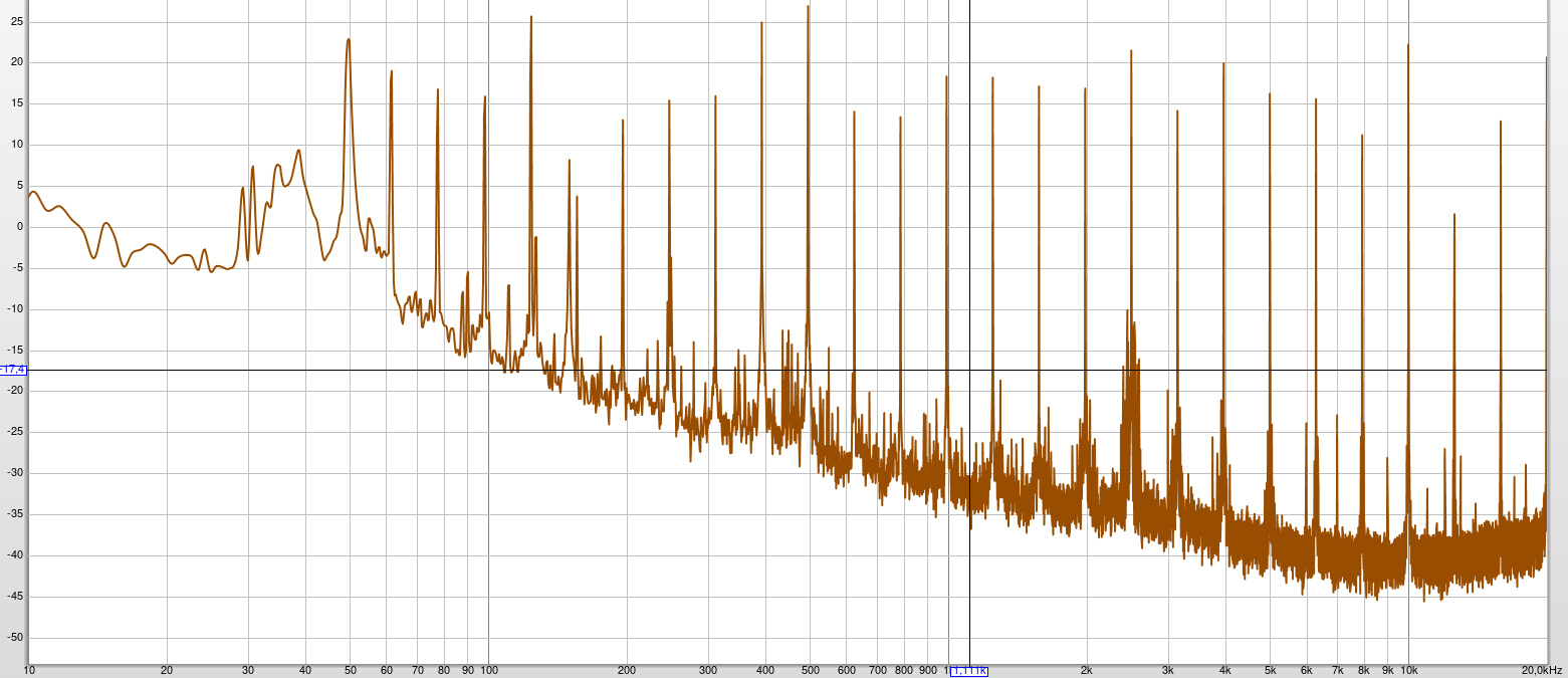

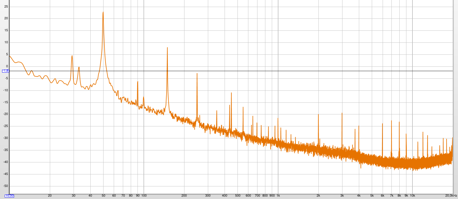

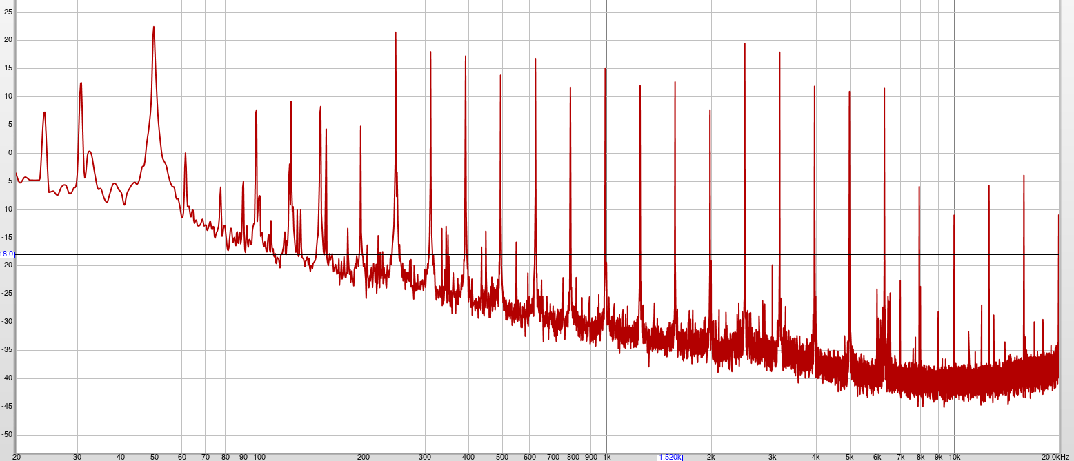

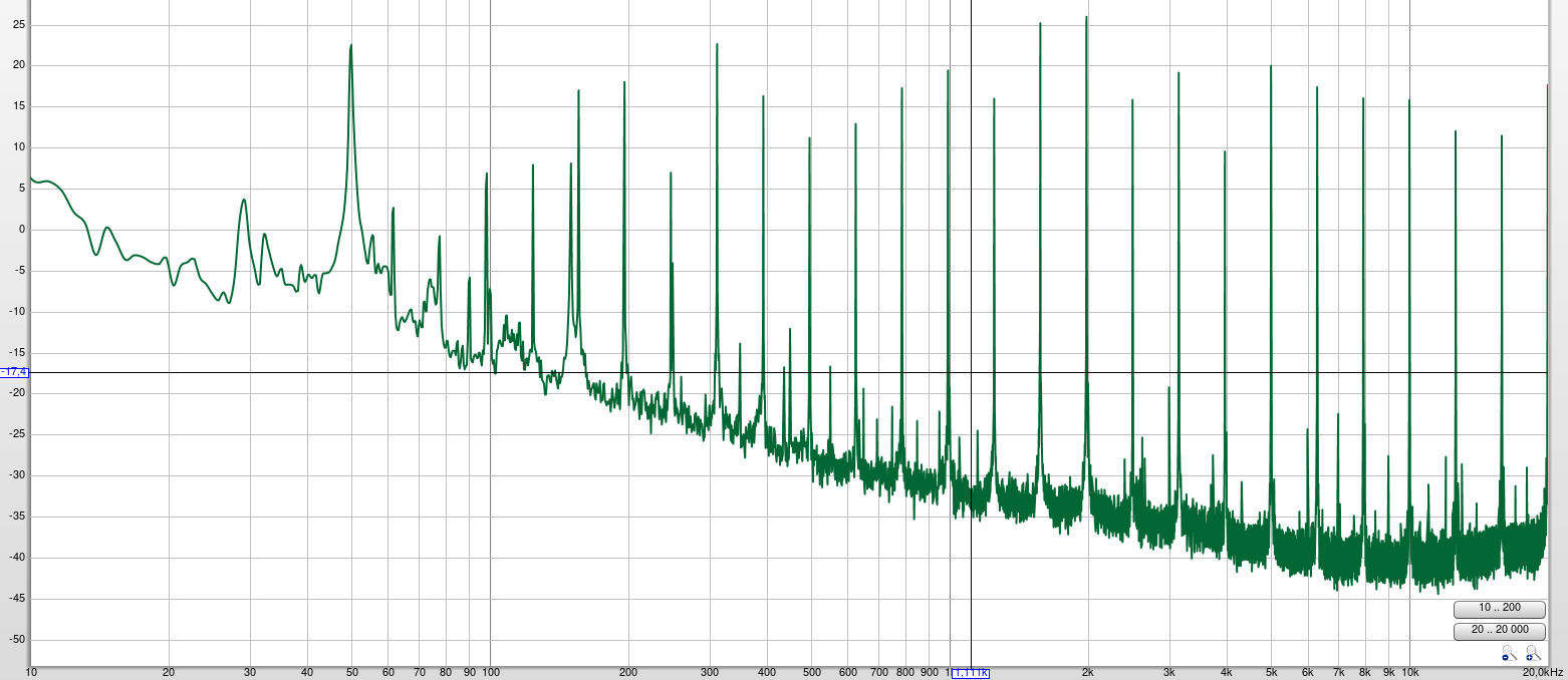

I played the 30 frequency signal from Linear Audio (see 4651) and displayed the spectrum thanks to REW with the mic at about 2m.
All the peaks between 2 frequencies of the signal mean non linearity or self noise.
First the noise floor (no speaker playing). Not really good but no time to search for improvement. The peaks may come from the switching supply of my laptop and also from its fan (not far enough from the mic):
As a reference a cone full range : a FRS8 Visaton
My plywood panel:
My canvas panel :
A cardboard
An XPS 9mm sheet not sanded nor coated:
An EPS 20mm sanded and coated:
The "glass" in front of an IKEA frame (acrylic?)
Some post treatment might help, we could also think to a metric but in the first reading, we could see a correlation with the opinion about the different materials...
Christian

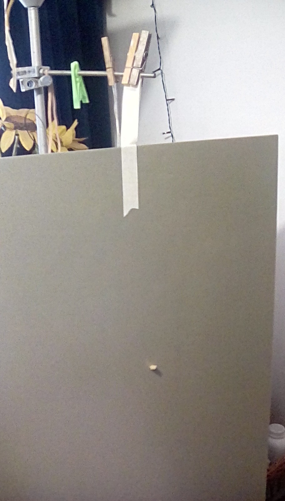

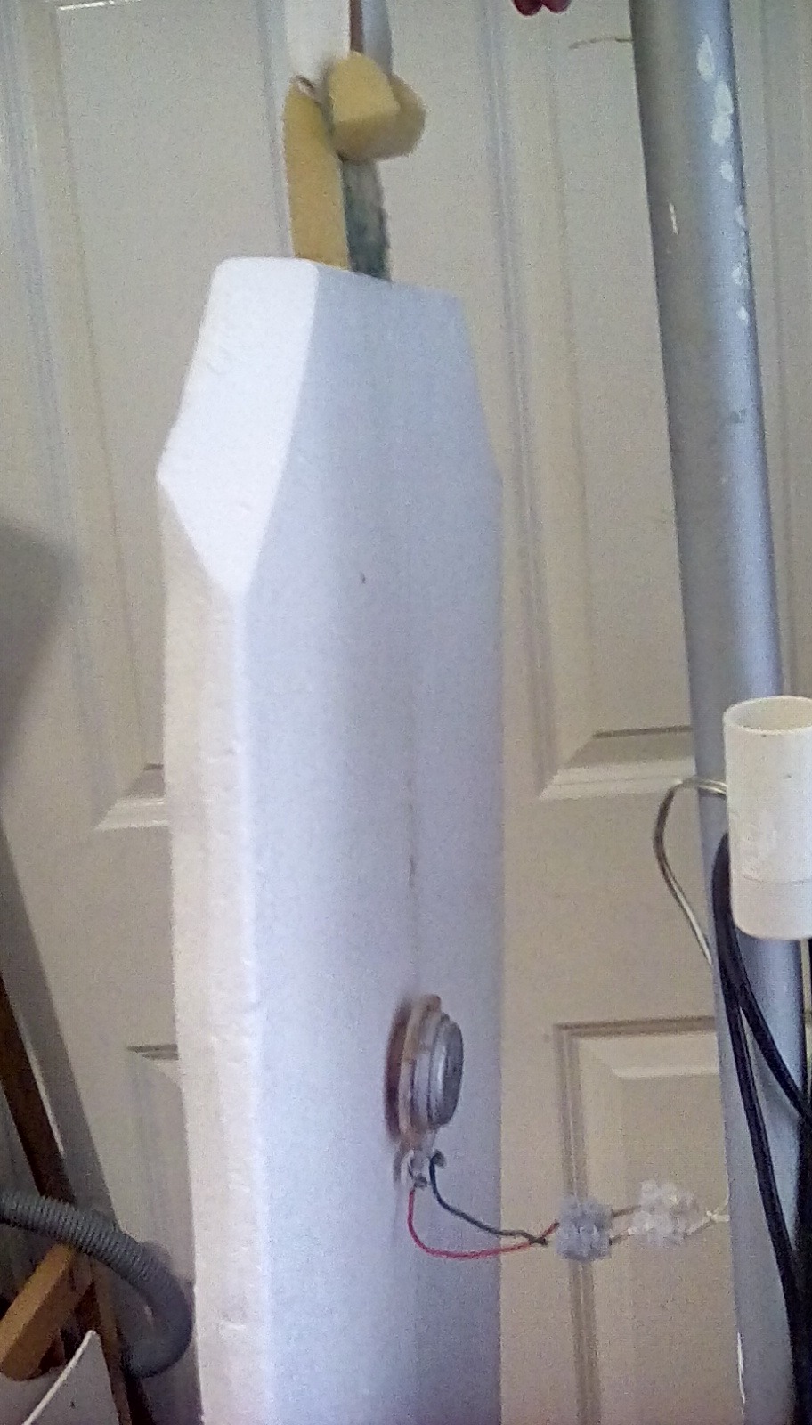

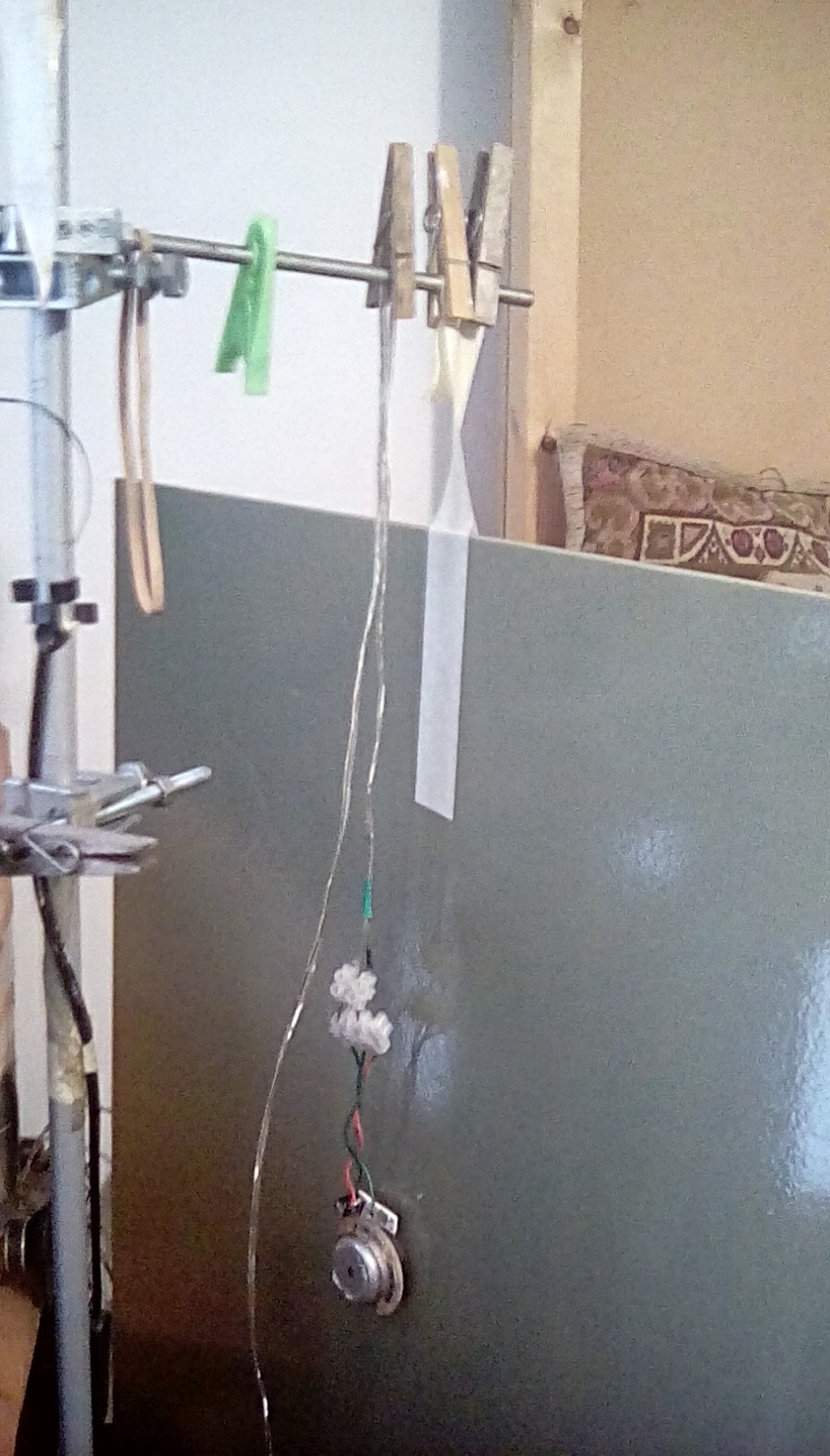

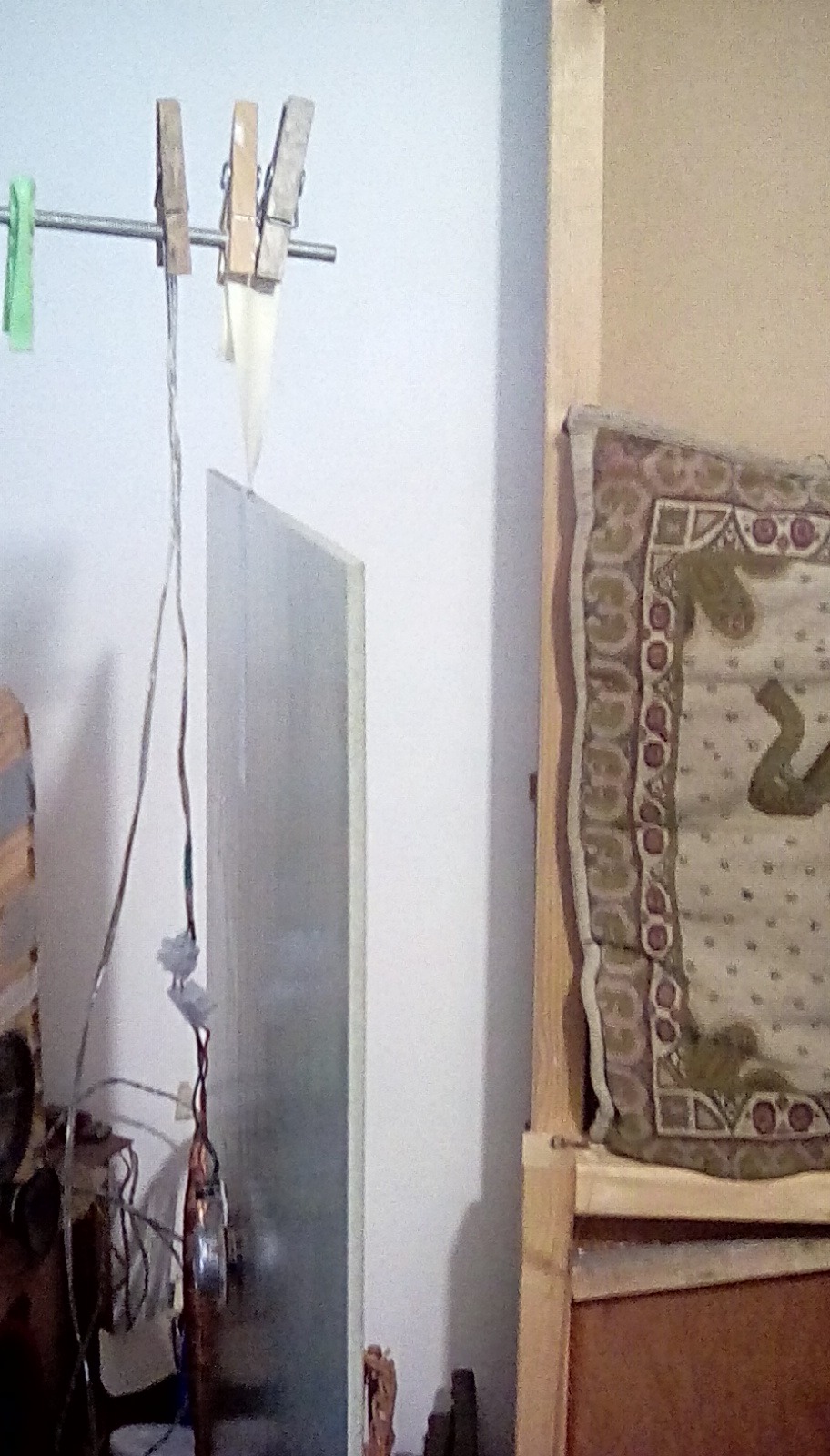

About the SPL at 2m for different materials
Other today test : about "efficiency". Or in other words trying to understand which characteristics of a panel make the SPL.
For that, I played a 200Hz to 5kHz pink noise and measure the SPL at 2m in dBA, all of that with REW.
As a reference, I use a FRS8 Visaton. All the settings were kept the same during the test; Only the material was changed.
The main results :
I tried to see a logic in that with the density and the Young modulus to have characteristics not linked to the geometry. This allows to sort the material in almost the order coming from the test but it doesn't completely fits as figure.
All of that is perhaps already known... it was not my case...
So if somebody as the knowledge or even an idea to link that to some physics, I'll appreciate.
Christian

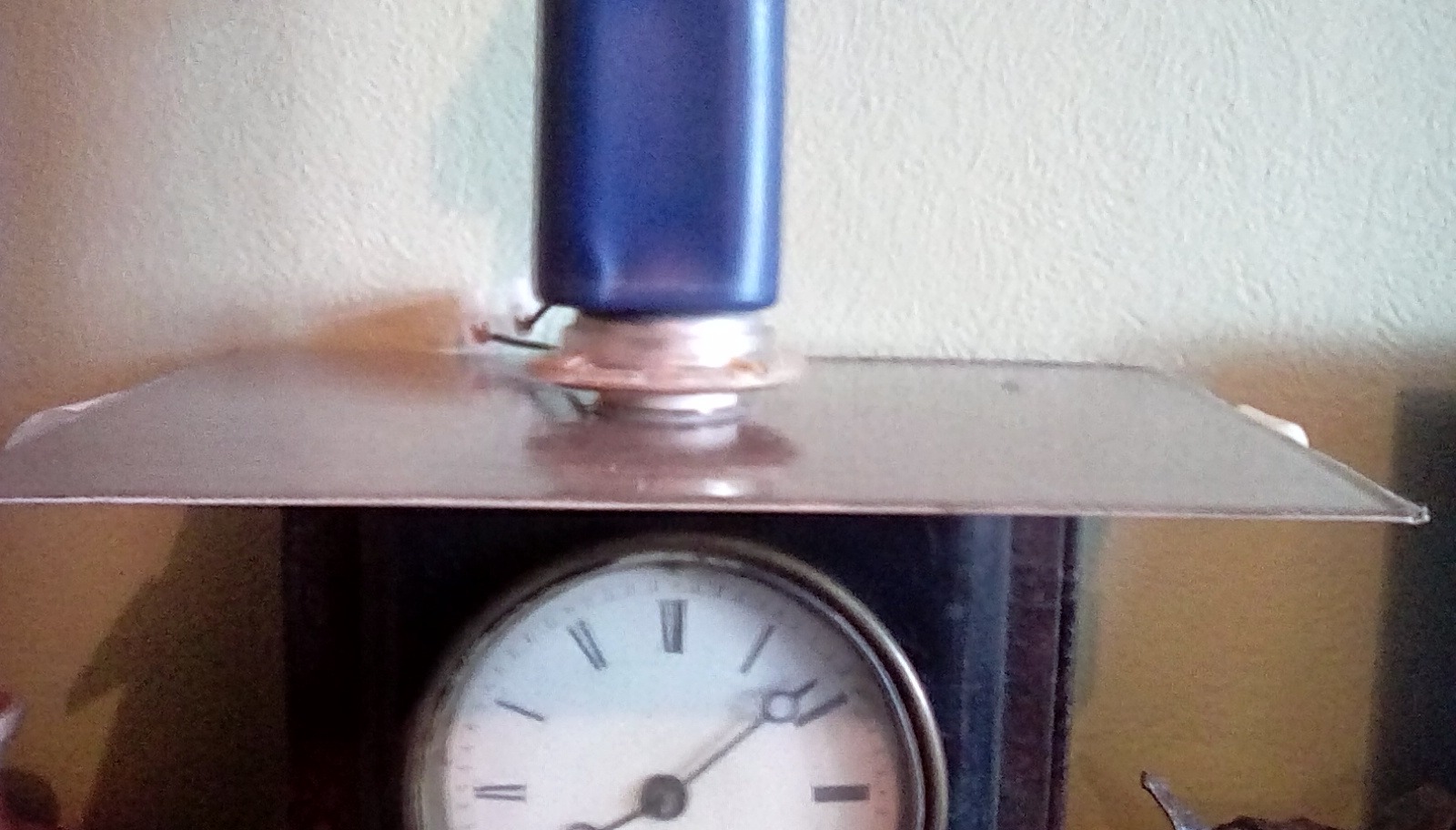

For testing panels no framework is needed.
I use the methods in the photos when testing exciters and panels using ordinary double sided tape .
they could last hours or days.
for permanent fixing I use pva .
The first three photos are of my 5mm epoxy coated xps using masking tape to support the panel and pegs to hold the tape and lead out wires
I've twisted them around so you can see.
This is the usual place where I mount my panels.
You could also use the masking tape stuck to the back of the exciter to the mounting at the top for added safety.
You can adjust the tension ,how much weight is supported by using the pegs.
The fourth picture is of a polystyrene panel with a permanent sponge attached to the panel.
I just use a peg to attach this to whatever I want, this is my preferred panel mounting as it stops the panel swinging around every time I walk by it.
The fifth photo is of a couple of tapes I have use ,one unbranded.
Not all double sided tapes are the same ,some are better than others, but all should last for enough time for testing.
The sixth photo is an old panel I found with the tape still on it, I have to use two pieces of tape as the tape is not wide enough.
It is always a good idea to have the exciter wires firmly secured at the top in case the exciter does fall off and crashes to the floor !!
If measuring ,I would mount the panel in the best sounding place in the room, hopefully this is where you will permanently mount them ?
Measuring them in a place where they sound bad is not a good idea !
Steve.

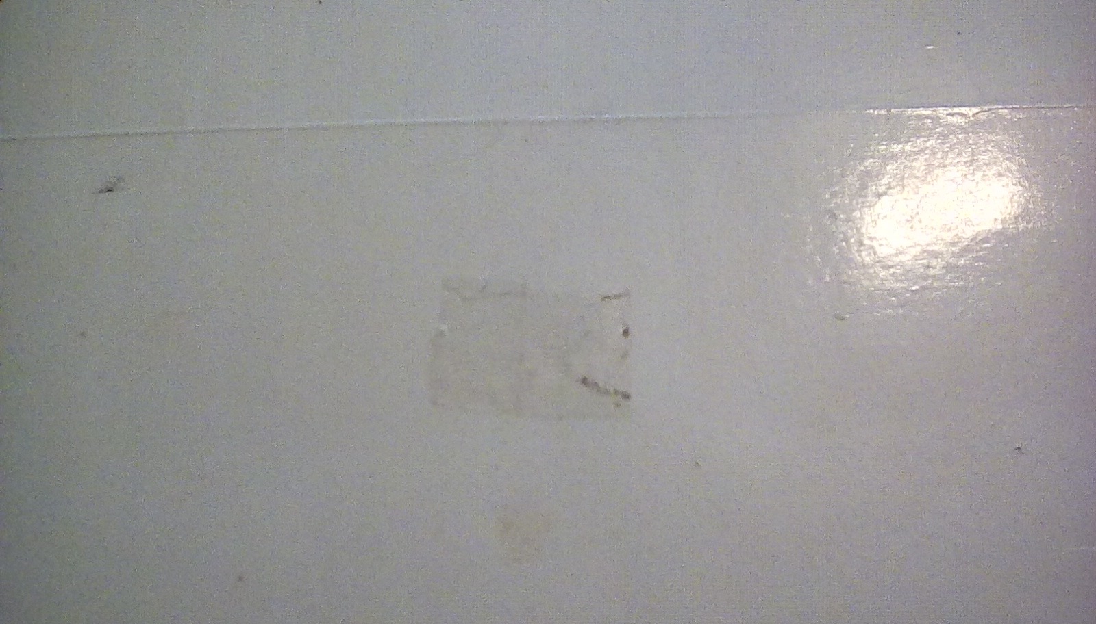

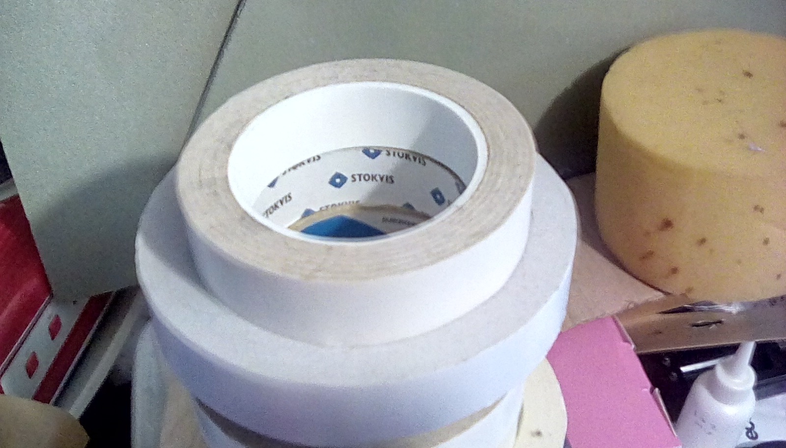

Steve.
