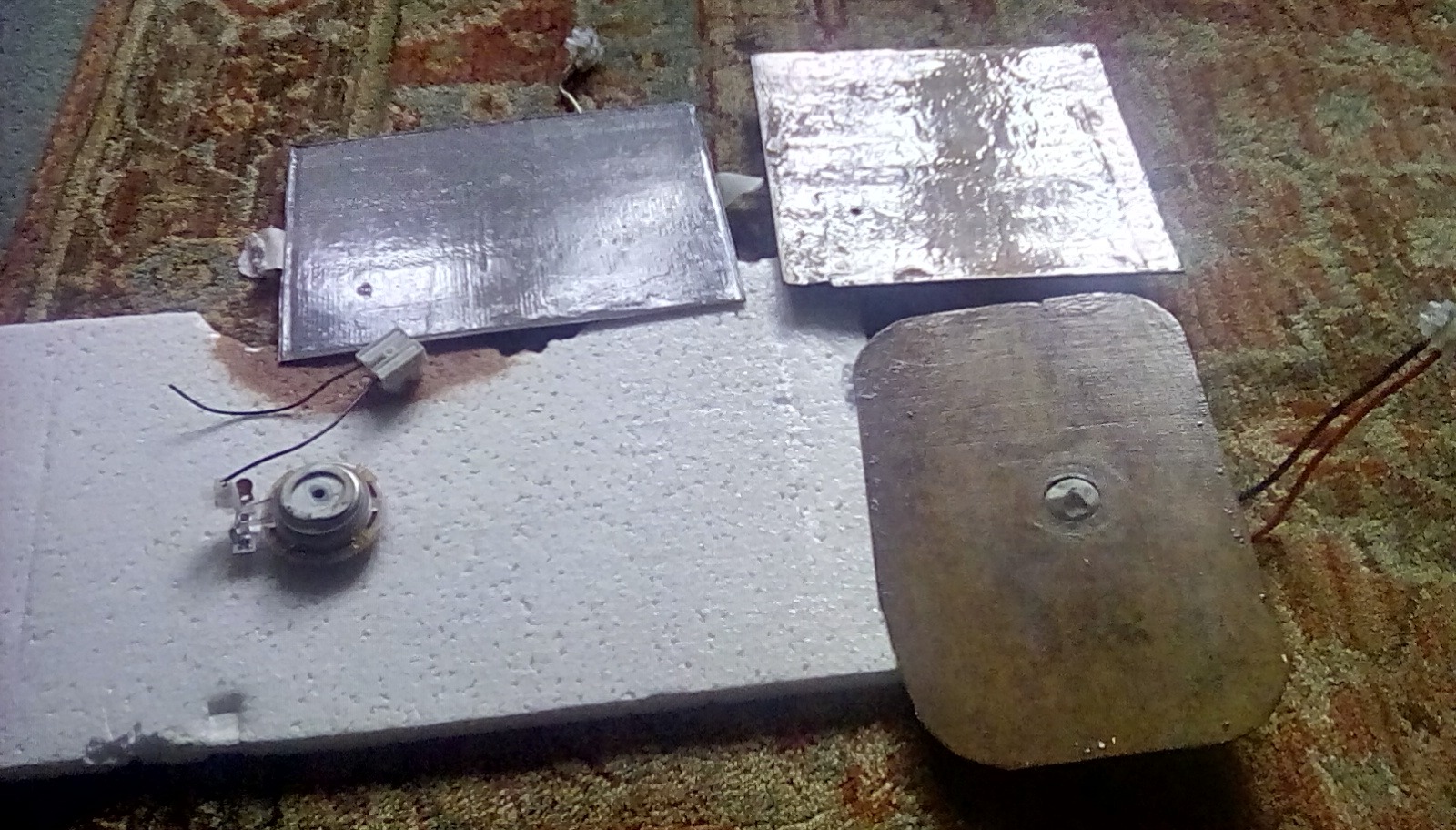

This is a photo of the card panel (top left) I made a little too much epoxy.
So I panicked and grabbed the square wood panel and the low grade eps panel and gave them a bit of a coat too.
The other is my 6x9 inch 1mm veneer panel coated in pva.
The pva coating is much thinner , but this is my first attempt and I was rushing.
The epoxy is quite hard now on the wood and cardboard, but it still feels a little sticky and soft on the eps ?
Hopefully this will cure better with time ?

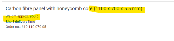

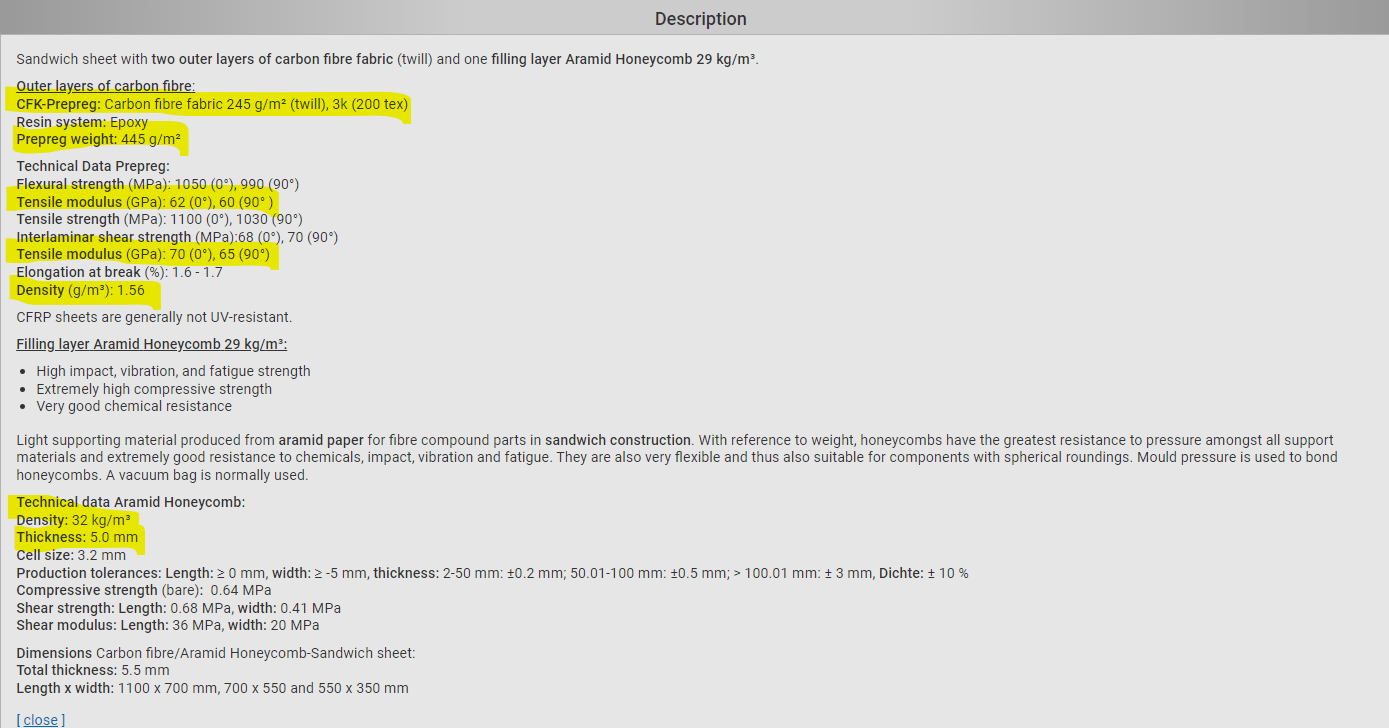

Eric,
When you evaluate the possible Fc, how do you get or infer the bending stiffness? Your experience of composite? In a quick look to the web site, I haven't seen information except thickness and mass.
... composites are strange things to me currently!
Christian
Christian,
Loeb's link included the following quite comprehensive details, which are enough to determine the Bending stiffness.
But one thing you may not have realized is that the carbon skin thickness can be determined from:
t=prepreg wt/prepreg density = .445/1560=.00028m = 0.28 mm.
Note, they made a mistake and wrote 1.56 g/m2 instead or 1.56g/cm2 or 1560 kg/m3 for the prepreg density.
Also, I don't know why they list the Tensile moduli twice. Once as 62 GPa (0 deg) and 60 GPa (90 deg) and then again as 70 GPa (0 deg) and 65 GPa (90 deg). Maybe they represent two different levels of curing? I don't know. But pick any number between 60 and 70 GPa, the result won't be much different.
So use:
Skins:
t=0.28 mm
E= 60 or 62 or 65 or 70 GPa
rho=1560 kg/m3
Core:
t=5 mm
E=0 ( not quite true but close enough)
rho=32 kg/m3
That should be all you need. Let me know if it's not.
The only caveat, as I mentioned before, is that the panel wts they report imply an areal weight of about 1.2 kg/m2, when it "should" be only about 1.0 kg/m3. I don't know if the difference is glue they add to attach the skins to the core, or if their reported "wt approx" is an overestimate, or a little of both.
Interestingly, they also report the shear modulus of the honeycomb in the spec sheet. I don't usually see that on spec sheets for cores. I could add the Heron shear criteria to my calculations, perhaps I should.
Eric
That first article must be a good one, as it's written by a Penn State professor. I did my graduate research in the same lab (but not in Acoustics!).
I agree the effect of the core shear modulus may very well be something that's underappreciated. I do recall this patent family well, as it's the first place I ever saw the B/mu3 criteria.
But check the math, I think there's a typo in the equation. If you read the sentence above it, I think it says somthing different from the "re-arranged" equation.
That is, the words say, effectively: G>(uc^2)/d, right? which correctly rearranges to (Gd/uc^2)>1 , right?
But they wrote (uc^2/dG)>1, which is exactly opposite. Or am I mistaken?
Strangely enough, they buggered up the same equation in the US version of the patent, but in a different way!
Eric
You are right Eric. In another document, the speed of the shear wave is v=(G/rho)^0.5. The goal is to get it greater than c the sound speed. In order of magnitude, with the data we have from materials :
