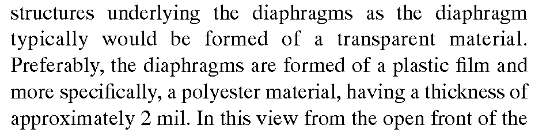

Does somebody know what would be a source of 0.05mm polyester (PET)?

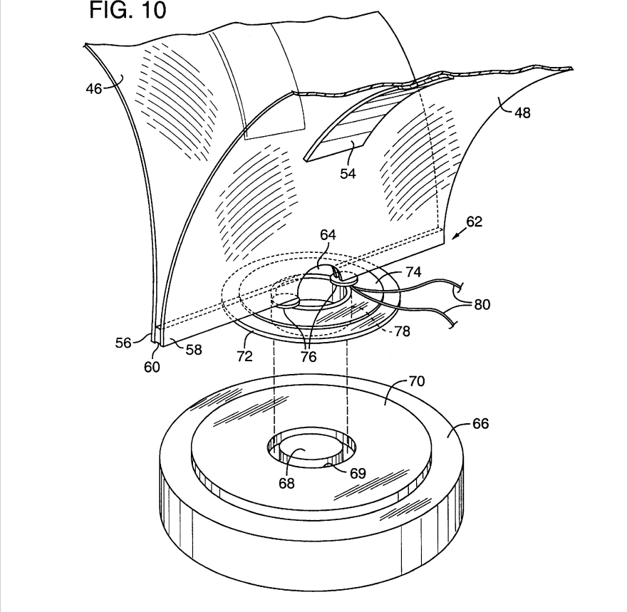

These are patents of Paul W. Paddock: US Patent 4,903,308, US Patent 5,198,624, US Patent 5,230,021, US Patent 5,249,237, US Patent 5,446,797, US Patent 5,450,497, US Patent 5,570,429 US Patent 5,604,815, US Patent 5,652,801, US Patent 5,727,076, and US Patent 6,061,461. (I found them yesterday) I had time to read only 2. All these patents have expired.
As the thread heading says, we are studying DMLs as a full range speaker. The tech ingredients idea is really no longer interesting. I mean anyone can stick an excitor on an EPS panel and get a sound his own ears like. It might not be the same to his wife's ears. Since finding out about Ammos (which won't appear as a product) and Sony marketed product, I've been experimenting with edge transfer of sound vibrations to a flat panel, mostly on glass panels, glass one-side-closed objects, glass both-sides-open objects, etc. Even EPS sounded way better.
Now, Rubanoide came into the scene, where the flat panel became the voice coil itself. Interestingly, the flat panel is bent into half a cylinder. It so appears that only one panel, bent onto one side is quite enough to give out excellent sound. The 2nd panel bent the other way gives some aesthetic feeling, and also acts as an additional speaker - one voice coil with two speakers. If the two flat panels go around the back symmetrical to the front, you have 4 speakers. And, that with just one voice coil!
Four DML speakers with just one voice coil.

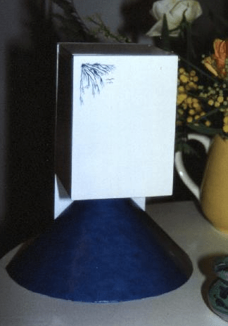

Very nice and clean DIY. This is a firing down speaker. Canon had something like that inspired the speaker below made for a friend years ago with a small fostex.
My pictures in post 7410 are with an ordinary speaker. It is not a rubanoid which is more complex to build. Where the patent is inventive is in the shape and material at the fold.Well not really. Paul W. Paddock filed for patent in May 1998.

Polyester drafting film is typically 75 micron (.075mm)Chdsl

You can buy double sided butyl tape made by Novia. I suppose available in France.

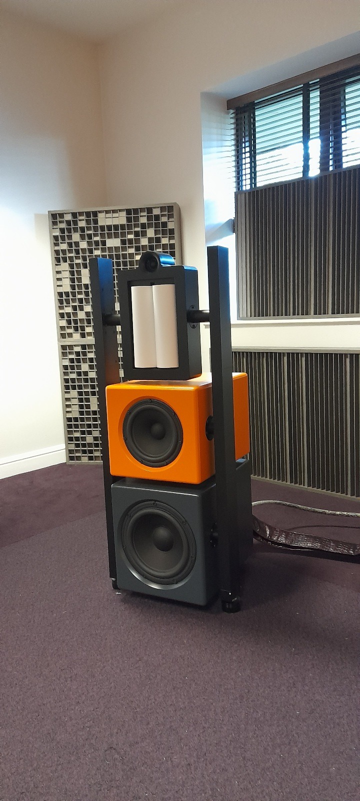

I remember the linaems LX5 ,my friend had 2 pairs and used to stand the second pair upside-down on top of the other pair, so that the two tweeters were next to each other.
I borrowed a pair for a while and loved the tweeters.
These two speakers are basically the same using rubanoide drivers.

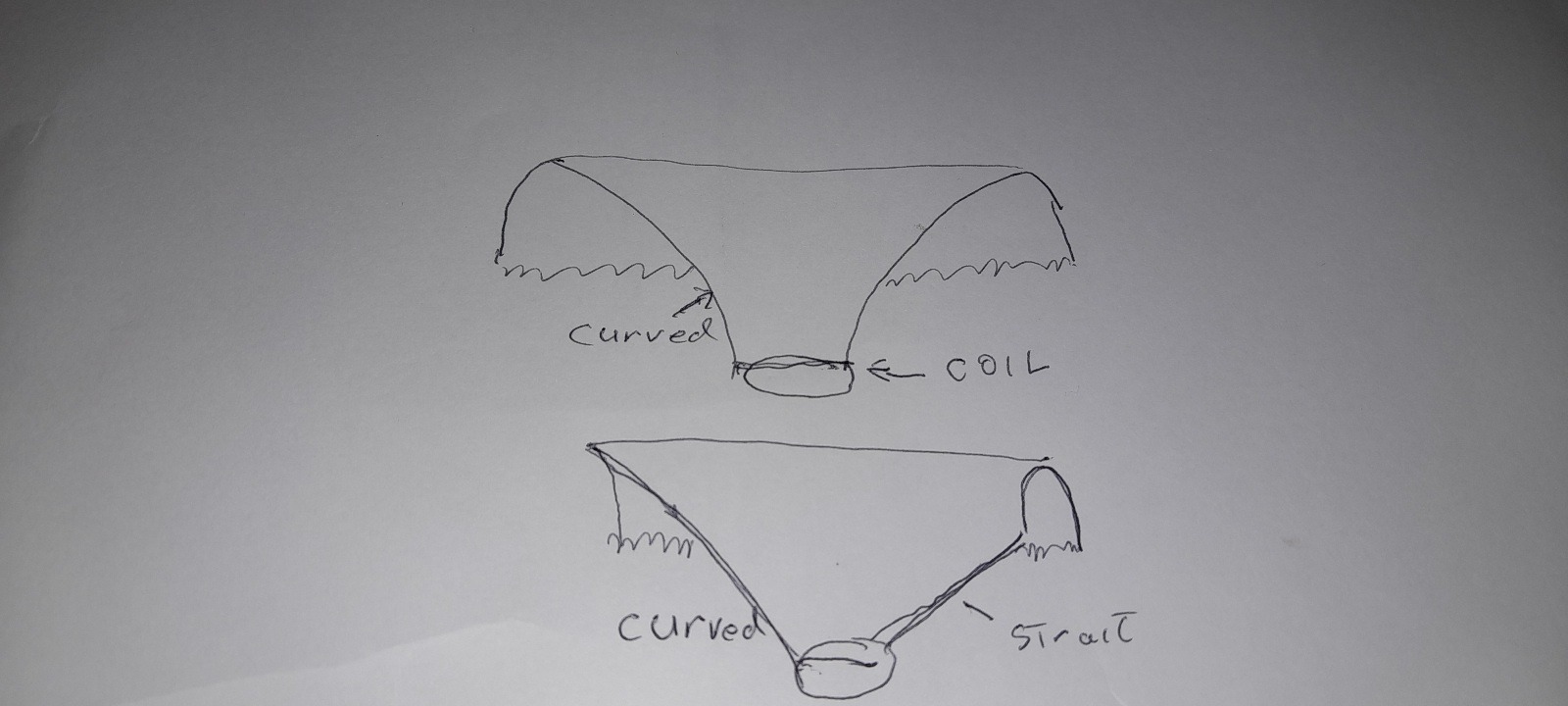

I was thinking the same thing - better coupling. But this geometry opens the back side & may reduce the SPL a lot.If using a coil would it be better to use a foil this shape .
Sorry for the very quick scribbled drawing.
One side only shown.
Steve.

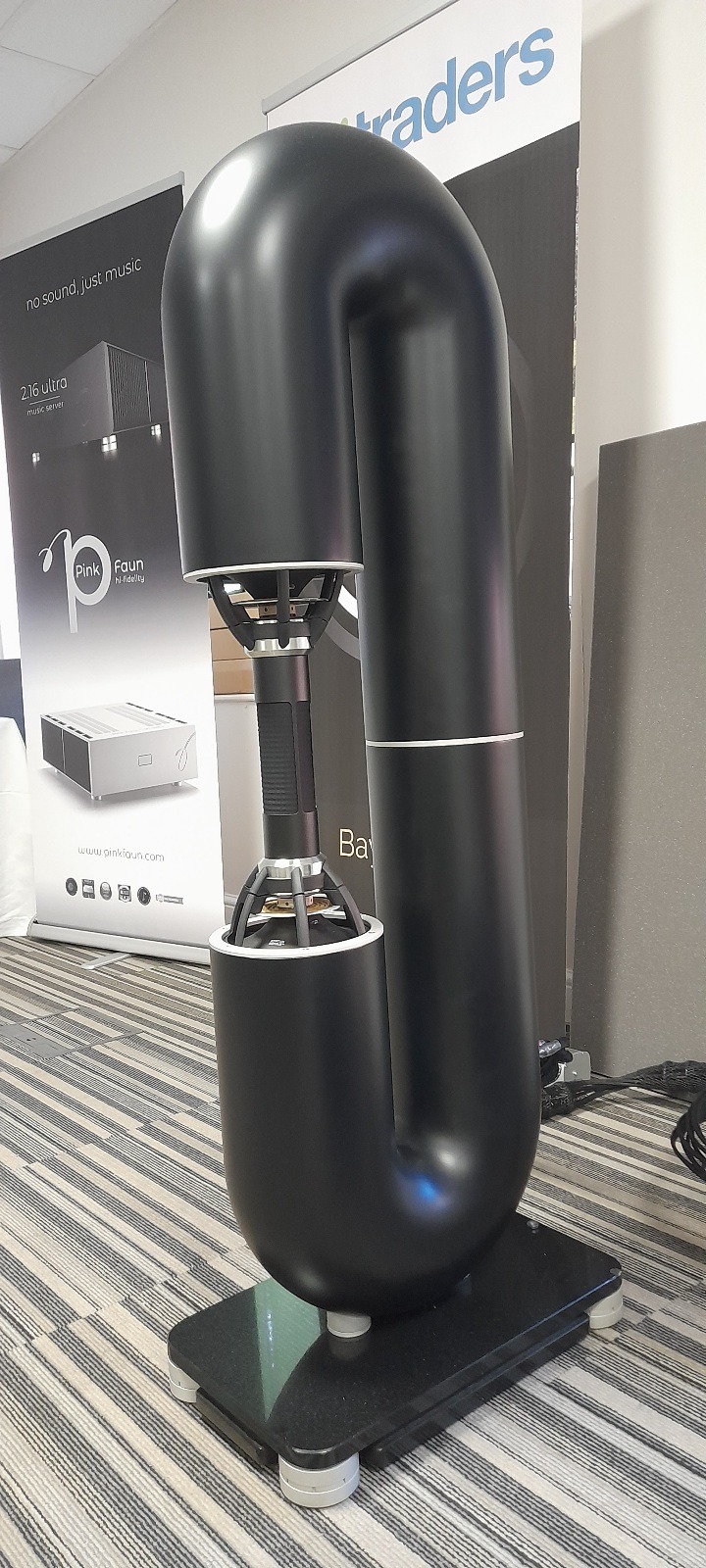

Rubanoide is similarly appealing in it's simplicity as DML. Regarding the magnets, it looks to me that they are arranged in this video so that N-S poles are on the front & back rather than facing one another across the gap, correct? In that way, the design uses the side-to-side field lines as they curve around at the edges of the gap in opposite directions at the front and back.Here's something quite interesting, right here in DiyAudio, one flat coil, flat magnets, curved flat panel into a cylinder (2 of them). Electricity goes through the flat coil, music comes out of the two cylinders. I saw this video quite sometime ago, somewhat forgot about it, until I saw it again here in diyAudio. It is called a Rubanoid, or ribbon-like. Don't see any ribbon, though. This work is real DIY, who understood the idea, and made a working model out of it. Maybe, some of us join our member in that thread?
A French engineer had found this idea in the 1980s, and as usual not commercially marketable to the general public. A Swiss company Audio Consulting appears to be making some speakers, and as usual, must be horribly expensive. Or, they are not producing any speakers right now. Any videos from them are 8 years old.
A better design would be to have the wires go in just one direction, so that you can take advantage of the higher flux through the middle of the gap.
