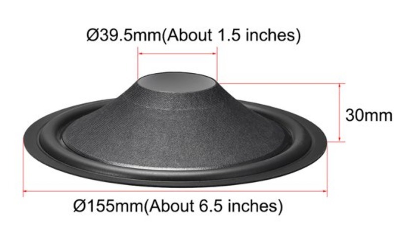

In your sketch, the vibrations start at a tiny edge, while the end edge is much larger than the beginning. The vibrations won't get larger, just because the end edge is much more than beginning, but would die on the way. That's why its better to have both edges the same as wider as can be, and one edge fixed tightly, while the other edge with flat voice coil incorporated allowed a restricted movement. This allows the whole bent panel work as DML. Sure, at the fixed end vibrations die, but that's not much of a problem. If 60-80% area gives out sound from the voice coil, that's quite good.
I suppose you've noticed the width of a cone is not much in speakers. In a smaller ones, that might be twice the width of the dust cap, but in larger ones, they could be equal, or nearly equal.
When you take out the surround, you are left with ~2" wide angled paper cone from this 6.5" to do the work, in one plane if there's one.

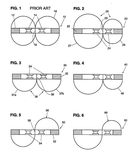

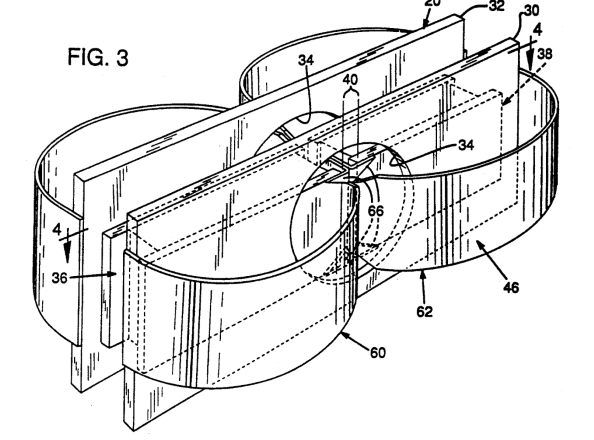

But Haddock's speaker has same width speaker panels in 4 directions.

In post #7,548, where I mentioned one voice coil with 4 speakers, it should've actually written one speaker with 4 bent DM panels.
The voice coil is the speaker. The 4 panels bent in different directions are the 4 amplifiers of sound coil. Depending on the angle/curve these panels are bent, the sound (quality) changes. I have yet built this--awaiting the magnets to arrive, but I think, even if the membrane stays straight, it'd still give good sound. Only a standing alone membrane would just flutter. I wonder, if we can wound the flat voice coil around a glass panel. Or, paste it between two glass panels.

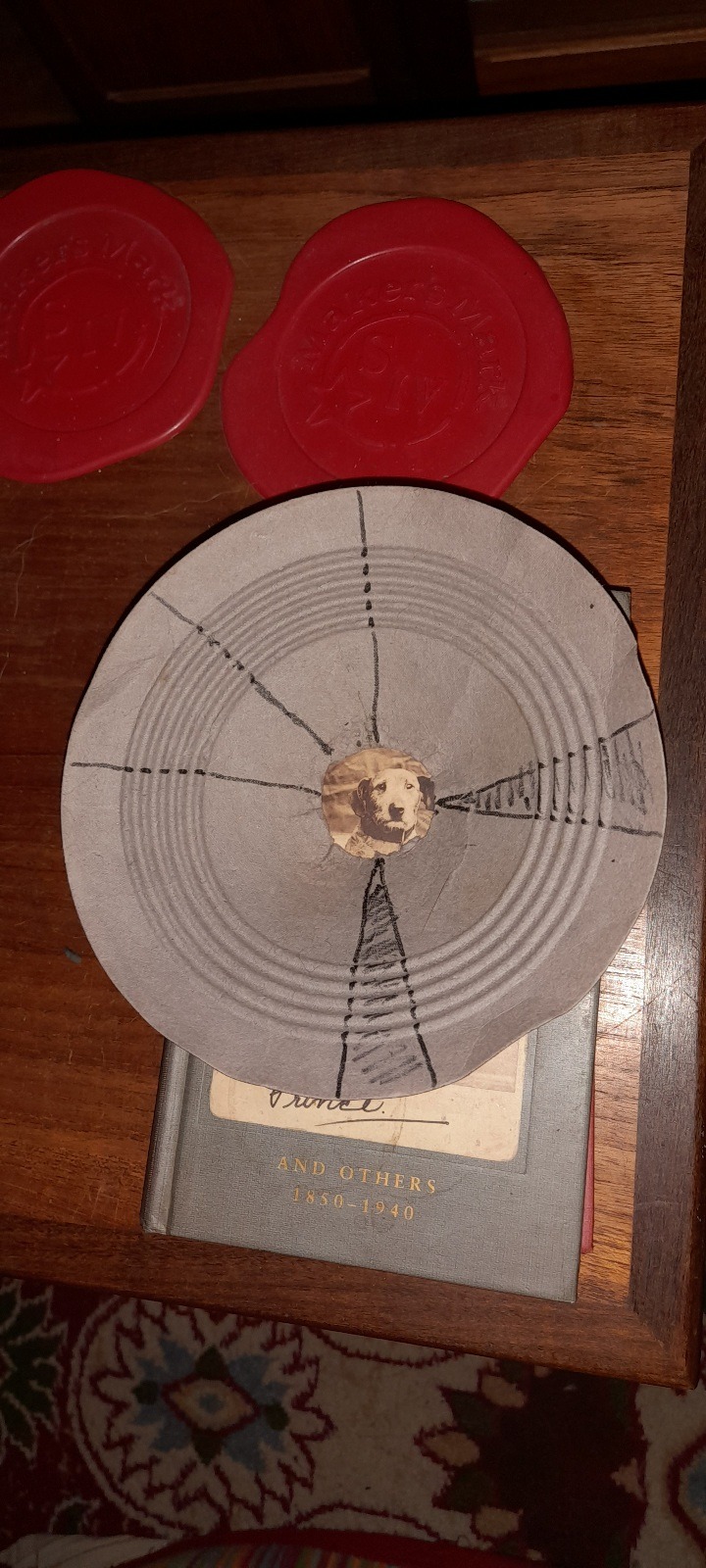

I could not get to sleep as I was thinking of a cone , with either cuts made to the cone (to the right of the picture) which would make the cone look like my drawing from the side.
Then I thought instead of making cuts ,what if you just made slits in the cone (on the left of the picture) making sure the sides do not touch.
Waves could move along the cone from the coil to the roll surround,to be absorbed, (bendingwaves,) not across the whole cone surface.
Would this cone still be able to keep enough of its pistonic pressure to still produce low frequencies?
Would light foam strips in-between the slits help damp the panel segments and increase pistonic pressure?
It would be very easy to convert a pistonic cone speaker, it's a pity I just threw out a couple of bass drivers which I could have cut up🙄
The cone in the picture was from a unit I used to make an exciter.
Depending on the size of the cuts or slits you could have up to something like 10 rubanoide foils driven from 1 coil ?
I have no idea if anyone else has ever tried or even thought of this ,if so I apologise.
If not, bang goes another patent 😱😭😫
Steve.
Waves could move along the cone from the coil to the roll surround, to be absorbed, (bendingwaves,) not across the whole cone surface.
I pertained with the idea that the cone surface is DM surface (I got a lot of resistance to that idea). Whether the pistonic motion makes physical waves on the cone surface, or whether the vibrations are transferred from the bobbin surface through the bobbin top to the bottom of the cone surface has to be determined first.
If it is just pistonic motion, the slit pieces would flap, and the vibrations coming from the voice coil trough the bobbin would just give distorted sounds.
In a given second (or millisecond) how many sounds you hear listening to music coming from a speaker? 10s, 100s or 1000s? When a piston moves, there's only one motion at a given time in one direction. There won't be 10, 20 different movements in the same direction.
Voice coil is the speaker, not the bobbin, not the cone that's connected to it. Sound travels many times faster in solid material than in air. The 'pistonic motion' we see is very much slower than the sound that had travelled through the bobbin surface and through the paper. Speed of sound in plastic is ~1070m/s, and in paper ~3000m/s. Our eyes cannot register that speed at close quarters.
Look at the exciters we have. The voice coil is restricted of any motion. Paste the exciter to a table and you have music.
