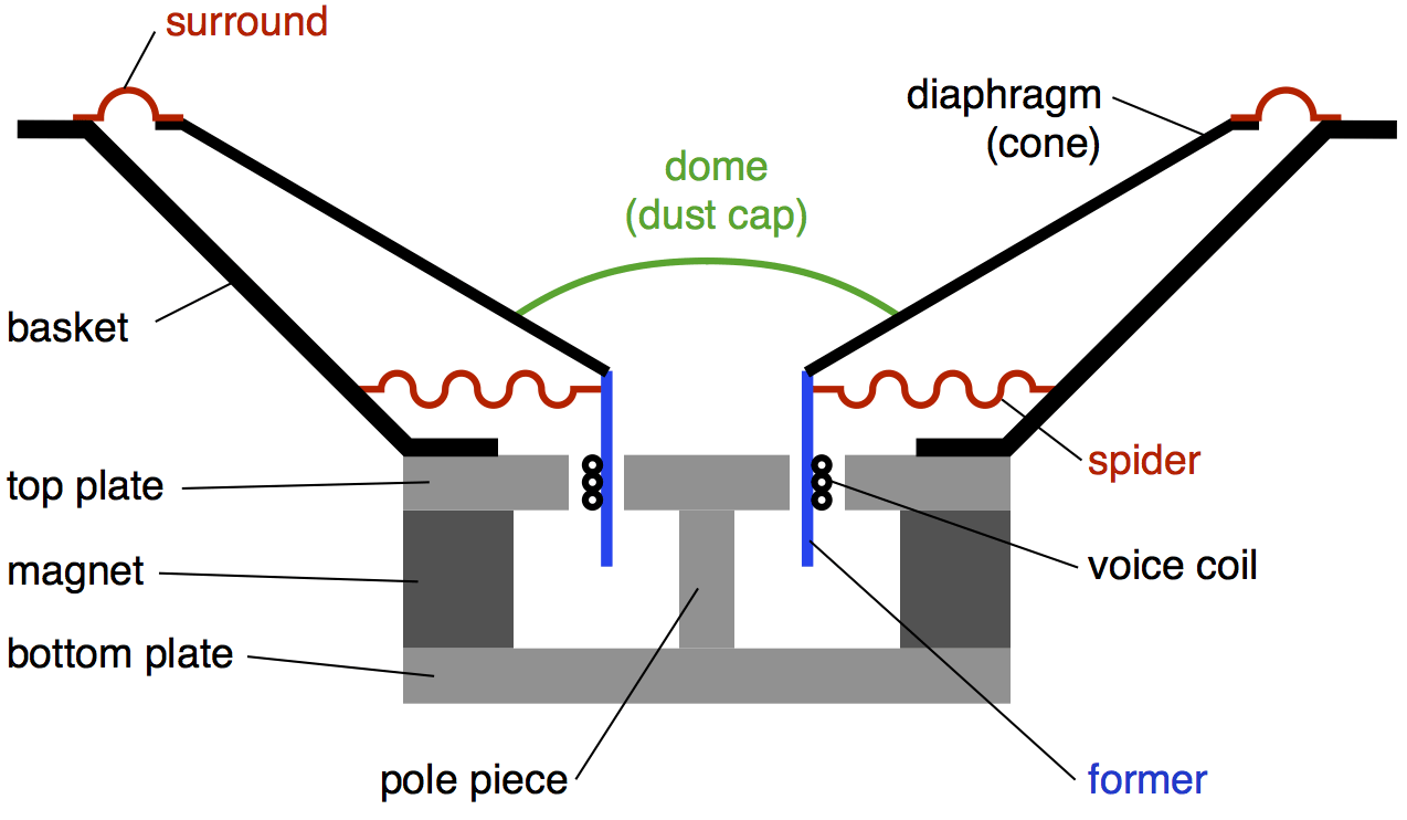

Cone or dome speakers are pistonic by design up until cone breakup which is where the cone or dome acts in DML mode. The cone or dome shapes were chosen because they are stiff structures that resist break up. This was the leading engineering principle for some time then research led speaker designers to acknowledge break up happened and to try to control break up. The BBC did a lot of basic research on this and developed cones with a curved rather than a straight wall and used plastic rather than paper, Bextrene was the favoured material for some time.

The pistonic behavior of a cone speaker is the first intention in its principle. The "break up" which is the same as DML occurs in the upper end of its frequency response.

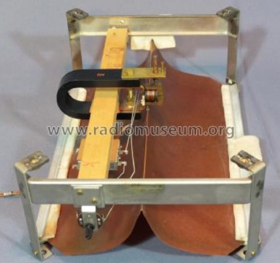

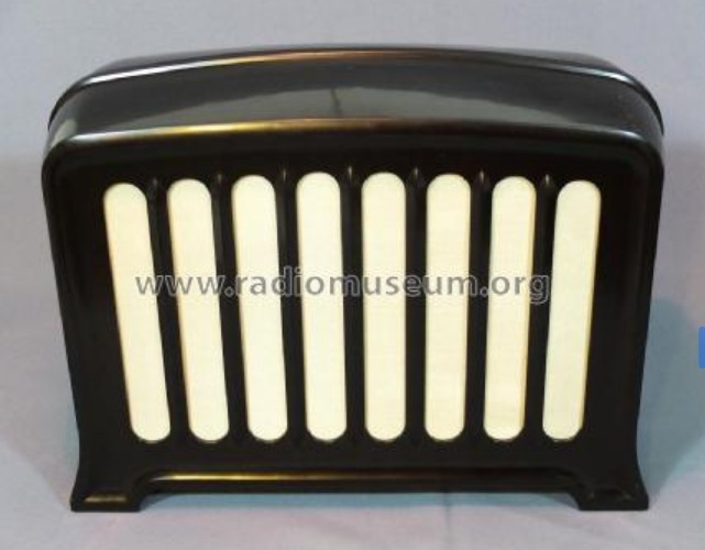

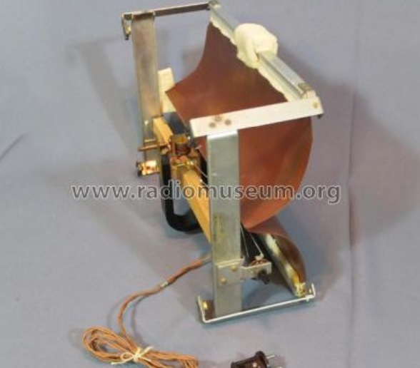

Anyway, in the Rubanoide matter, the French guy must've pinched Haddock's ideas/patents, maybe those patents were already expired by then. I don't know, if the French guy has any patents. But, this idea of curved planes giving out good sound from a point source had existed very much earlier. A Telefunken speaker Arcophon 5 and Arcophon 3 had been on sale around 1929-1932. So, Haddock must've pinched from Telefunken. Anyway, we all do that. 🙂

That is far from all there is about that, I wish it were that simple. Standard speakers are pistonic up to the break up frequency than then enter DML mode. Due to the complex mix of frequencies in music, as Eric’s note on frequency modulation shows, there is nothing simple about pistonic modulation and to add to the complexity cones can be and often are in both pistonic and break up or DML modes at the same time.
