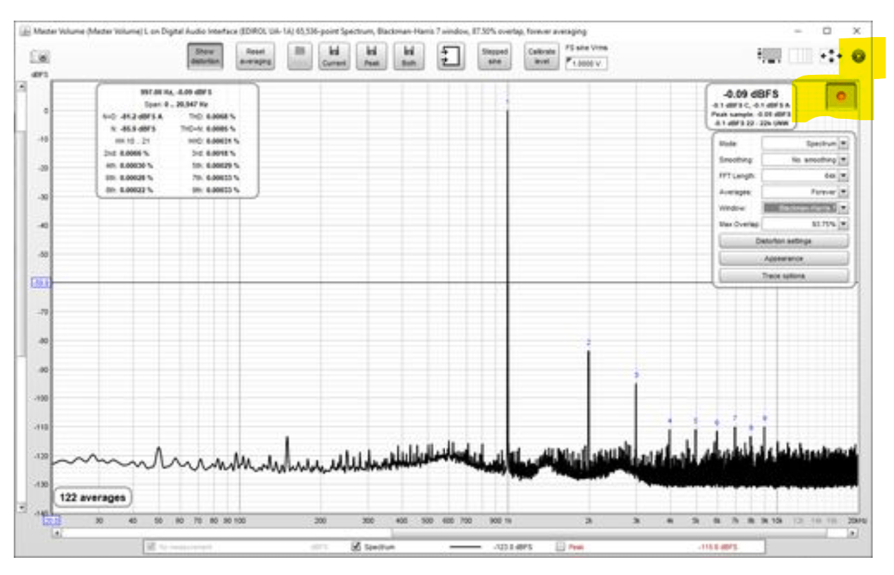

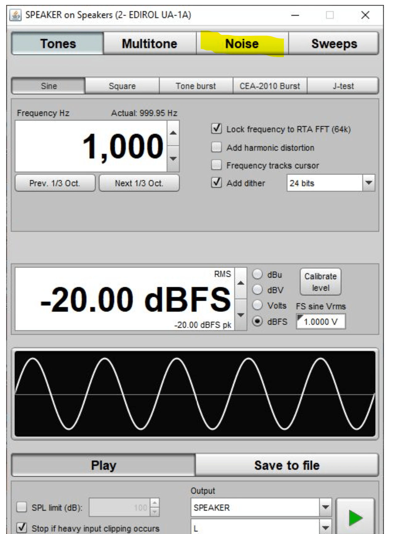

Hi Steve
I have REW on PC and a calibrated mic. I'm not sure what I'd need to do to get a full frequency spectrum from say white noise.
On the main screen of REW there are two icons that look like this:
The first allows you to generate a variety of signals, including white noise, and pink noise. The signal generator screen looks like this, choose "noise" at the top and then pick from there exactly what noise you want, then click on the green arrow (at the bottom right) to start the signal.
Open also the RTA icon. It will give you a frequency spectrum. Choose what type of spectrum you want using the control panel (gear icon in the upper right), then start the RTA function by hitting the start button just below that. After hitting start you will get a real time frequency spectrum. Both are highlighted in yellow below.
Hope this helps,
Eric
View attachment 1133930 View attachment 1133931
Hope this helps,
Eric

Many thanks Eric. I'll have a play tomorrow. OB bass + DML mid/top hybrids currently sounding very nice with some Rachmaninov.
You're welcome.
There are a couple of ways to do this, but IIRC, you can use white noise, and the the "spectrum" mode, or pink noise (or pink periodic noise) with any one of the "RTA" modes. Either of these should give a flat frequency response for a perfect speaker. Other combinations ( i.e white noise and "RTA" mode would produce a sloped line rather than a flat line. At least that's what I recall. If someone knows better please correct me, it has been a while since I did measurements like that.
Eric
