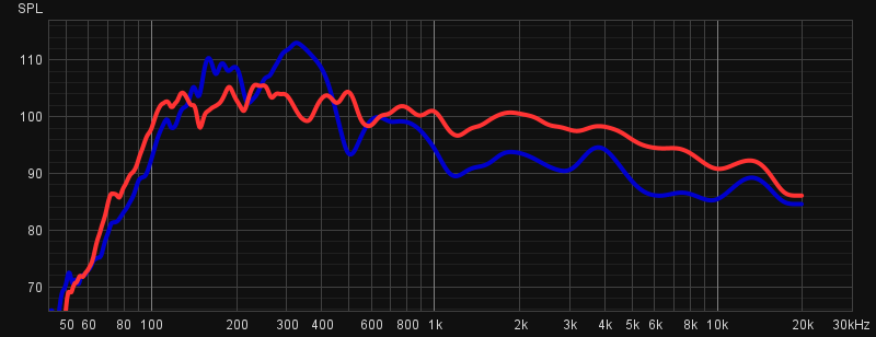

Lordtarquin.Finally dug out the laptop with measurements of the panels for the PA system.
In the rush I had not labelled them too well, but I think this is the correct responses.
Blue is pre-eq and red after.
I think I ignored the very large swings in the mids, since they where sounding really good with some EQ and I was in a hurry, but looking at the curves now it is actually nice to see what a disaster it is pre-eq, considering it still sounds really great
It means there should be plenty of room for improvement when tweaking them to even out the response in 250-600Hz region. I'm hoping I can get decent results by modifying the suspension more, which is very easy to do.

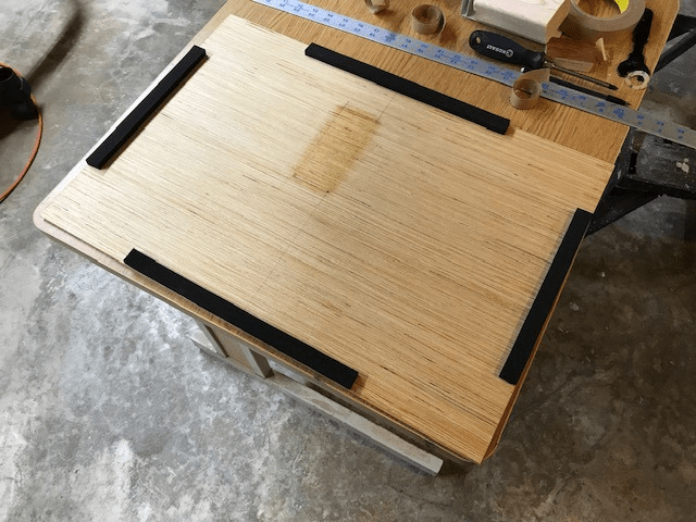

If you use multiple exciters, first try connecting them together with wood brace. You can use double sided adhesive tape to glue the brace on the magnets.Could someone kindly send some photos or links where it is possible to see how to hook the magnet to a structure behind it that can support it, the panel in cf with nomex sounds great but the one on the support behind I just can't get it to work.
Eric, how and where do you attach the panel to the frame? This is something I've wrestled with since I began the whole project.
The easiest way is with double sided mounting tape. Attach the tape to the frame and then attach the panel to the tape. The mounting tape I like best is 3M Extreme double sided mounting tape. It comes in a strip 1 inch wide but I prefer to use only a 1/4" to 3/8" wide strip. I prefer to use the tape around virtually the entire perimeter, except for a few inches (2 or 3) from each corner. But the only reason for leaving the corners free is because it makes it much easier to separate the panel from the frame later if you want too.
Instead of the mounting tape you can use foam like the gray Frost King window weather stripping, or EPDM foam. Those are typically about 3/8" thick and 3/4" wide. I use the full 3/4" width with those. Also, these usually only have adhesive on one side, so you have to use something else (double sided tape or spray adhesive) to mount the other side to the frame or panel. But which tape or foam works best, and which dimensions depends on the panel material. Finding the best combination is still trial and error for me.
In the images below I attached the foam to the panel first, instead of the other way around. I also used a bigger gap in the corners than I do now, but I think you can get the idea.
Eric

How have you attached the exciters to the panels, using the sticky pads or using glue?
Steve.
Just spotted this. I EQ my overall response to an overall 3db drop from about 40hz all the way to 20khz.
I use a fancy Gorilla glue to attach the exciters to the panels. The sticky pads tend to result in poorer energy transfer from exciter to panel.
Simon
Many thanks Eric.The easiest way is with double sided mounting tape. Attach the tape to the frame and then attach the panel to the tape. The mounting tape I like best is 3M Extreme double sided mounting tape. It comes in a strip 1 inch wide but I prefer to use only a 1/4" to 3/8" wide strip. I prefer to use the tape around virtually the entire perimeter, except for a few inches (2 or 3) from each corner. But the only reason for leaving the corners free is because it makes it much easier to separate the panel from the frame later if you want too.
Eric
View attachment 1134339 View attachment 1134341
My approach is similar but a little different, with approx 25mm long strips of 6mm thick x 15mm wide neoprene foam attached with 25mm gaps all the way round including the corners. I PVA both sides of the foam & stick to the frame first, and then panel onto foam once the foam is stuck to the frame. My 2mm ceiba ply panels are only 30x40cm, so relatively modest in size. They are also very light for plywood. They operate mainly from 400hz upwards (XO set at 500hz, Butterworth 4th order 24db/octave) to help remove a peak around 400hz that's hard to EQ out.
I was wondering whether less foam and less sticking would give a better result with the panel edges being less constrained, or whether there would in fact be an increased opportunity for unwanted 'buzzing' and other artefacts. I know Steve goes for a very minimalist approach with his panel supports. I think I'll try 10mm wide neoprene foam next time.
Simon.
