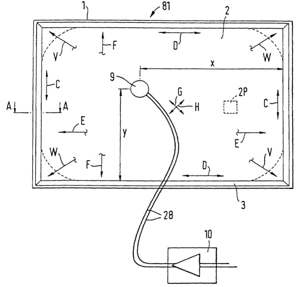

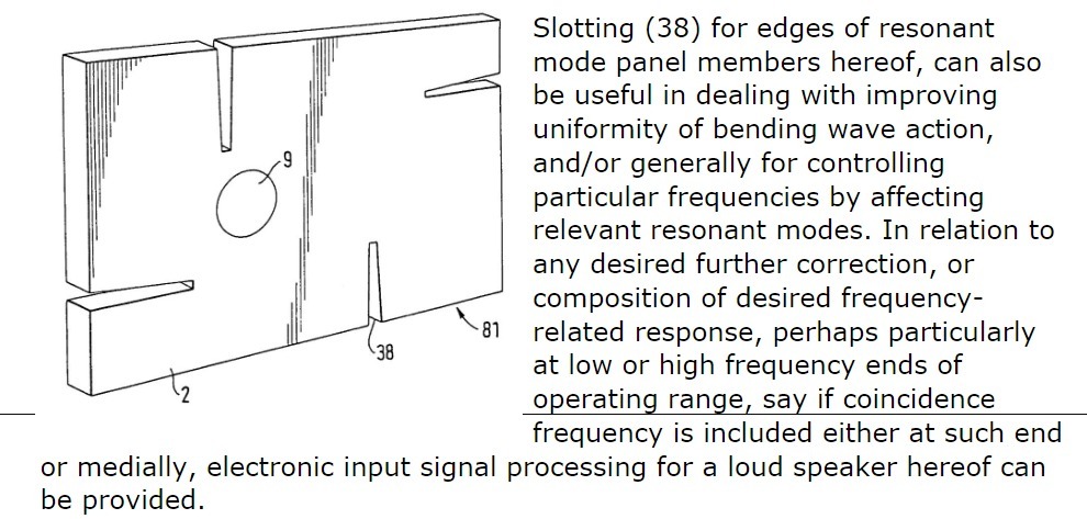

Here's a good patent to read. One of them, actually. Not much in the Google page, but more in the pdf. It is too wordy, though.
The hardest part, I suppose, is how to prevent the pistonic motion attacking the panel. I haven't found a solution for that, yet.

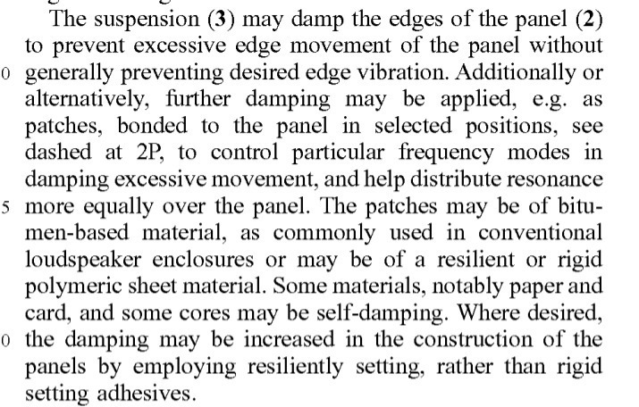

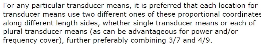

You can find the answer in the pdf of that patent I linked, page 63, right side. You have to read it looking at the Fig. 1.Excuse me, could you explain this blue tak thing to me? I don't understand where you are applying it
Look for 2P in this text.
Actually, you can find answers to all kinds of questions in that patent.

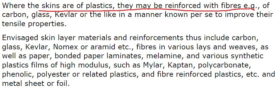

Akylite is a polypropylene sheet that has very good rigidity despite its low weight. This is due to the core: it is made of transparent polypropylene that has been vacuumed. This creates a honeycomb structure, which makes the material extra strong.
Also, before starting, it might be helpful to read the patent I linked in the post above. You might lose few days, but less headache later.
Page 62, right side of the patent pdf. You would read about skins and why they are needed in that patent.
