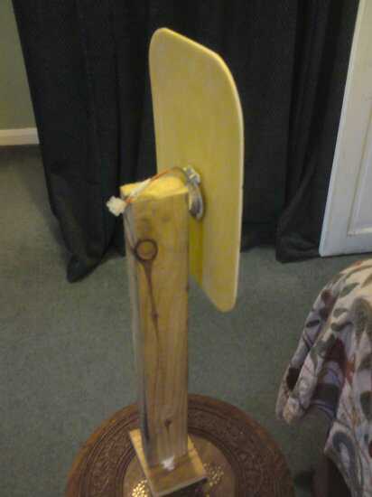

With small light panels , they can be mounted without supports of any kind, totally free floating.
This picture is from my NXT RUBBISH gallery.
My 7ft EPS panel used to stand on the floor sometimes clamped at the bottom for support and to prevent movement (panels walking across the floor on loud heavy bass ).
Steve.

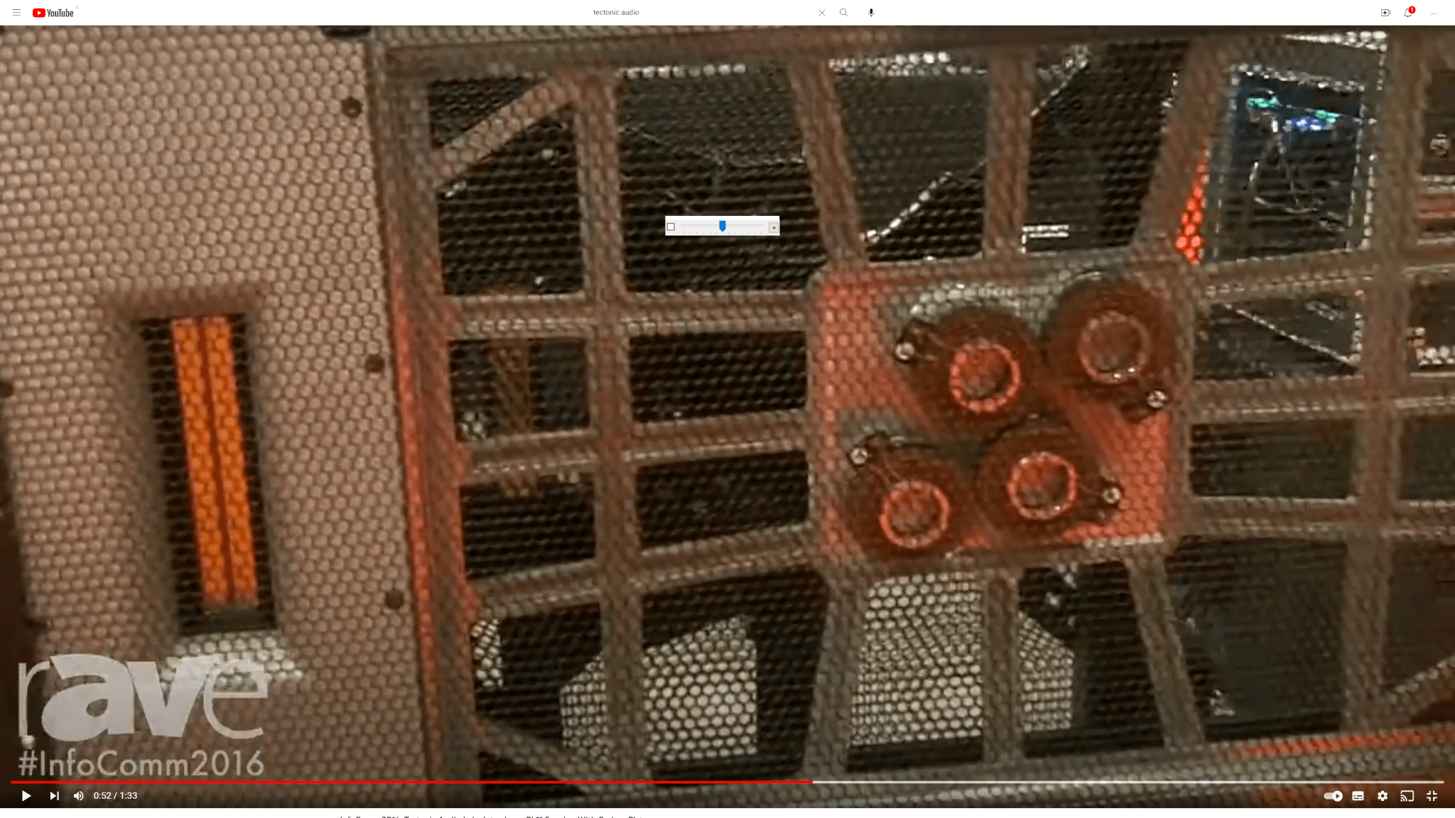

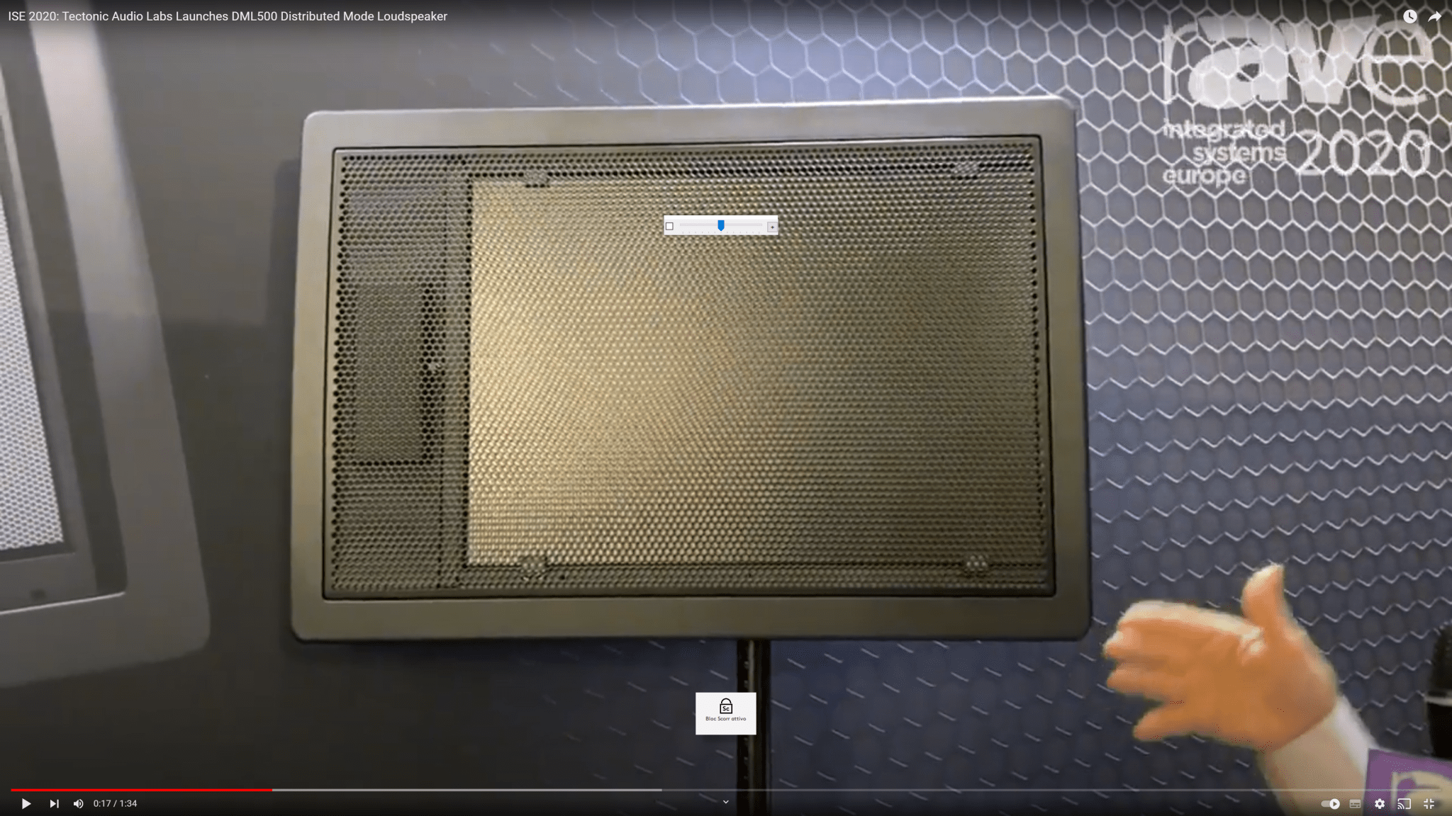

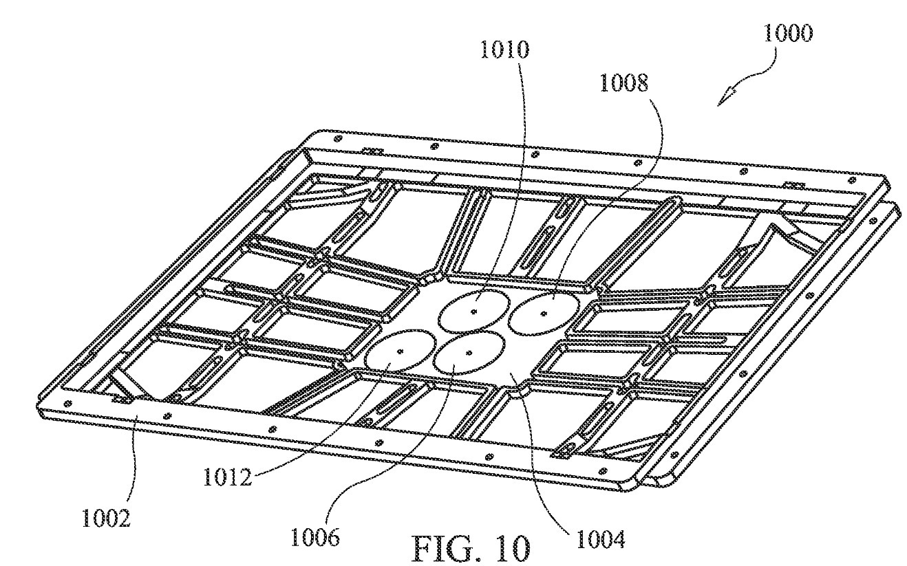

Hi Pixel1,
The Tectonic panels seem to be connected rigidly to the frame at the 4 points and by soft material on more than 50% of the length of each of the four sides.
Check the link below for a better view.
Eric
https://tectonicproaudio.com/about-the-technology/
Thanks Valerico, I hadn't noticed in the animation that there was some kind of material on the sides, I wonder two things what material they used and if it is only attached to the vibrating plate side or also to the frame. What do you think?
pixel1,

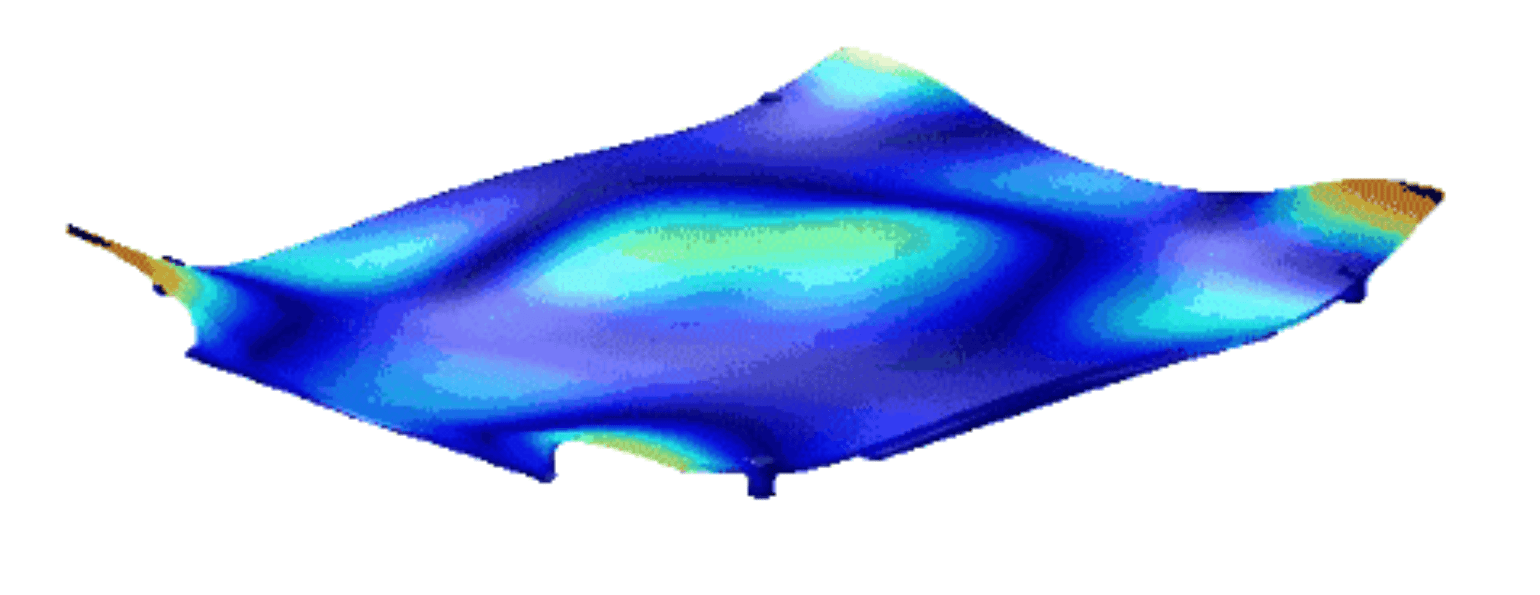

I don't recall ever reading anywhere what material Tectonic uses around the perimeter. It may be mentioned in their patent, I'll have to look again. I suspect it is a material with high damping. If anyone knows I would be interested to hear.
From the animation, the material appears to be attached to both the frame and the vibrating plate. That's my interpretation.
It's also interesting about the four fixed points. From the animation, it doesn't look like the plate is truly "clamped" there. That is, while the plate doesn't seem to move vertically at those points, it does appear to rotate freely in both directions. I'm curious exactly how those "points" are actually designed.
Eric
Reactions: 1 user
yes, the only thing you can see from the photos and videos on youtube is that they use an L-shaped plate in front to lock the panel frontally. What I've never read on this forum is someone who has seen and heard them play in person

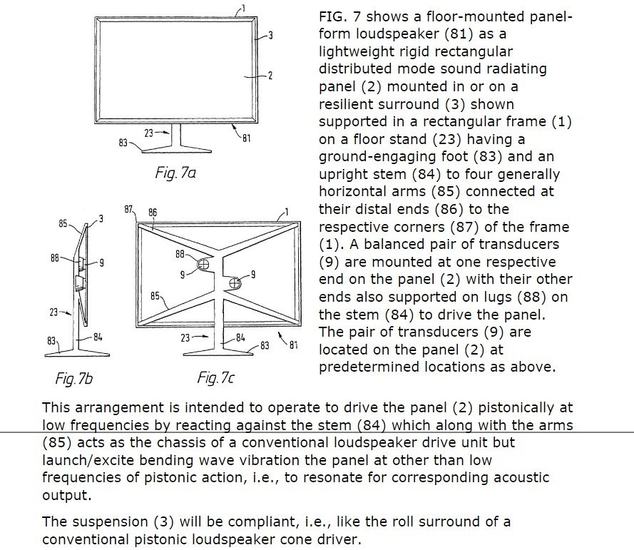

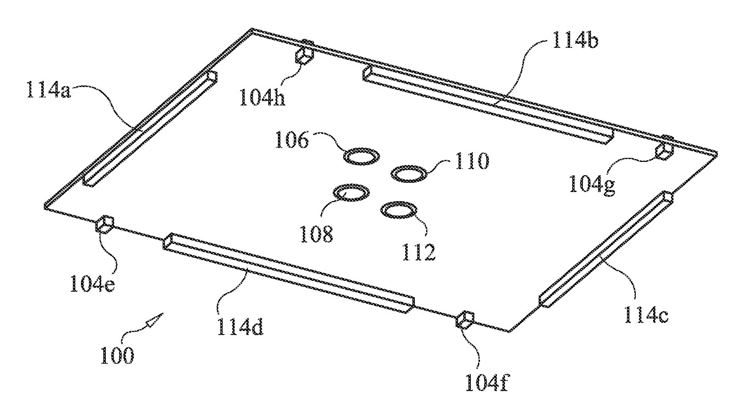

Here's the patent for that. As always, better read the downloaded pdf.
  • FIG. 1C is a rear view of a distributed mode loudspeaker illustrating the outer surface 102b of the panel 100 with additional supporting elements in an embodiment.
  • In this embodiment, four foam strips are provided on the outer surface 102b of the second skin material layer of the panel 100 so they can be insertably connected into matching grooves on a mounting frame.
  • The foam strips 114a, 114b, 114c, 114d are comprised of open-cell or closed-cell foam material that is often used with an expanded rubber (e.g., Poron(R) that aids in creating a light and suitably stiff distributed mode loudspeaker with optimised boundary conditions.
  • The outer surface 102b in this embodiment also includes the four transducer coupler rings 106, 108, 110, 112 for receiving a coil former on each of four different audio transducers.
And so on...You'd have to read the rest. :)
