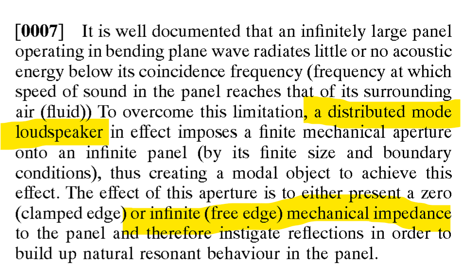

From this patent:
https://patentimages.storage.googleapis.com/ea/0e/93/9583fcf9a1db27/US20020044668A1.pdf
There's also certain independent research going on the bending wave, transverse wave, distributed mode, balanced distributed mode etc technologies in other parts of the world, such as China, Japan, Russia or South Korea. Some are slightly translated, some are not. So, Azima is not the last and only authority on this, just one link in the chain.

So, I say to everyone newcomer, or who still wants to make a good distributed mode loudspeaker, just read the patents.

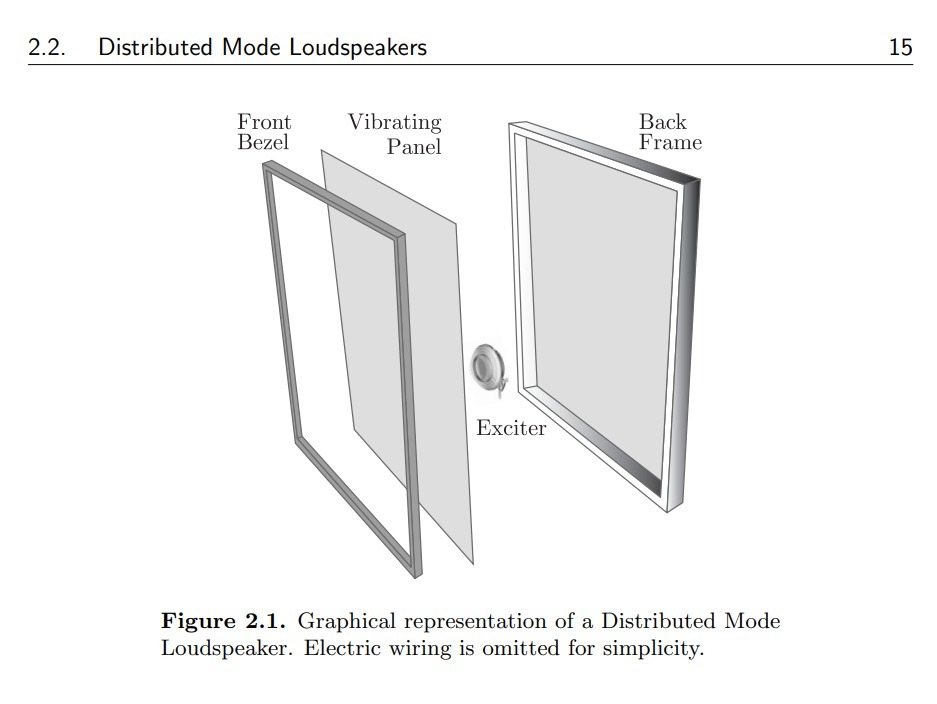

This is similar in design to my friends panels .For an an earlier effort, I used an H baffle with an Abstract frame on top of it (see attached sketch). One could freely hang a DML panel from the top of the frame or use one of the Abstracta clip solutions to secure the panel (with foam between clip and panel).
One could also (if required) use a cross bar to support the exciter.
Lots of options. Easy to assemble.

Looking at your design reminds me of a design I have seen before and used before.
I will try to cover this in later posts.
Unless someone beats me to it.
It gets a bit involved.
Steve.

yes, I had the tectonic pdf yesterday and today I read the patent well, I have a wooden frame but I have to create a rear support which, in addition to supporting the exciters, also has the task of hooking the parts of the panel with rubber or foam as well as apart from the 4 fixed points, I have to find a temporary solution for the tests and then move on to something more beautiful and stable, I don't see it as easy. What I wanted to ask is if the tectonic panels also sound on the back, on closer inspection I think so but for normal use it should cause problemsI don't know, if you have this pdf already, if not, this might be of some help for your project.
