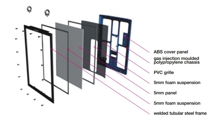

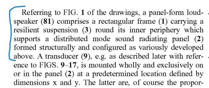

Anyway, for the radiator panel to become a fully fledged loudspeaker, its perimeter has to be secured with a resilient suspension, that is, because of the edge "problems"...
This matter of the perimeter suspension is mentioned in every patent/document I had read up to date, DE/GB/US and other foreign ones. The above quote is from a standard Azima patent. If anyone can give a link to a NXT/Tectonic patent, which states that the free open perimeter of the radiator panel is the preferred method for making a distributed mode loudspeaker, I'd be glad to study it.

So, the most important factor of a Distributed Mode Loudspeaker (DML), the radiator panel, for example the 5mm panel as in the post #8,945, has to be created, a composite with a very low density homogeneous core and two quite thin homogeneous surface skins, preferably of carbon fibre. The core is needed only because the very thin, like 300 micron, surface skins don't have the necessary stiffness. The core is actually a hindrance, but there's no way to do without it, physically. Anyway, a composite has more strength, more stiffness etc, than its components. Still, the core must be homogeneous, has the same stiffness in both directions. It could be cellular matrix or a honeycomb matrix, but not a corrugated matrix. Such a matrix contains a lot of air, but very stiff after the skins are glued on. One can use processed wood products such as paper or card for the matrix, which is the cheapest, but not long-lasting. Balsa wood was suggested in the Göbel patent, but that was dropped in the later products as plain wood or plywood is not homogeneous.
The preferred types skins are given in the patents, and the best being carbon fibre, better even if the weave is at 45 degrees. The skin is the most important element in the radiator panel, as it is on that surface the distributed mode bending waves happen, and the result depends on the physical characteristics of those skins. The information on that is given in the patents. There's quite a bit of maths and physics of the strength of materials are there, if one understands. The strength of materials is a separate section of applied physics. NXT was a lab of more than 40 engineers and scientists.
In the earlier days, NXT licensees used polystyrene sheets as the radiator panels for cheap PC speakers, or for toy speakers, but for the prototypes, NXT used better high quality composite panels. Armstrong, a NXT licensee, used very low density synthetic foam material for their CS1000, but that was quite weak loudspeaker.
Tectonic Audio Labs only use carbon fibre composite panel with carbon fibre skins for their DM loudspeakers. Sheet Control/DPK Sound now use very light aramid honeycombs as the structural element (core) and a special grade of paper as the skin.
As for transducers, both Tectonic Audio and DPK Sound make their own, and their placing on the panel is still a trade secret.

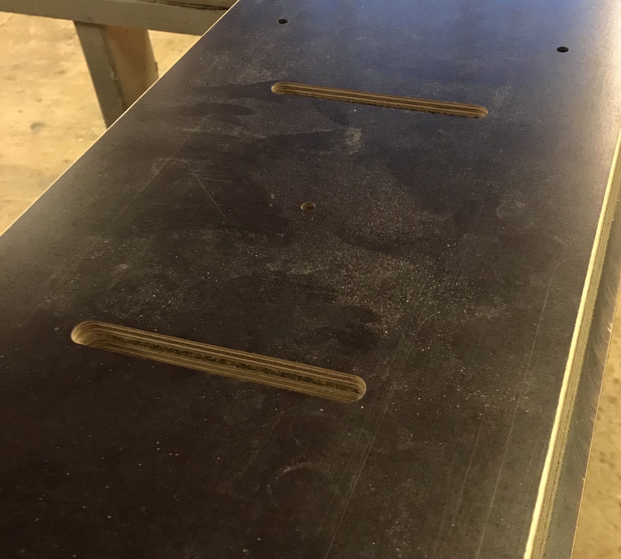

Maybe, you also employ the idea here, #8,733 as in this patent, for that? Fig. 5 description in page 64, right side, to get rid of the back sound? The two side rectangular holes would act like bass-reflex, enhancing the lows. NXT/Tectonic placed their ideas in many separate patents. :)
I cover the holes with 3m acoustic thinsulate and wool felt. Not like bass reflex, like leaky sealed box or aperiodic enclosure.
