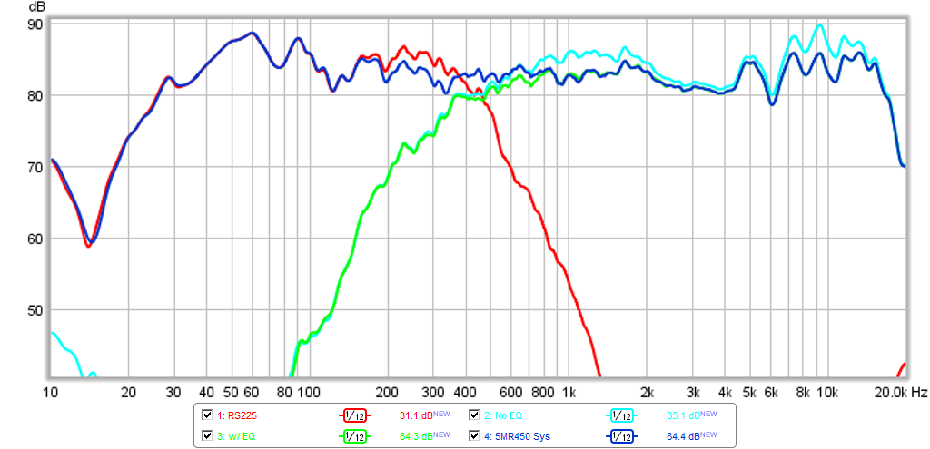

Eldam was wondering what the 5MR450NDY sounds like with the latest setup. Here it is with the 350Hz Harsch XO and mounted in the Nautaloss with RS225 woofer for bass. Same sound clips as Round 4. There is a BSC applied to flatten the rising response.
Here is the XO response, the sound clips are of the non-EQ'd response (light blue):
It may sound a bit bright. Let me know if you are interested in the other set of clips with just two gentle PEQ's applied.
Cool !
If you notch the 5K Hz peak with - 5 Db, is it always bright ? Or do you think it comes from the 1K to 2 K Hz range ?

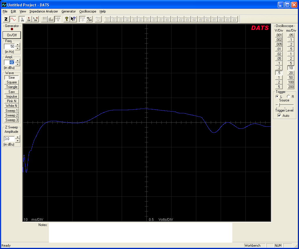

Does DATS have an O-scope mode?
I just checked the manual - YES. I think I am good then and will give it a try. Can handle up to 5v signals. Also has a function generator.
Yes software package has but when using DATS as the soundcard device we have no ground connection only the red and black leads which are hot mono I/O's and ground is not offered outside plastic house. And problem is if you shift to computers soundcard inside DATS software package there is no calibration so actual levels are not true.
You can go to trueaudio.com and download TrueRTA which is nearly same as DATS software packet, the free version is limited but that's only the RTA section that is limited to 1/octave. Oscilloscope and generator think will could do your job via computer soundcard but will need to be calibrated as manual can guide one thru to get precise readings. If you think of connect to speaker level drive voltage watch out to not overdrive soundcard by some padding network.
I think I figured out how to use it as an O-scope on any signal: set the funcion generator output to a very low level (it won't work without some signal being generated) like -60dBU. The view the Left channel which accepts inputs. For example, here is the voltage generated by me tapping a driver diaphragm (acting as a mic).
Volts are calibrated using DATS precision 1.000kohm resistor and built in signal source.
I think the main culprit is the 5k peak. The 1k-2k gives more presence but not annoying.
Here are some sound clips with two small PEQ's applied in the1-2k and the large cluster of peaks in the 10k range. So the sound now follows the dark blue response in the above xo plot.
I did not get rid of the 5k peak yet as that would be a rather "high Q" EQ and trying to avoid those for now.

@ X : thanks for the reccordings !
At home the notch I made on a similar peak at 4.5 K helped a lot...(width : around 3k to 6 k) ! Mine was measured with tone burst at listening position, maybe in the axe here this bump is less a problem ? I don't know!
