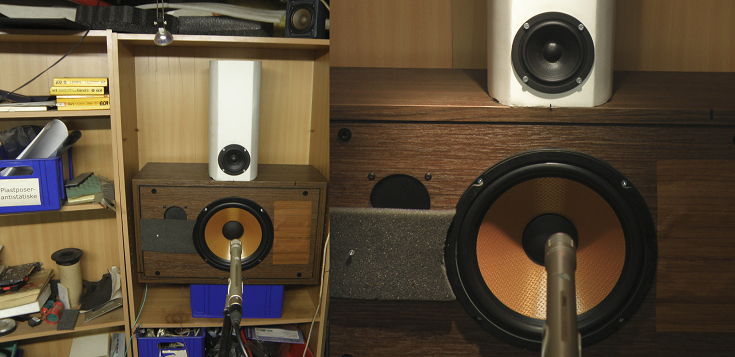

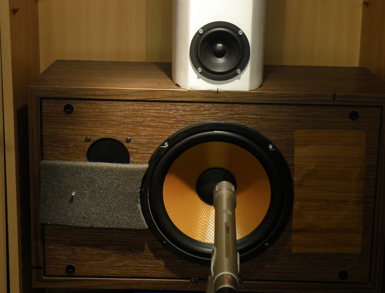

The round 4 was made with a plywood faced speaker. The thin ply was glued to the 1in thick XPS foam with a compliant adhesive for CLD. The sound of the front baffle is very dead when tapping on it. The low HD measurements of the 10F show that cabinet is not causing any HD problems. The HD measurments that I made later in the Al foam core Nautiloss is a little higher. That may be cabinet vibrations that cause that increase.
Soundclips FAST 10F/8424-SPH250KE
Had long time thinking about do some recordings as inspired by X : )
Eldam talked lot about the Miles Davis track "So what" so recorded that this night and was surprised how good it got therefor when setup was put there did four more recordings and now share them here.
Replay chain is computer/Jriver/HIFImeDIY-UAE23/optical/DEQ-2496/solid 0,4mm copper wire/Sansui AU-D9/solid copper 0,5mm wire/FAST speaker system. Recording chain SM81/multicore wire/XENYX 802/multicore wire/UCA222/computer/Audacity 2.1.1 at 48kHz/export as 16bit 48kHz flac.
In Jriver both left and right track are routet to mono speaker to get sound picture as one expect from the stereo track then recorded as monofile in Audacity 48kHz flac file and to have a reference to compare with same conditions CD stereo tracks are mixed to mono in Audacity and saved as 44,1kHz monotrack flac file.
All 10 tracks five recorded + five modified reference will take 138Mb disk space therefor they are found on a cloud drive. In below txt-file copy paste address into browser and press download at the cloud webpage.

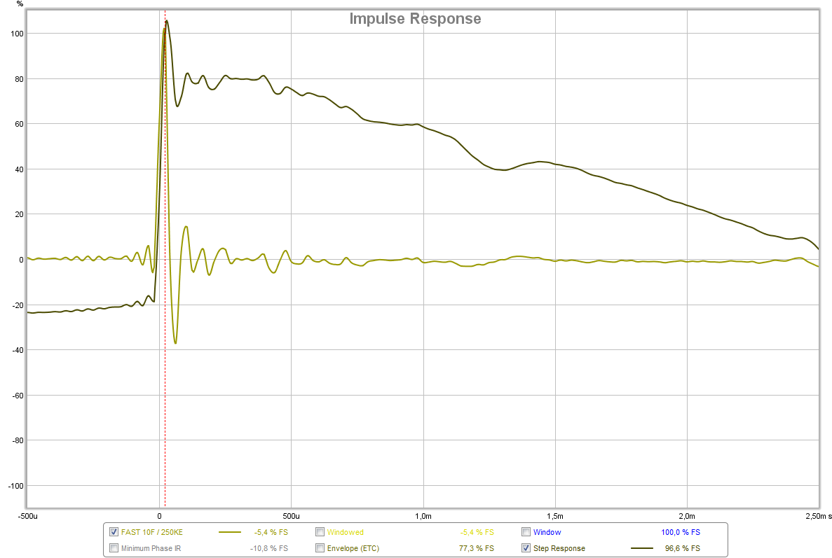

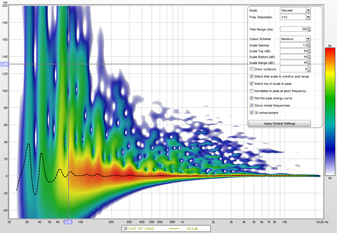

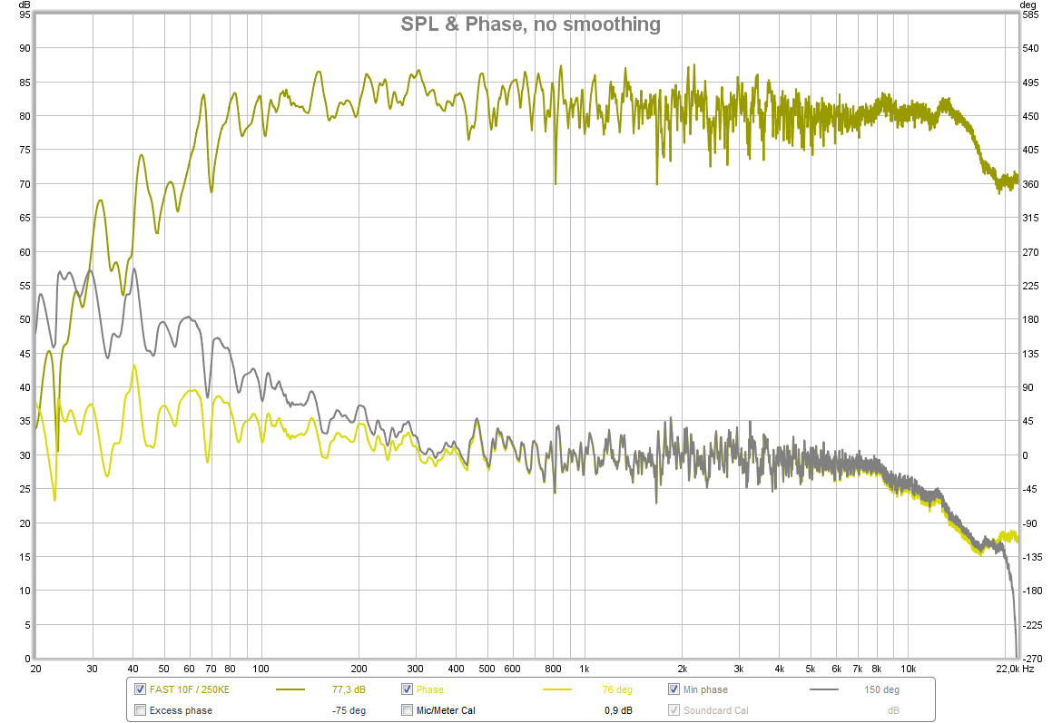

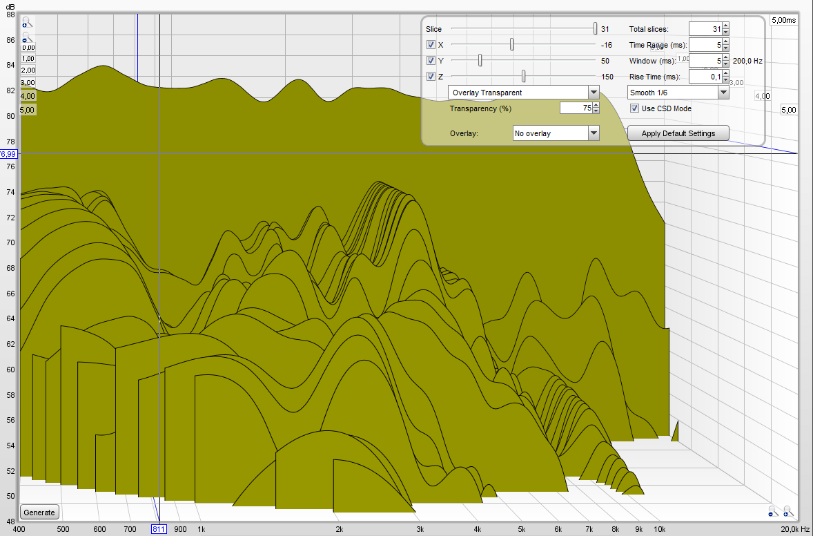

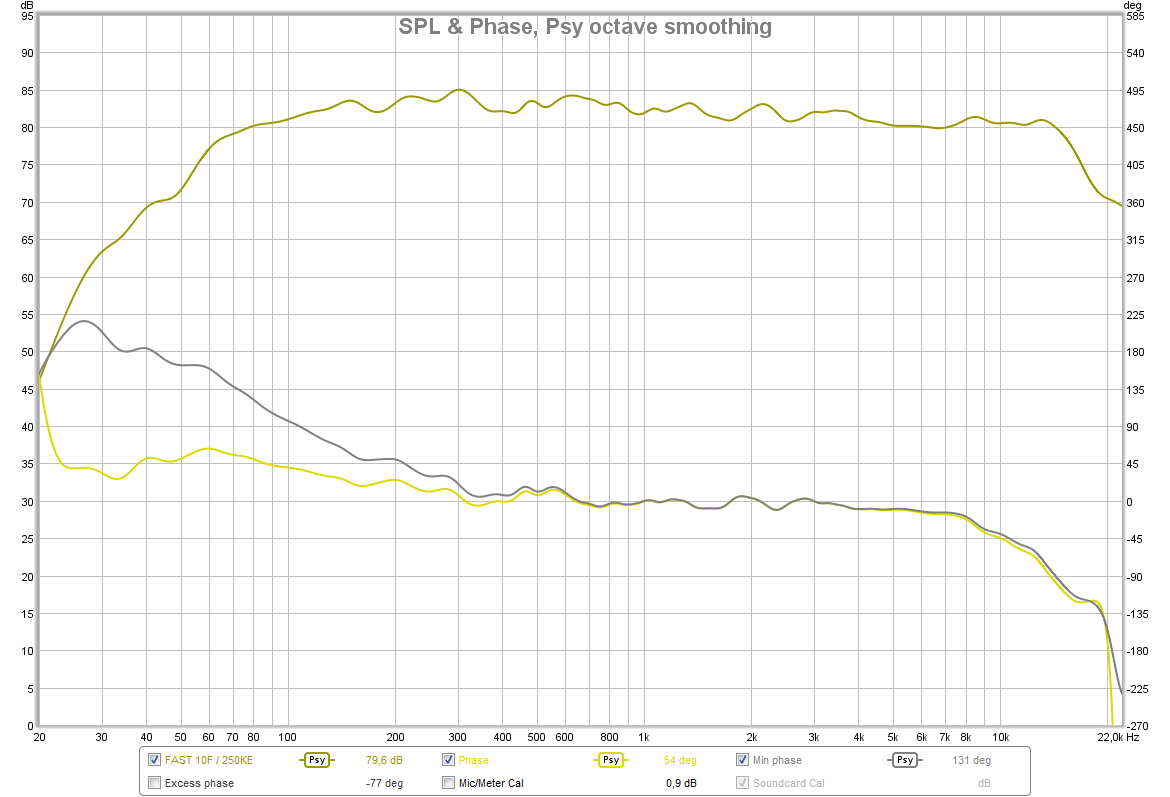

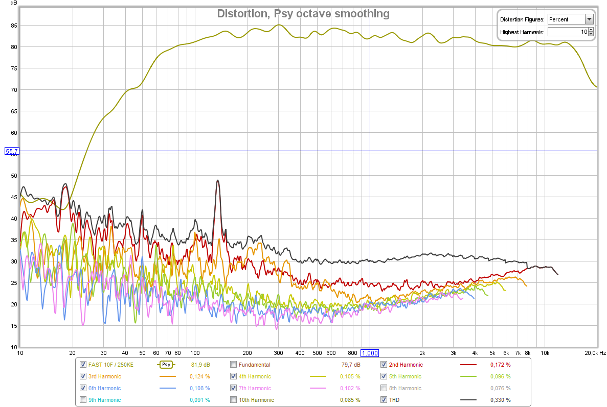

Measurements FAST 10F/8424-SPH250KE
Here measurements done at same 54 cm distance as recording was done. Jriver DSP is responsible IRR EQ/IRR XO LR4 500Hz acoustic/0,21mS delay tweeter/FIR convolution to neutralize LR4 XO and IRR system low end HP. This is clear when looking at how relative flat system phase is and show also minimum phase as REW calculate based on frq response for a IRR system. System also quite capable to produce square waves as is although dream about being as good as wesayso, Barleywater and gmad to tweak system settings 😎.

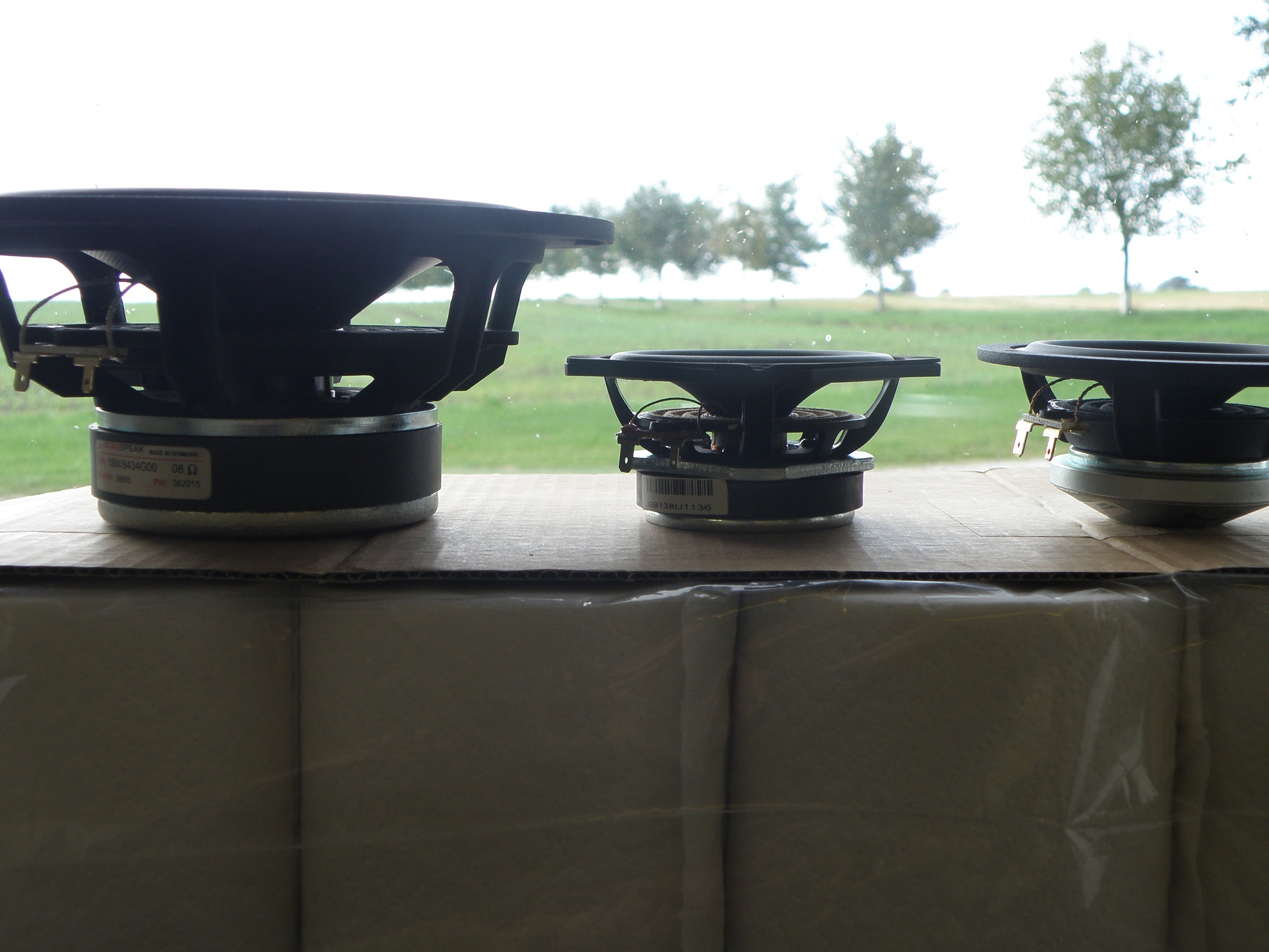

A Neodymium magnet could be smaller, allowing more rear ventilation. Maybe that's why Scanspeak created the 10F.
I'm sure that wasn't the reason in this case...
See the picture from BYRTT earlier in this thread:
The TC is more ventilated than the 10F, that was a big surprise for me when I actually held a live sample of the 10F in my hand.

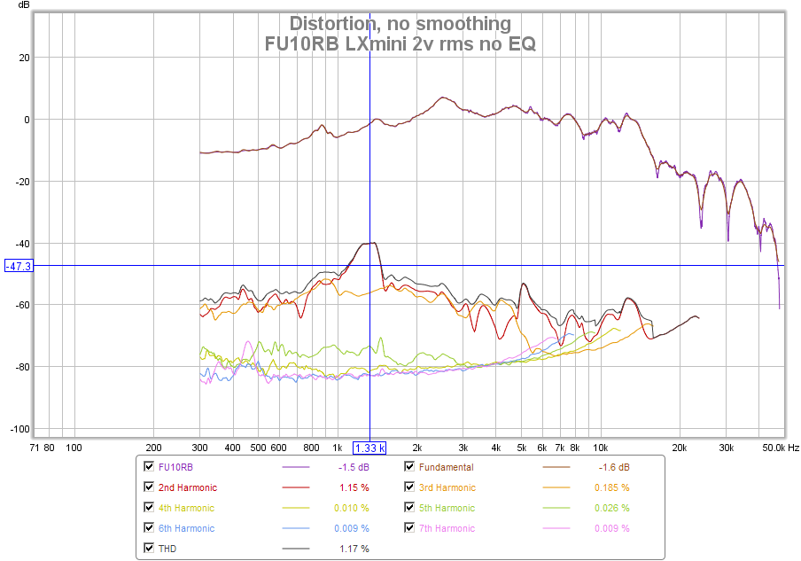

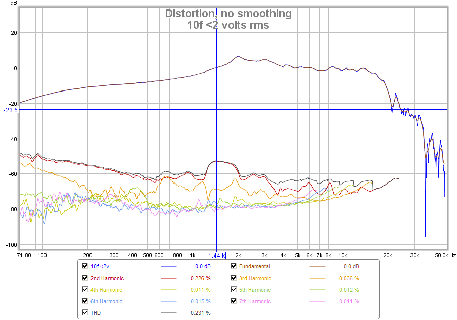

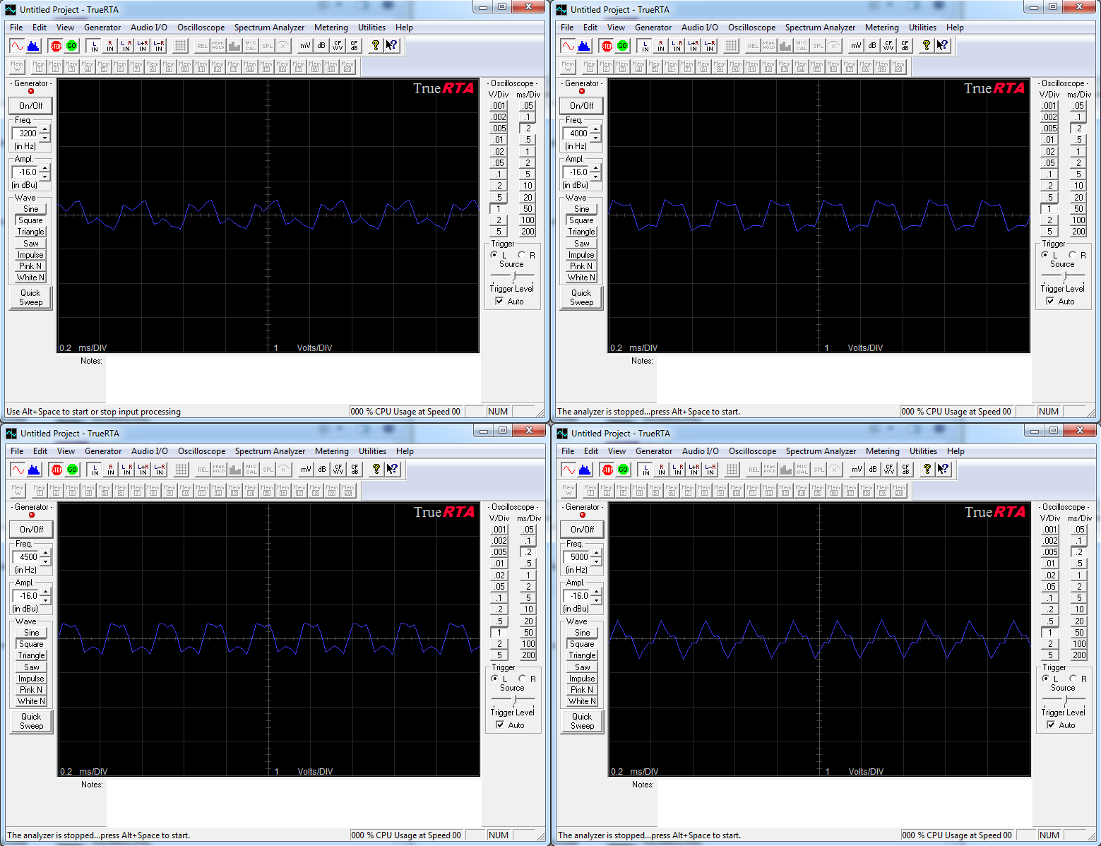

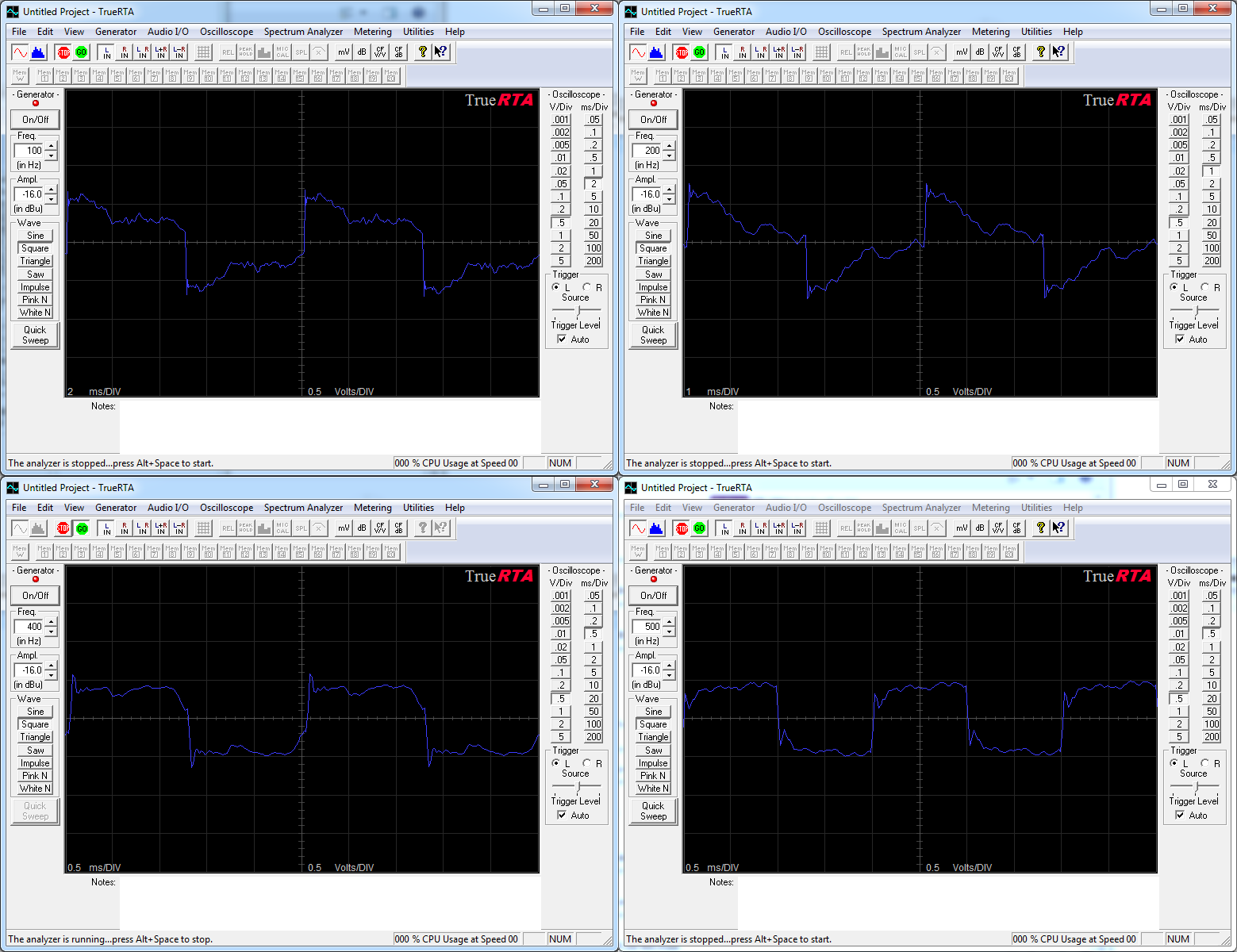

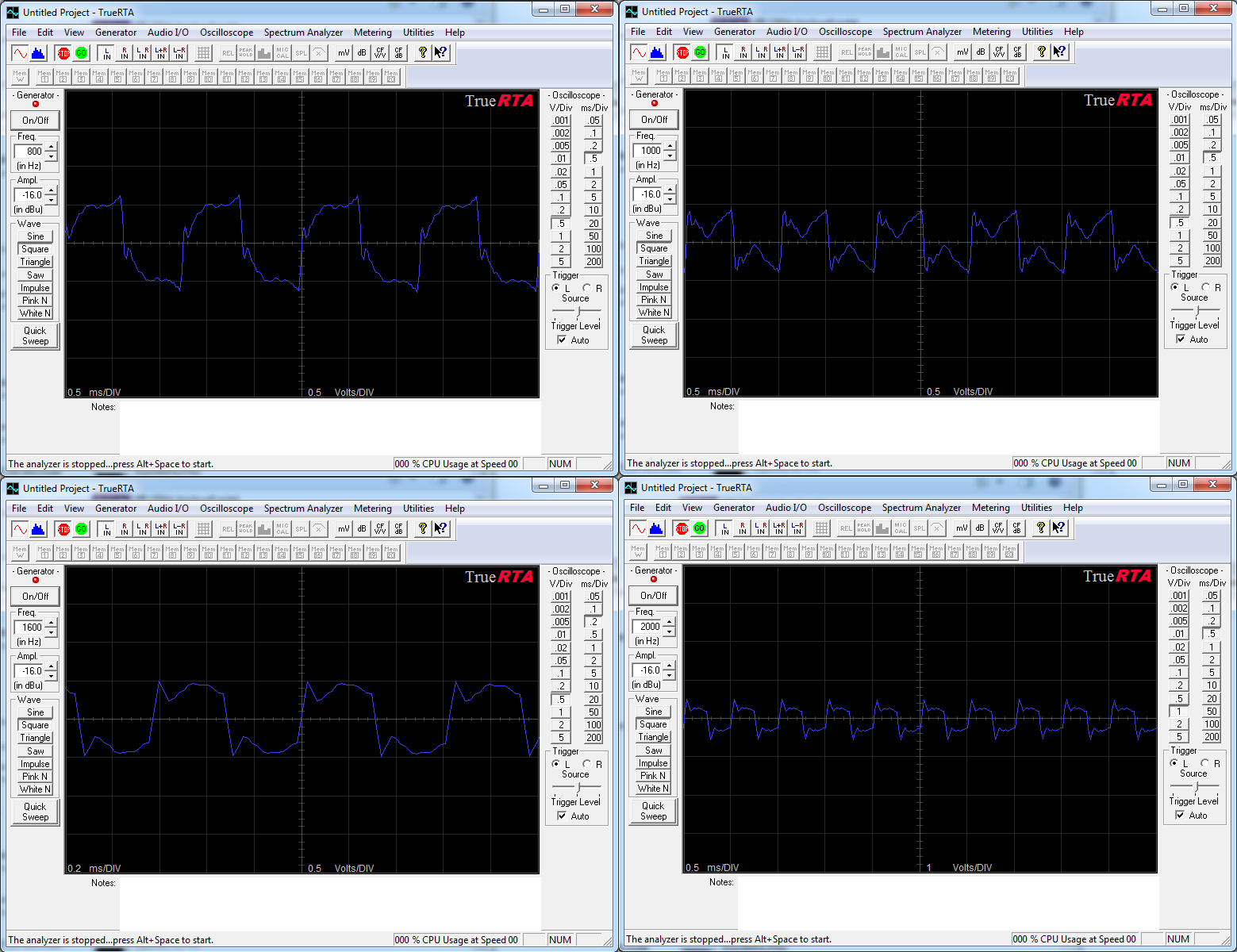

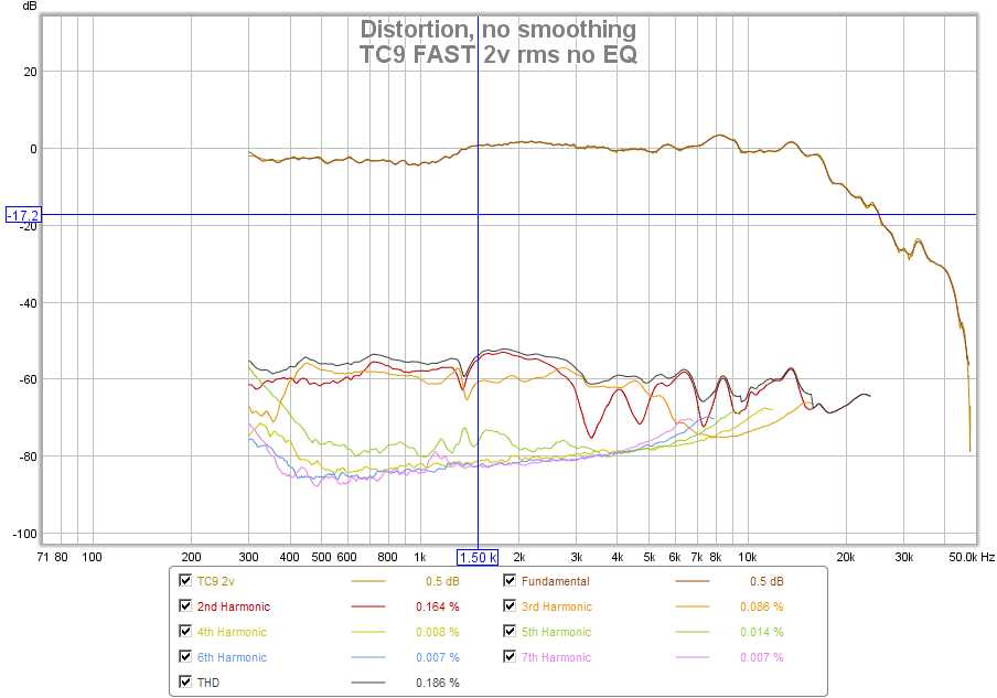

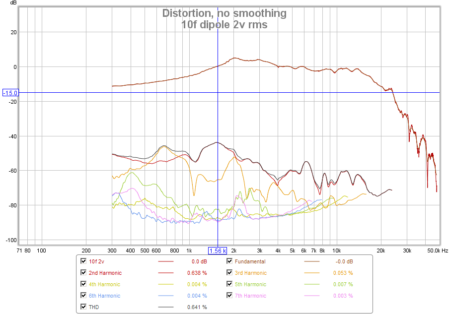

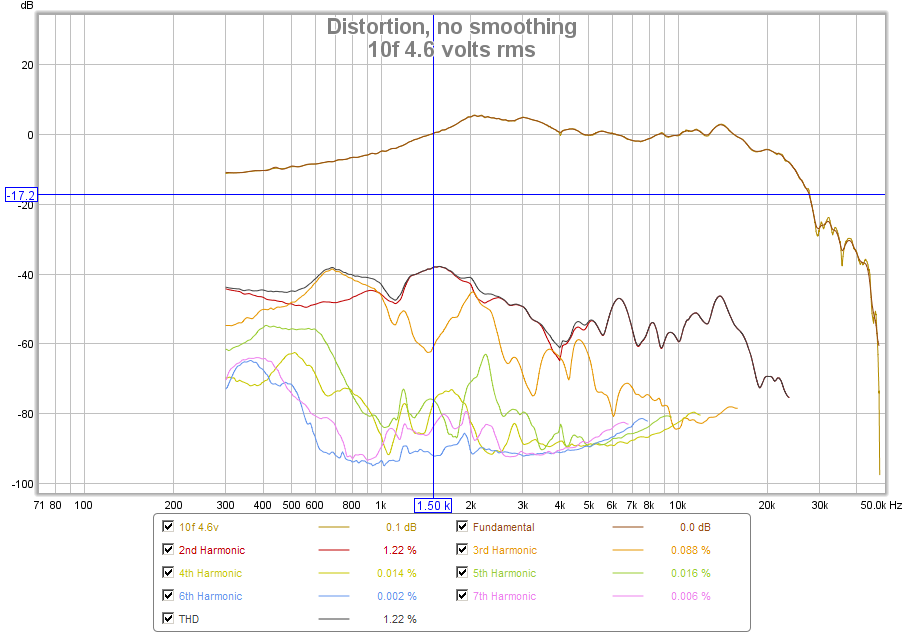

I've done some survey measurements of 10f running as naked dipole.
I started with 440Hz sine wave, and was immediately taken to task for earlier post about audibility of HD at low levels. By ear the level didn't seem very high at all, but a distinct higher frequency signal was present that at certain points in room where fundamental has standing nulls really stood out. I set up a track with 440Hz and track with 5th harmonic and adjusted mix for hearing lowest level, and found this was with 2200Hz mixed -62dB to 440Hz. Respeating with 3080Hz, I could discern this mixed in at about -55dB. OK, hat eaten! With music signals these levels have little impact on perception, or according to Geddes no impact. IMD and transient IMD play bigger role in roughing up the sound.
A full range sweep at less than 2 volts rms (didn't get the volt meter out!):
Then sweep at 4.6 volts rms:
Next sweep at 2.0 volts rms, followed by 2 volt sweeps of TC9FD in sealed 4" diameter pipe, and of FU10RB in LXmini setup with driver mounted in front of well stuffed 3" diameter pipe 5" long.
10f:
TC9:
FU10RB:
Dipoles seem to incur 2nd harmonic peak below dipole peak. It will be interesting to see results of 10f mounted LXmini style. In a new thread.
