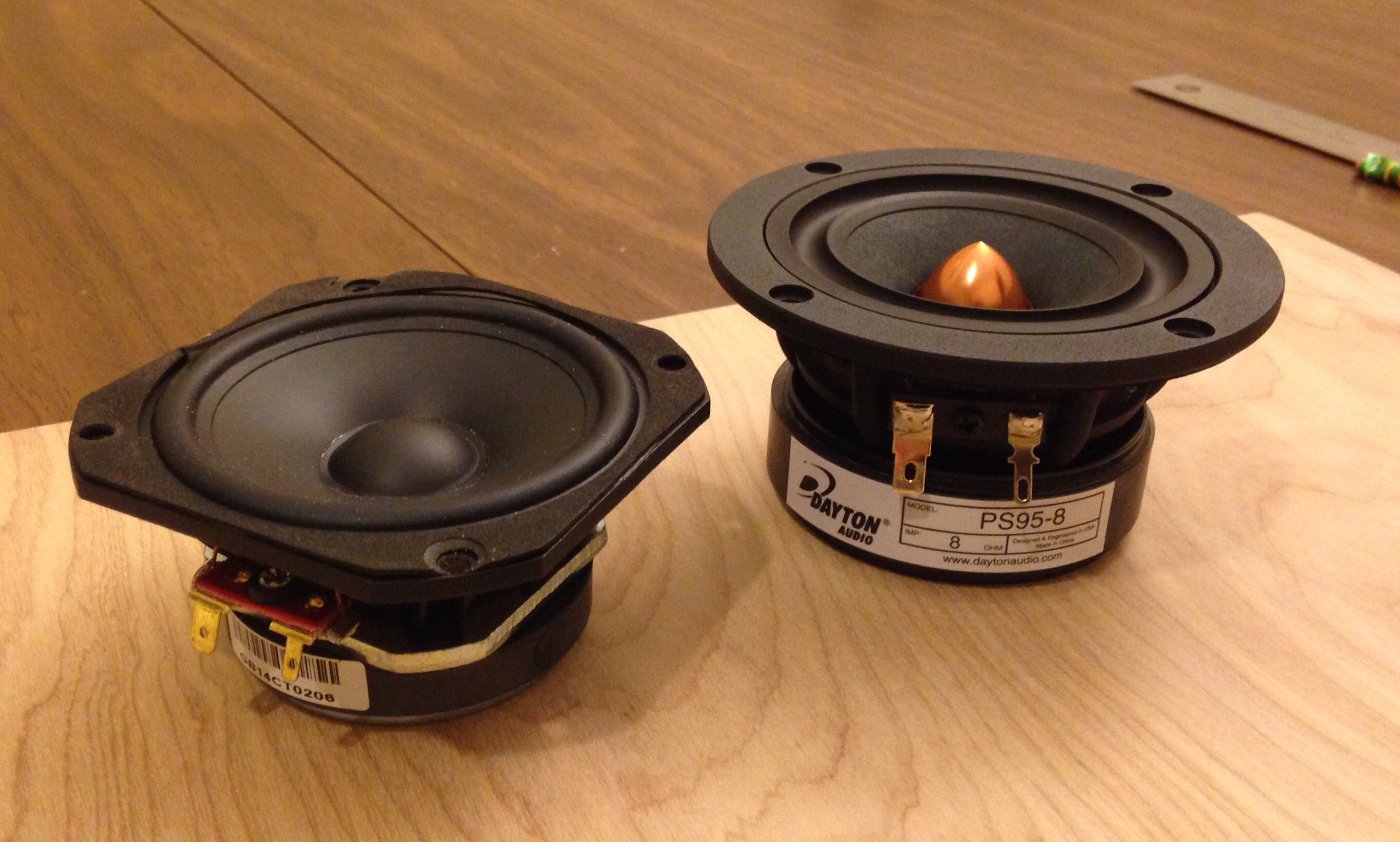

Norah Jones' Turn Me On sounded awesome. The snare drum sounded more present thru the PS95 than the Vifa. Vocals were great with Norah but Diana Krall was airier and wispier. There's a bit of wispy on every song played thru the PS95 Sibilants are more pronounced and everything sounds better off axis. Vocals have less weight than the Vifa but strings sound larger and float apart from the rest of the music. Treble is detailed and stronger than the Vifa. Accompanying musicians are more apparent and more easily audible. Miles Davis sounded vibrant. Horns are beautifully portrayed if a bit thinner than the Vifa. There's a sheen with PS95. Pop music bounces along nicely.
The live comparison in my apartment was similar to the virtual one in that the main differences between the drivers are apparent. But live, these drivers are far superior to the virtual experience.
The PS95 bristles with life where the Vifa remains neutral and more mellow. I think the midrange is more mature and truer to real life with the Vifa while the PS95 adds a bit of color and sparkle. As an audiophile I know the Vifa is more accurate but the PS95 will probably get more play time. It produces a larger image probably due to the increased treble. Piano twinkles more and there's more sustain on the notes. It's a very colorful driver that tints and flatters the music. I love it! It's much more than a pretty face and it works great in my open baffle setup accompanied by Alpha 15's in H-frames.

... The snare drum sounded more present thru the PS95 than the Vifa... There's a bit of wispy on every song played thru the PS95 Sibilants are more pronounced and everything sounds better off axis. Vocals have less weight than the Vifa but strings sound larger and float apart from the rest of the music. Treble is detailed and stronger than the Vifa.
I agree. The previously-published Impulse Response graphs, to me, tell the tale and explain why I thought the PS95-8 sounded more 'detailed'.

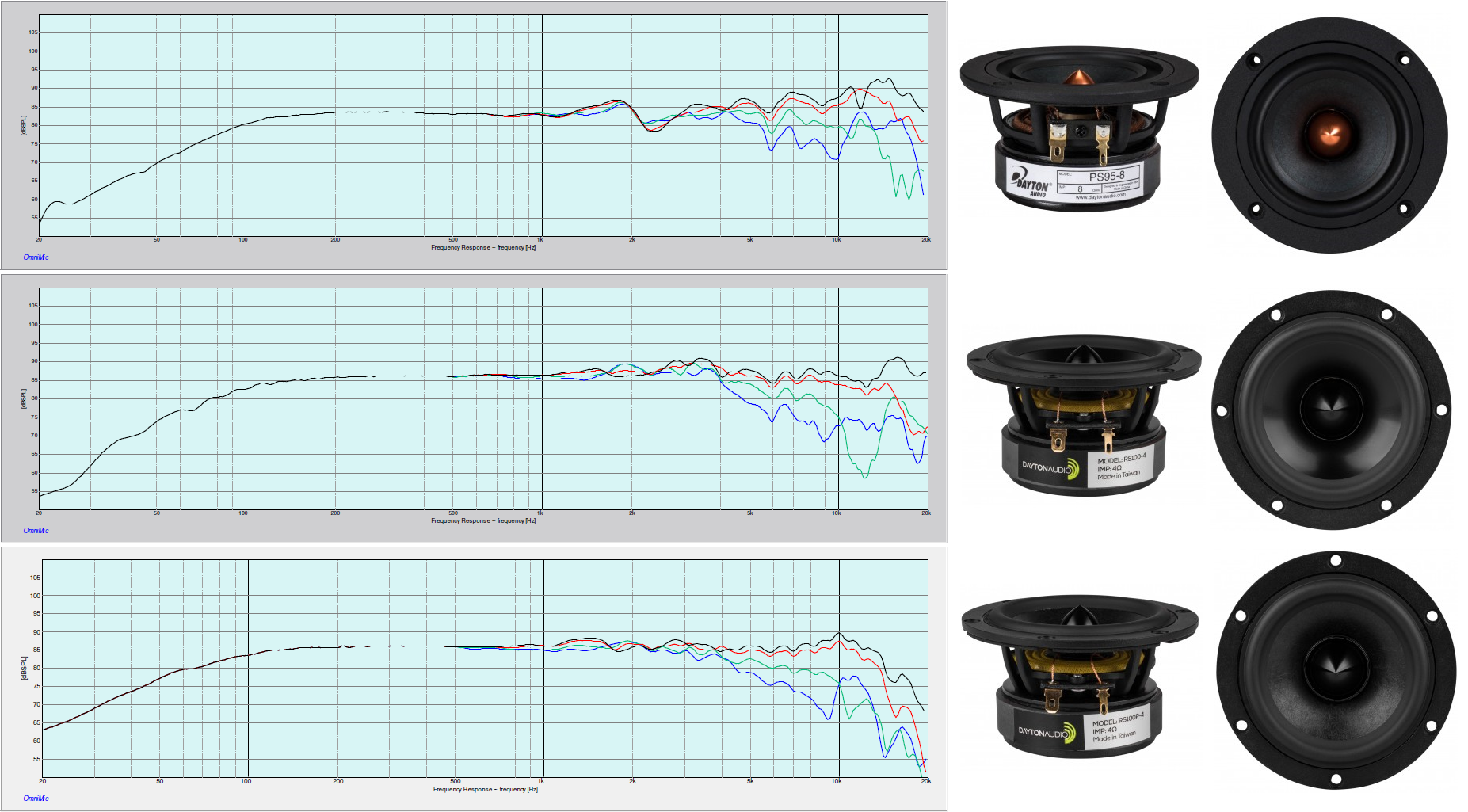

PS95-8 was recorded and measured 30º off axis that must give a difference because it has rising response on axis, below taken from Daytons datasheets (PS95-8/RS100-4/RS100P-4), RS series is smother but also little costlier.
From the graphs, I can see that off axis performance of PS95 is better with more sparkle - consistent with description by Godzilla. It seems that the phase plug is not the source of this enhanced off axis capability as all three have a phase plug. Perhaps the smaller diameter or thinner cone with more breakup?
And hear I though that the Holy Grail was max flat on axis.
