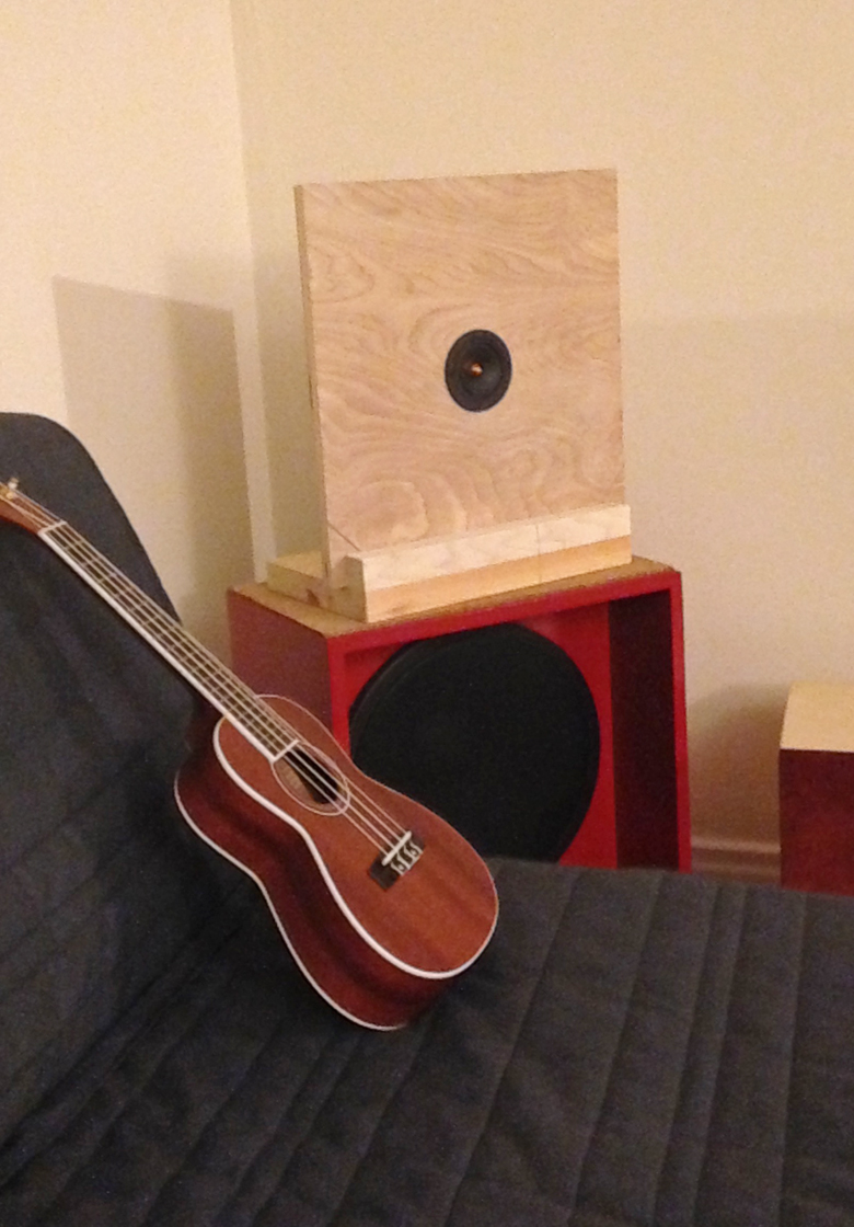

Are you talking about this "table" of cheeses to be sampled with a glass of wine? (actually a stool that I use as 29in tall speaker stands)
![505475d1442938731-subjective-blind-comparison-2in-4in-drivers-round-4-round-5-lineup.jpg](https://www.diyaudio.com/forums/attachments/full-range/505475d1442938731-subjective-blind-comparison-2in-4in-drivers-round-4-round-5-lineup.jpg)
Or this table (new to me)?
![504955d1442687392-ff105wk-tl-desktop-bookshelf-speaker-wkstn.jpg](https://www.diyaudio.com/forums/attachments/full-range/504955d1442687392-ff105wk-tl-desktop-bookshelf-speaker-wkstn.jpg)
My eye spys a Jeep 68223392AA and a Tang Band W2-852SH on that stool.![]()

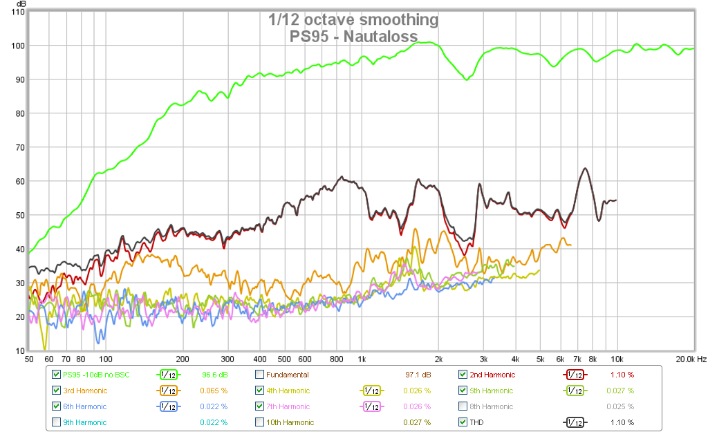

I agree that the PS95 is one of the prettiest drivers I have. That copper nose cone really adds some bling to it.
The performance is enough to garner substantial votes despite elevated HD levels relative to 10F/B80/TC9/TG9:
Truth be told, maybe it's the pleasing 2nd order HD that makes it sound good and "tubey"
The $65 is the 10F/8414 (higher 0.51 Qts) vs the $95 10F/8424 (lower 0.37 Qts). For OB, the $65 is probably better.
I have some less biased opinions than this:
Having liked this driver myself, also the SB from the other round, I feel I should seek to clarify some things.
Firstly, this is the THD plot of the nautiloss (according to legend), which you already showed higher overall THD
Am I right?
And unless the actual SPL is incorrect, then the rise from ~95-100dB between 1-2kHz would seem actually rather loud, to me at least...
So all in all, the 1% second order (the most benign order) at 95-100db@ 1kHz really isn't a huge deal.
But in the interests of fairness, its usual for paper coned drivers, yes? And also responsible for the general characteristic of natural sound, possible even with a level of second order THD.
And another question beckons:
What did I like about the 2.5" SB in the other round?
Did that have dominating second order THD?
Do you have similar plots at the same SPL?
On my note during the listening in round four, I have noted that A [Dayton] and B [TGnine] have distortion. But I have never mentioned that I was disturbed by A, only by B...
Technically I think this is what we know about masking of high order distortion by second order distortion...
I think it's not about what you like, it's about what others don't like...
Visaton, Peerless, SBAcoustics [may include the Tangband] are top drivers which are on different level with the other drivers...
Peerless was the most natural. If you look only from 2k5 and above, it is imo the best of all. And what's going on with the SBA? It has rising response around 10k. And this is with rising third order distortion. The other drivers which have similar properties [Alpair and may be FRS] just out of the competition much sooner. There is more airy treble, but I don't think it is what you like, because it is there with distortion.
