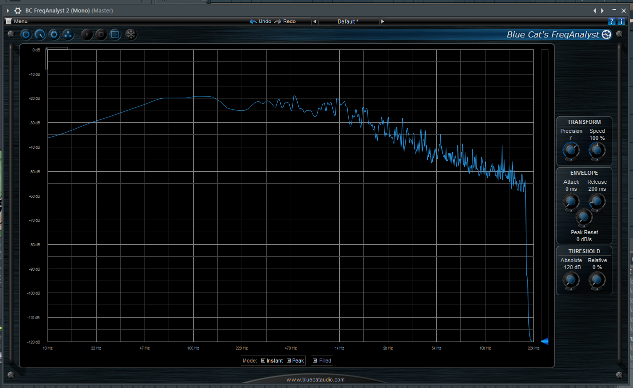

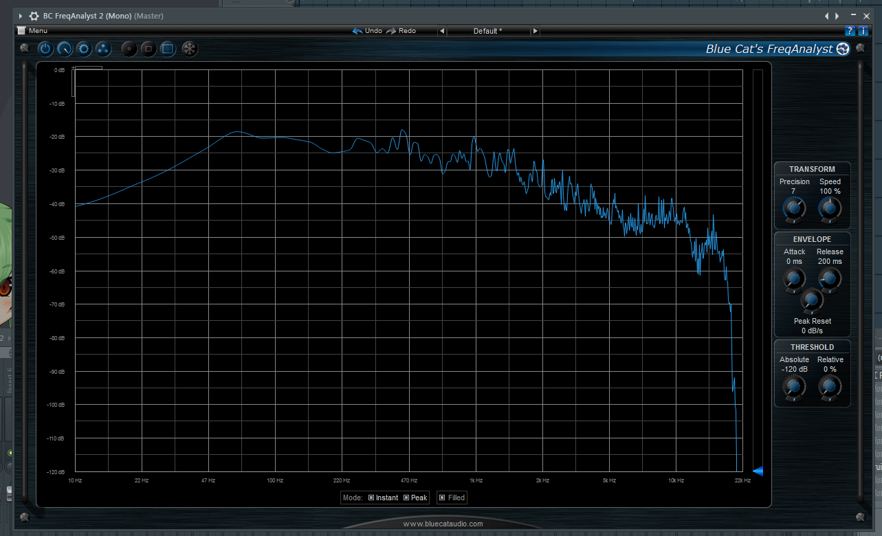

But I noticed something very strange when doing this. For example in B-clip3. If we listen to only the left recorded channel it sounds much different to the right recorded channel. The right channel of this clip has much less bass and an slightly hollowed out midrange, while the left channel of this recording has a more full sound. Here is a mono-recording of just the left and right sides of B-clip3.
You can also see from a peak-frequency response of each channel that the right channel has about -5db drop in the 40-300hz region compared to the reference recording and the left recorded channel.
left channel

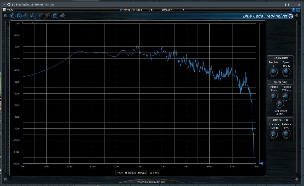

and here is the peakFR of the reference-clip3
502518d1441535773-subjective-blind-comparison-2in-4in-drivers-round-4-ref-clip3-peakfr.png

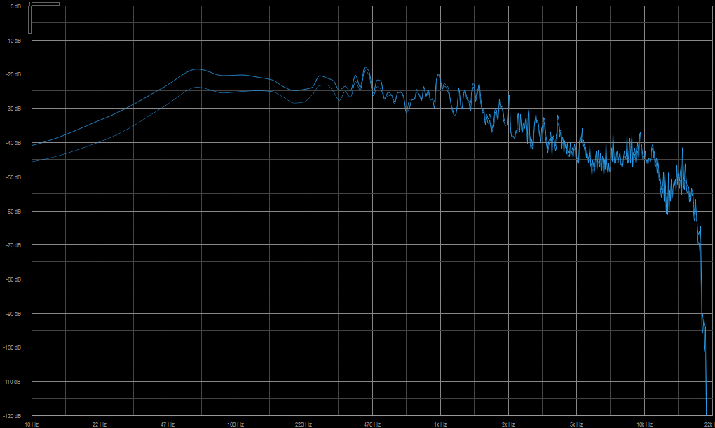

XRK, is this speaker placed slightly closer to the right wall of the room when recording? We could be hearing some reflections or phasing effect from the right wall in the right channel and a bass boost room echo being picked up on the left channel.
OK I might be cheating a bit here by analyzing the recordings, but we can see that driver B has a slight peaking in the 7-12khz range, a strong dip in the 12-16khz range and the a rise again above 16khz compared to the reference recording. (which looks surprisingly like the FR of one of the well known drivers here)
Either way I think I will only listen to the left recorded channel for all the clip when listening, assuming that the speaker was kept in the same location in the room for all the driver recordings

I think what you are seeing is the offset tweeter relative to the baffle. The mic is centered on the tweeter or driver under test and the woofer is thus offset to the LEFT of the XY mics. Woofer is closer to the left channel so it may have a bit more bass. The room walls are about even as I have walls at 45 deg to left and right. So maybe mixing down to mono from stereo recording is best.
Jeshi,
Ok that makes more sense. Glad that it is more simple (the left mic is closer to the woofer) than any room/echo/reflection effects.
I will just listen with the left channel of the recordings and ignore the right channel. This is safer than mixing down to mono since it could cause phasing effects from the two channels.

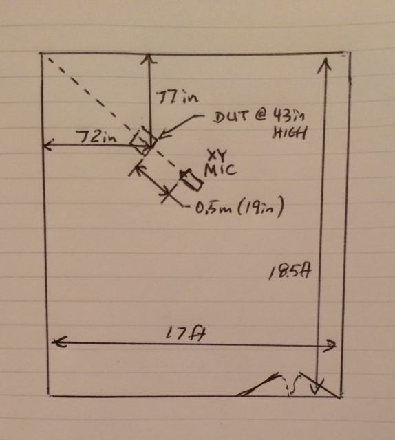

The H4 uses two cardioid microphones pointing two different directions. Speaker doesn't appear to be symmetrically placed in listening space. Speaker is symmetrical to two walls in room that isn't a cube. Sum of H4 microphones doubles intensity of direct sound of speaker while retaining each microphones capture of different room reflections. The resultant mono mix of H4 microphones leaves less for the brain to think about.
Microphones may well have different low frequency response; but this is mostly in woofer range, which is essentially identical for all clips. Overlays of jeshi's pictures show dominance of direct sound >400Hz:
X, can you diagram layout of speaker and H4 orientation in room?
You guys are making too much of this difference in left and right. Here is layout of speaker and mic relative to room walls etc. I was off by 5 inches for the left right wall balance, but maybe that is a good thing?

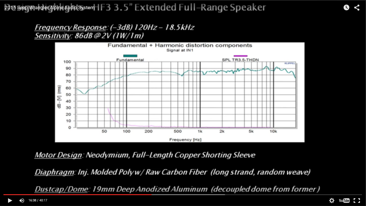

On the way (driver number 5) is the "Alpine HF3" a super cool new full range driver, mostly unbeknownst to this forum... a diyAudio member tipped me off to this driver which is an OEM 3.5in fullrange with a parabolic carbon fiber/poly cone, 19mm dia aluminum dustcap, Nd motor with copper shorting ring unit made by Alpine specifically for the Jeep Wrangler. This member is kindly providing this driver and should be here any day now. It has some interesting (and impressive looking) specs for the price ($18 to $22) and is available at any Jeep dealer (part number 68223392AA).
More info can be found here (go to 16:30 to see description of new driver):
https://www.youtube.com/watch?v=b25jj_zzINQ
Here is a screenshot of the frequency response:
502531d1441540925-subjective-blind-comparison-2in-4in-drivers-round-4-alpine-driver.png
Anyhow, Round 5 may include another driver if I get one before the testing ends. It will be the same setup as Round 4 so you can directly compare with the drivers being discussed in this thread now.
thanks XRK. The placement doesn't need to be perfect, just that it is consistent between the driver recordings.
